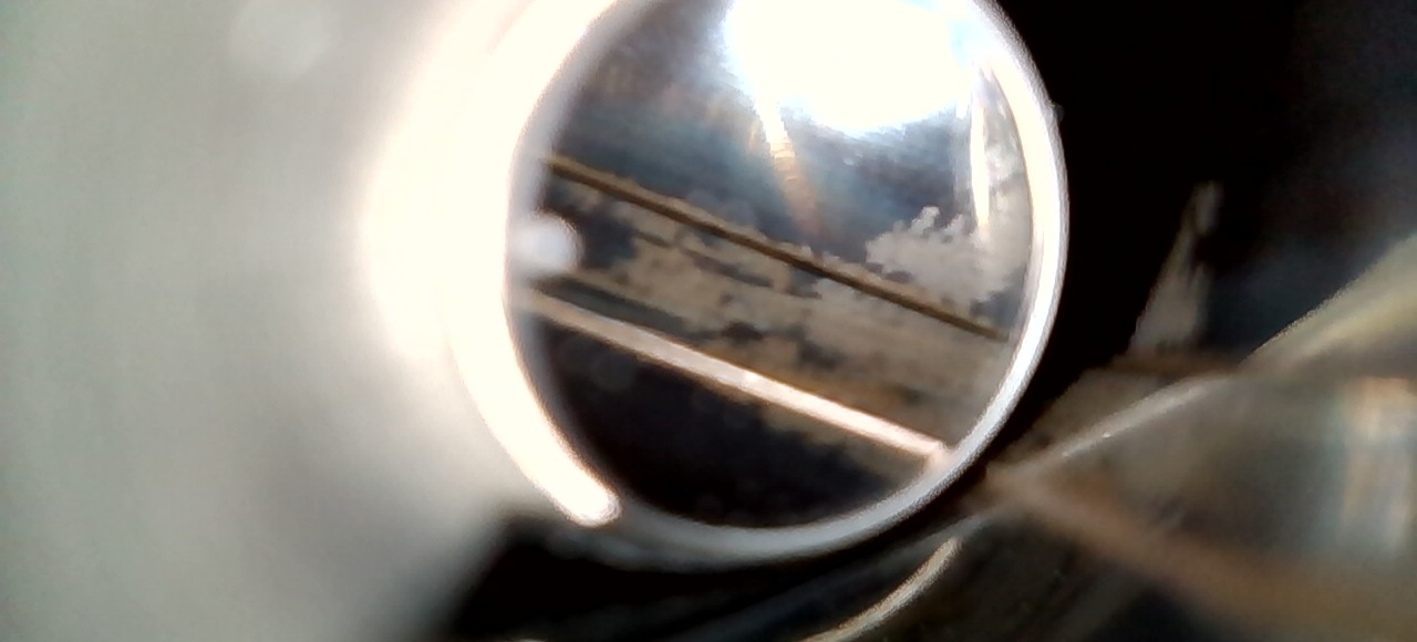

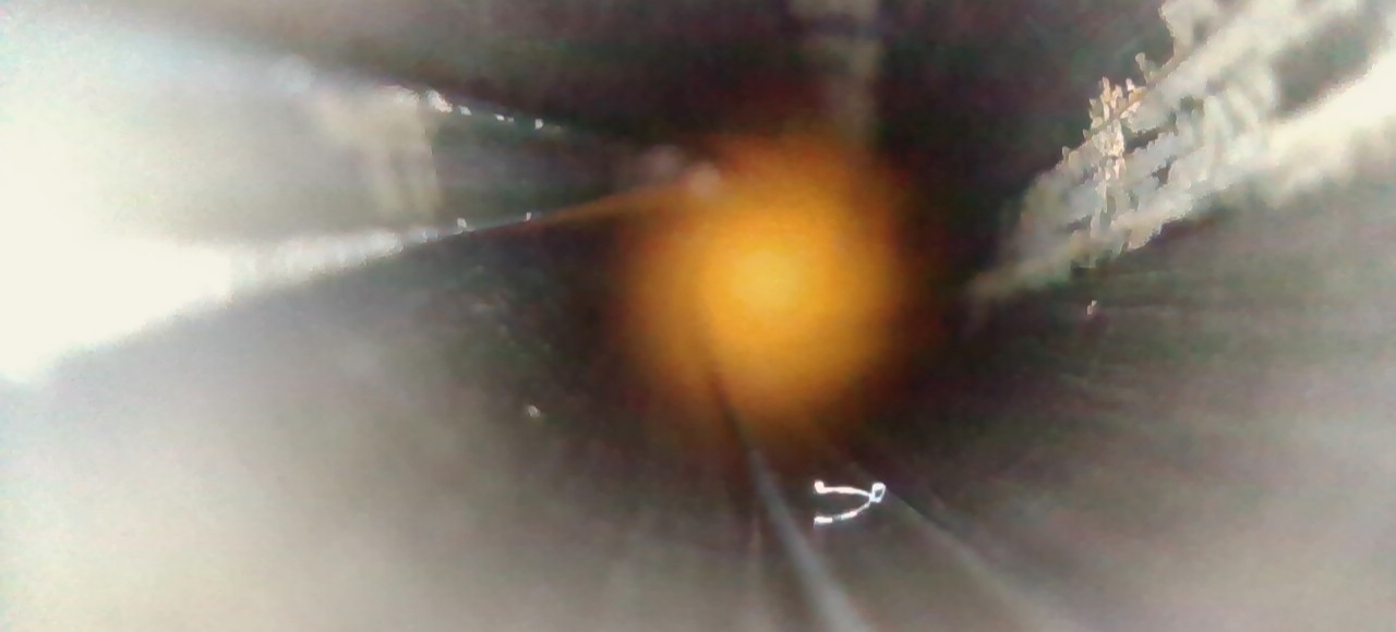

Might as well ask here. Tikka lite Veil (SS barrel) in 300 Win. Rifle has like 15 shots using Hornady CX bullet (factory ammo) and Federal Premium Berger Hybrid. Only ran 2 slightly oiled patches with ballistol before shooting followed by a dry patch.
Rifle is a copper mine or so I thought. I don't get the blue color anymore with Boretech Eliminator and I tried KG12 as well.
Here is what I'm looking at. It's the same from chamber to muzzle crown every few inches. It's not rust as I also tried Kroil. Might be pitting ? But it doesn't look fully like pitting as it's gold/white. This is after cleaning.
Any idea? I've never seen something like this in my rifles.

How does it shoot?

I would say around 1 to 1.5 MOA with 3 shots. After 15 rounds down the tube it's hard to tell. Should be able to throw some more this week and report back.
It's just weird because I own a couple of rifles and none of them are this ugly with a borescope including 2 Tikkas. I'm able to clean them relatively well with a couple of patches of Boretech after 100-200 rounds. If I don't plan to shoot them for a while I just push a lightly oiled patch before storing them.
Now with this one the patches look clean while the bore is ugly. I wonder what could have done this.

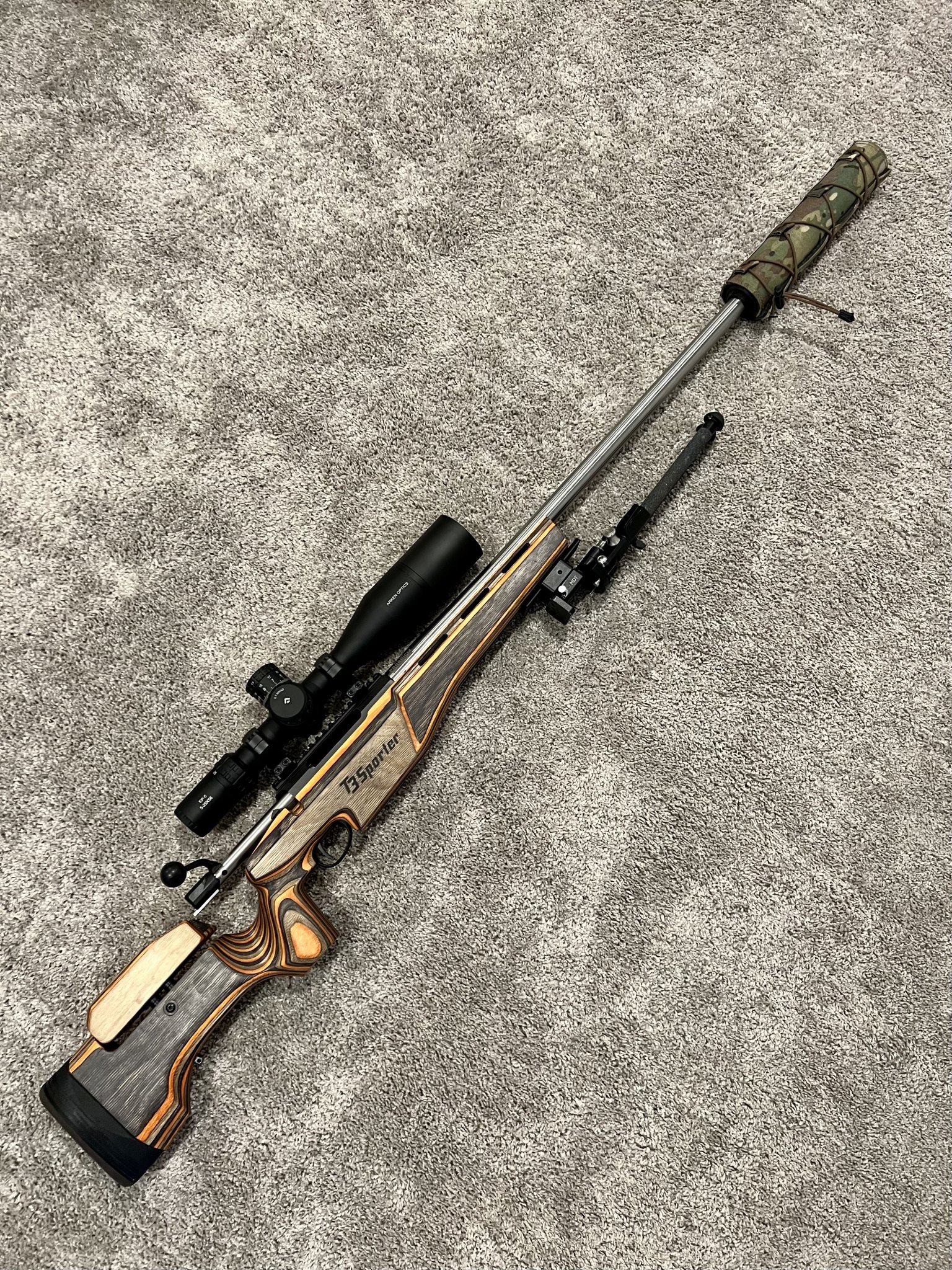

Here's what I call my Super Varmint Lite
My old T3 Lite .223 in a T3x Super Varmint Stock and a Waters Magazine so I can load long .
Came across those Waters mags earlier when trying to figure out how to be able to seat longer 223 in the Sporter, but it’s a hard pill to swallow when I could just convert it to AICS for pretty much the same price, even if it requires some fitting.

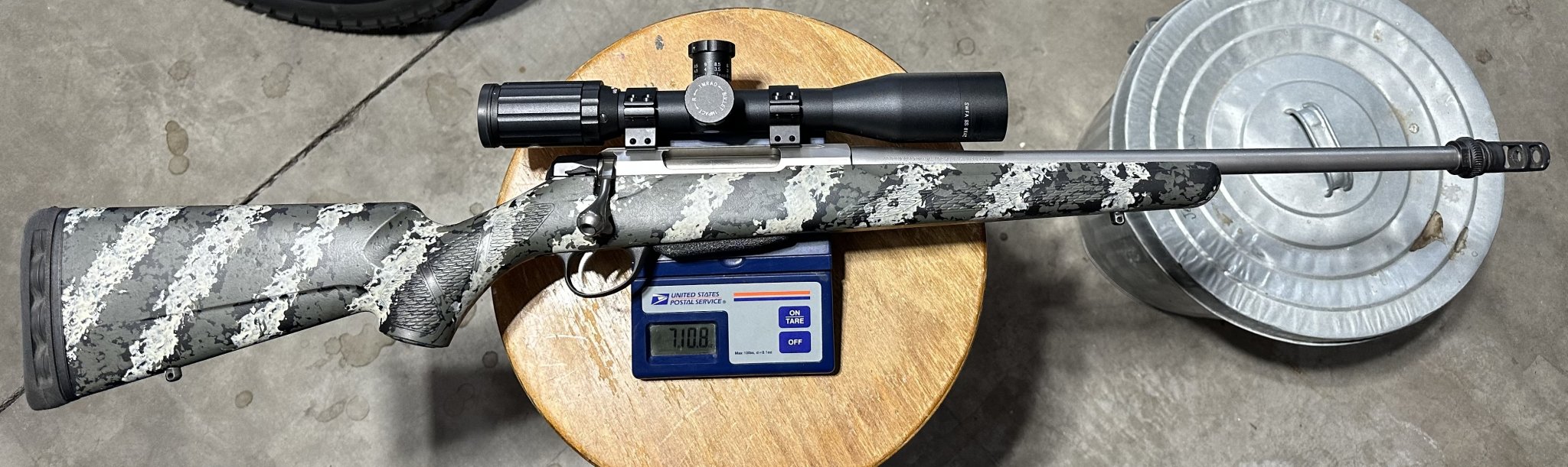

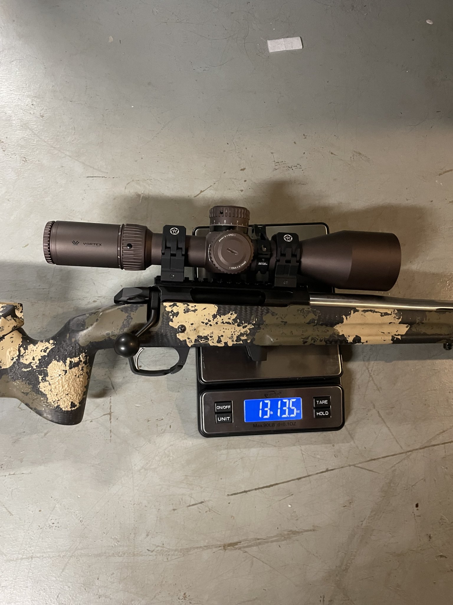

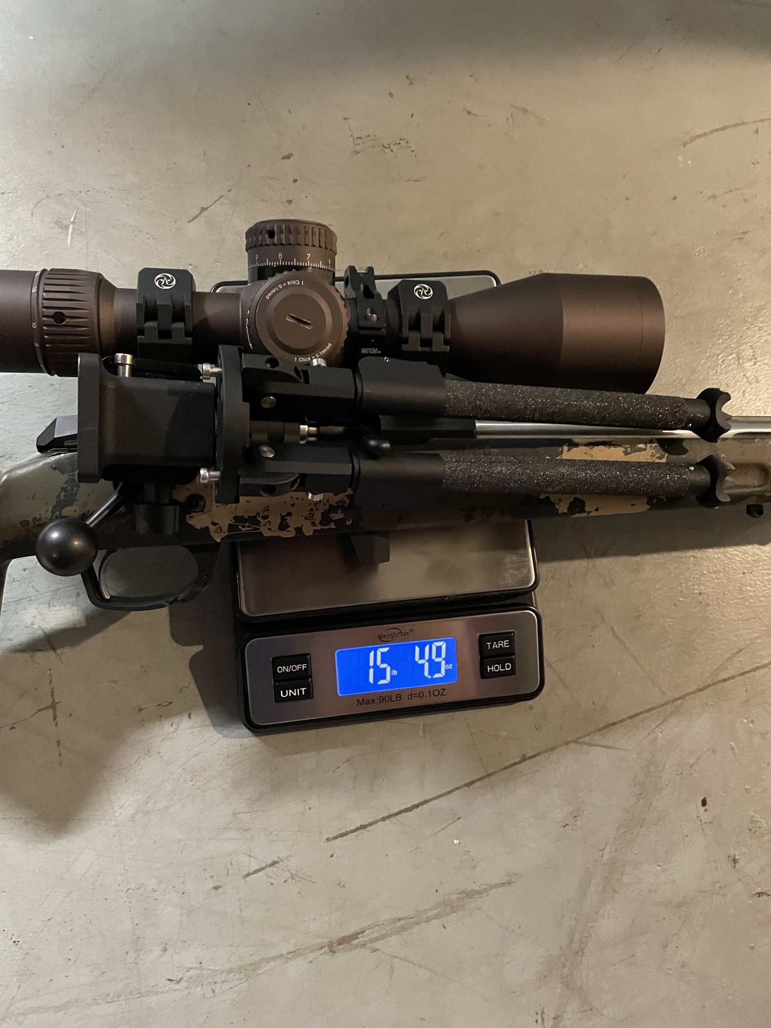

Has anyone weighed the Tac A1 chassis? I'm replacing the stock bbl with a Proof CF 20" and thinking of going with a lighter chassis too, but not sure how much weight savings I'll get. I've got a match this weekend and don't want to remove the action to weigh myself.
If you’ve a t3x action in 6.5 Creedmoor, I’ll weigh my Tack A1, and you can subtract one from the other.
Hopefully that will sort it out for you?

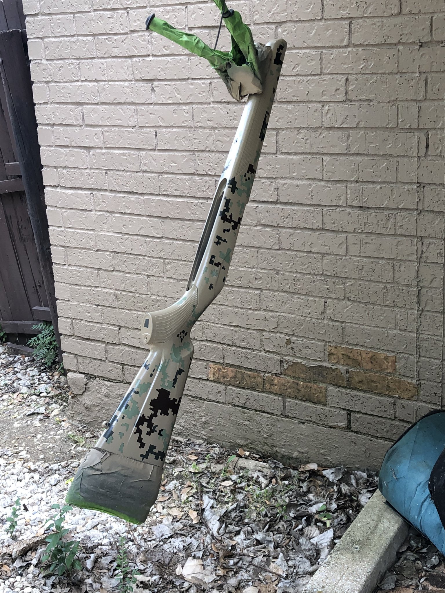

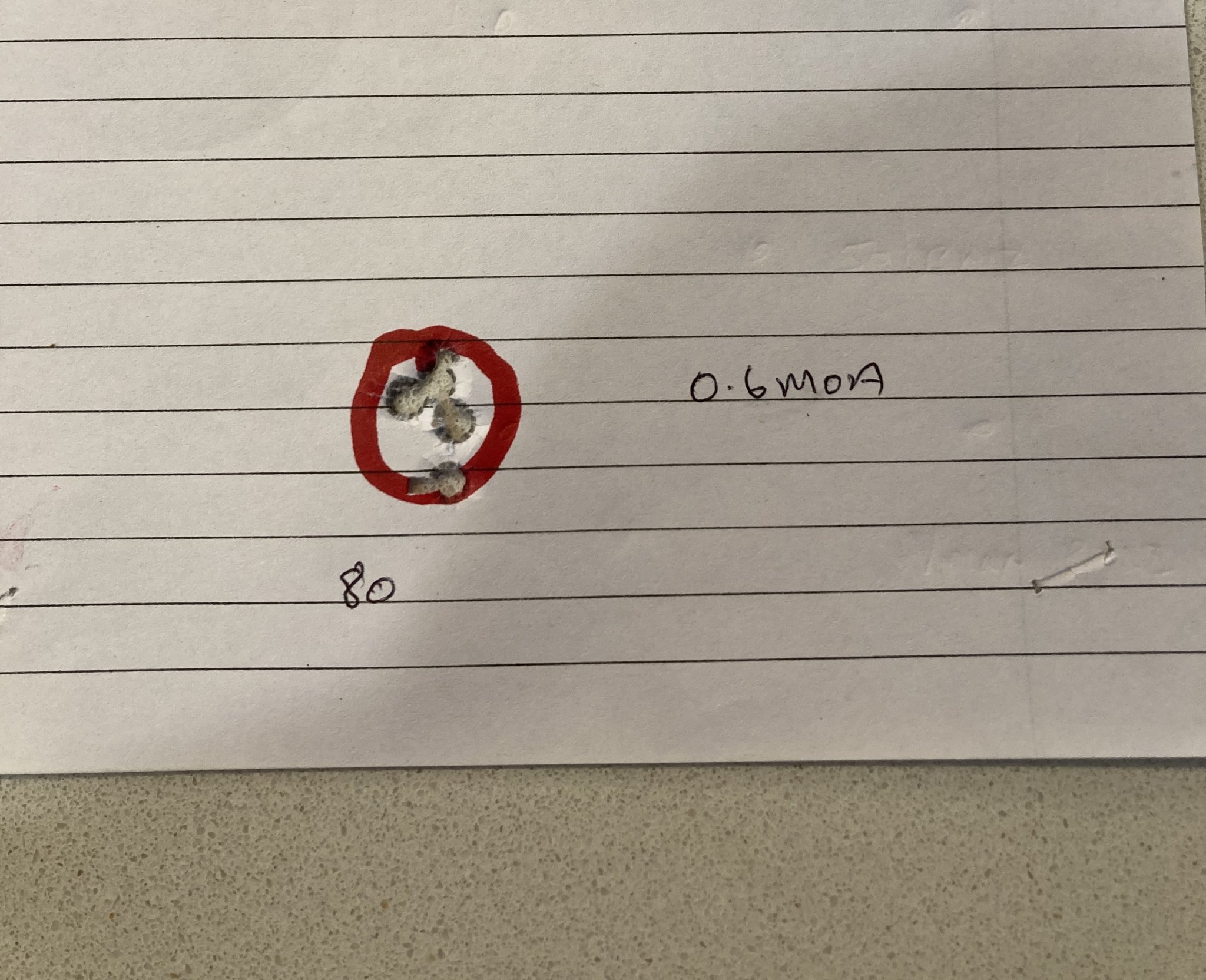

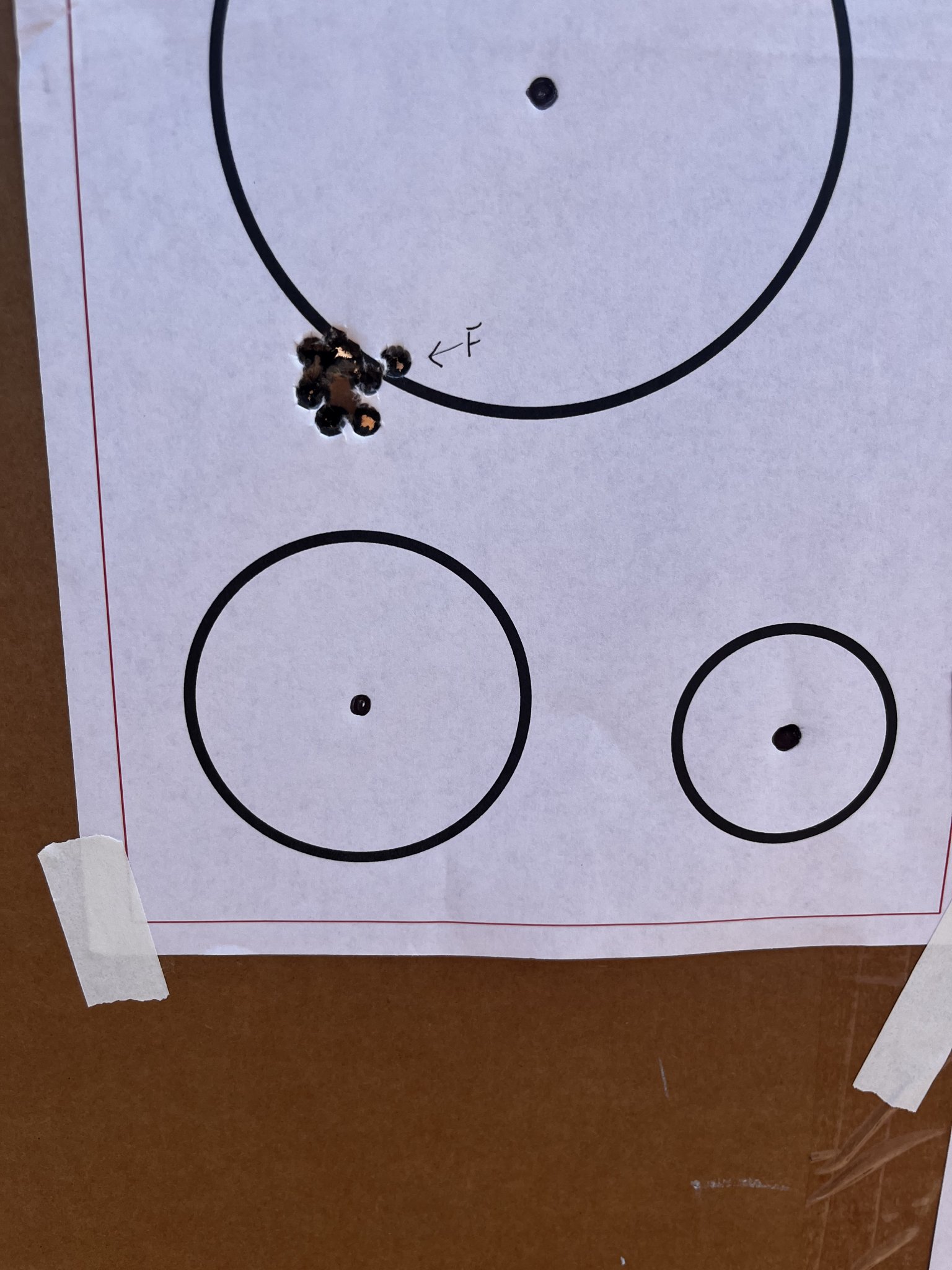

Started and possibly finished load development for Tooley chambered Bartlein
140eldm rl26 @ 2860. Called flier was 4th round but even with it (.7”) I’m not sure if would spend anymore time on this for my needs. 10 shots. This was shot as fast as I could comfortably shoot aside from walking down to mark the called shot when it happened.

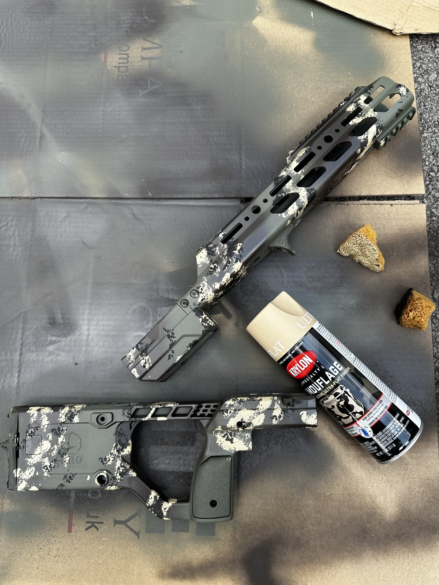

I won’t lie, for a good 15 minutes during the process I thought I’d ruined it, but it was fun and I’ve saved myself about 280 bucks on cerakote which I can now throw at ammo 👍
Rattlecan is ALWAYS the way to go. Cerakote just looks like you try too hard.
The real secret is to let the rattlecan wear naturally, that’s when it really starts to look good. And when it gets too beat, blast it again.
I have gone rattlecan as you put it a couple of times. IMO the key is taking it slow and several coats of a sealant as last coats. I was pretty happy with this, and always you learn a bit more to use on your next paint job

Google "filiform corrosion"
The big question is, how does it shoot?

I'm really liking the Waters Mag , it's transformed the old .223 and opened up the option of 80gr ELDM's .
Just got my Waters mags for .223 and they are awesome. Took a little time to wear in for me, but they are buttery smooth now and will take super long COAL. Highly recommend them for anyone with the standard Tikka inlet.
