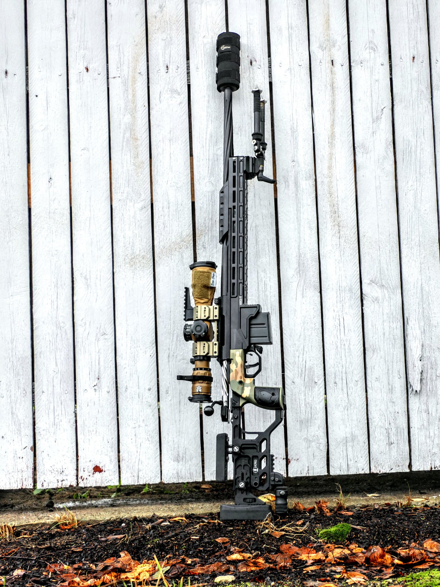

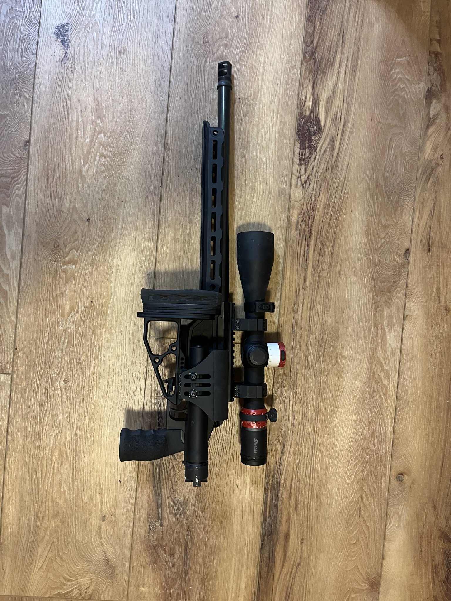

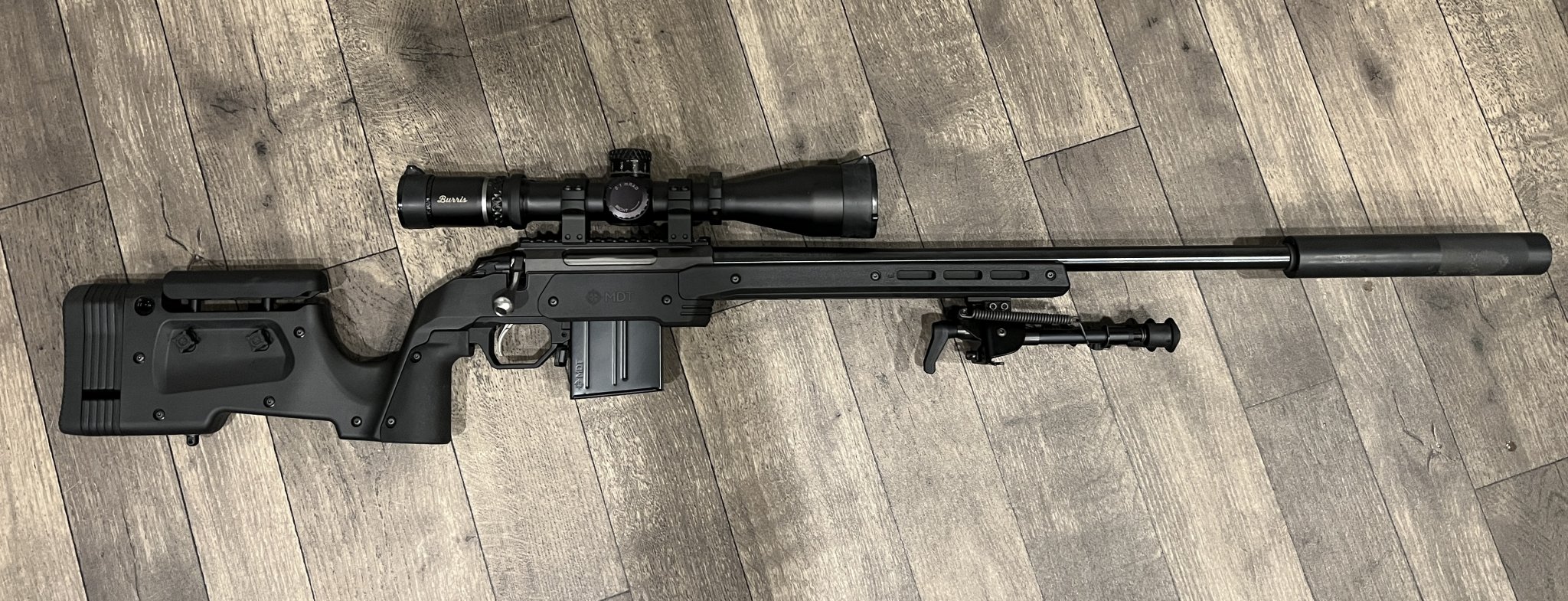

Updated my tikka today from my old trusty bravo to a XLR envy pro. I really like this chassis and am going to really like the folder for driving around and shooting prarie dogs from the truck. Should make it a lot easier to pass around.

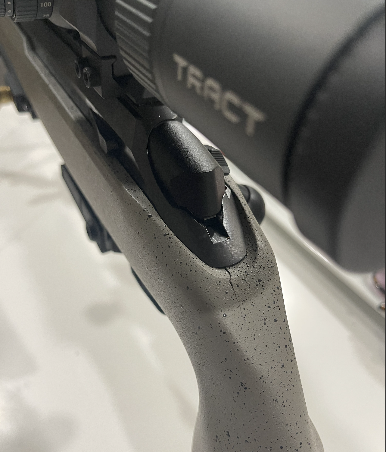

If you modified it they’re not going to honor the warranty, they don’t care if it has anything to do with the affected area. They’ve denied warranty claims because people didn’t send their rifle back in the factory stock for shit that has nothing to do with the stock.
If it were me I’d dremel it out, fill it with marine Tex, repaint it and bed it and call it a day and not waste my time with Beretta.
I'm pretty handy and may take this advice and repaint it and call it a day. Everyone here agrees that Beretta is terrible to deal with and I don't want my rifle gone for who knows how long. I'm just pissed it's only a couple of months old and it's not exactly on the cheap end of the spectrum.
They will ask.
Have you took the action off the stock.
If you have, they can say no warranty.
So, think clearly....
For real? You can't adjust the trigger without removing the action, or at least I don't know how to. Who doesn't take out their action to clean it and look things over. FWIW, the lady today didn't ask. Also, they tell you action torque specs, meaning they're assuming you're going to pull them at some point.
Appreciate everyone chiming in. Seems like the common theme is Beretta isn't great. If they say I voided the warranty by punching a T Nut 14" away I'm going to lose my mind, haha.
So I found and rewatched a video on YouTube where someone visited the Sako in-house stock factory , and the narrator/'tour guide" is the guy who was the "R&D Manager" and I think the lead on the UPR among other things at Tikka. - And he basically said that resin that is impregnated in the carbon fiber of the stocks - the excess resin - needs to be removed, which they do with a robot - and basically "some people think that they see a seam, which would mean we made the stocks from two separate sides, that's not the case, it's just a seam from the excess resin..."

What bolt handle is that?

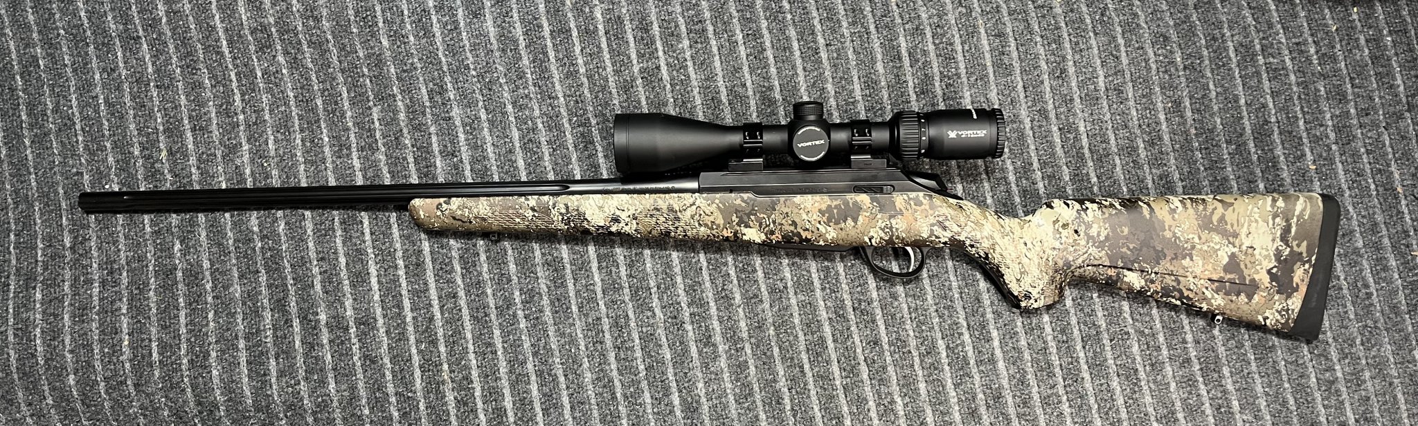

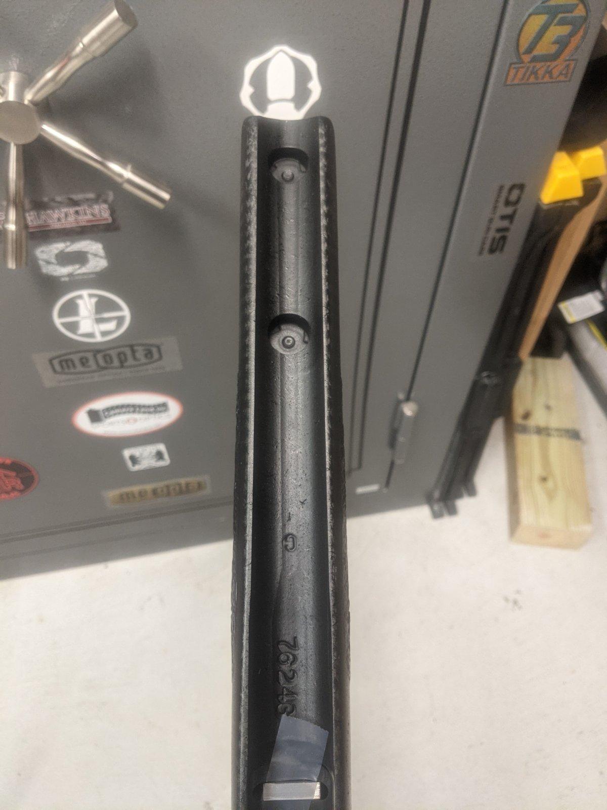

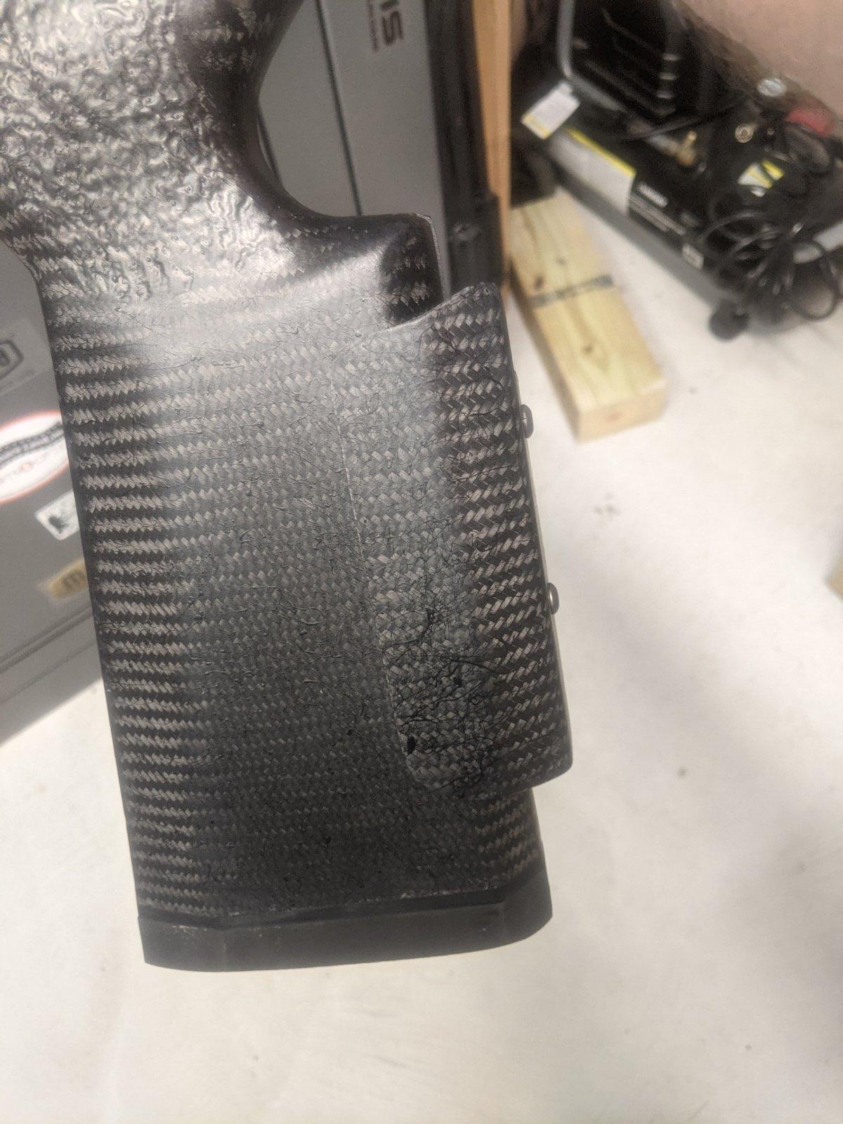

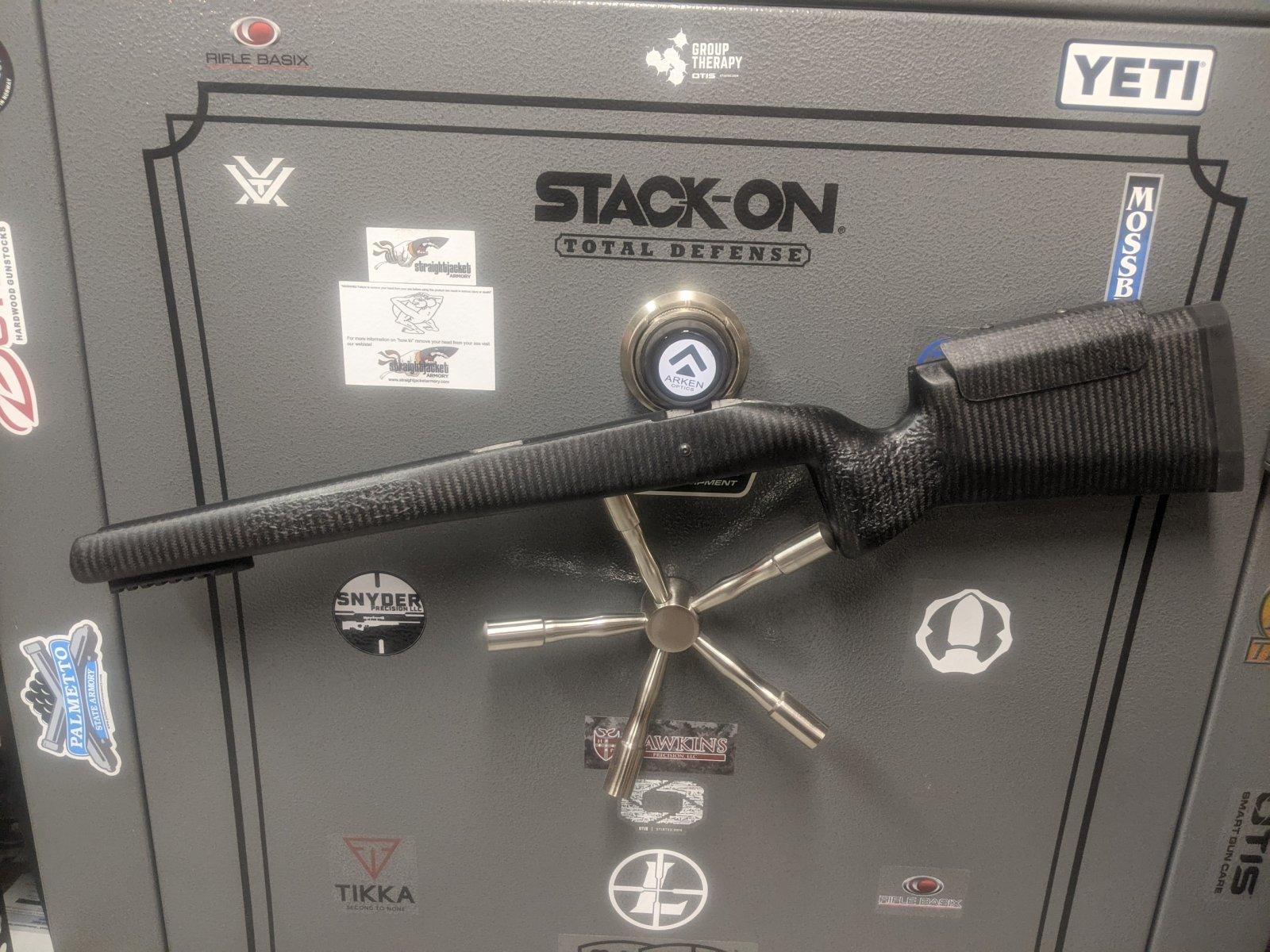

Hey gang,
After everyone chiming in, I decided not to roll the dice with Beretta.
1. Nobody had anything positive to say about their warranty process and CS.
2. CS told me they had no available stocks to replace it with that they could find. I could not bring myself to hand it over with any idea when I would get it back. If it were a mechanical issue with the action, then obvi I wouldn't have a choice.
So, I took redneckbmxer24 input, but I used the strongest JB Weld I could find at around 5600psi. I drilled out the tail of the crack, cleaned well with acetone, filled, sanded and cured. I purposely did not attempt to clamp the crack closed, as I wanted the filler to have some tooth against the fiberglass (I'm a woodworker). Because I now had an eye sore, I decided "nah" and painted it. If the crack reappears, I'll just scrap it and put it in a chassis. Hopefully it'll last, as I actually like the stock. Paint job inspired by my 457 that's in a Manner's stock.
Before:

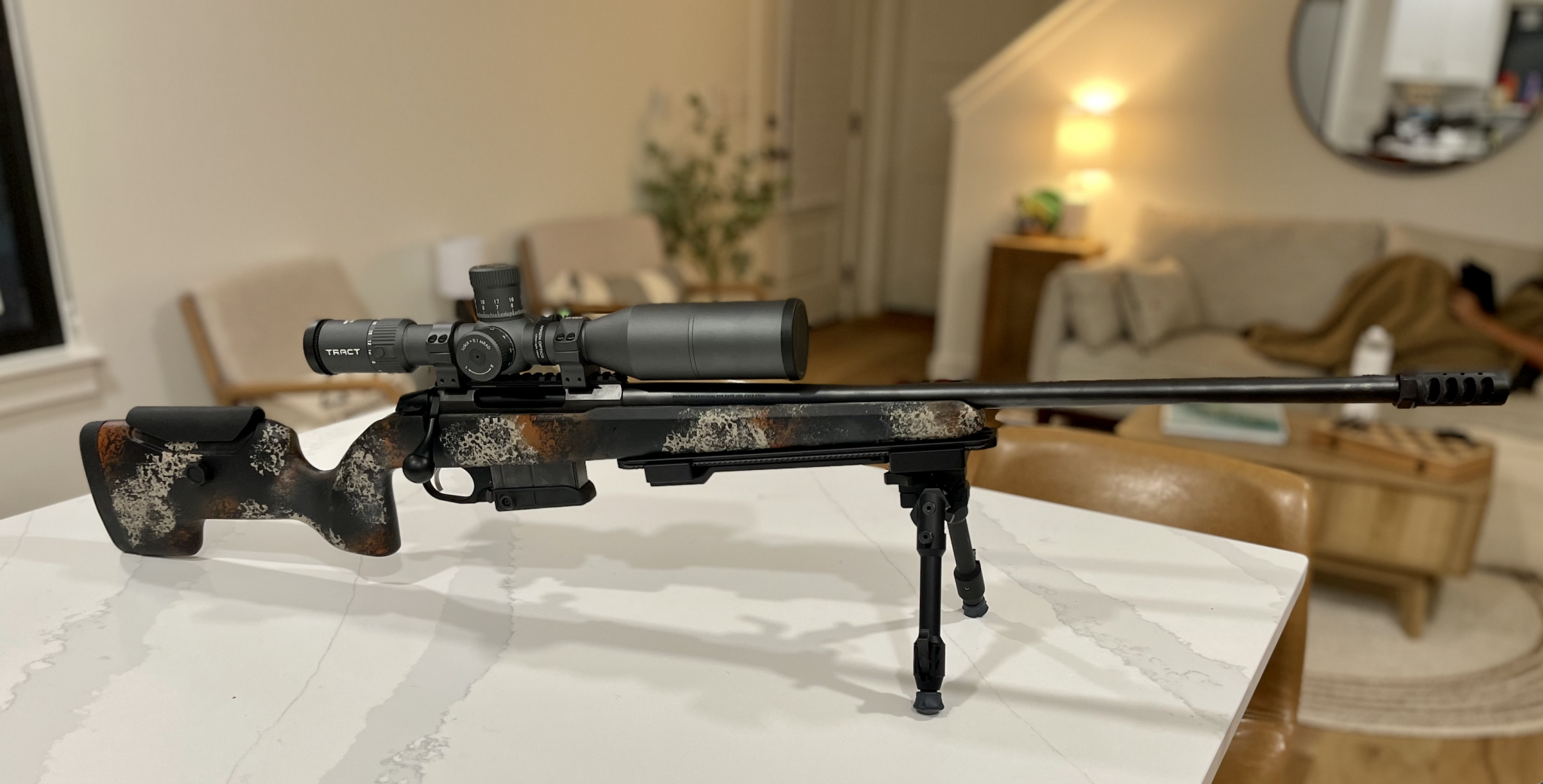

After:
Thanks to the hide for the input!

Looks good I like paint do you have close up of the repair?
Reactions: climbing1
You might consider going into the fiberglass stock refinishing/repairing business lol wow
Ha! I’m not a fan of fiberglass. But it did cross my mind to strip around the palm swell and make it wider and mould in a thumb rest. That is one thing I absolutely love about Manner’s is their wide swell around the palm.
If the stock takes a dump again, I might experiment with it. If I do I’ll share my process/result. 😅
Reactions: carbonbased
One reason for the crack in that stock could be loose bedding which in turn uses the rear action screw to split the stock also because the action screw hole might be too small in diameter. Another reason is because these stocks do not have a single fibre going from left to right. Repairing that I would cut a groove left to right around the tang and inly soaked carbon rovings, then cover with filled epoxy and fair. Got to get the structure right. Or buy a composite stock that is built right from day one.
If it splits again relieve some of the material inside, install pillars, and pillar bed. That should relieve whatever stress is causing that. Worst case scenario, with enough repairs you'll eventually have the first full JB weld stock.

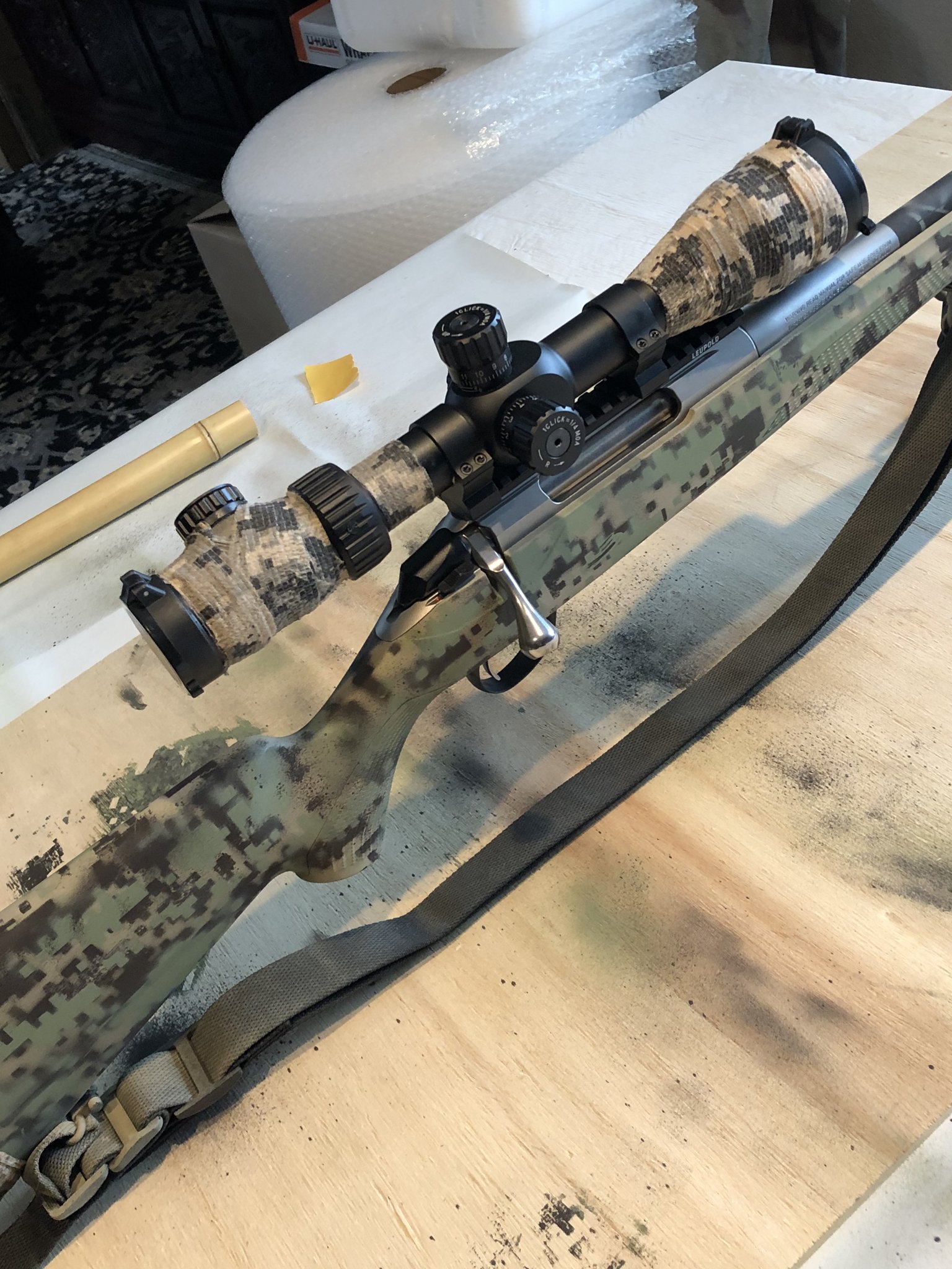

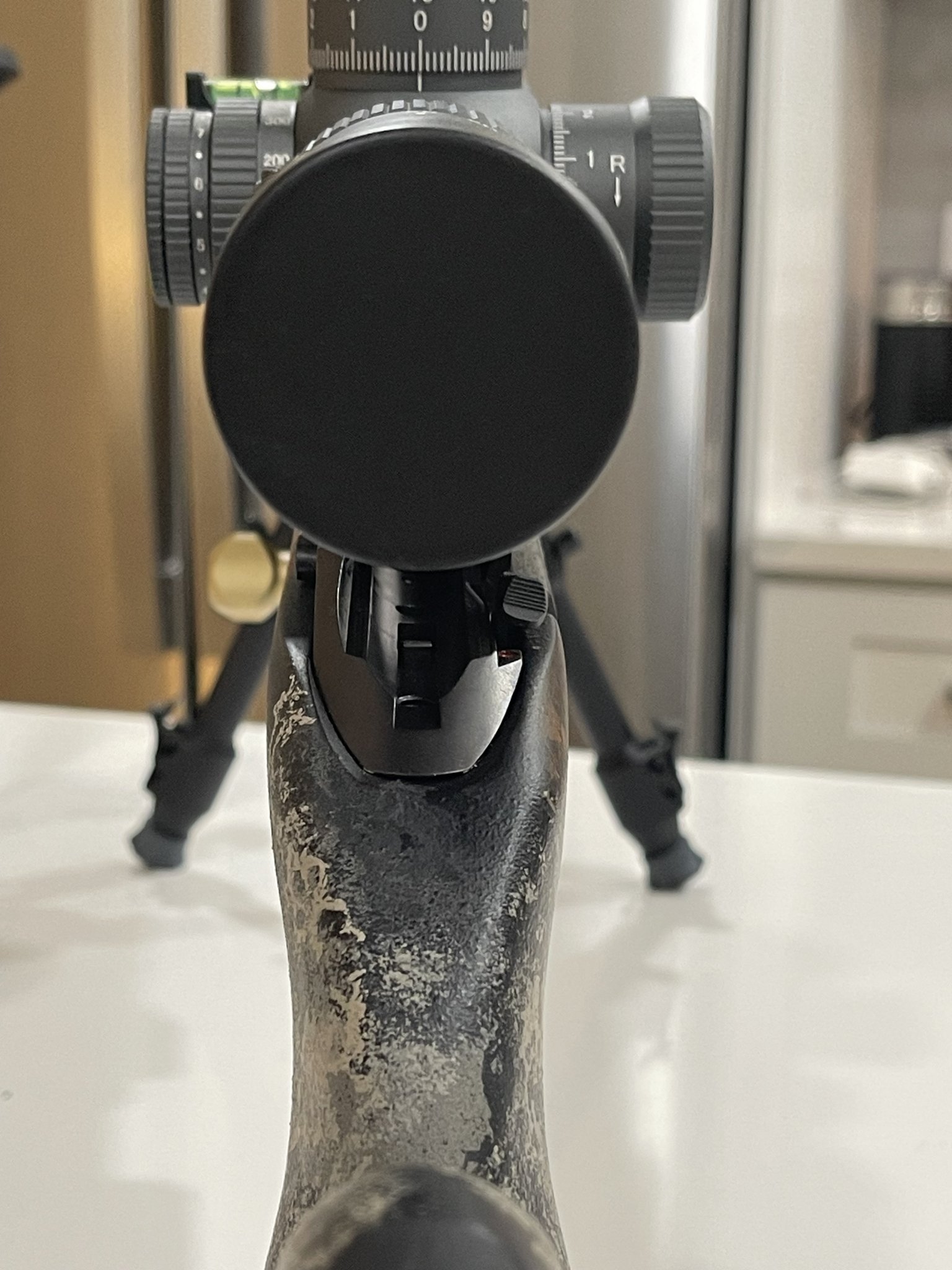

I love the freedom a bit of paint and a stock that allows you to exercise a bit of creativity. Get tired of it? Redo it lol
I have painted my tikka several times. This is the most recent incarnation.

NIce! And agreed.
Do you strip it down or just clean and go over it?
NIce! And agreed.
So far I clean and go over it. If the paint was chipping or loose I would do a full strip. So far I just wipe it down good with alcohol and hit it with some fine sandpaper and then wipe it down a 2nd time. Anything loose should show by then (I hope lol)
Thanks! I promise you can do it. Matte paint with various colors hides a multitude of sins.
Oh!! And a coat of non-glossy clear coat will help protect your paint job. It’s important to allow for fully dried layers if you are doing layers. Here in Texas I just left the stock outside in 100° weather for a few hours lol

Your paint job looks awesome man. I hope your repair holds up well, I think you did the right thing to repair that stock.

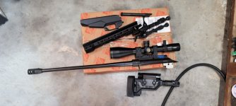

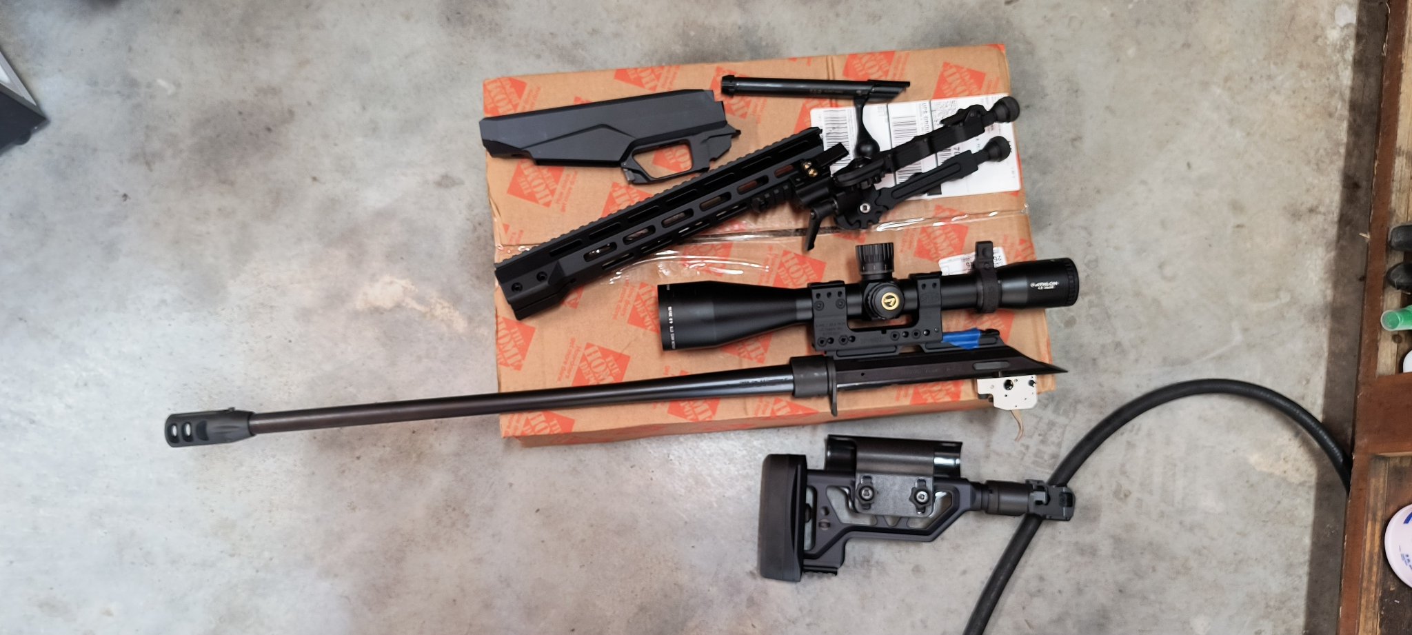

I decided to install the Yo Dave trigger spring. I was very disappointed that the two sling mount m screws slightly gauled when removing them. I cleaned them with a die nut etc. Good to go. I know I didn't have to removed them but I figured that out after the fact.
As for the rest of trigger spring install, it was very easy. I am VERY shock how well the trigger feels now. Very light and a clear wall is still there.

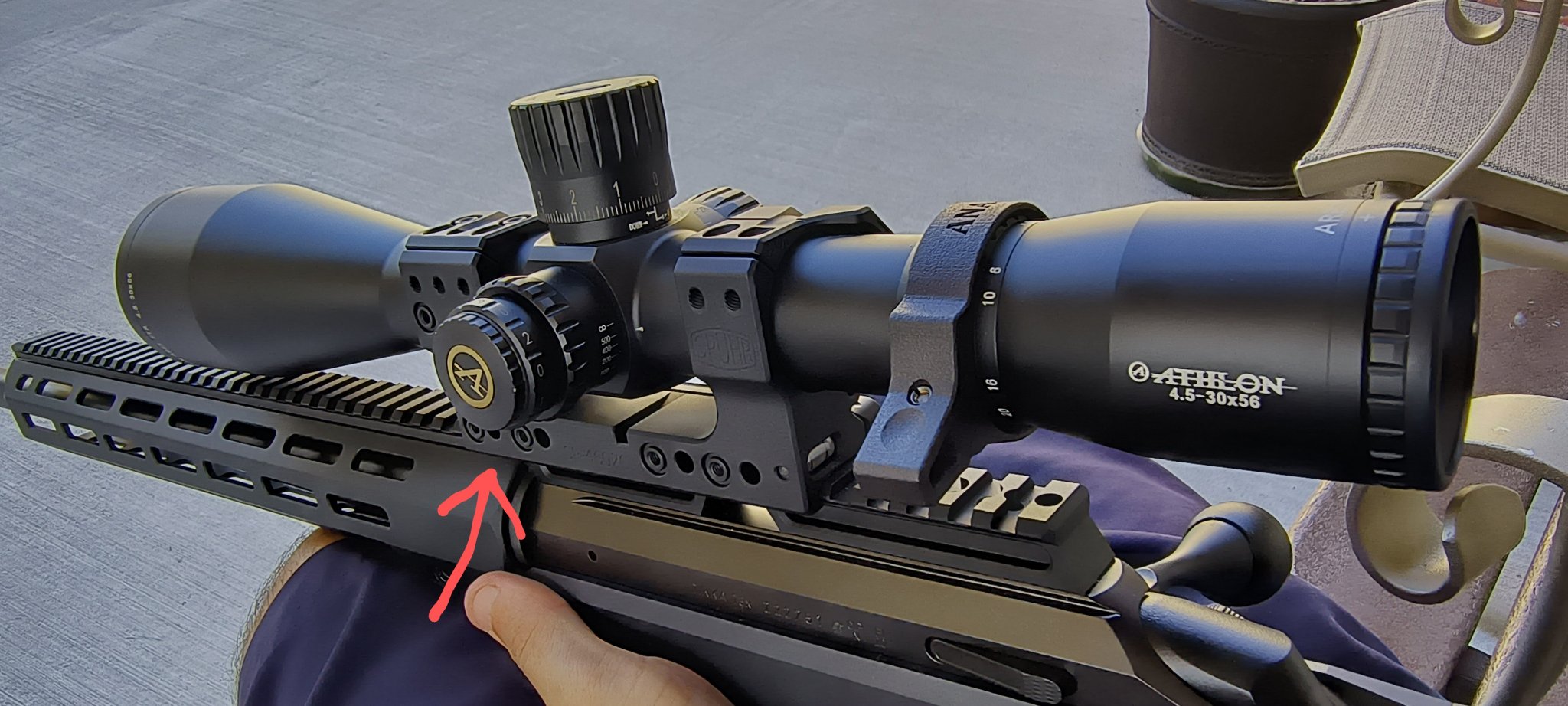

I also noticed that the front of my scope mount was attached to the hand guard top rail (red arrow on a picture from Friday) . That can't be good. So I went ahead and moved it back which actually made the distance from my eye far better. That's what I get from trying to rush things Friday when I put the scope and mount originally on.🤦
