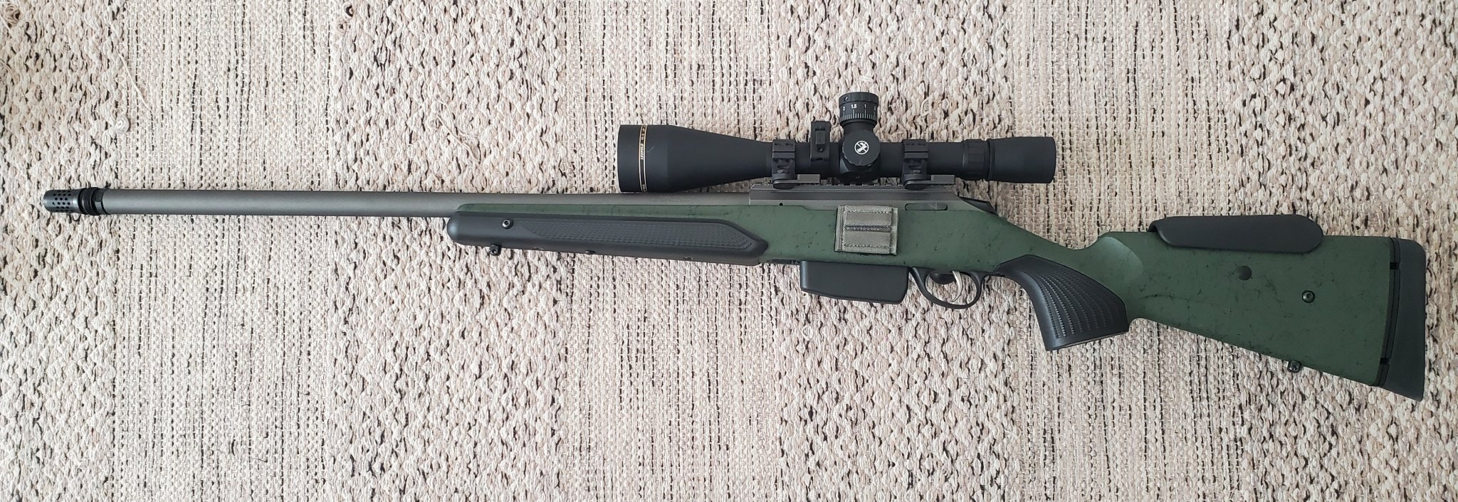

Finally got the 280 AI out for some load development.

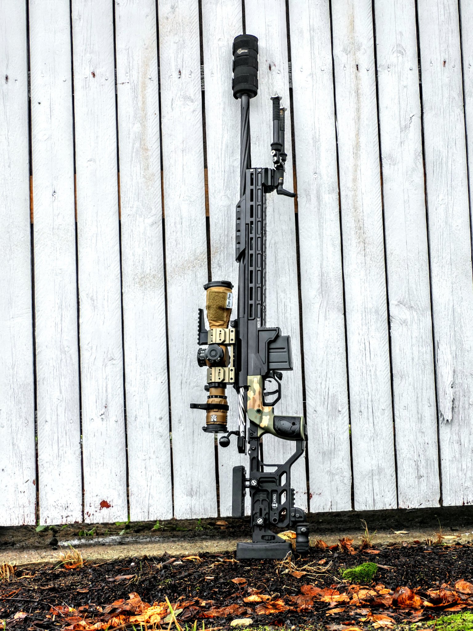

My Tikka T3 SS Varmint with the KRG Whiskey-3 gen6 chassis & Total Hunter OIC1 forend is a nailer.
3 black grouse on the weekend.
Longest shot was in 510-yards, bird down and we found it.
123gr Lapua Scenar was the pill and Vihtavuori N160 44,6gr, caliber .260Rem.

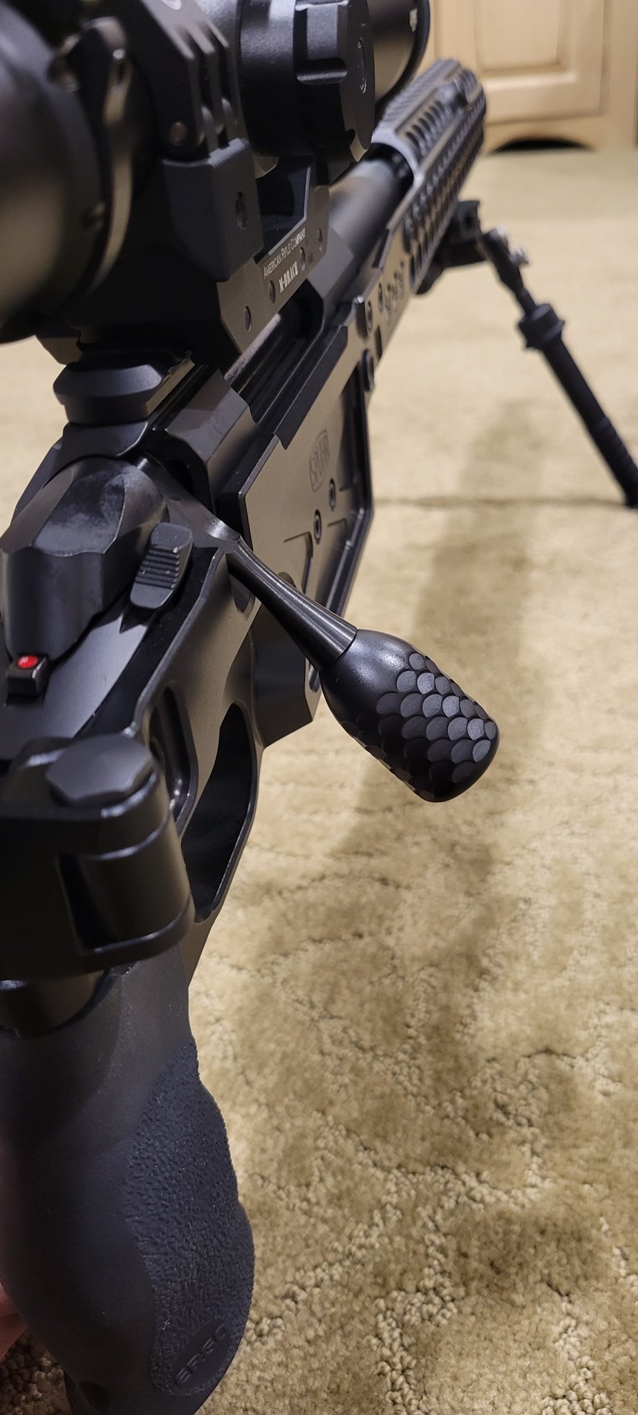

John (@cannoncrossfire) hasn't been here as much recently. I was able to get a left hand t1x handle from him recently. It's awesome.

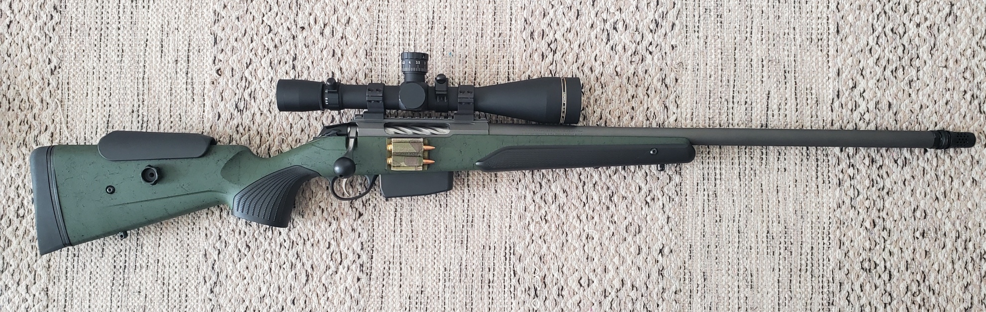

Posted in shorty thread too here's the basics
T3x shorty in 308
Pse etac stock
18 inch bartlein varmint profile 308w
Nxs 2.5-10x32 in optilock ringmounts
Weighs 9lbs without the bipod. Have a 20 inch 223 barrel and 223 bolt too. My only rifle currently. See how it shoots this weekend...

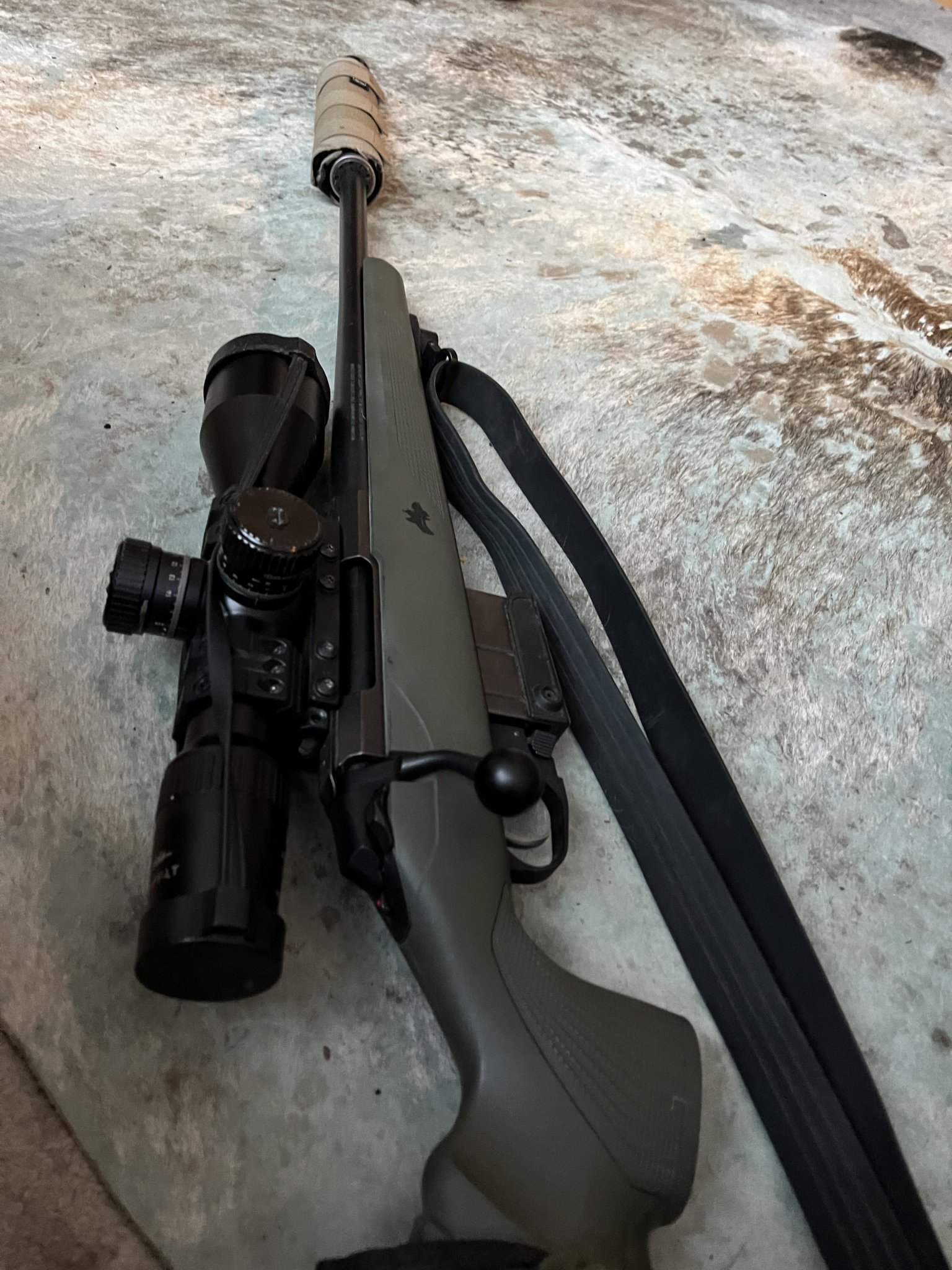

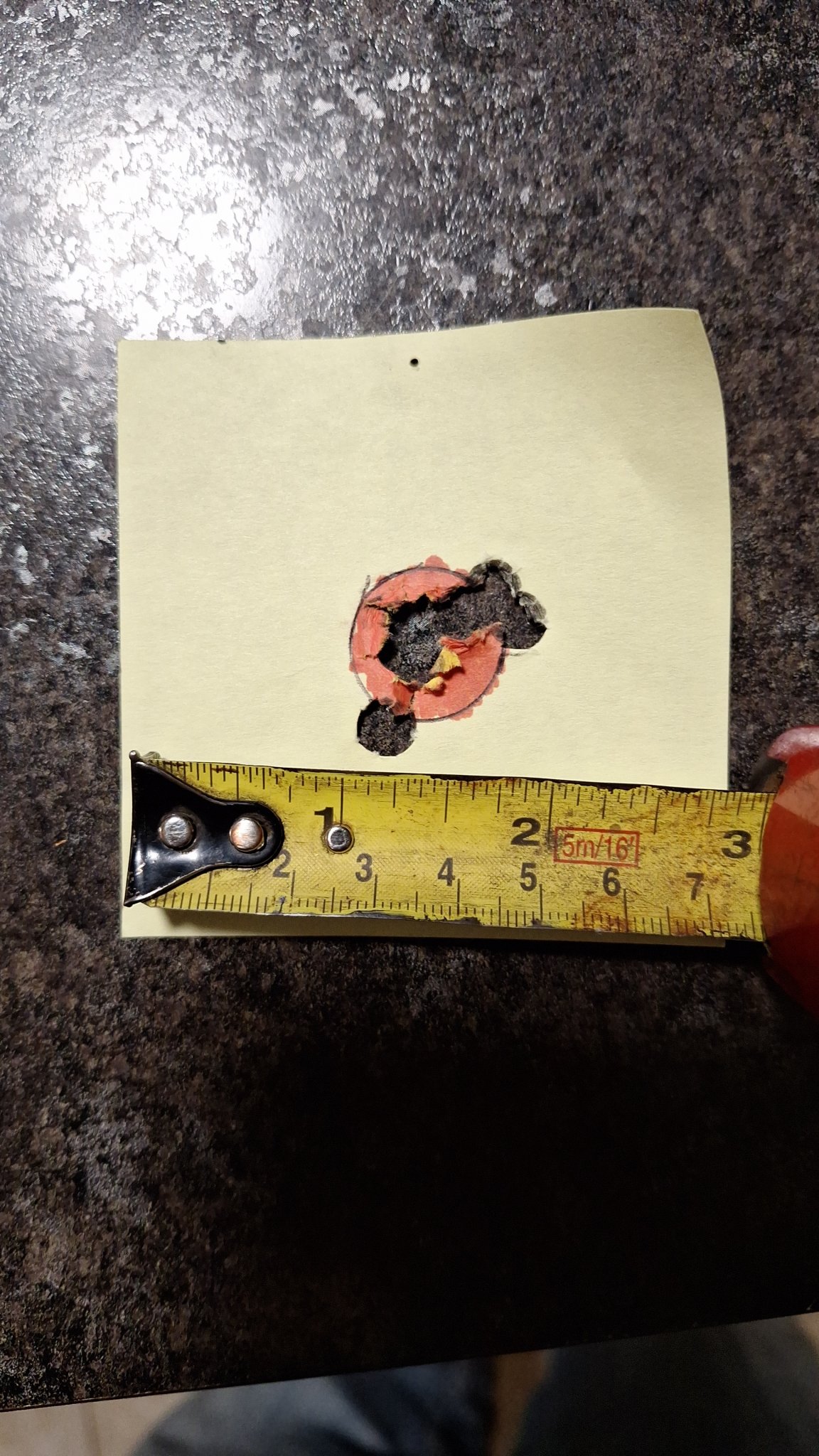

Took my newish shorty 308 t3x out, spec and pic above. Barrels new the rest of it isn't...
Gold medal match 168 and 175 both sucked! 1-1.5 moa. Surprised there. Haven't shot any lately so may have been me plus the new barrel settling in.
But random load of 45gr varget and speer 168 bthp in petersen srp brass turned in a .76 10 shot group with 9 into .5. Super happy with this starting load. Think I'm the limiting factor..

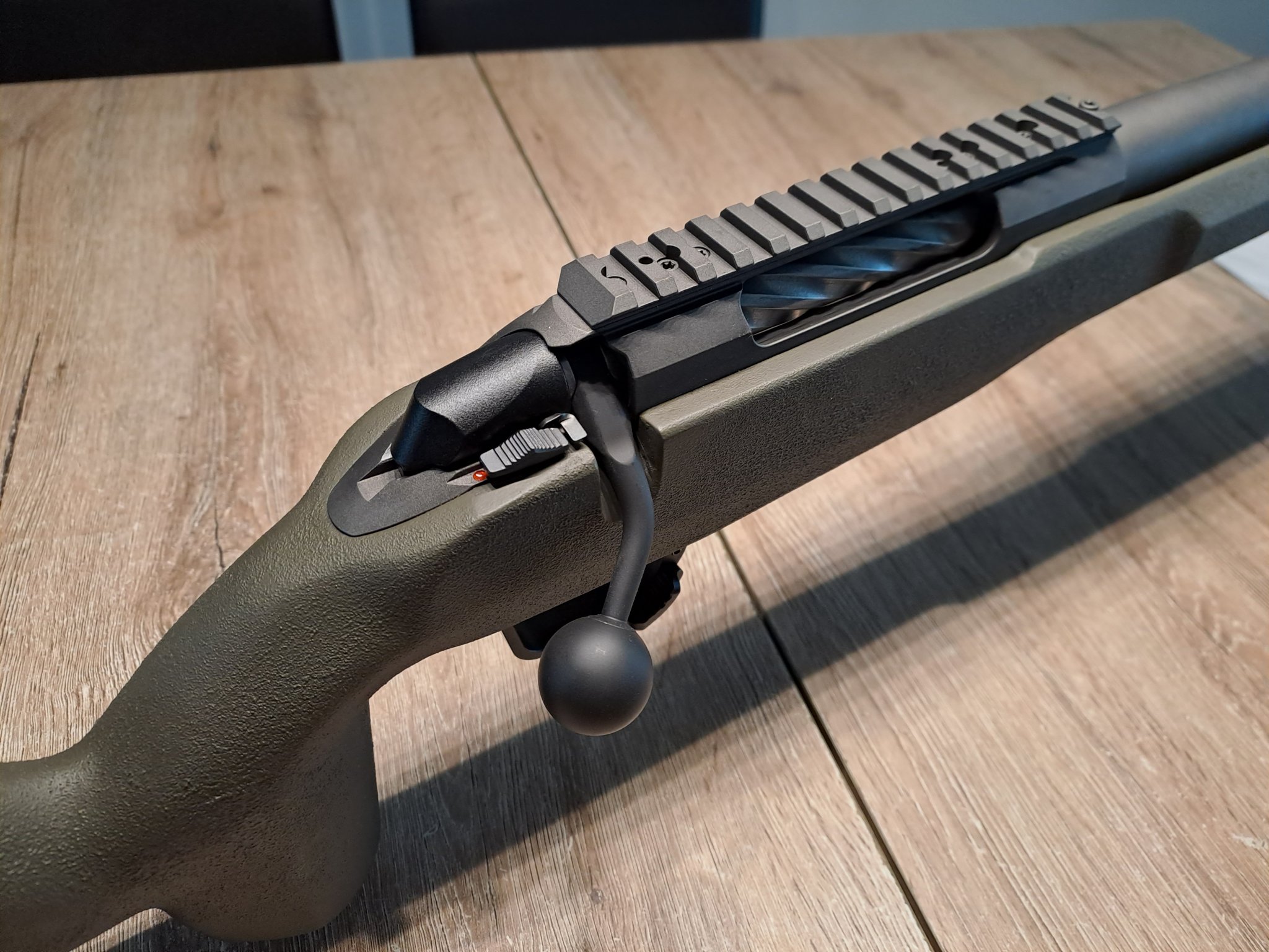

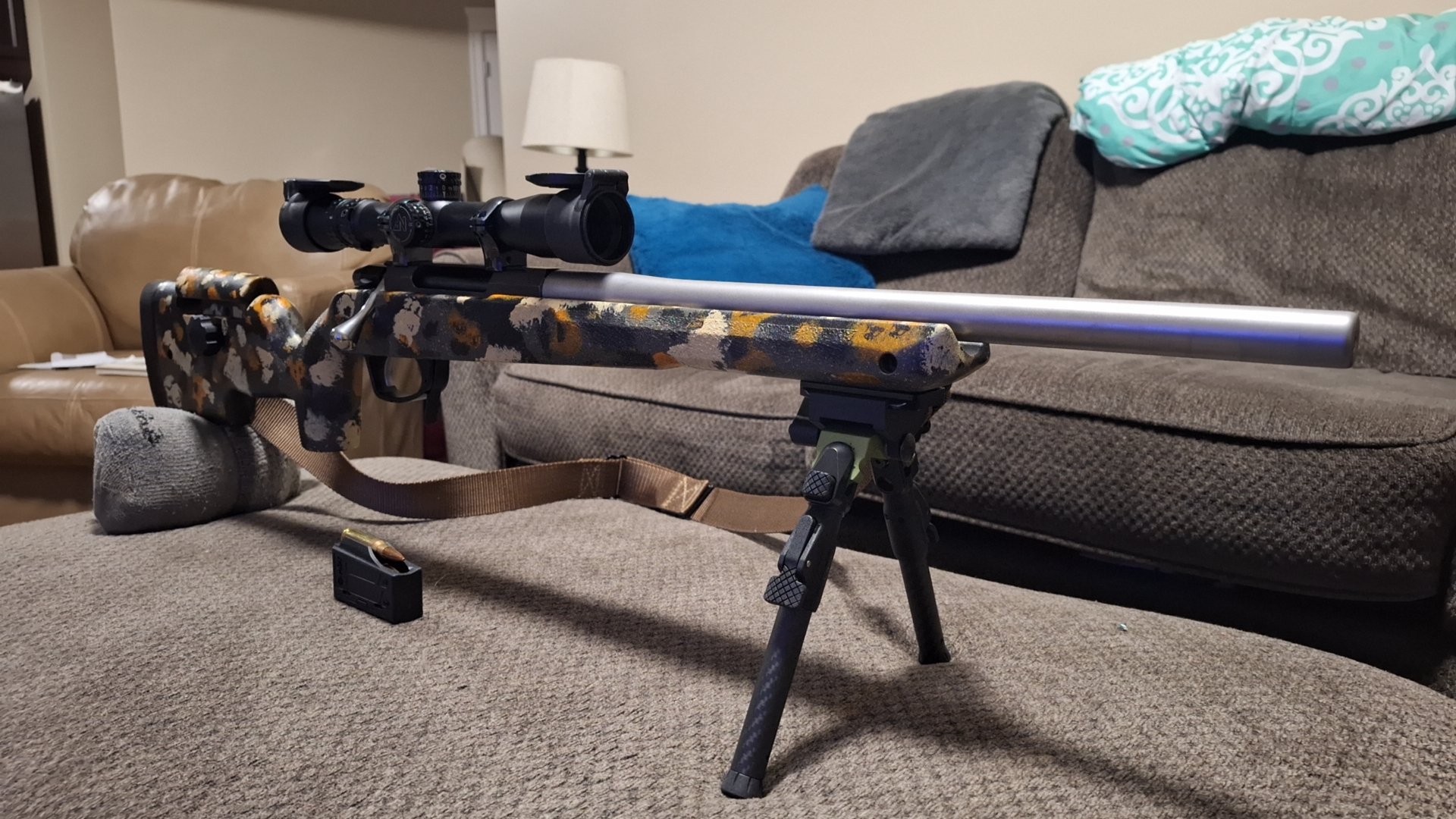

Picture of mine. Shoots sub 0,5 MOA 5 shots/100m.
Would buy again. The stock is from PSE.
Cheers
Is the structure of the stock like a regular ctr stock or beefier?
It’s stronger with more internal bracing. I have a SV. I actually quite like the stock. No reason for me to switch it out.

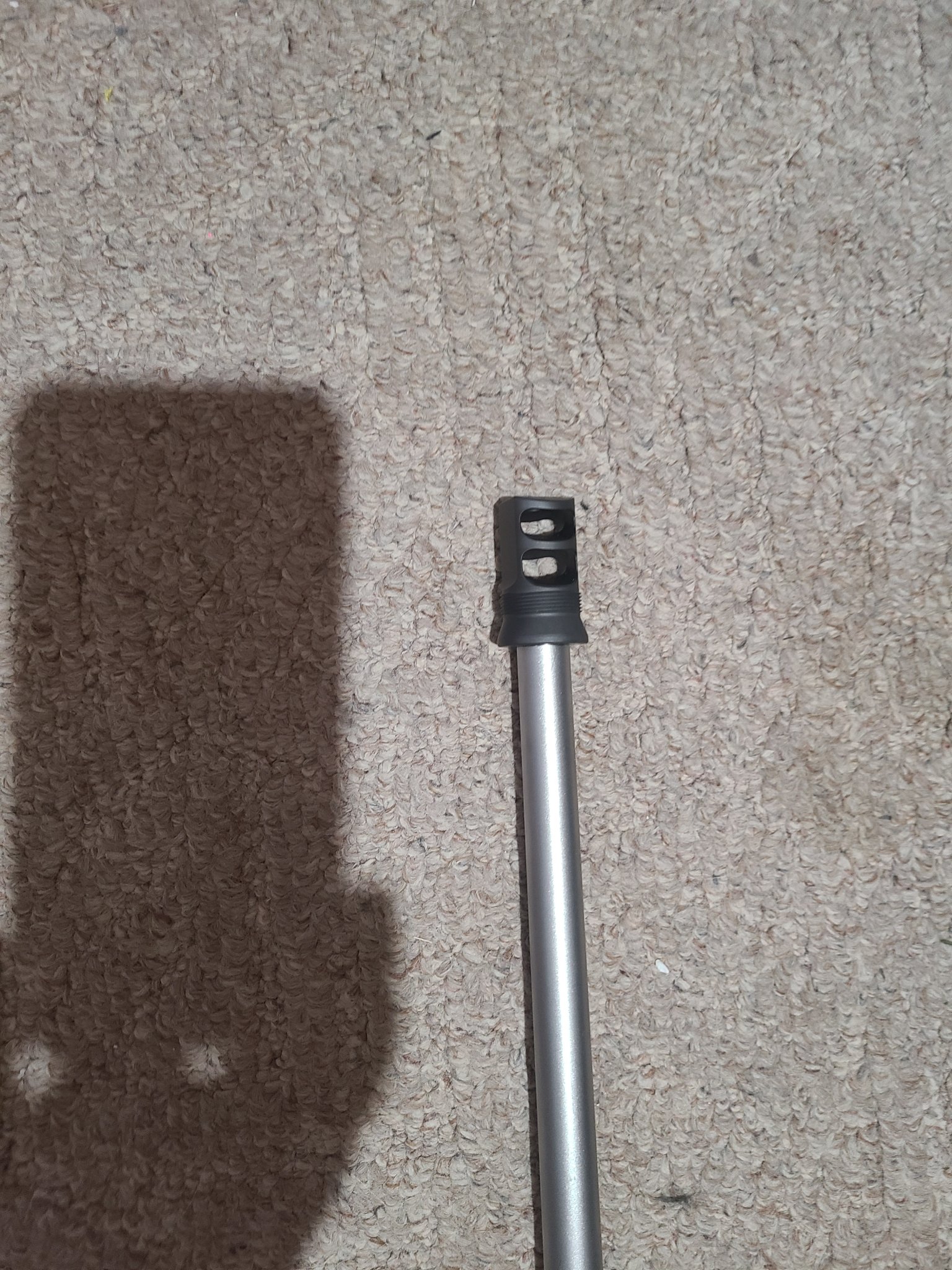

Tbac cb face mount brake on my t3x lite barrel. Sent to them for threading. Muzzle face used as shoulder. 9/16-24 thread.
Probably not the best brake but it mounts my ultra 7 fine.
Edit: corrected thread pitch. I grind 9/16-18 unjef threads at work on aerospace parts and put the wrong one down.

Tbac cb on my t3x lite barrel. Sent to them for threading. Muzzle face used as shoulder. 9/16-18 thread.
View attachment 8265914View attachment 8265916
.30 cal bore size as well?
I guess you might find someone to do it but either way there’s gonna be very little material there. It could work I guess but it wouldn’t give me great confidence either way.
Reactions: Charlie112
Correction. 9/16-24. Edited above as well.
6.5 creed. According to thunderbeast thread chart and other respected gunsmiths here they don't recommend less than 0.100" from minor diameter to groove diameter. 9/16-24 minor 0.512" and 30 cal 0.308" groove diameter. 0.102" wall thickness.
"1/2-28 threads are too small for .30 caliber. There is not enough metal between the bore grooves and the thread root diameter.
For 6.5mm (0.264") up to .30 caliber, we recommend a minimum of 9/16-24 threads.
If your barrel does not support the minimum dimension "D" in the diagram, we have a "FACE MOUNT" brake that "may" work for your rifle. Please call for details."
From this page.
