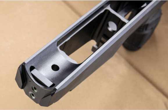

Do anyone knows, if the recoil lug on the Tac A1 sits on aluminum, or if there is plastik, or other material than steel or aluminum under the recoil lug?

Curious if anyone has actually done a tear down of the lug on a Tax A1...
FWIW a KRG chassis has steel recoil lug, aluminum back bone, and Expoxy bedding the recoil lug... I don't have specific information on the TAC A1 chassis, just keep in mind you won't be able to necessarily tell what is there by looking at it.
Thanks man. yeah, i havent been able to find a tear down of it anywhere. I know on other Tikkas, that the lug is removable, and just sits loose in the hole, but it dosent seem to be the case with the Tac A1.

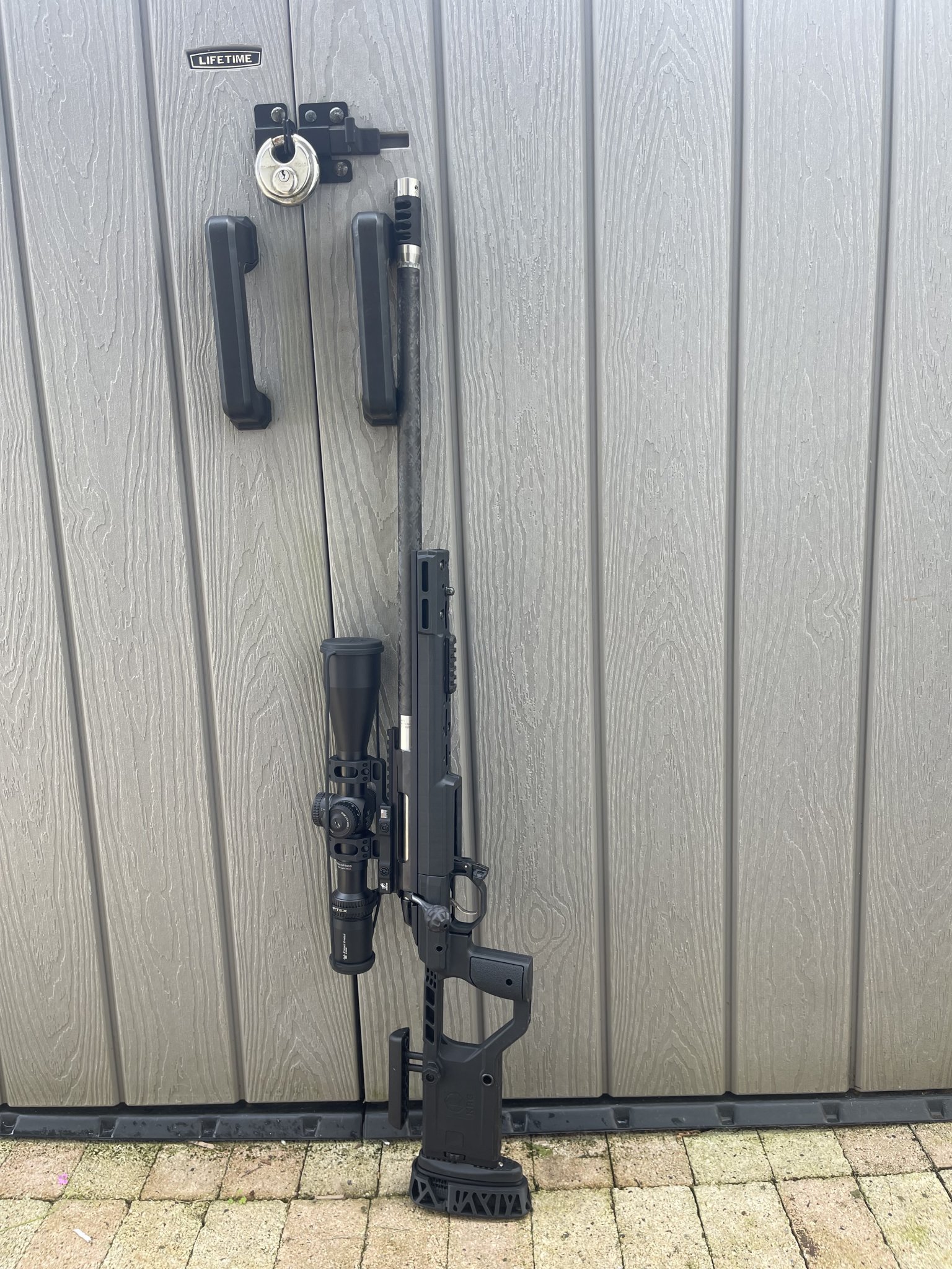

Pretty stoked on how this build came out. Ordered a 300wsm, pulled the barrel and replaced with a 6.5prc proof, added ec tuner brake, xray chassis, backfire butt pad, bolt knob insert, and a 5-25 strike eagle. Looking forward to breaking it in on Sunday and hunting some axis deer next month. You guys think it will prefer the 147eldm or the 156 Berger bullets with that barrel?
