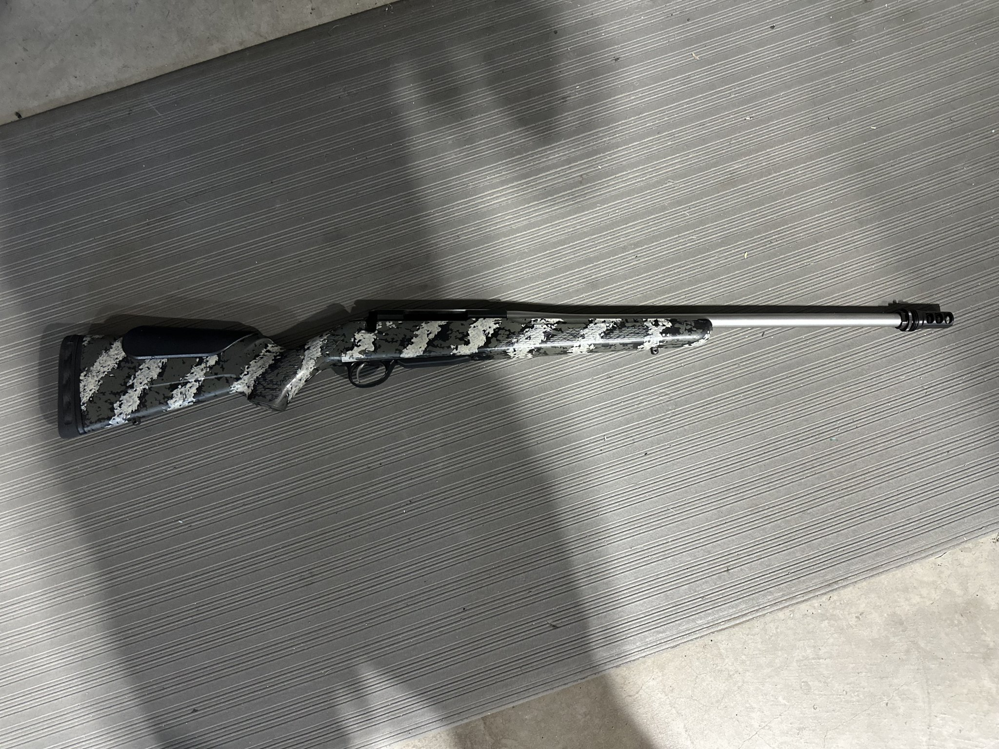

have a pic of your rifle? A friend’s roughtech rusted. why do you think yours is stainless?
The veil rifles are definitely stainless, that’s what I have. But I’ve heard the stock itself also referred to as “roughtech”. It’s dumb they make it so difficult to discern
I didn’t say anything about it being stainless, I only know it’s cerekoted… I don’t have a photo readily available, but it’s this one:

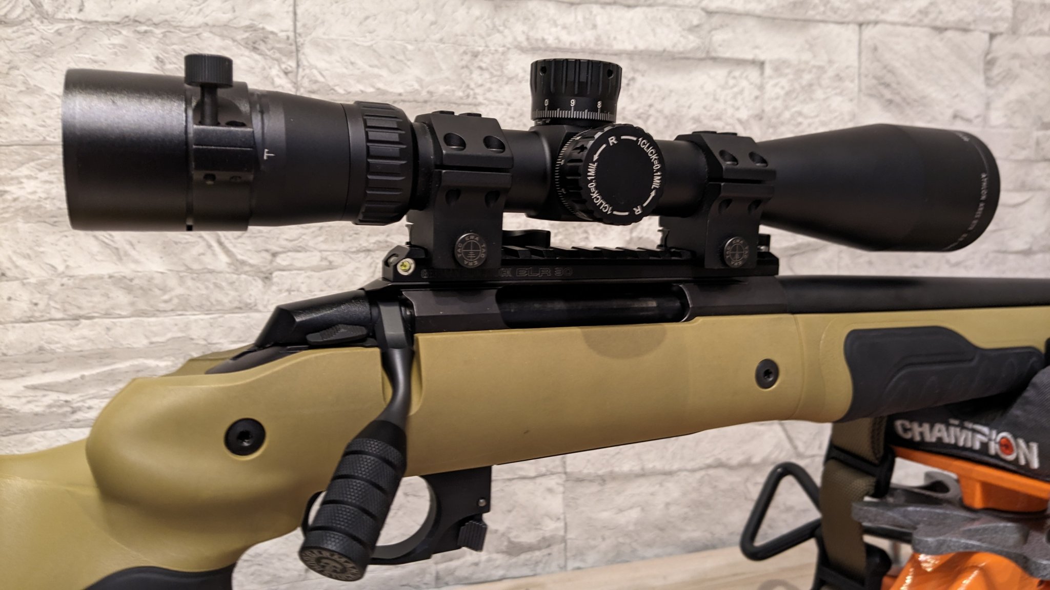

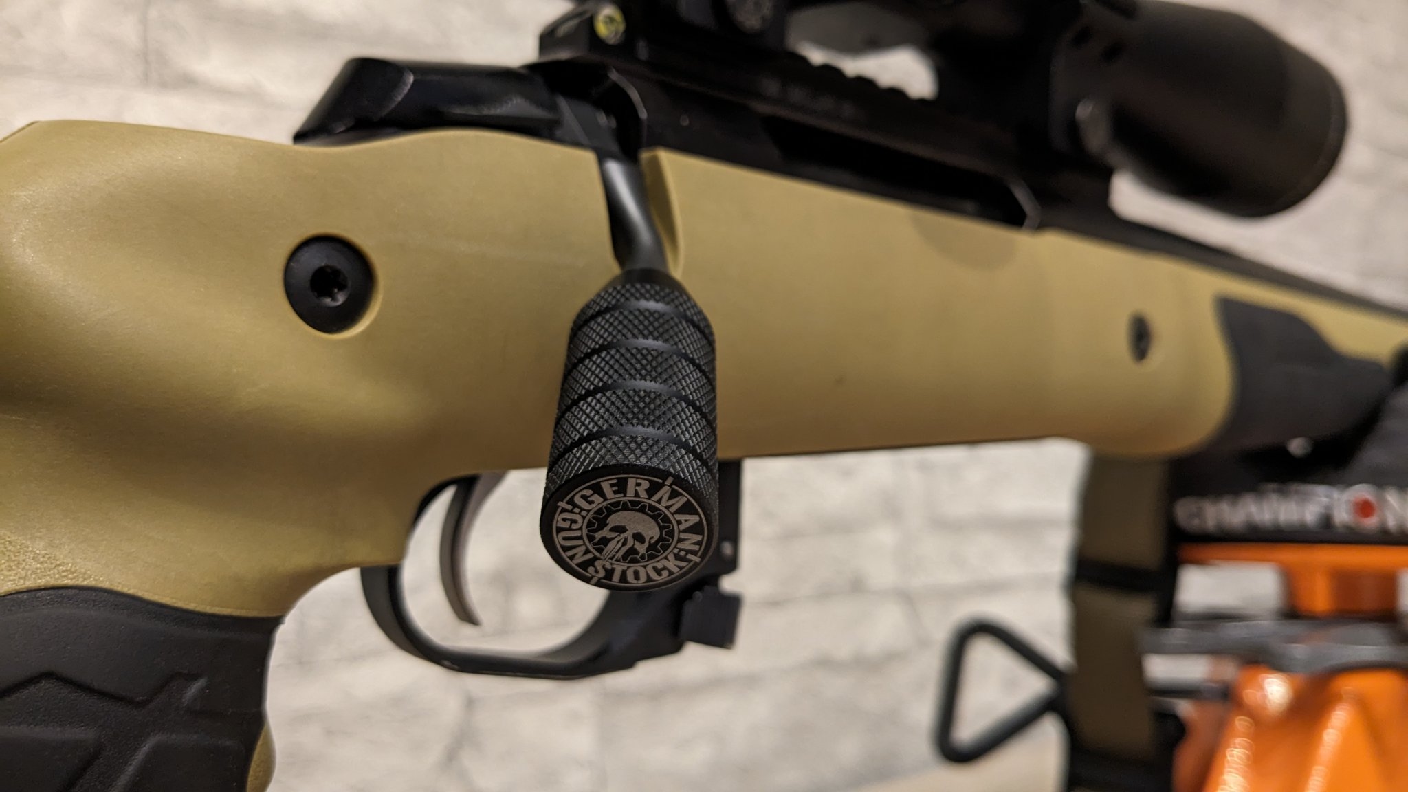

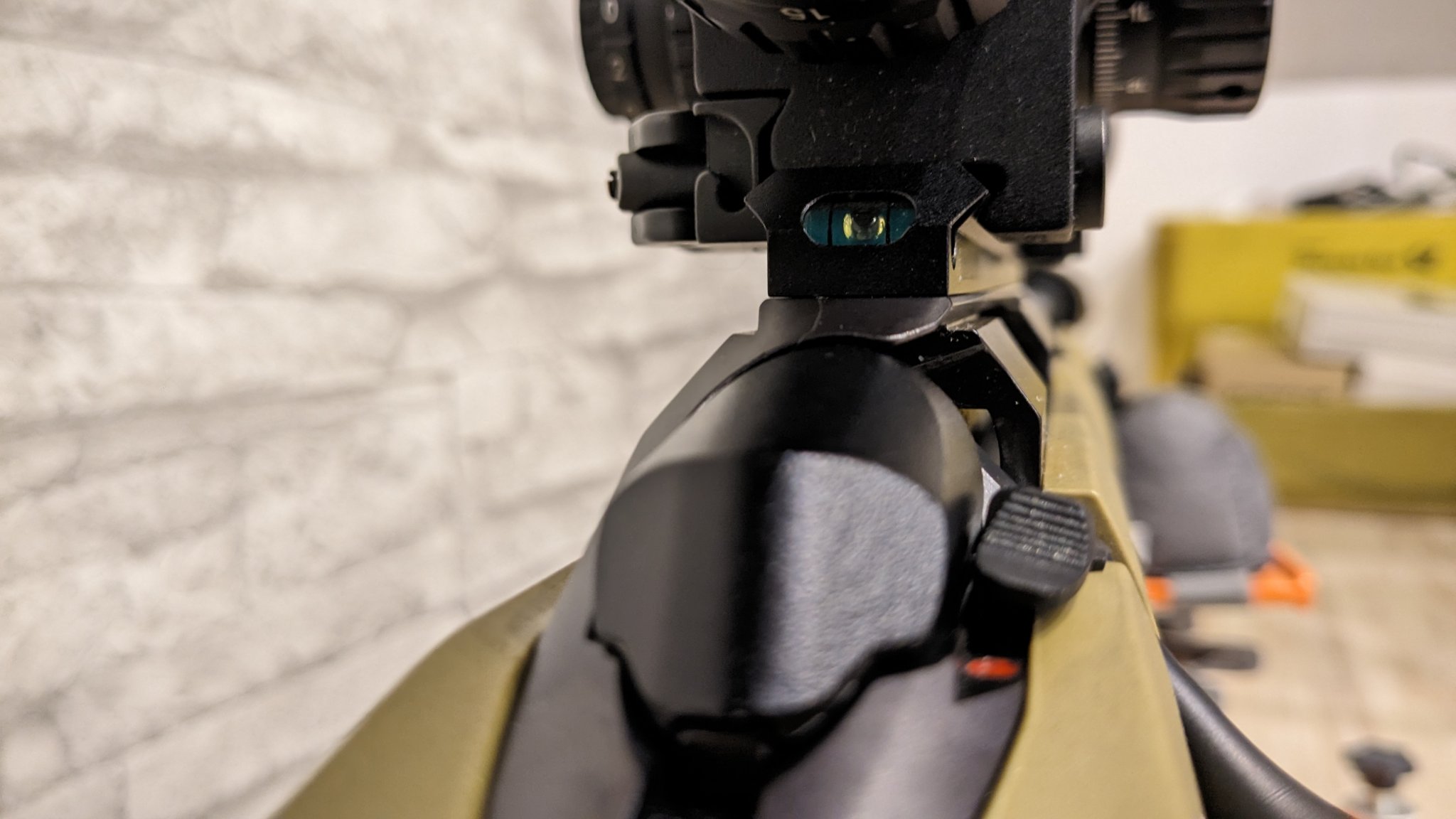

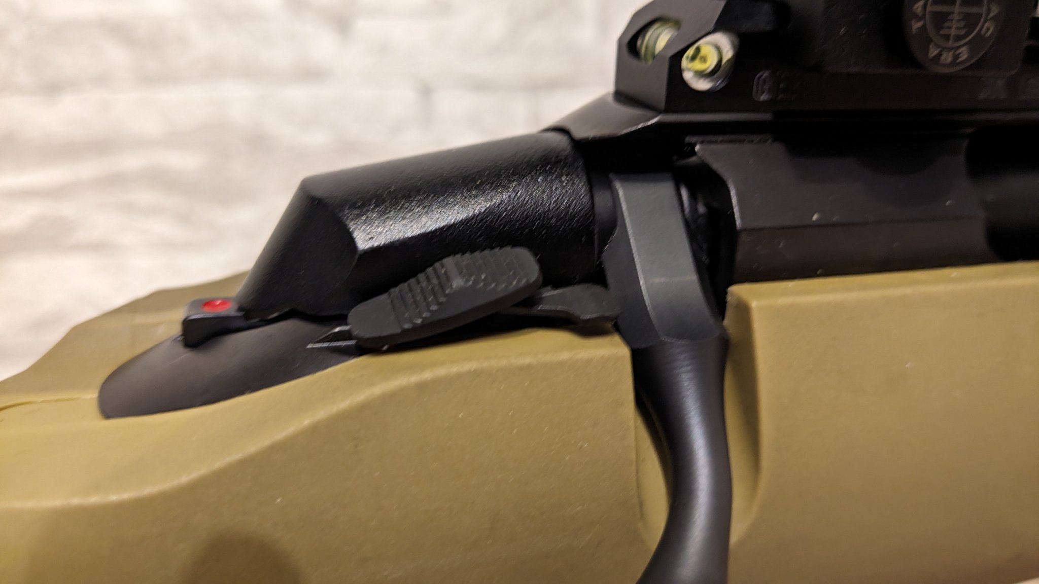

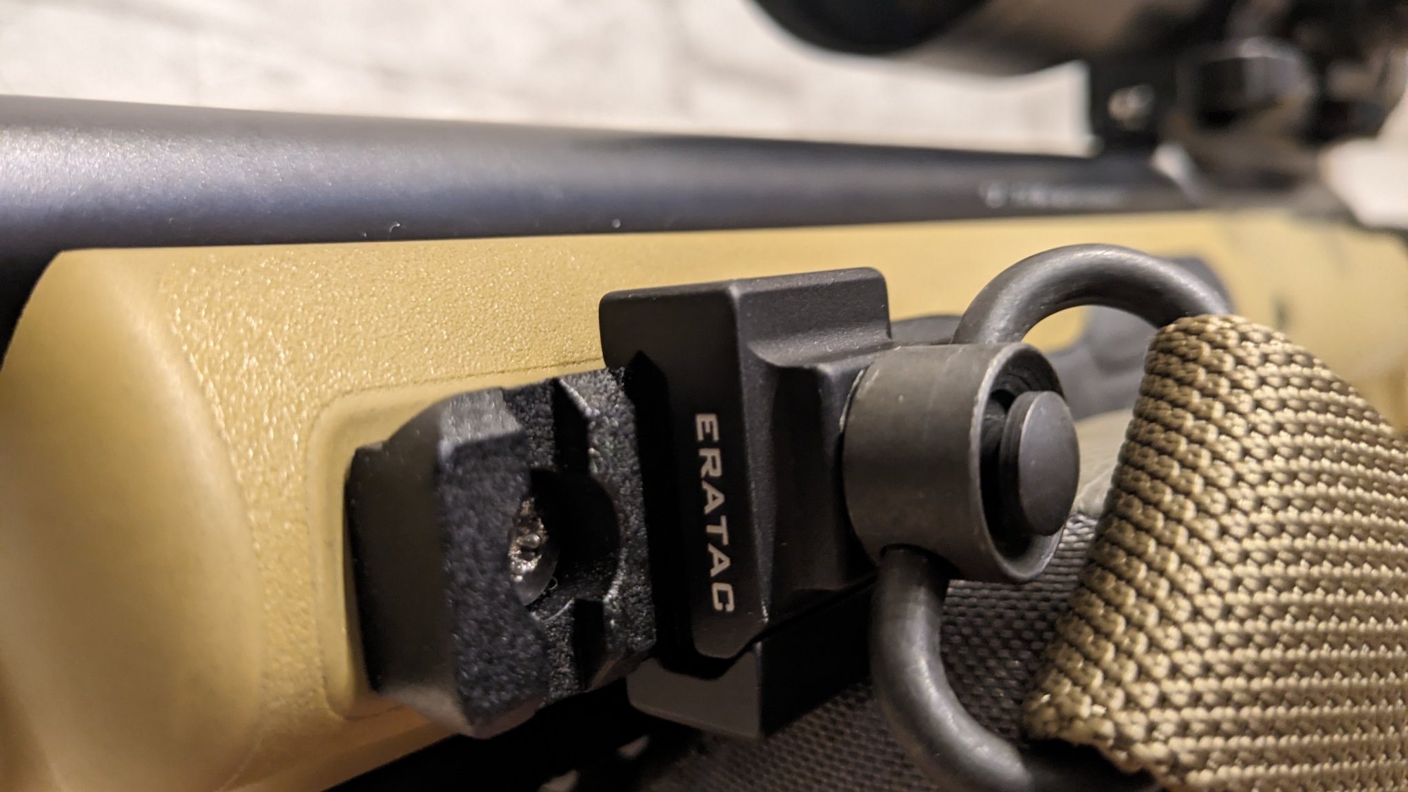

Finally the new parts for m CTR arrived.
- German Gun Stock 30MOA rail with bubblelevel
- German Gun Stock angled bolt knob
- Tikka TaC A1 Trigger double stage with 3way safety
- EraTac QD Sling mount

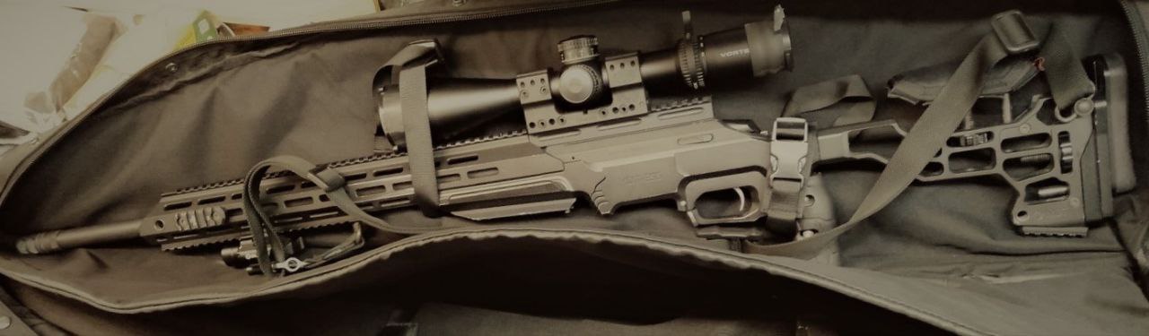

Also has anyone done a 'serious' build on the MDT LSS XL? All I've seen are budget rigs on that chassis.
I'm contemplating trying a lightish folding chassis that I can scale up and down as needs require. The HNT26 is cool but I don't think the buttstock locks in the folded position. The ESS is too heavy.
The LSS XL and XLR element are the only options for Tikka I've seen that will do what I want.

The HNT 26 does lock in the folded position.
