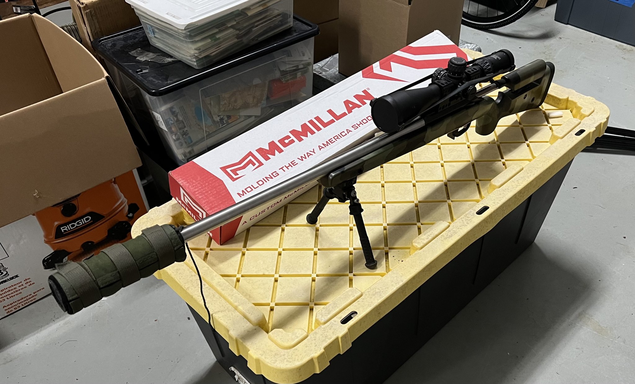

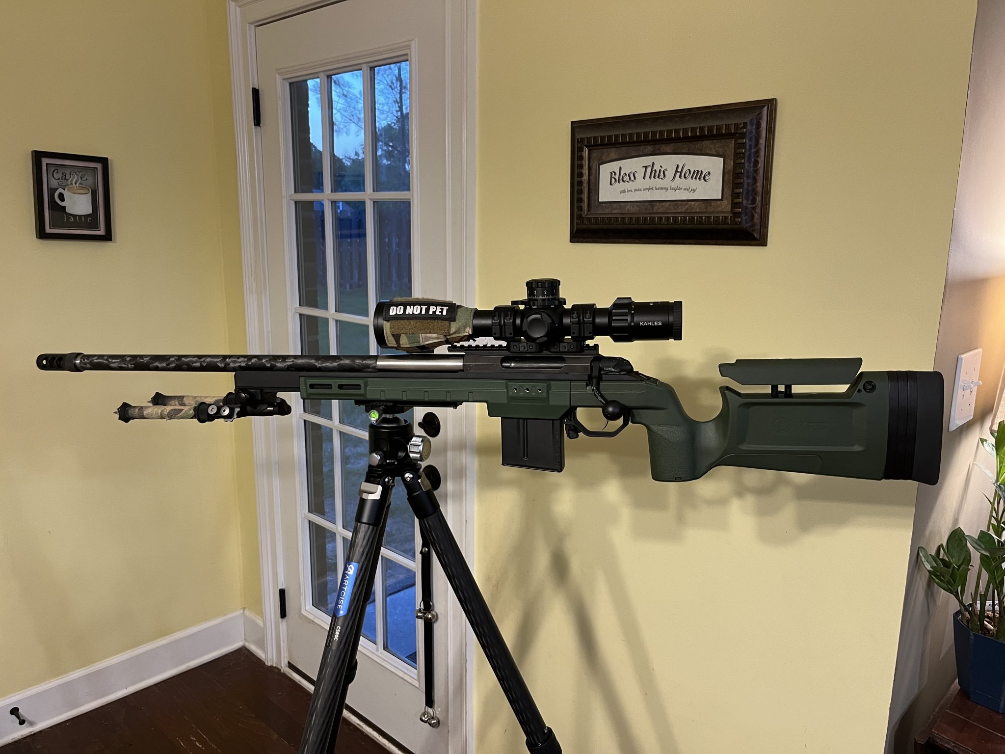

Started life as a Tac A1. Now all that remains is the action and trigger. :LOL:

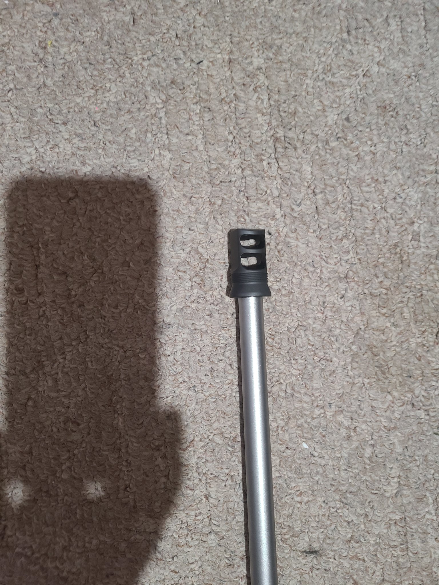

Ive got an ultra 7 on my t3x lite stainless. Thunderbeast face mount cb brake. 9/16 thread and uses muzzle face for shoulder.
6.5 creed.
9/16 thread is good to 30 cal. Groove to thread root is over 0.100" wall thickness.
Thunderbeast does not recommend 1/2-28 on 6.5 or larger on centerfires.
SAAMI specifications

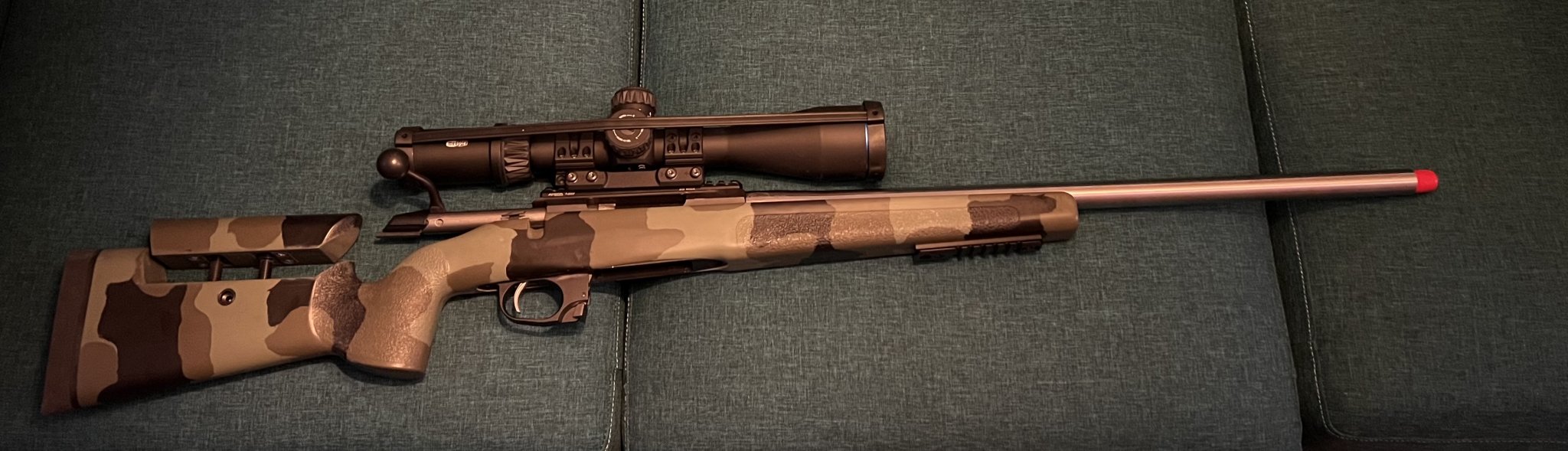

It shot well and it was a handy hunting rifle, but I’ve replaced the barrel with medium Palma so I could shoot 10-20 rounds without overheating the barrel. The barrel is one pound heavier now, but I’ve saved 1.5 pounds by switching to UPR stock.

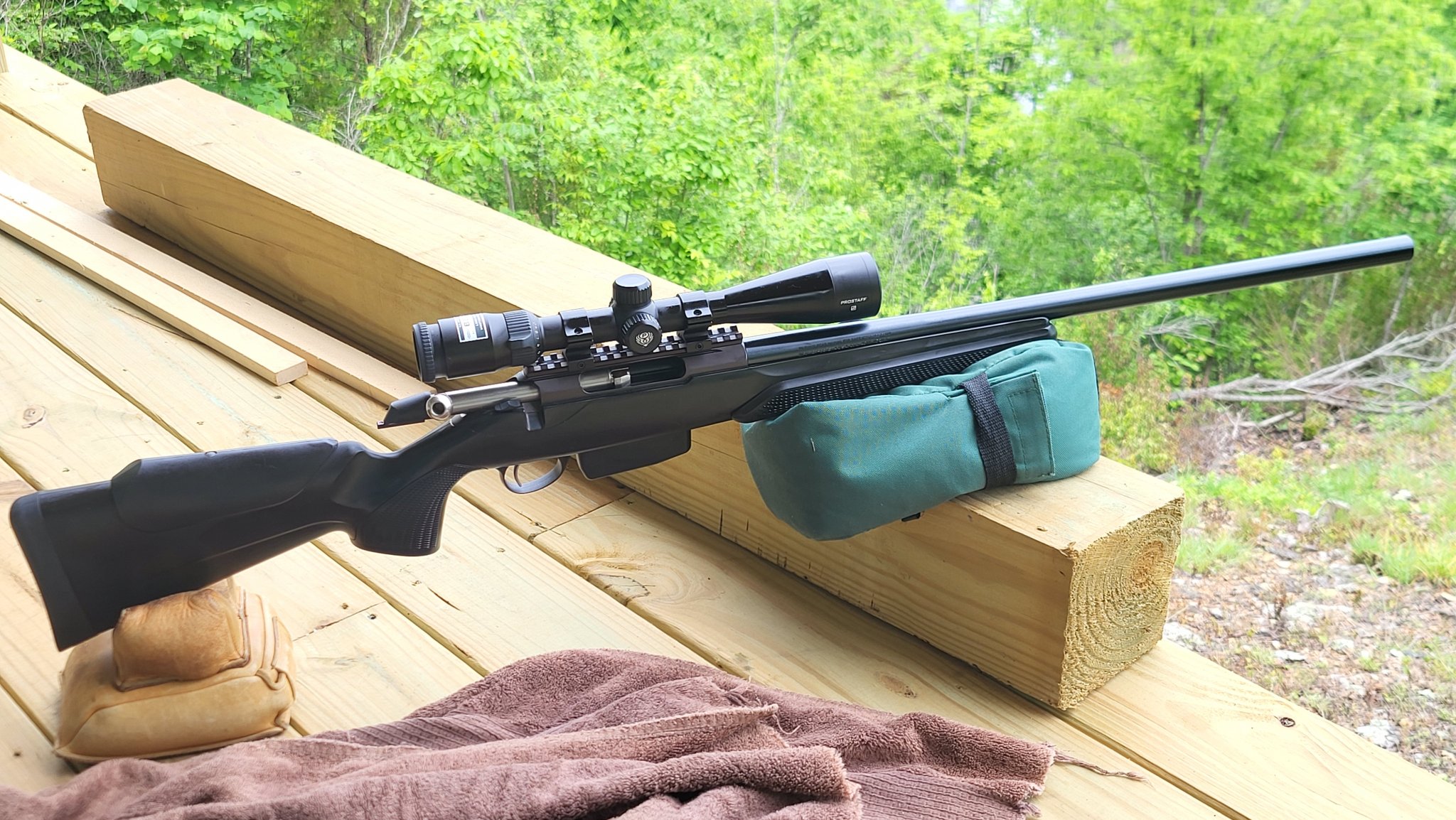

I'm new to this so be gentle. I got this 6.5 Varmint a couple weeks ago. I've only been shootin Walmart American Eagle through it and so far I'm very impressed. With less than a hundred rounds through it and a left over simple scope setup it shot .34 MOA at 100. Using Strelok I was hitting a 6" 320 yard plate a little right of center with no problem. I dialed two clicks left and moved out to a 10" 500 yard plate I went six for six. Dead center. It didn't go perfectly because after that 6, I went 0 for 5 at a 8" plate at 620. I couldn't make adjustments because the plate is infront of a dark woodline. I went back to swatting the 500 to end on a high note.
I'm having lots of fun with a bone stock rifle. I still haven't shot in proper style so I look forward getting better results. Thanks for letting me share.
Nothing better than a gun that likes cheap available ammo. Awesome shooting spot.
