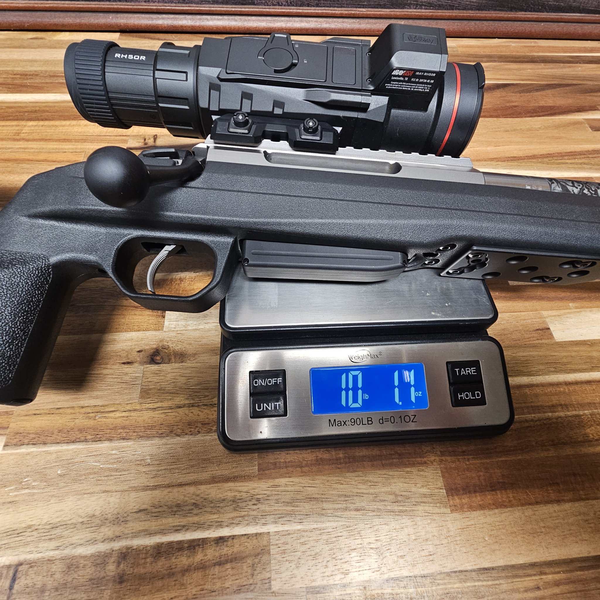

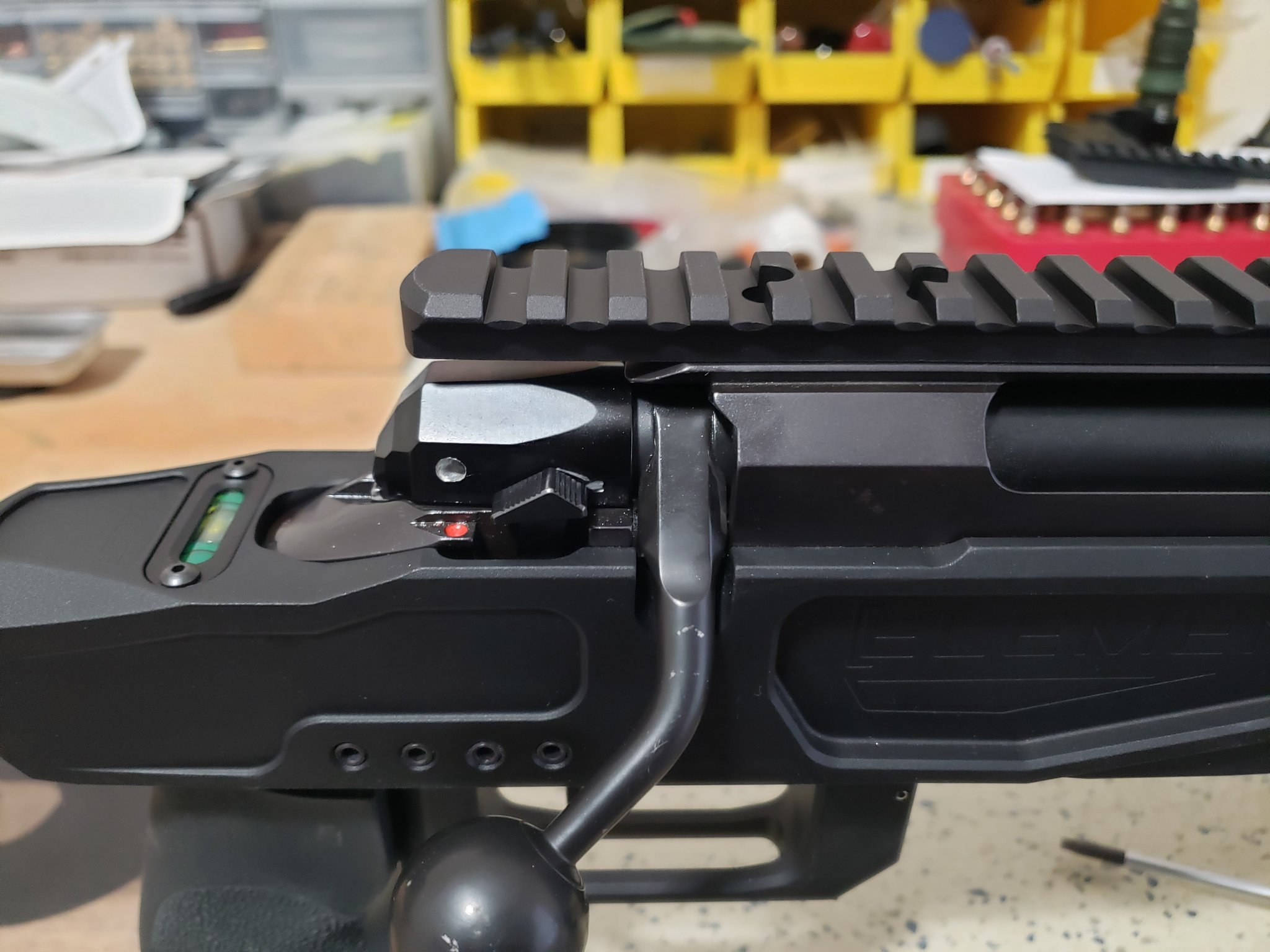

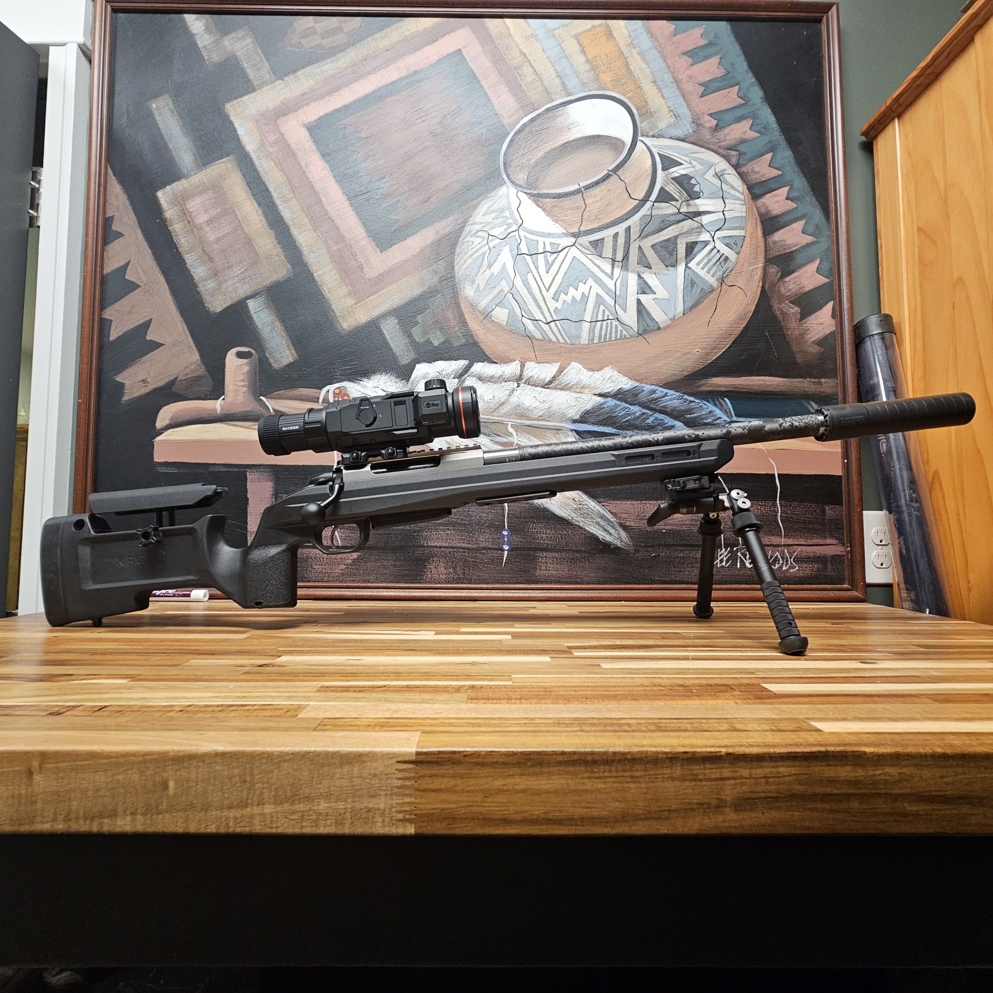

I put together a thermal rig last night, 308Win Proof prefit. This action has the factory CTR 0MOA rail, and ejected brass is hitting the optic mount no matter where it's placed. Does anyone know of a rail option that's taller than this, besides the hideous MDT ESS rail? I tried a 20MOA EGW rail and it's better, but not quite 100%.
This is what I did.
Buy the cheap EGW rail (without a recoil pin) and mount it backward. It will move the optic more rearward so you aren't climbing the cheek piece. That should move optic enough out of the way.
If it's still hitting, get a cheap brass deflector or make one out of kydex that will attach to pic rail.
Very nice. Did you fit the proof yourself?
How did you find that process to be? Not too bad?

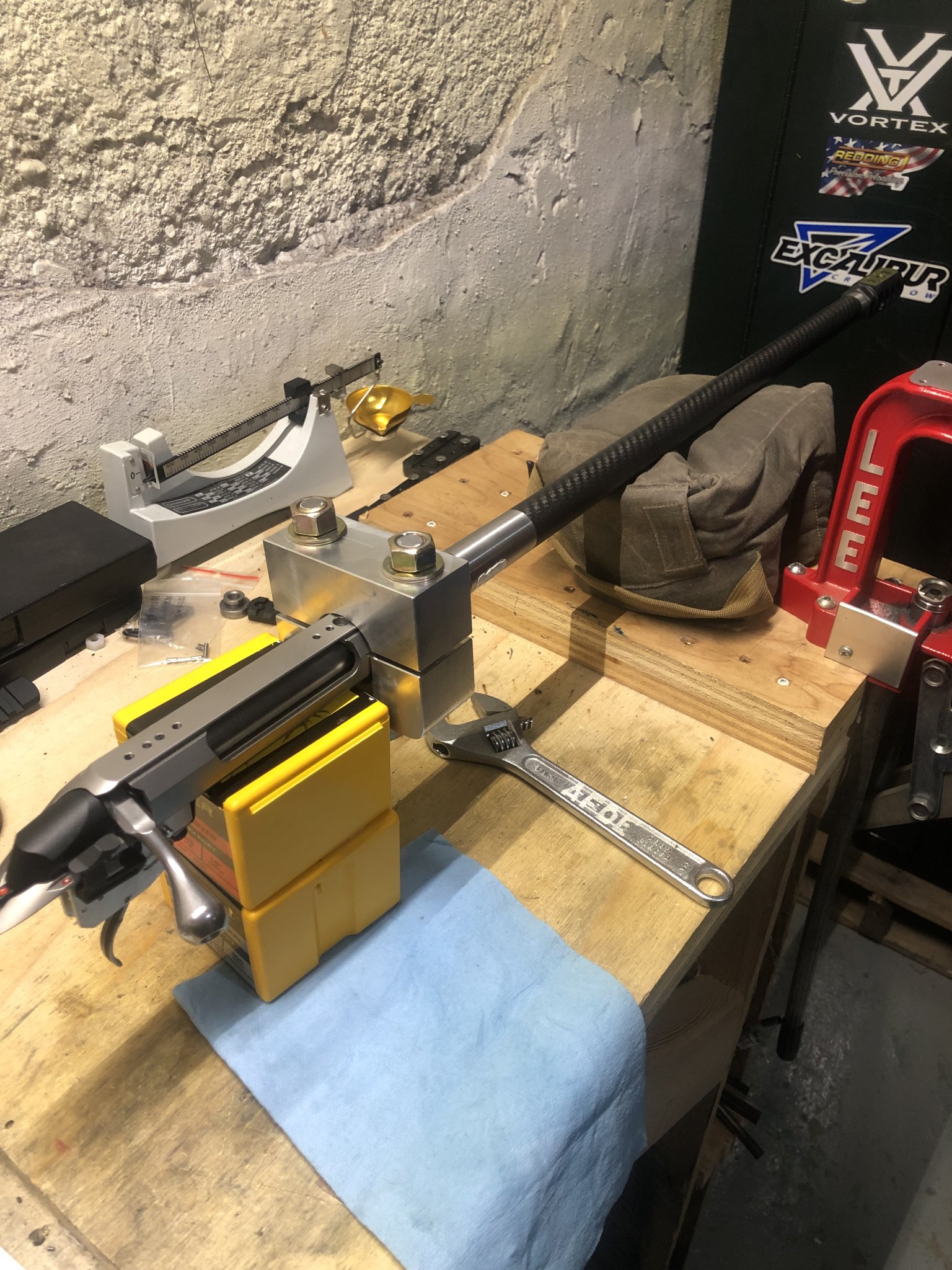

It was alot easier than I thought it would be. Started out with a 6 5 Creed CTR barreled action, read every thread on the Hide about Tikka barrel removal, gave the shoulder/action and tenon/action junctions a Kroil bath for 2 days, strapped it into a SAC barrel vise as TIGHT as I could, installed a Wheeler #1 wrench finger tight, gave it 2 smacks with a mallet and it gave up. Proof barrel install was nothing, tightened to 80 ft lbs, checked head space and zereod. Wish I had done it sooner!
How does the proof shoot vs. the factory barrel?
It shoots as good as the factory barrel, I'd say. I did the change for weight savings mainly. I saved over a lb and a half in barreled action with the switch. I also went from 20x day optic to 640 core thermal image when I switched barrels, so it's hard to say. I probably should throw a day optic back on to check, but I've been happy with the Proof 16in. as it is. I run the cheap AAC Sabre 150gr load thru it from Palmetto State for night hunting, and it'll stay on a 10in. plate at 450yds all day, which is plenty for where we night hunt here.
Edit to add: Pic is three 3 shot groups at 100yds.
Also an update on this issue: I installed a 20MOA Area 419 rail to gain a little height for my optic, and ended up grinding a small angle into the forward optic mount lug that sits over the ejection port, and although spent cases still barely hit it on the way out, ejection is 100%.

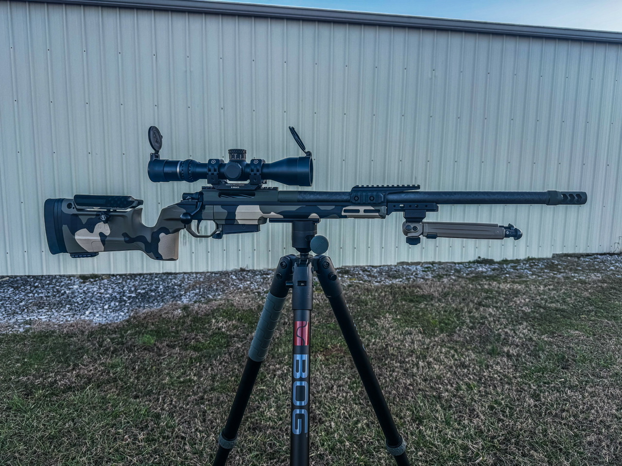

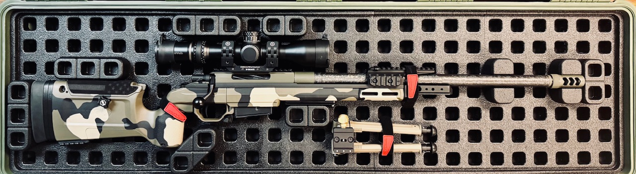

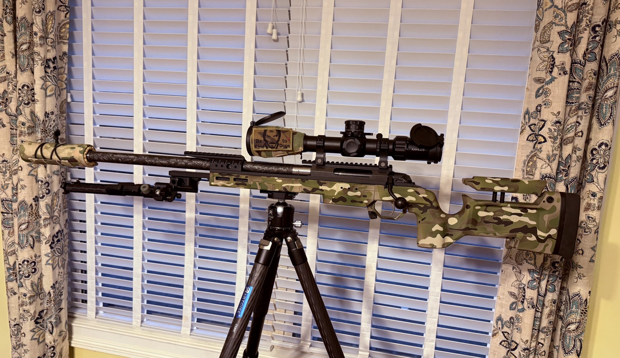

Just finished this build.
Tikka T3 Action
Timney 2 Stage Trigger
A419 20moa Base
A419 Hellfire Brake
Anarchy Outdoors Swept Bolt Handle and OMR Bolt Shroud.
6.5 PRC 1:7.5” Proof Sendero 22” machined and cerakote ODG by Meredith Rifles in Athens, AL.
KRG Bravo with ARCA Spigot and EFR Bridge cerakote by Custom Gun Coatings in GAP Camo.
Magpul Bipod w/ A419 ARCA Clamp and KNS Snapfoot.
ARC MBRACE 34mm/1.26”/0moa Scope Mount.
Burris XTR3 3.3-18x50 SCR2 Mil Scope
Weight is 12lbs exactly without bipod and 13lbs with, unloaded with empty 3 round magazine.
Case is a Harbor Freight Apache 9800 (Pelican 1750 Clone) with a Magpul DAKA Grid System.
