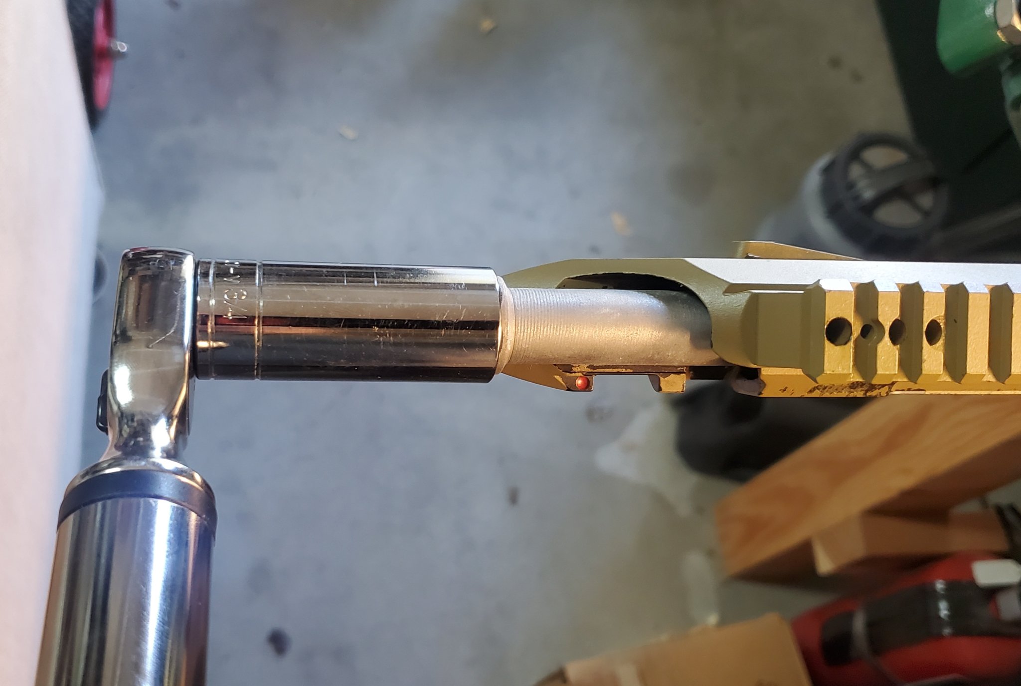

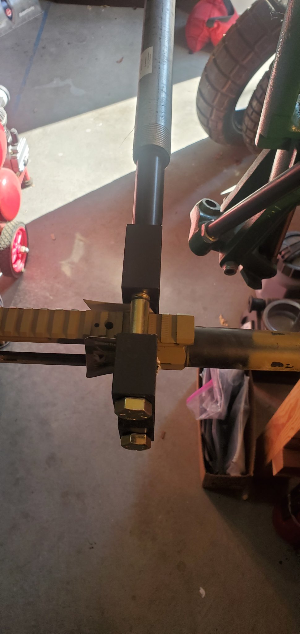

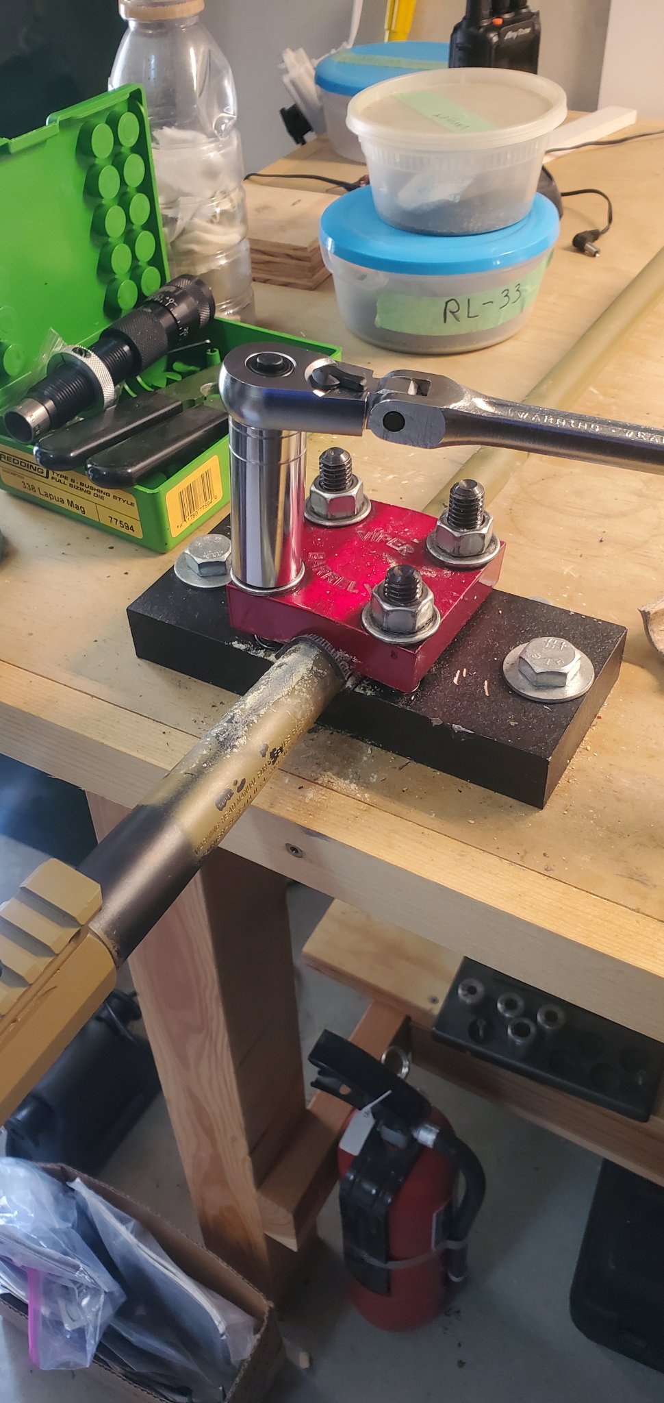

I took off another Tikka barrel from a Tac A1 action. Minimal fuss, the key is prep work, patients, and torque.
1. Prep work: Once action and barrel are removed from the chassis hit the barrel joint inside the action and the outside of the action with penetrating oil like Kroil or WD40. Have the right tools, a Tikka action wrench is not enough to get a barrel off, for that job you need a wheeler action wrench that has flat sides. Make sure you got a good barrel vise and some rosin powder.
2. Patients: I like to sit the barrel vertically in a sink and let the oil soak in for days, turn the barrel the opposite direction and soak again for a day or two, let gravity help that oil seep into that joint, hit it several times with oil to make sure it's penetrated. Once the barrel is removed from the action you will notice the threads saturated in oil, it really gets in there if you give it time.
3. Torque: Once you are ready to take the barrel off make sure that the barrel is really snug in the barrel vise, use some cardboard as shims to avoid marring, and rosin sprinkled around will add to the grip the vice has on the barrel, you do not want slipping. Some extended heavy steel pipe that fits over the wheeler handle will be crucial and add to the torque you need in order to remove the barrel, i'm guessing it takes about 225-250 ft lbs to remove a tikka barrel, just a hunch. So make sure to have that cheater bar/pipe to add to that torque. Remember the flats of the Wheeler should be evenly torqued on to the flats of the action, not too tight though, card stock or business cards can be put in between the wrench flats and the action to avoid marring. Sometimes a wack with a rubber mallet can help add some shock to loosening things up.
Remember if you try to use an internal tikka action wrench to remove the barrel you could destroy the action if you use over 200ft lbs of force. A Tikka internal action wrench is great for putting barrels back on as you only need between 75-90ft lbs and that pressure is no danger to the action.
All these things combined and a tikka barrel will pop off, it's a little work but it avoids any cutting or need for a gun smith, and you get to keep your original barrel in tact.
View attachment 8645638View attachment 8645639
Is there a reason you didn’t get the vise closer to the action? Im getting ready to do this on a lite for the first time. I have a SAC vise and wheeler wrench.
Reactions: ranger43
Like, slightly over finger tight. Tight enough so it won’t slip off the flats, then stop.
This is the point I missed when I tried to remove a Tikka barrel. I had cranked on the bolts holding the external action wrench onto the receiver.
Ruined the barrel, messed up some threads in the receiver. D’oh!
The Tikka barrel has a more extreme angle by the action due to the profile, so I try to grab an area that has the most grip and fits the barrel vise the best. You want as much surface area to grab as possible.
Reactions: trob and jLorenzo

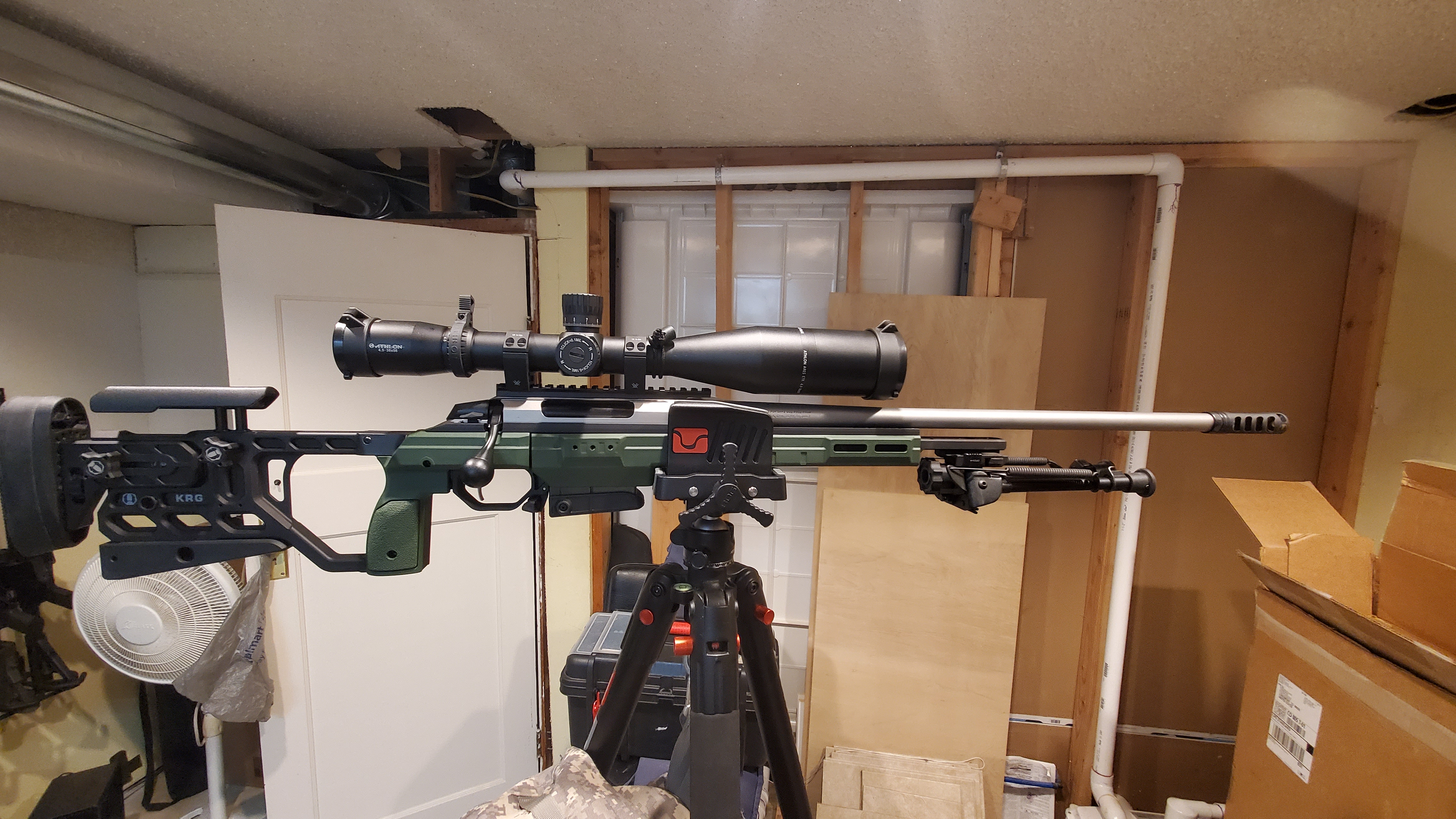

Stock standard GRtech SuperVarmint in .308Win. At this point I've walked around 12km already. This was the only shot for the day. I had all the confidence in the world knowing the shot would land precisely where I aimed.
I have 2 Tikka's now and don't regret either. I am probably one of the few that stil have them in the original stock.
That stock is great, especially for what it looks like you're doing. Even the CTR stock is fine for off hand shooting.

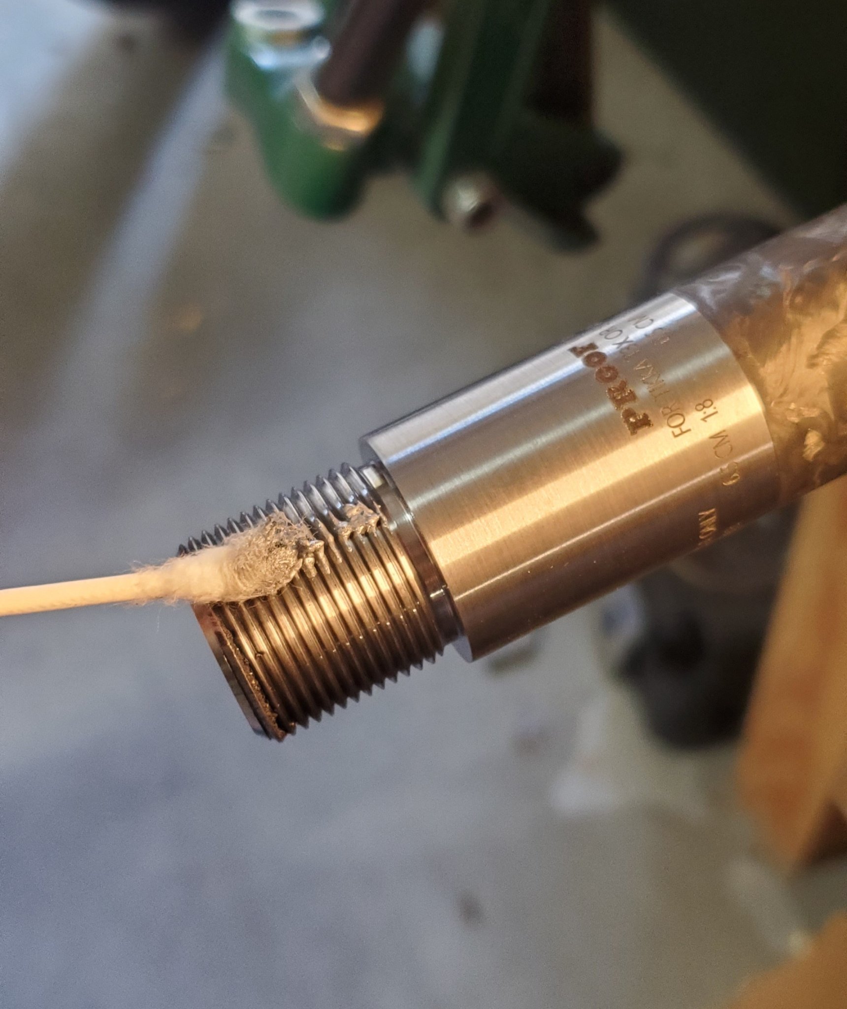

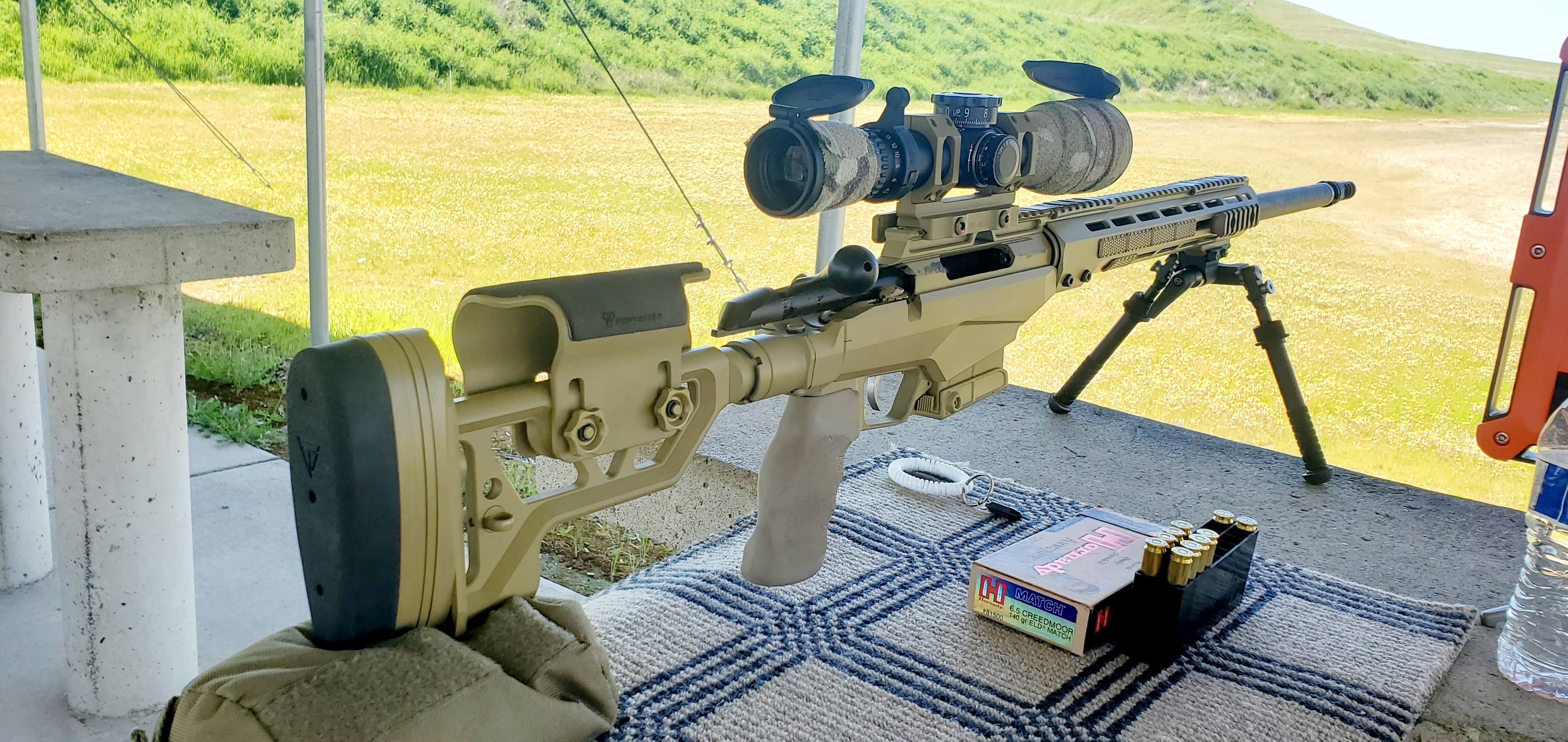

I finally got the new Proof barrel on and took the Tikka to the range to break the barrel in, I got some interesting results that I will share in another post.
When swapping barrels out I can't stress the importance of using a good torque limiting wrench like the ETork, or Summit Tools 3/8 or 1/2 drive. I prefer a digital one that alerts you when you have hit your desired torque setting. This way you will not mare or destroy the inner ramps of your action. The other thing I recommend especially if you are mating a stainless barrel to a hardened steel receiver is some metal based anti seize, this should be used sparingly. This will be important in my case as I plan on removing the barrel at some point for another round of Ceracoat to the receiver. After the anti seize is applied work the action back and forth a few times to make sure the threads get an even coating, then the barrel will be ready to be torqued on. I torqued the barrel to close to 90ft lbs, this is more than enough torque to make sure the barrel is good and tight, won't come loose when firing, yet will come off with minimal effort when the time comes.
Reactions: Sossa

"I prefer a digital one that alerts you when you have hit your desired torque setting. This way you will not mare or destroy the inner ramps of your action."
How much torque is required to mare or destroy the inner ramps of the action? How much is too much.
The ceiling on the inner part of the actions is anywhere from 175-200 FT lbs from what I have read, but I do not know for sure. This is when using the Tikka action tool, not when using a wheeler which applies the forces on the outer flats of the action. If you stay under 100ft lbs it should be all good.
From what I understand is when the barrels are installed at factory they use a hydraolic press and the action if put in a special chuck that protects the action.
But I am just a guy who tinkers, don't take my word as gospel, I am just relaying what I have researched and what has worked for me.

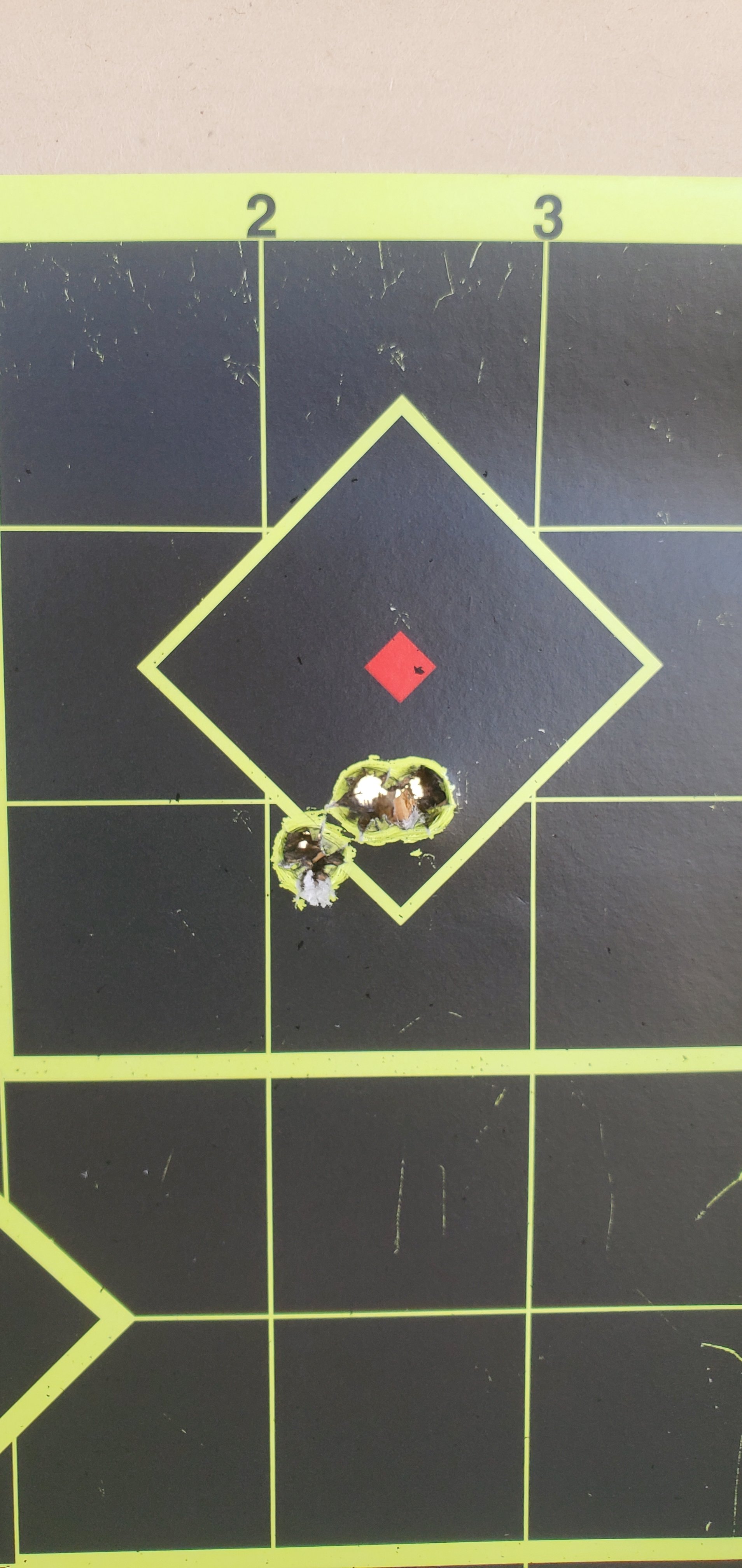

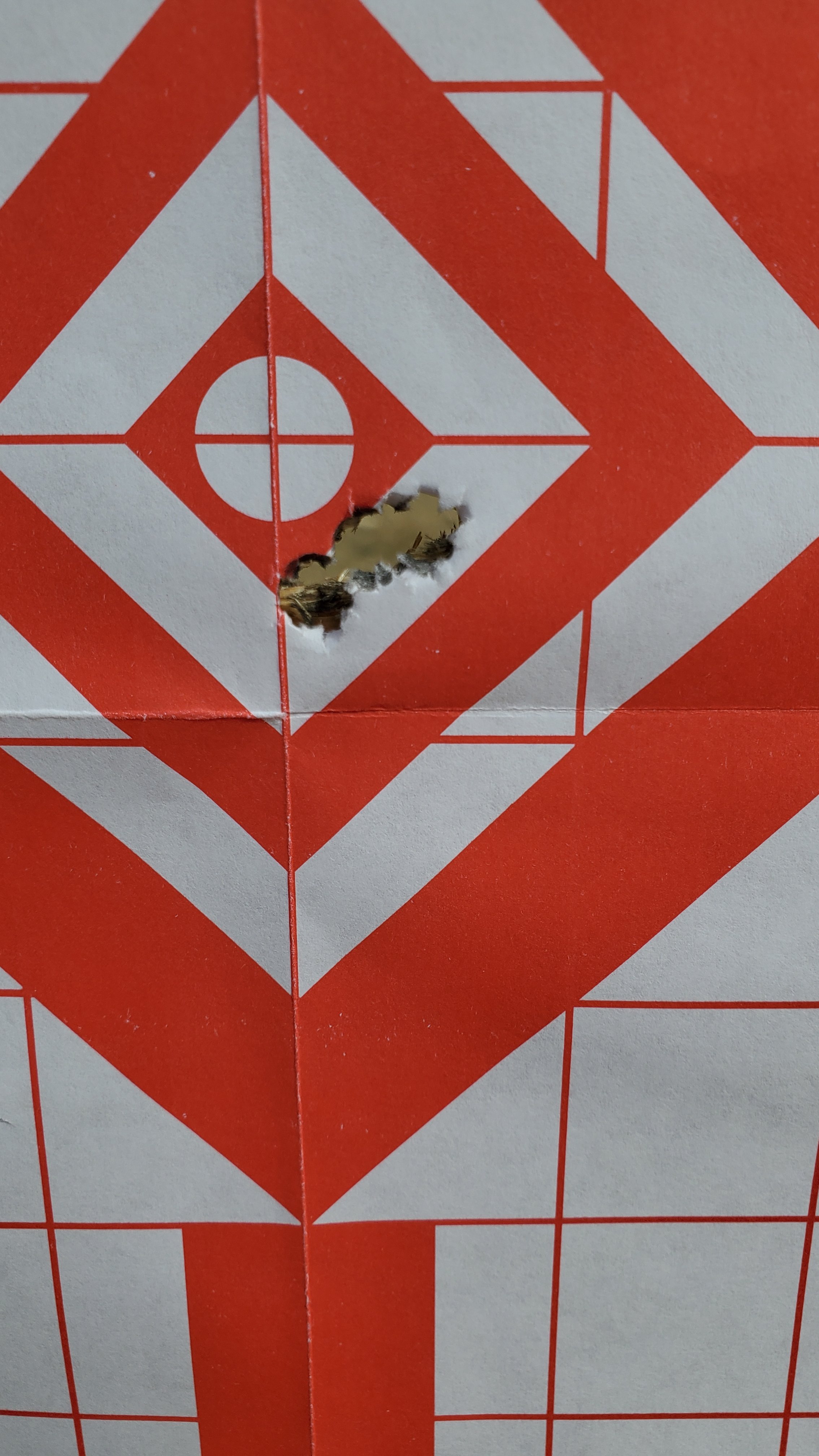

Proof barrel update. The proof barrel shot well but I don't think other than it being lighter it's all that much better shooting than the stock Tikka t3 heavy profile barrels. I was able to get some 1/2 minute groups with 140 ELD but that is no different than how the Tikka was shooting prior with the stock barrel. I did shoot a little 120gr and it seemed deadly accurate, couldn't see where I had shot at one point but the impact was perfectly where I wanted to place the shot, sometimes you get lucky, kinda funny, given that I should probably explore more 120gr in that barrel.
Nice but why did you stop at 3
Makes no sense to shoot more, I rather shoot several 3 shot groups as well as few shots at longer range. Also we prefer 140/143gr for hunting and rather get them to shoot. I have spoken to several gunsmiths who have in the meantime also seen the sense in 3 shot groups for initial testing. If your second shot is a flyer the group is not going to get better with more shots. I prefer to evaluate every shot. Just about all of my rifles shoot well at 100m, more important is to test/tweak the drop chart as most of my deer are shot between 200 and say 600m .
edi
We had a Proof prefit fitted to a T3 which loved 123gr Nos CM. 3 shot group. Did not like 140 ELDM as much initially but after a few shots she settled in and is under 1/2" with them as well.
edi
My super crazy load is 139gr scenars, amazing in a 24" tikka barrel. It's interesting but loads that work for the stock barrel behave the same in the proof barrels, harmonics must be very similar.

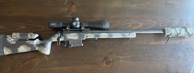

6.5 creed stainless CTR in W3.
Seeing what I can do with the factory barrel this year, will get a Bartlien or Krieger m24 at somepoint. Waiting on the heavy arca rail and 2 round quiver and I think I'll have the chassis dialed.
