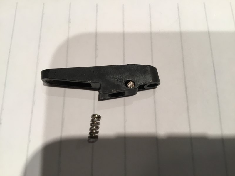

Busted Bolt Stop Pin...
Thanks for posting the photo, I double checked my bolt stops with a magnet and both are magnetic - if you were unsure if plastic or not. I think Tikka would have way more problems if they made the stop out of plastic instead of steel/metal.
There are a few aftermarket bolt stops on the market so i'd check out one of them to replace it.

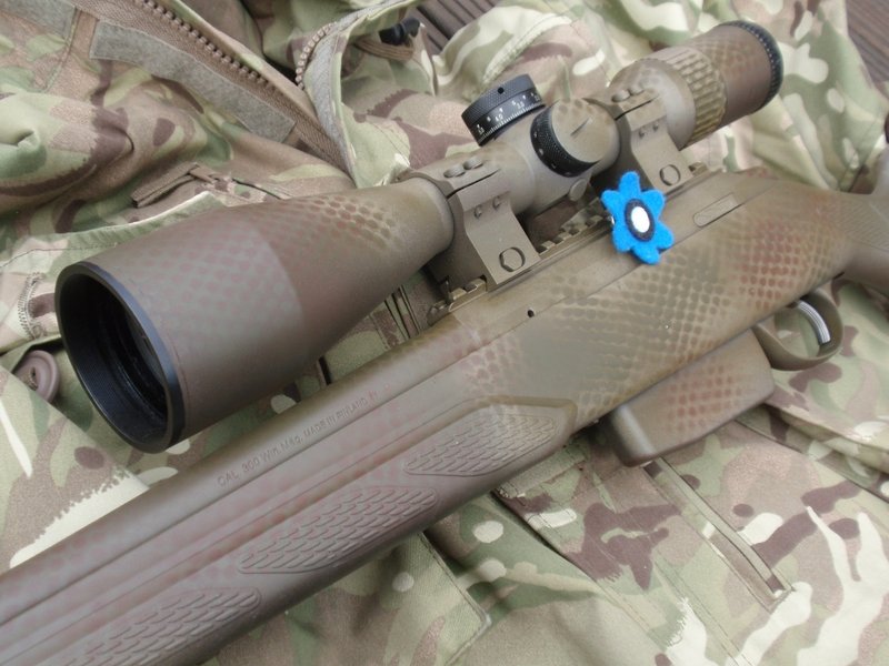

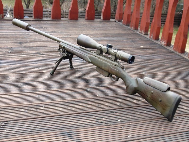

Previously I have a Tic Tac in 300 WM I got 7 years ago and I am happy with it. Keeps sub-moa at 1 km, in factory condition (I mean the original stock). I've shot it mostly suppressed, or sometimes plain barreled (no brake, don't fancy these very much). But it does kick, a lightweight as it is. Pics are of it.
What I bought was a new Tac A1, 308 Win with 20' barrel. Now there are some curious things. First, in this part of the world the rifle comes with only one magazine, not 2 or 3 you get and I did not get any bipod stud (MLOK or other). But the main surprise came to me in the way that all rifles are not equal. What I mean is that the Tikka declares everywhere the barrel as medium profile with imperial muzzle thread (AR10 basically), regardless of the barrel length. But at the store the usual 24' and shorter 20' did not look the same to me. Turns out the shorter one is a MIL version with the barrel from TRG (OD of 22 mm IIRC at the muzzle) and it's M18x1 muzzle thread. Same as my old TicTac. So yeah, if I can choose, that's the one that came home with me. Now I have to get a bipod and scope on, and we're golden. Lapua's 175 grain Scenar should run just fine through it.

Bought my second Tikka at the end of last year.
