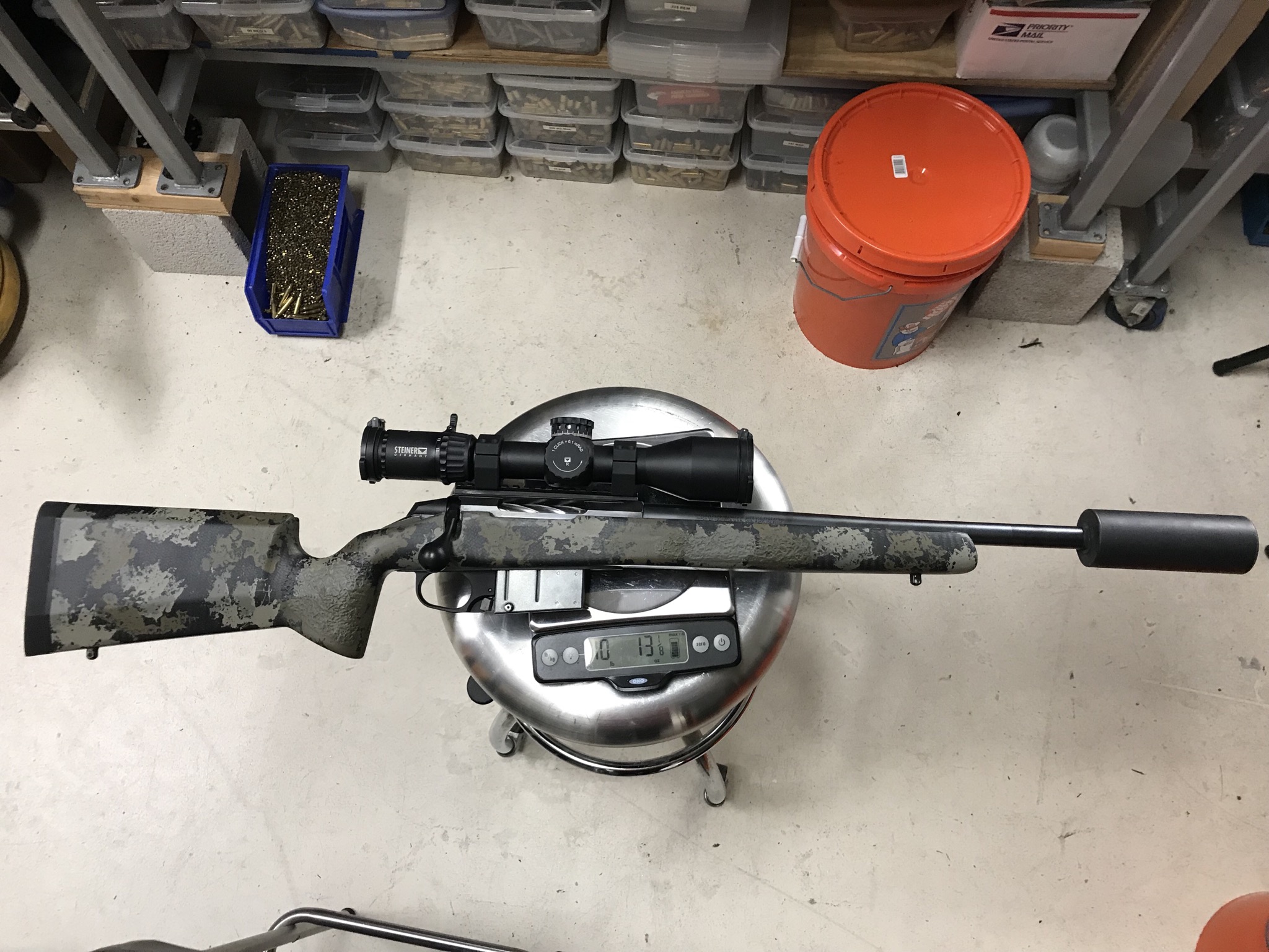

First ever semi custom build.
Tikka T3X Lite action
27" 7 WSM Carbon Barrel
XLR Carbon Chassis with Tac Lite buttstock
And Carbon swept bolt handle
180 ELDMs are shooting sub MOA right out of the gate at 3080 fps and with the 23.5 MILs I have to work with now that I am sighted in with the Vortex AMG it should be able to get them a ways out there :)
8.75 pounds for just the rifle and chassis...10.9 pounds scoped.

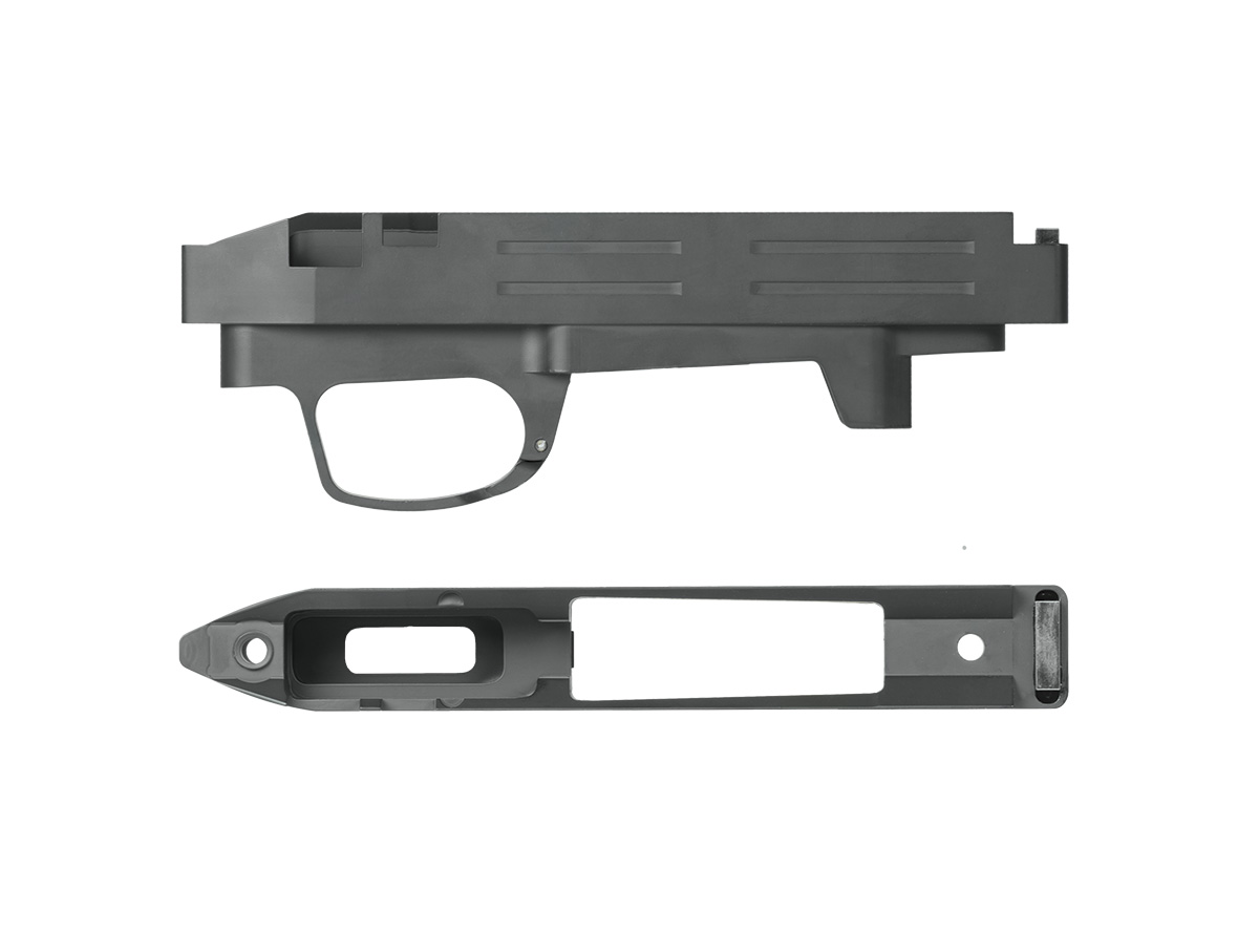

My 30 Nosler build on Tikka T3x using our TRG
magazine compatible bottom metal to run Berger 215 hybrids at 3.50”. Looking forward to getting this scoped and starting on load development

• Bottom Metal: RedSnake nEXTgen TRG Bottom Metal

That is sexy!
Are you guys gonna do a short/med action version for long .223 - 6mm projectiles or will the long action version work with those too?
and, where did you get that bolt handle...... because if you make them, start selling them!
That is sexy!
Thx. I’m very pleased with how it turned out. No immediate plans for short/med action DBM.
Bolt knob is from PTG and put it on a handle I had turned to match the contour.

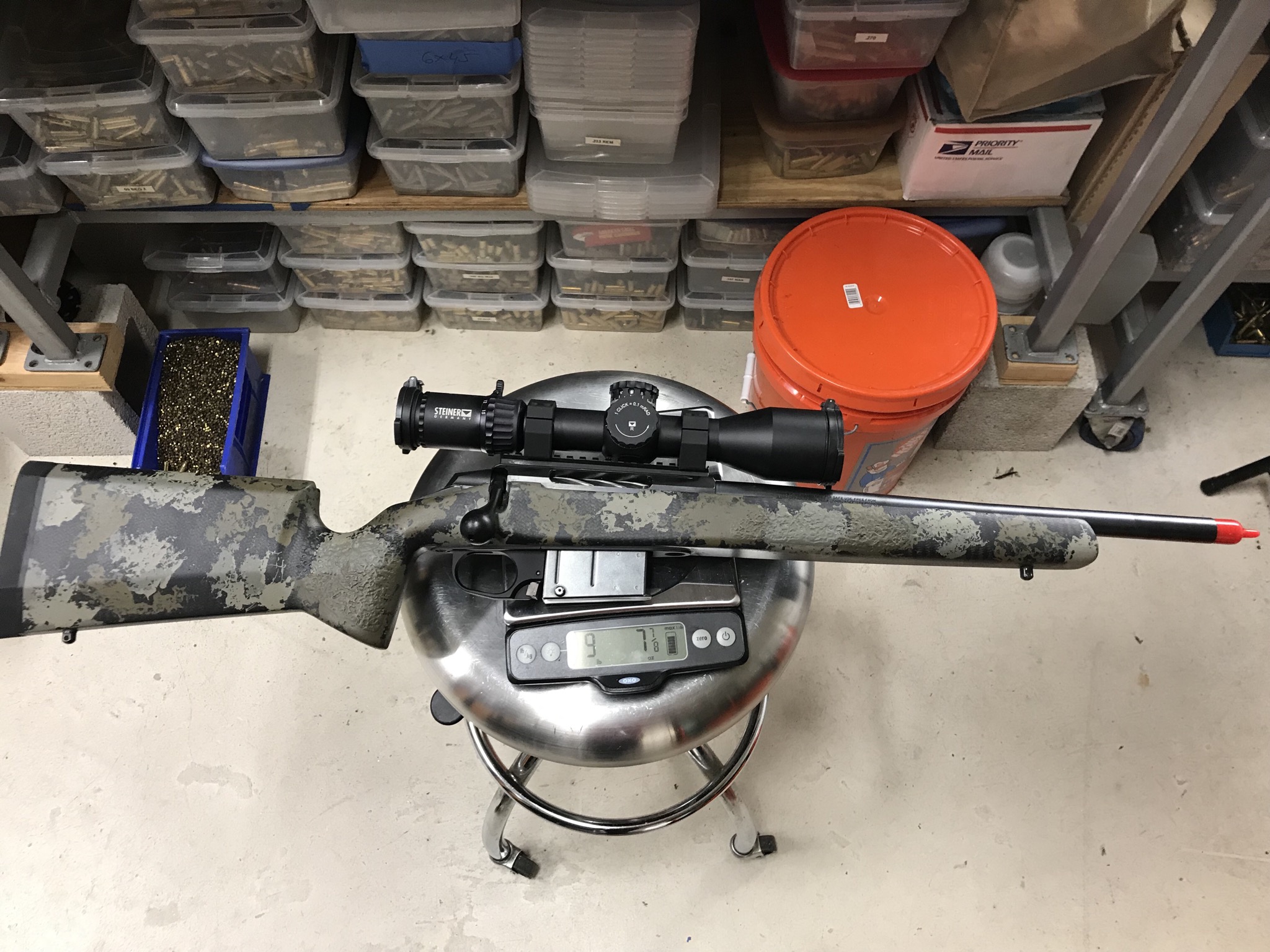

Not sure what happened to my post so I will try it again.

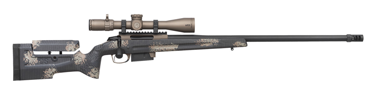

New products 2018 – If at Shot, please stop by and take a look Booth#20005
New MCS-DBMTK mini chassis systems
Manners Composite Stocks is proud to introduce the new MCS-DBMTK mini chassis systems. It has the same basic features as our standard MCS-DBM Gen2 mini chassis but is designed to work with all Tikka actions chambered in short calibers. When combined with one of our bulletproof stocks we consider this a true bolt in and go system It comes standard with a precision ground stainless recoil lug and a AI style 5 round magazine. It features a low-profile ambidextrous mag release and an extended mag well. Also we are offering this in a CTR version called the MCS-CTRTk mini chassis, it has all the same features but is designed to use your factory ctr bottom metal and mags. To fit these new mini chassis we are rolling out two new stocks made just for these systems. First - a special high tang version of our MCS-PRS1 stock designated MCS-PRS1TK, Second - a version of the MCS-EHA stock designated MCS-EH1TK.
( shown below in new prs1tk stock in scorched-earth camo pattern - designed to show 70% carbon fiber then 15-15 of colors )
