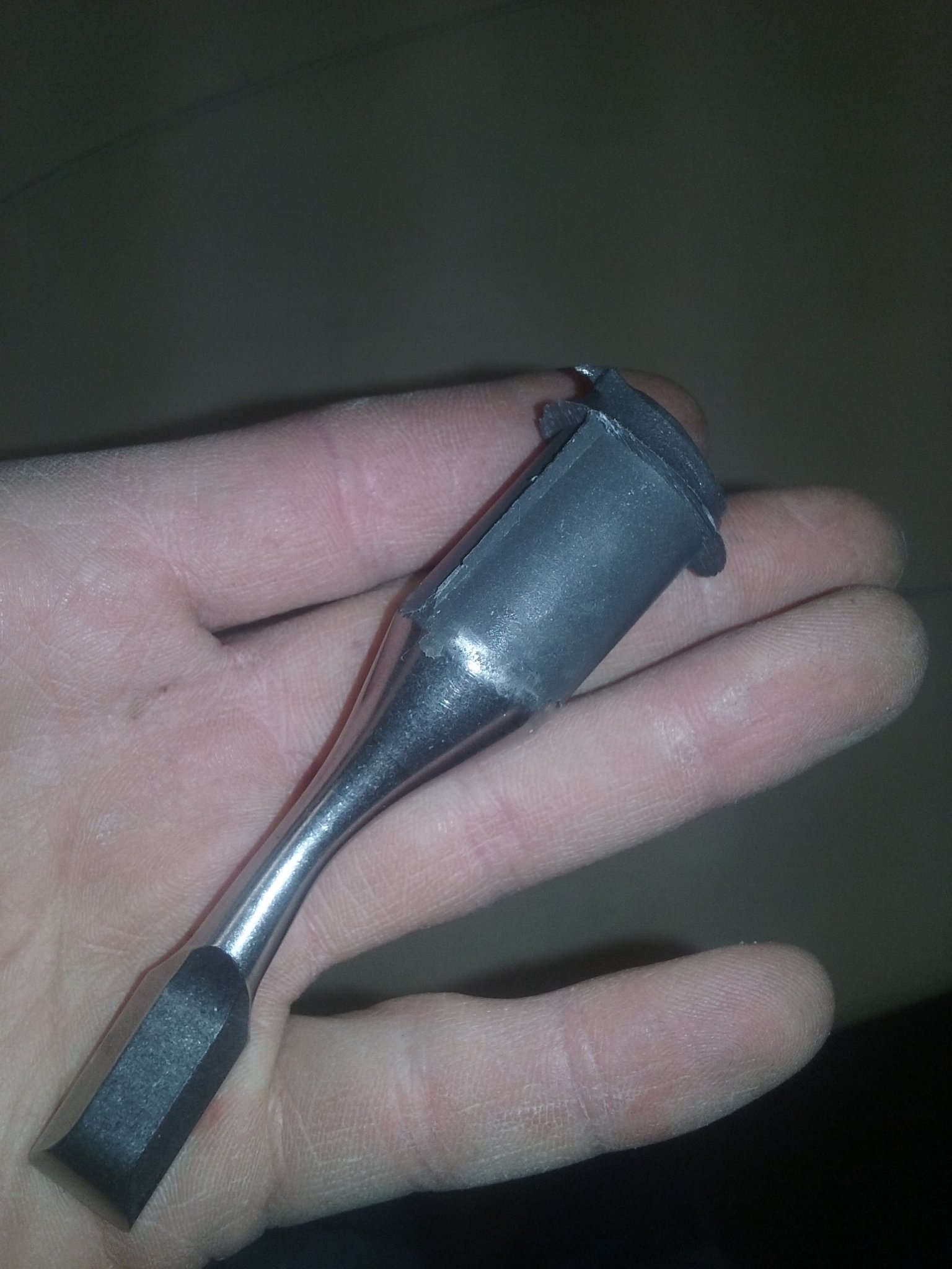

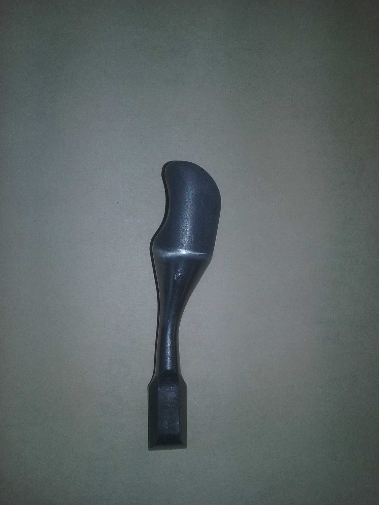

If they are mounted like the CTR you'll have to heat them.
Get them good and hot and make sure you have a good tight fitting torx bit with a bit driver handle.
My screws was fairly easy to remove once I put the heat to them.
This is where the fun begins prying off the rail.
Keep the heat flowing .....I used a good heavy duty scraper type razor blade to get it started then a steel caulking spatula to get it the rest of the way.
The clean up was the worst and most time consuming of the whole job.
3m pads,acetone and plenty of elbow grease.......

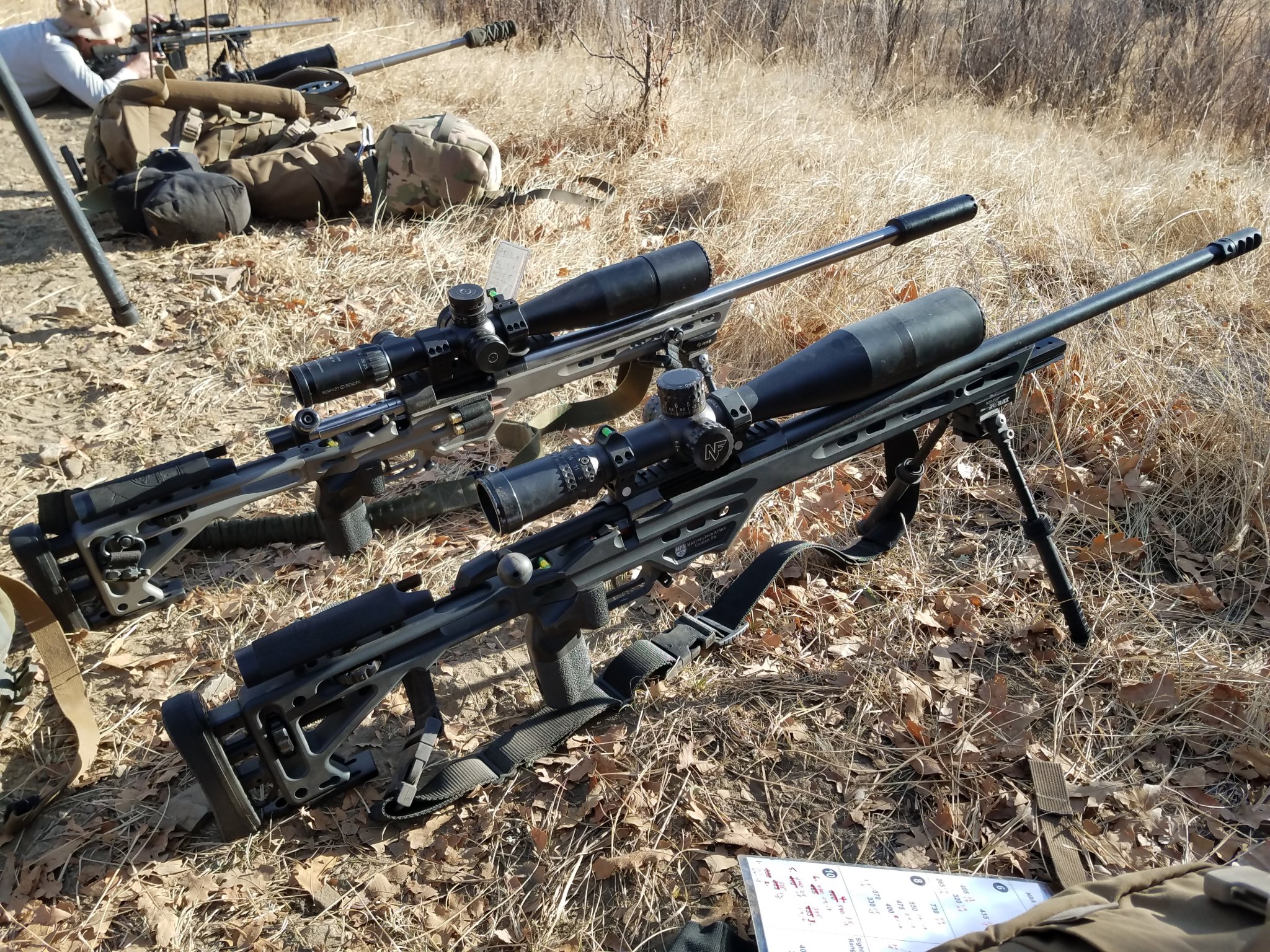

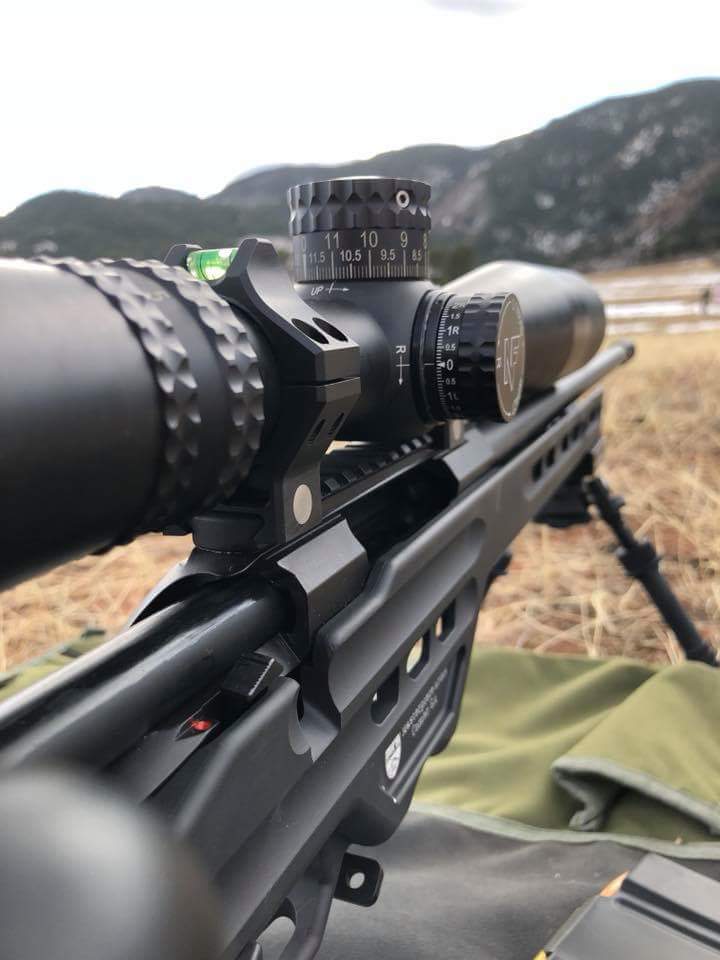

Tikka T3X CTR 24" 6.5CM
MPA comp chassis
NF ATACR 5-25 H59
My understanding is that you order whichever Tikka T3 stock that has the bottom metal inlet you want. For example, I wanted to use the ctr mags, so I ordered an A5 adjustable with the ctr inlet. If you want one compatible with the mags that come with the T3 “lite” models, my understanding is that you order one that is compatible with the “Factory plastic” in the “bottom metal” drop down box when ordering like this one: https://mcmillanusa.com/product/game-hunter-tikka-t3-t3x/
Edit: if you’re asking about which stock to get, that’s so subjective depending on personal preference but I think that game hunter looks great for a long range hunting build as long as you don’t mind the weight.

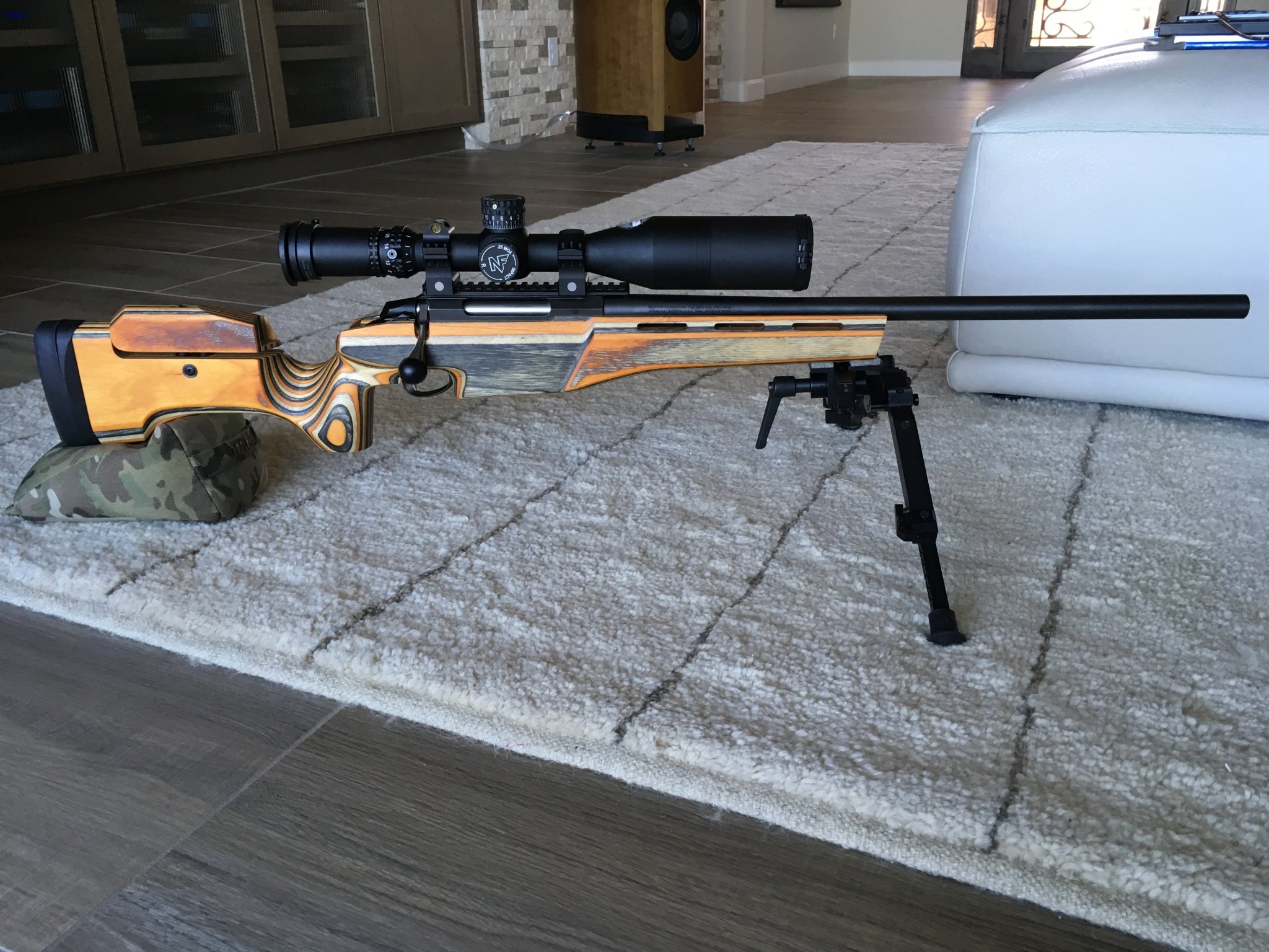

I put my T3x in one of these and it fit like a glove.
They mention you might have to trim the ejection cut on the stock for the T3x but mine did not need anything done to it.
Bell and Carlson CTR

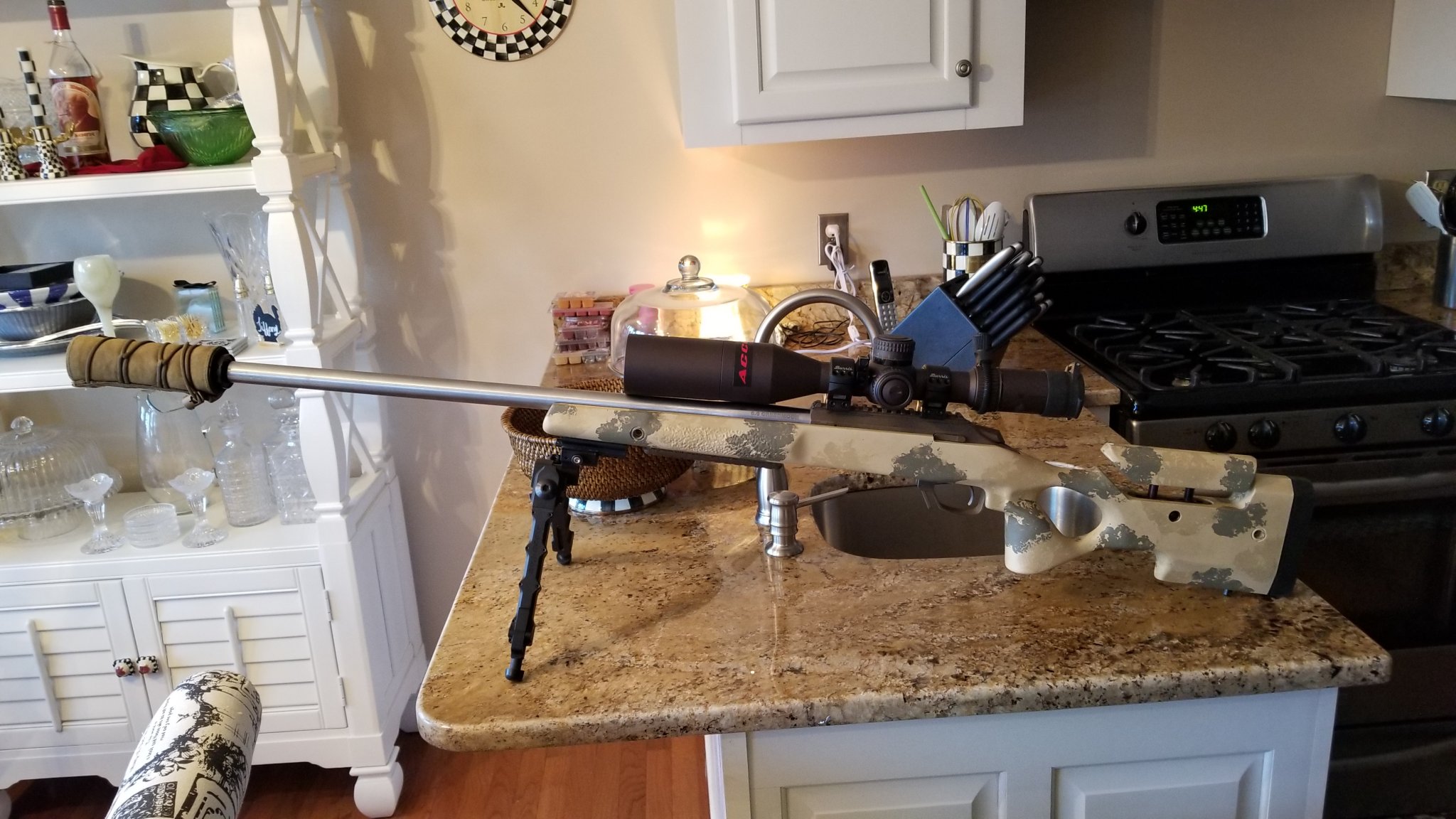

Tikka T3X Ctr in a manners T5A with 26" Hawk Hill barrel, CDI bottom metal, Vortex Razor Gen II in Mrad, Yo Dave trigger spring, Accu Tac bipod, and Rugged Razor Suppressor. These Tikkas shoot lights out in factory form but with a little gun mechanic love they are even better.
Reactions: kimberyote
Nice gun, those hawk hills are shooters! Mine is nearly telepathic.
