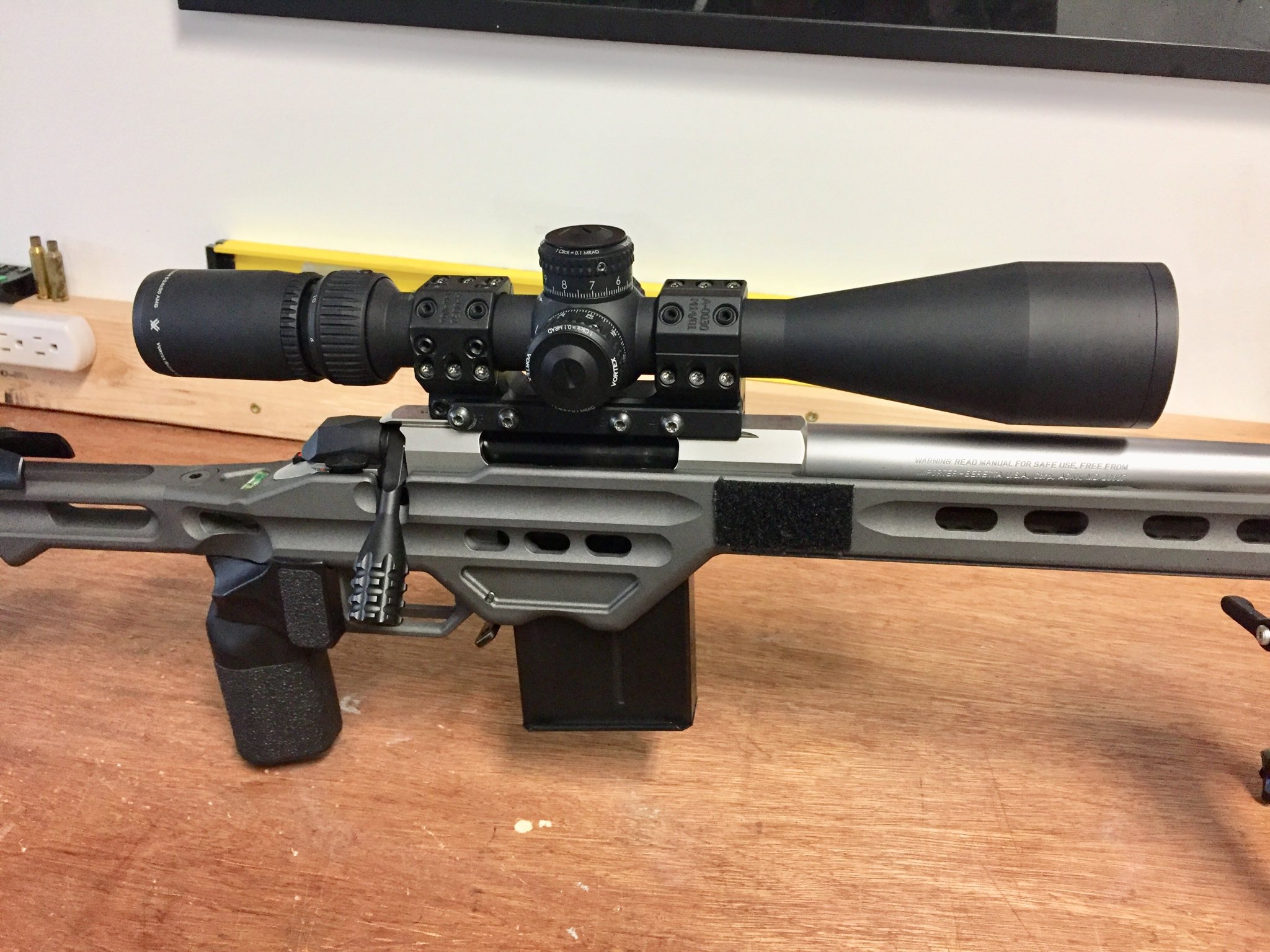

I just got a Spuhr 3701 with Vortex AMG, so far I liked it a lot. I’ll shoot it Wednesday and report back.

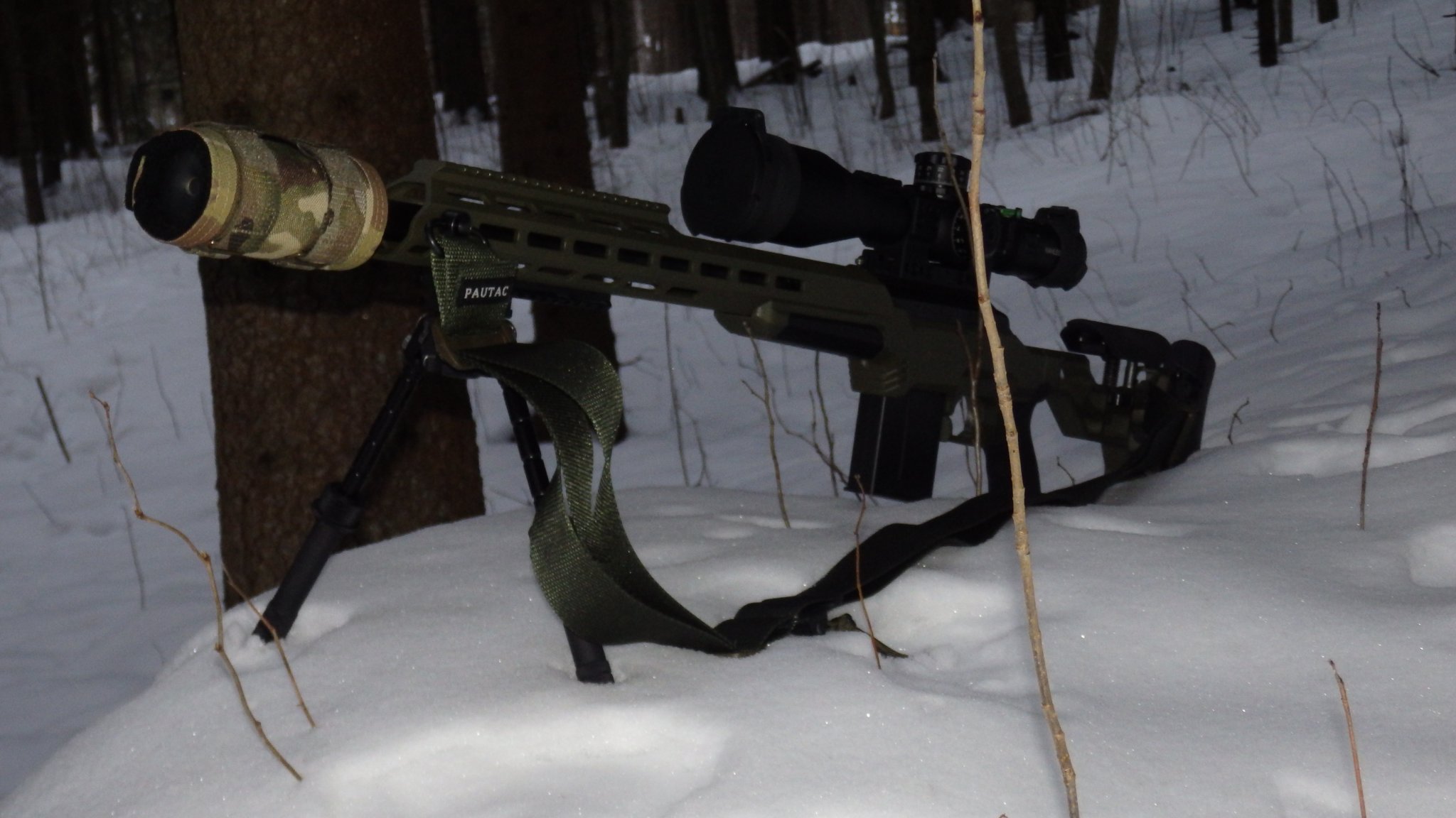

Just got my Area 419 Arca rail installed and had a range day with it. Overall I'm really pleased with it, and the MPA RAT pic rail makes swapping bipods a breeze. I highly recommend it.
Two adapters makes that bipod sit real high. Plus the added weight. Hopefully one adapter comes out to be dual purspose soon enough

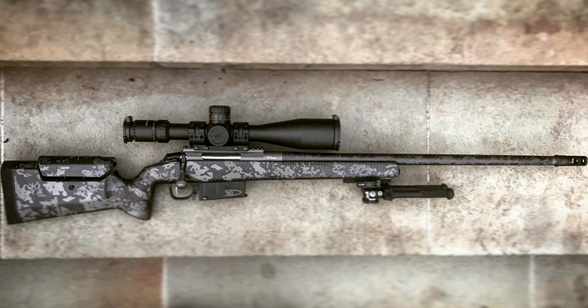

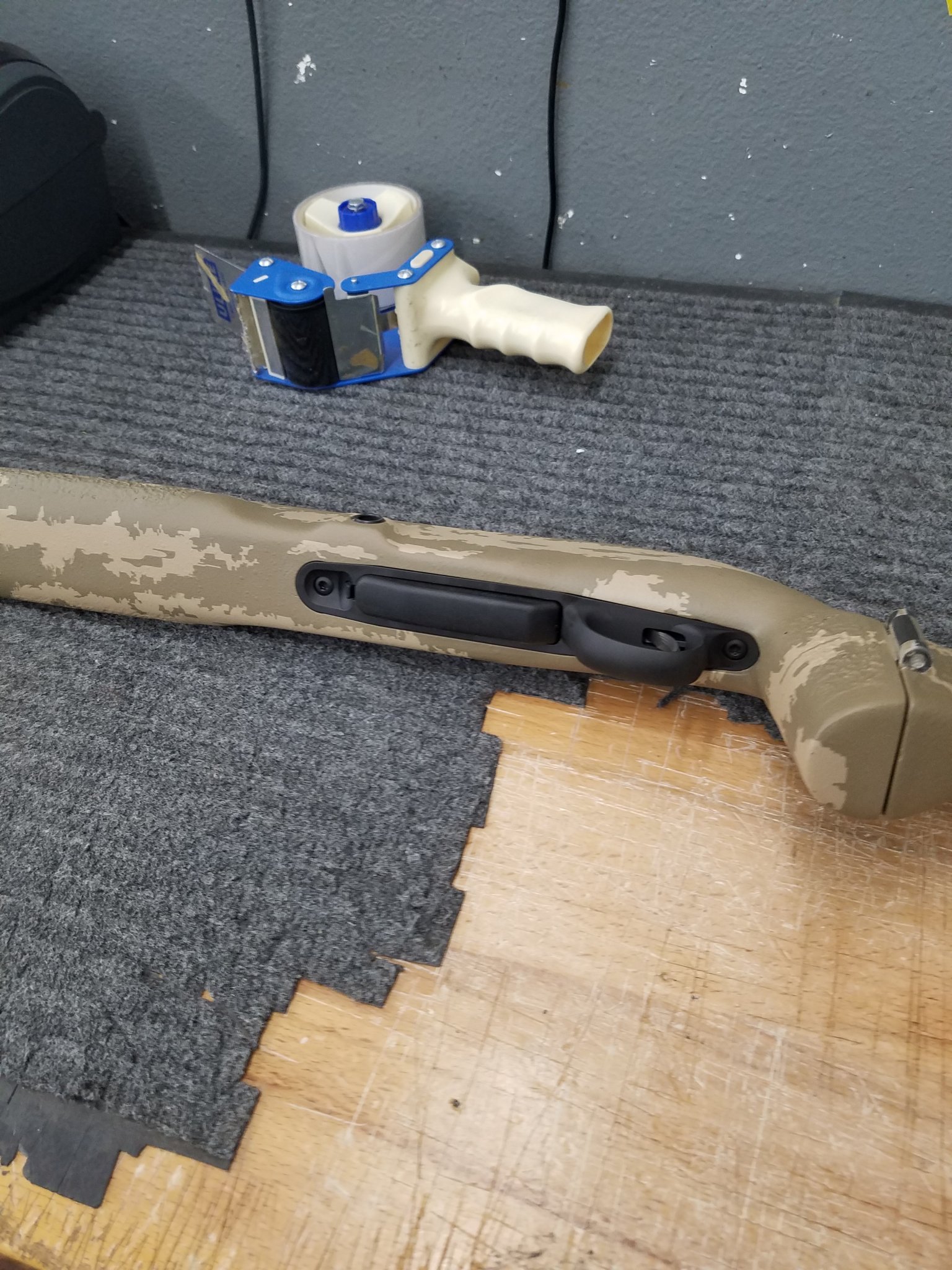

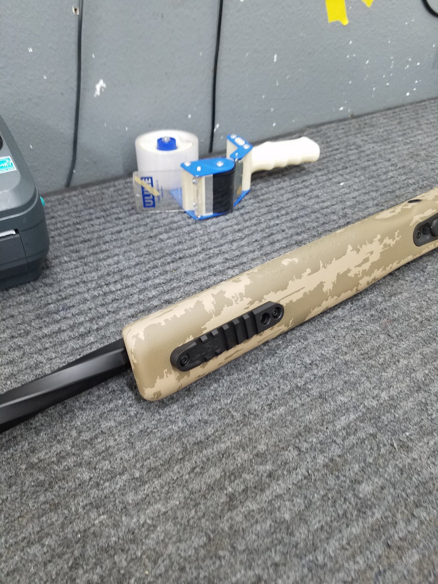

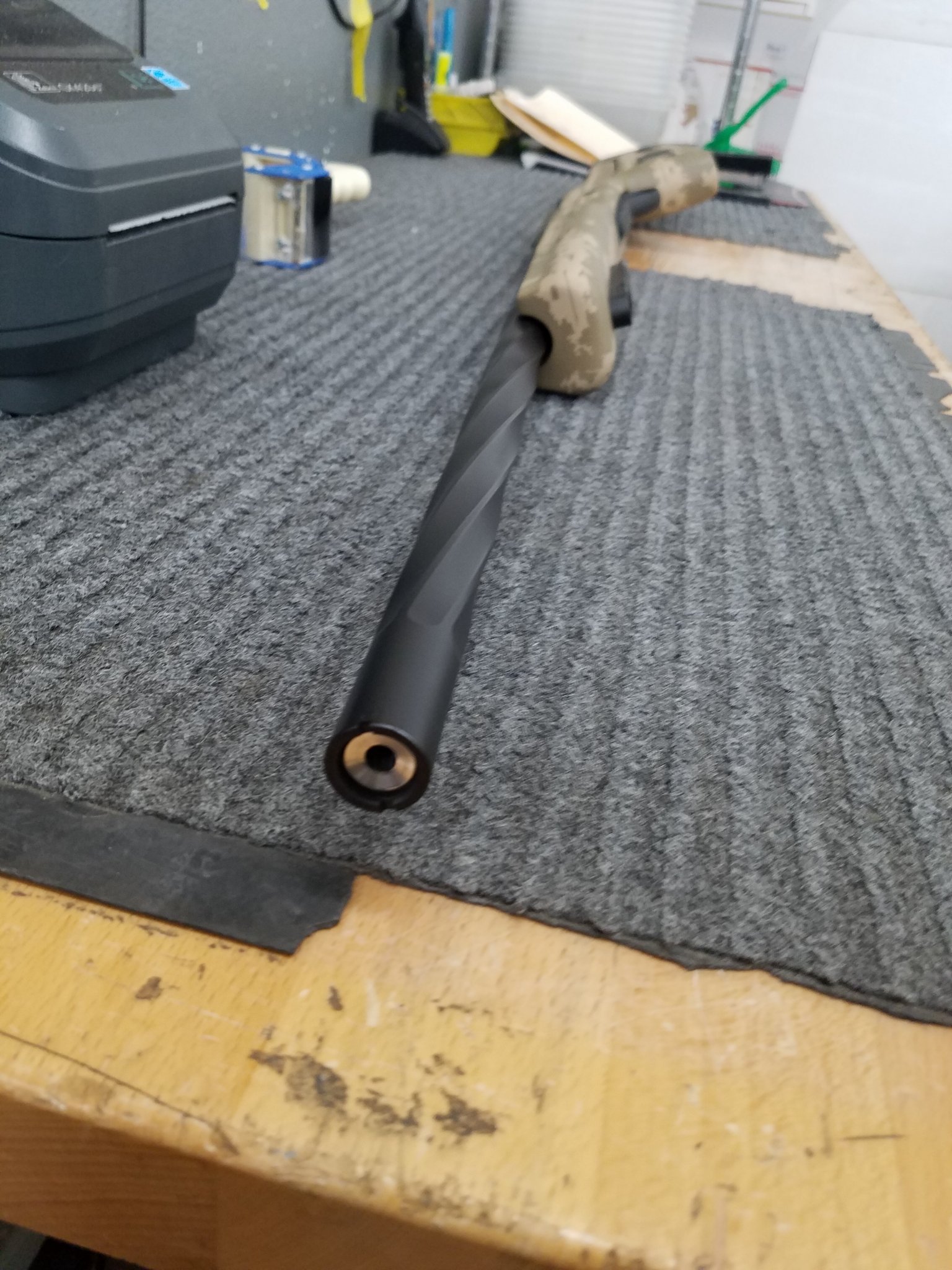

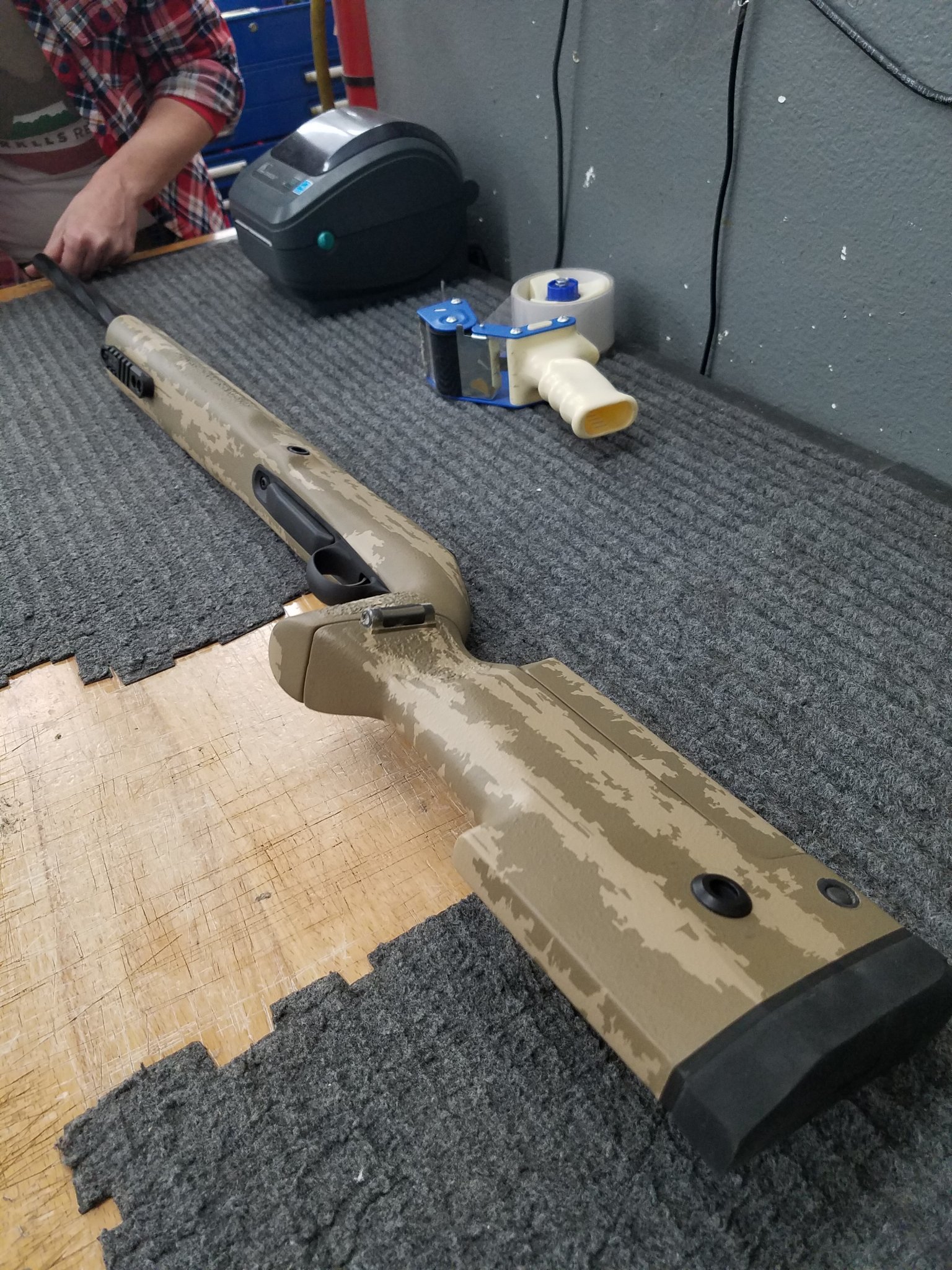

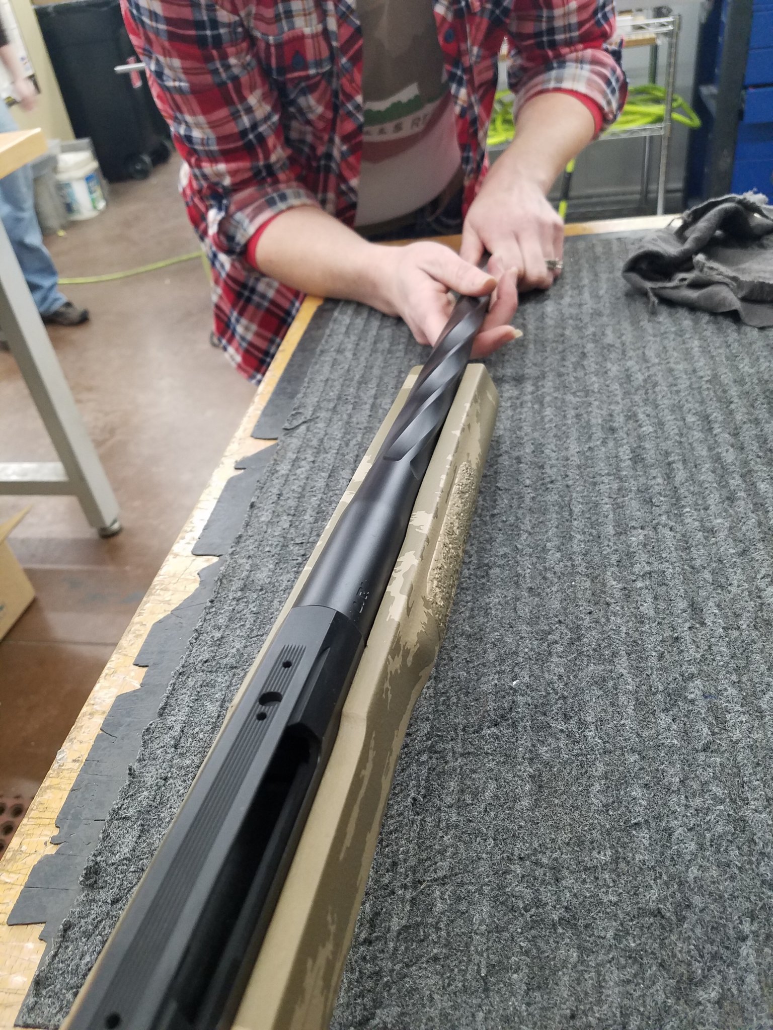

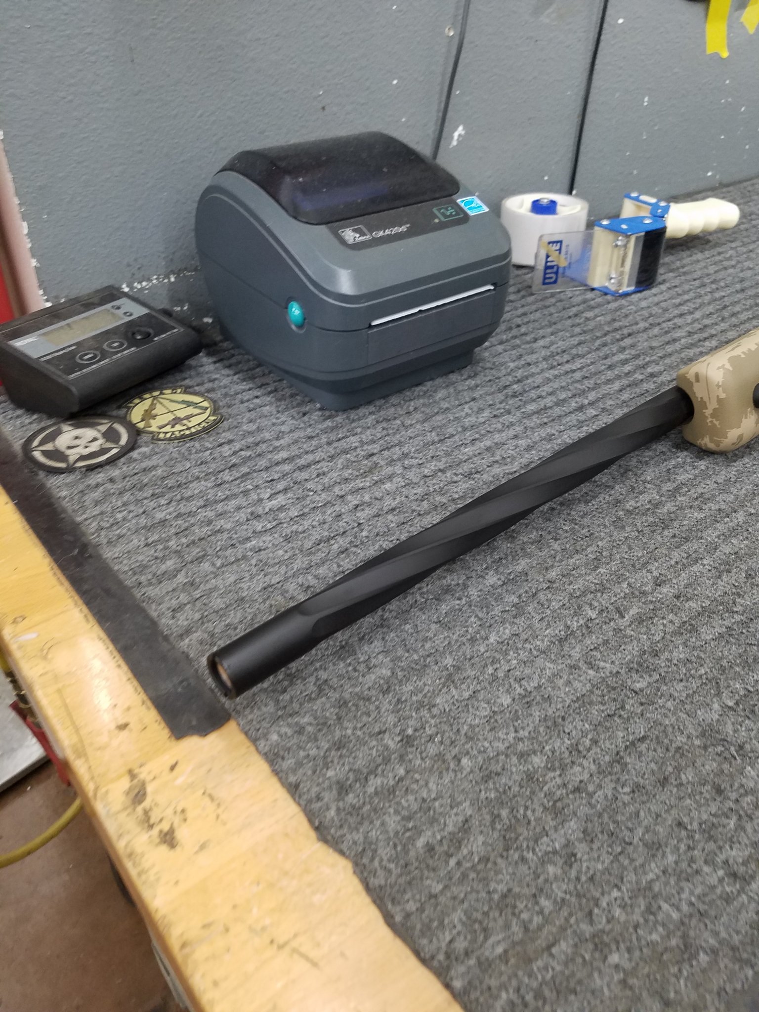

Tikka T3 build we just wrapped up.
New barrel, some fluting, and C/K to finish.
Stock is a Manners T4A blank. We did some surgery and tang work to build it up for the action. Then surface machined the inlet and fitted all the additional hardware. 1:1 right off the machine.
Finally, some paint work using our DMP pattern in 2 color. I designed this pattern almost 7 years ago and we make all the stencils in house. Actual applied coating, not film dipped.
Nice little rig for killing critters.

I have my first Super Varmint in .223
Jeeeeeeeeeeeezus thats one heavy barrel... be really nice if there was a fluted option too.

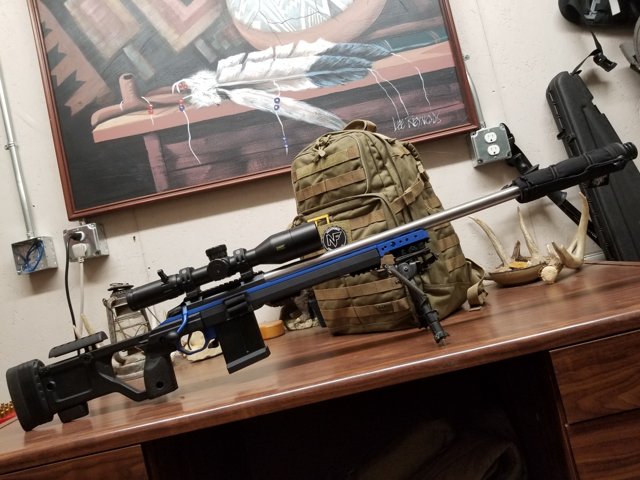

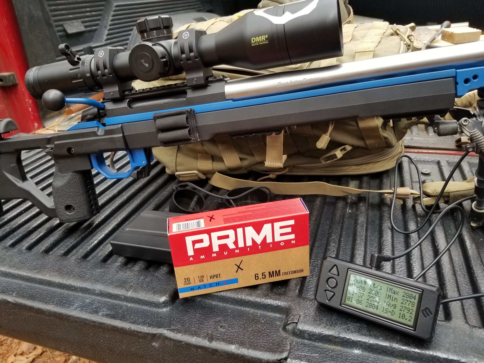

Finally got some decent data on my new match rifle. 22" 6.5 Creed, I was wanting to run Prime ammo only but was never satisfied with group sizes:

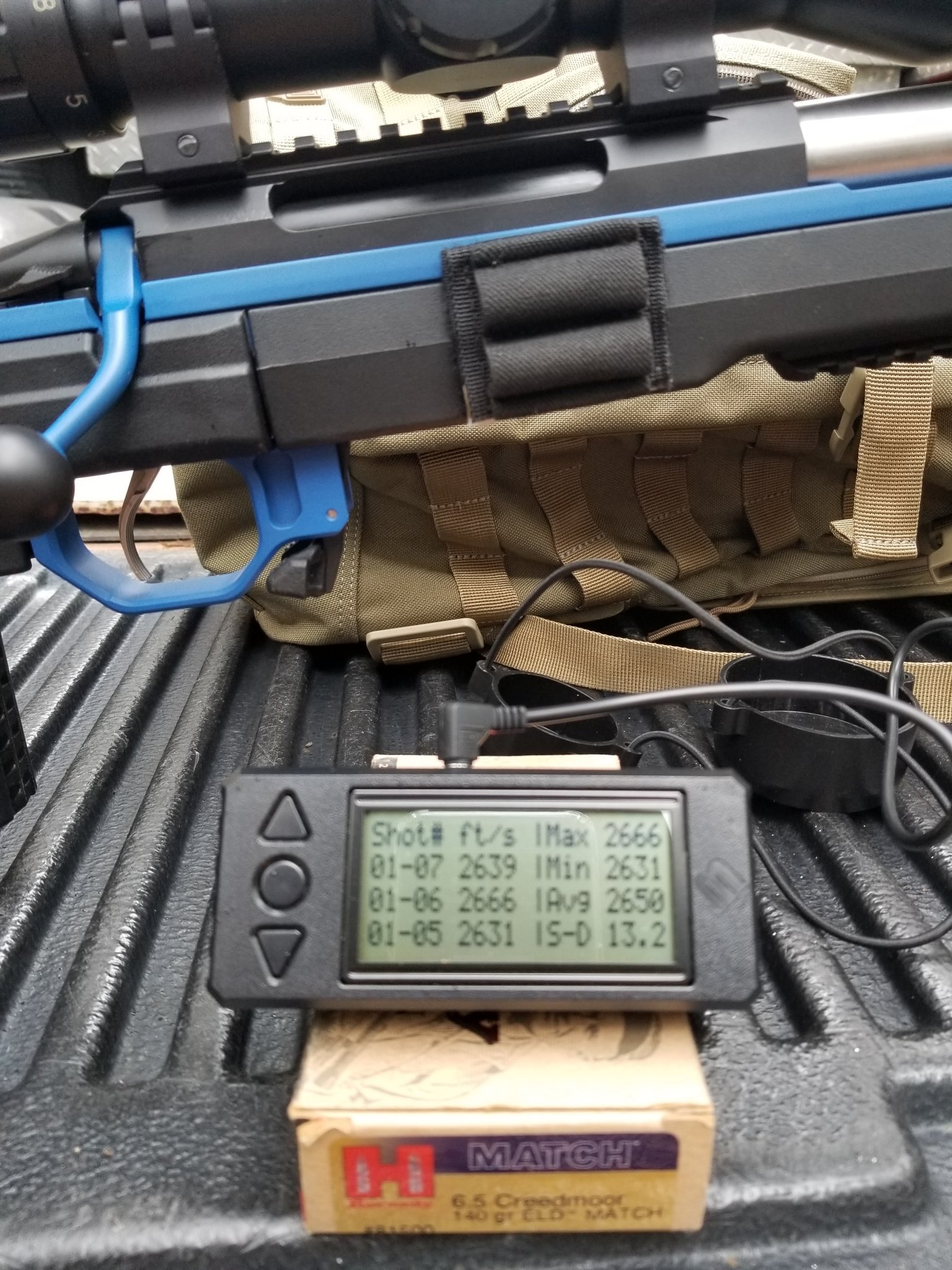

So decided to try Hornady Match 140 ELDMs before hand loading:
I was impressed with the results of the Hornady. I may hand load in the future (if I ever have time), but for now I'll be running Hornady. Next range day will be out at distance.
