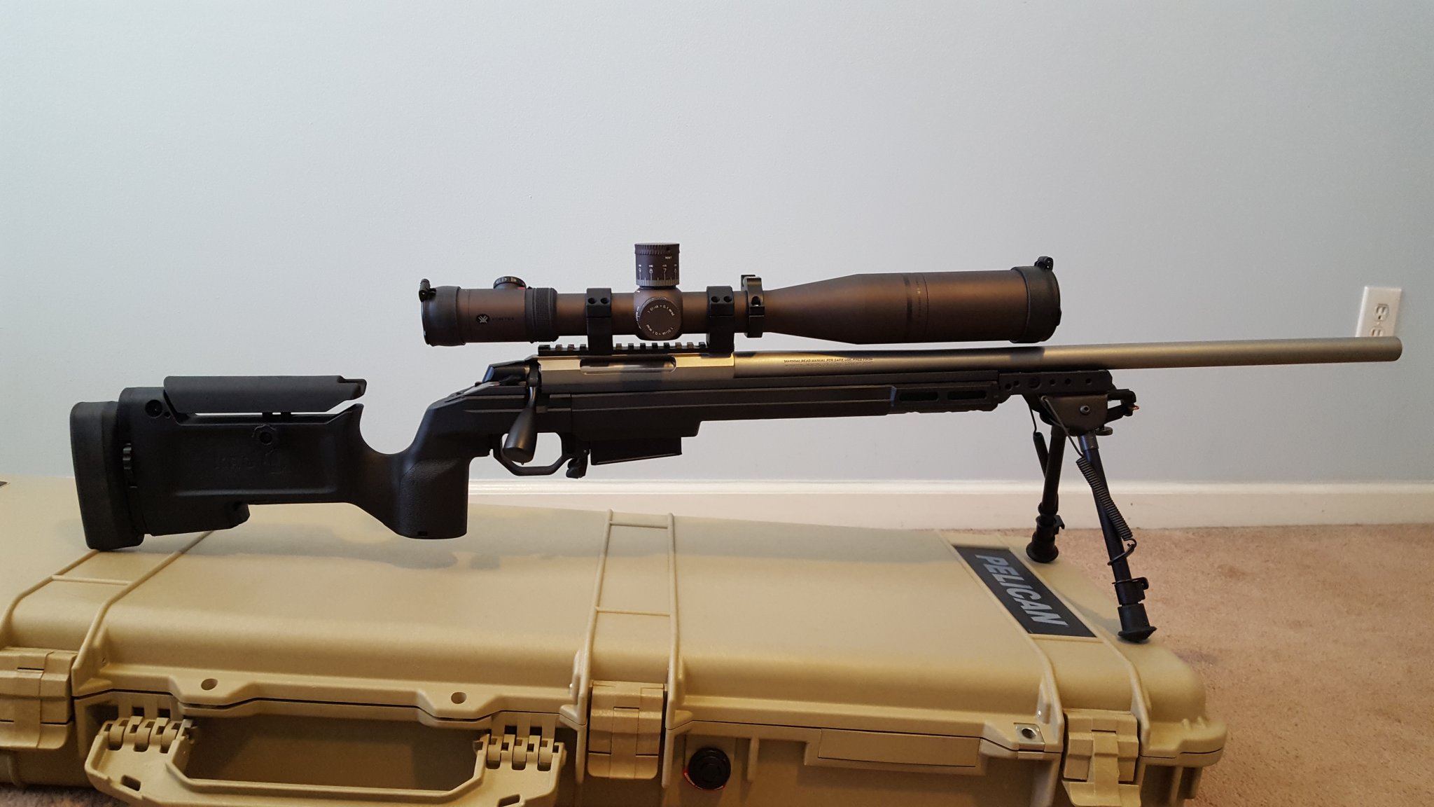

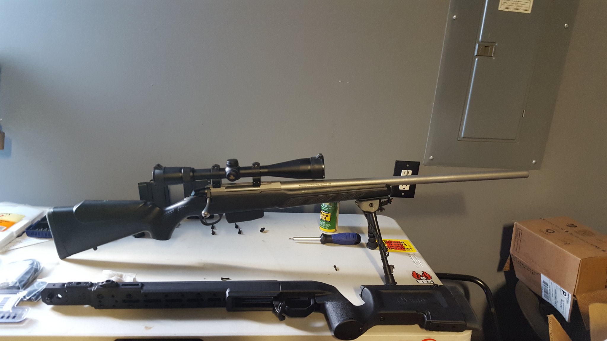

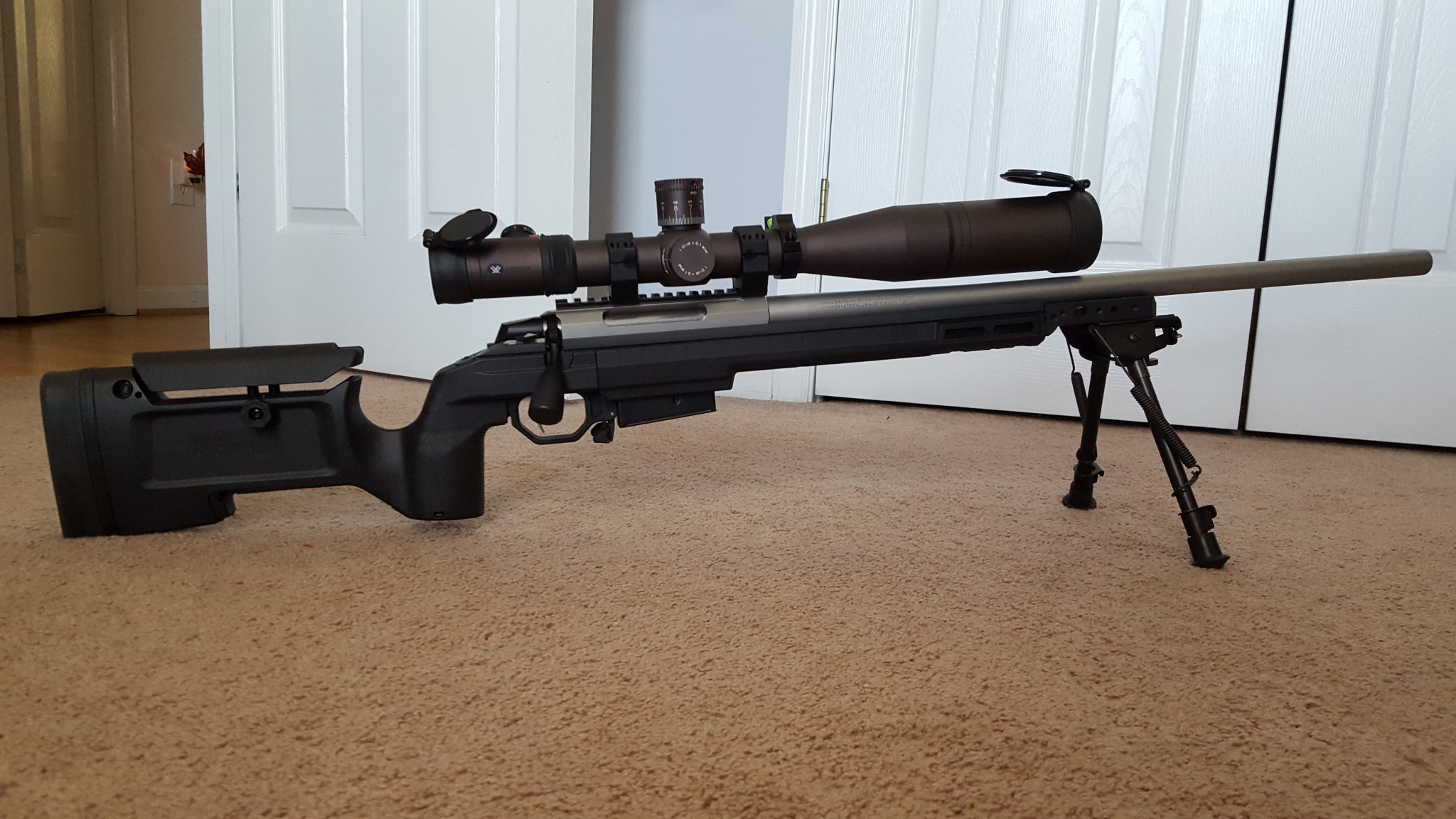

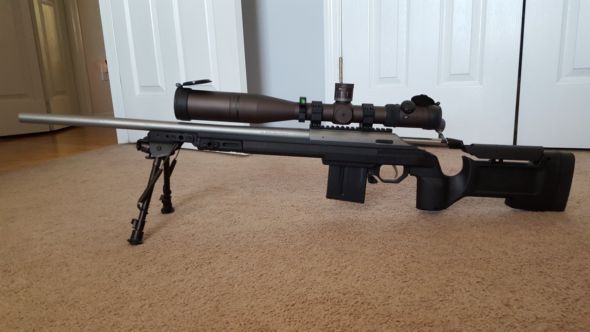

Alright! I got home from deployment this week so I was able to install everything on Friday after work. The front action screw that came with the Bravo chassis was slightly too large to thread into the action of the rifle, but Fastenal had what I needed when I stopped by after work. IDK if this was because they just sent the wrong screw or if there was a change to Tikkas since 2007 when I bought mine, but when I called KRG they were very helpful (I spoke to John); I just didn't want to wait for a screw to ship so I bought one locally (I've already been waiting since January to install this stuff lol). If anyone else runs into this issue, the screws only sell in packs of 10 or larger so I have 9 spares.
Anyway, list of what I installed:
-KRG Bravo Chassis-also with their AICS logo mags, I bought (2) 10 rounders and a five rounder since I hunt with this rifle. It came with the mag release button already installed-not sure if they are supposed to though? I wasn't going to buy that piece but I do like it a lot after getting used to it.
-Hook-style cover for the chassis (I'd prefer if this was the one it shipped with)
-KRG spigot mount with QD sling plate on the left side
-Magpul M-Lok QD cup on the front left of the forend skin
-Glades Armory black melonite w/ oversized tactical knob. Very happy with this, just needed a healthy dose of loctite to keep the knob from loosening.
-Glades Armory black aluminum bolt shroud to replace the plastic factory one
-Harris HBLM-I am considering going to an HBLMS with pod-lock
-Warne M6T3 20 MOA 1 piece tactical rail
-Seekins/Vortex Precision Machined Rings. 35mm diameter, 1" height
-Vortex Razor HD gen 1 5-20 MRAD FFP scope
I am still waiting on my tool-less buttpad height mechanism that I ordered to ship, KRG was backordered when I ordered everything. Also waiting for the Tikka specific cheekpiece to come out, I'll be ordering one of those too. As it is now the cheekpiece is at a good height but another 1/4" would make it perfect. The cocking piece would prevent the bolt from going back far enough to slip over the rim of a round in the magazine if it were any higher though.
Overall I am very pleased with the chassis, I haven't had a chance to shoot it yet but the ergonomics are very good. The grip is fatter than I am used to but with a thumb on the shelf grip its very comfortable. I have a case of 168 gr GMM (the rifle likes it a lot) waiting to sight in with and all I need to do before that is boresight it. Ordered a Pelican 1750 today, so hopefully that will come in and I can cut the foam this week.
Enjoy your porn:

VERY nice!

SSWWEEET :p

Very nice!!! Congrats on the sweet setup. I am very much looking forward to picking up a KRG Bravo once they get the cheek piece dialed in!

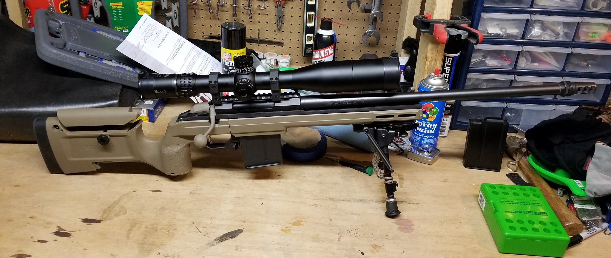

Anyone running the ARC 10 round mags? I am having an issue with the 4th or 6th round nosediving and missing the feed ramp. I have tried every combination loading the mag with 10, 9, 8, 7, 6, 5, and 4 rounds and it happens with them all. It only happens once a mag no matter how many rounds I have in the mag. I have upgraded the followers to the MK Machining improved follower. I ran about 100 rounds through the rifle yesterday and on 2 different ARC mags it happened every time. Switched back to the AI for a couple and it didn't happen. I really want to like these as they are so much smoother than the AI. Odd thing is I got home and ran four full loaded 10 round mags through the rifle on a bench and did not have one hiccup. Only thing I can think of is that the follower is getting hung up on the inside of the mag and forcing the round down?

MK Machine has a follower that supposedly fixes that, worth a look

Yup, mine too, nose dives... its frustrating. Im still waiting for Ted or someone else to iron this magazine out. I always go back to my aics mags, but they are so damn long.
tried that

Thanks, yeah really frustrating as the rifle functions much smoother with the ARC mags.

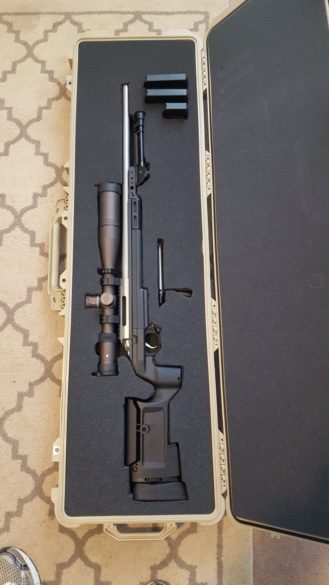

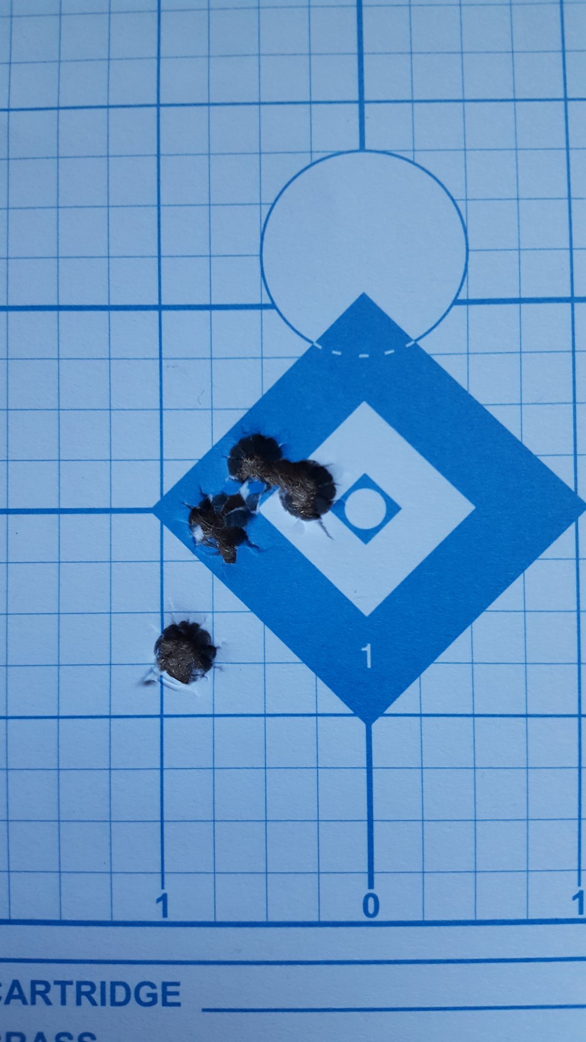

Finally got out to the range to sight in today and must say I'm impressed. At 12.8 lbs unloaded this rifle is incredibly comfortable to shoot, and between the rifle and chassis itself the controls are quick and intuitive to operate. The KRG AICS mags worked flawlessly and smoothly.

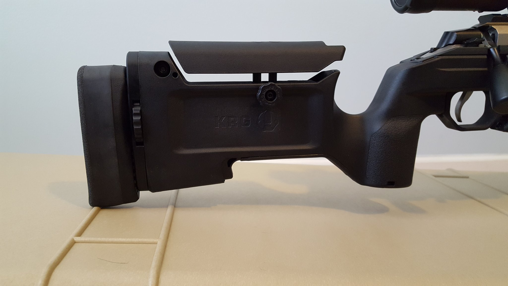

The tool-less buttpad height adjustment mechanism was sitting in my mailbox when I got home (they were backordered when I ordered everything else-go figure it gets here after I go to the range). Made some small adjustments to the foam in my Pelican 1750 to fit it; without any LOP spacers the tool less buttpad mechanism adds about 1/2" to the LOP-about the same as two spacers, so I took out the spacer I had in there. Once the Tikka specific cheekpiece is out and I can get another 1/4" out of the comb it will be perfect.
I got it all dialed in and included two groups that I fired after I sighted in. The first group is 7 rounds at about 1 MOA, and the second is 5 rounds with one flyer that opened it from about .6 to 1.5 MOA. That was all me though, I haven't shot scoped rifles in about 2 years so I definitely have room to improve and tighten things up, and the wind today didn't help.

Wow that’s a good looking set up...I am going to buy a CTR in 6.5 Creedmoor to hunt and target shoot with and was thinking of a Manners stock but maybe I should consider this chassis.
Seems a bit heavy but most of my hunting will be from a blind so not that important for light weight.
Congrats on a very nice set up ??
