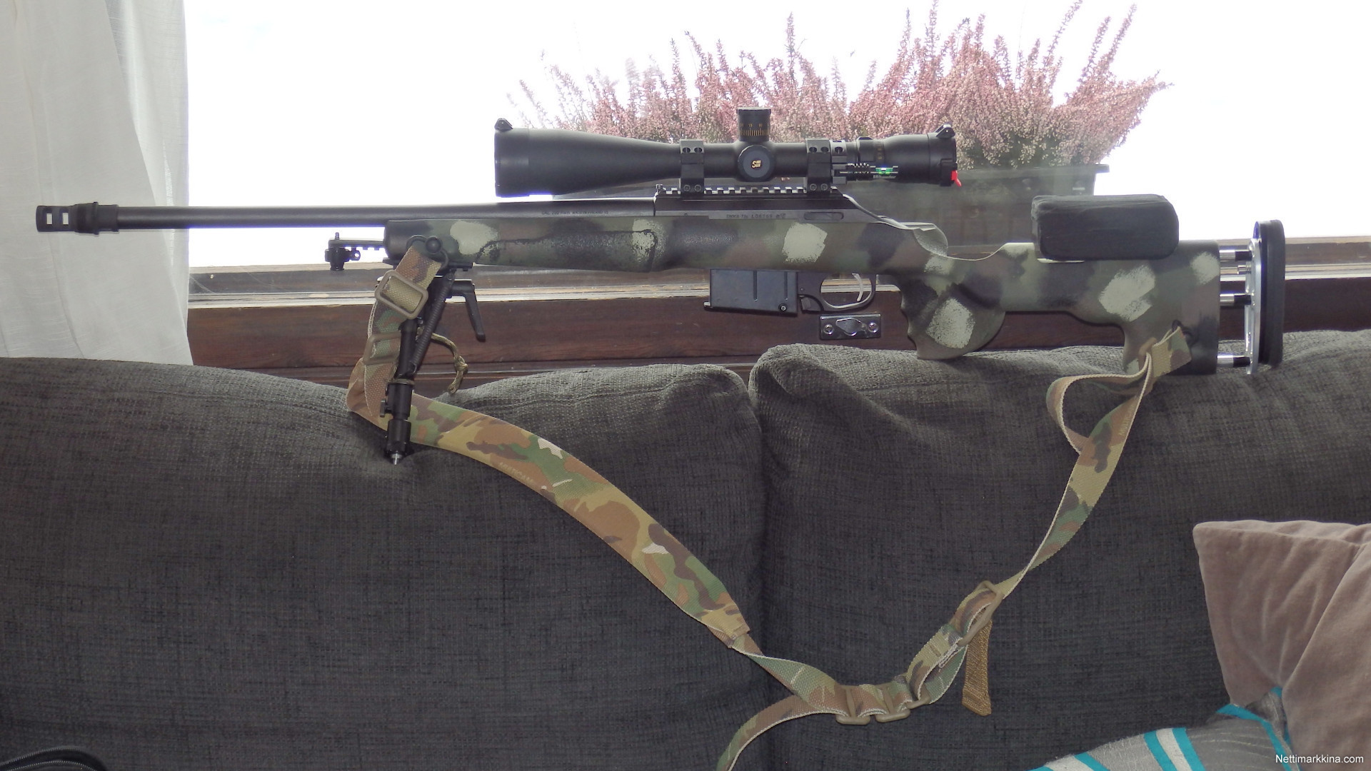

Did you remove the Berserk? Why? What did you go to instead?

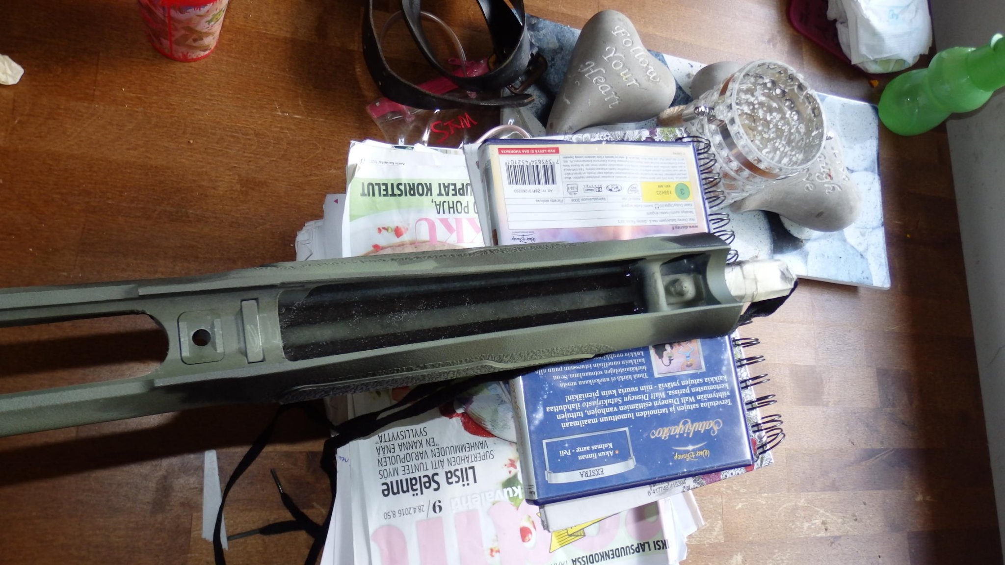

But for the tactical use, it is a bit loose, even though i modified the front of the stock, with carbonfibre tubes and filled the whole tire front end with epoxy, that still was not enough rigid for me.
If i lock the pipod and i turned the rifle with the pistol grip, i could see that the stock did twisted a little bit.

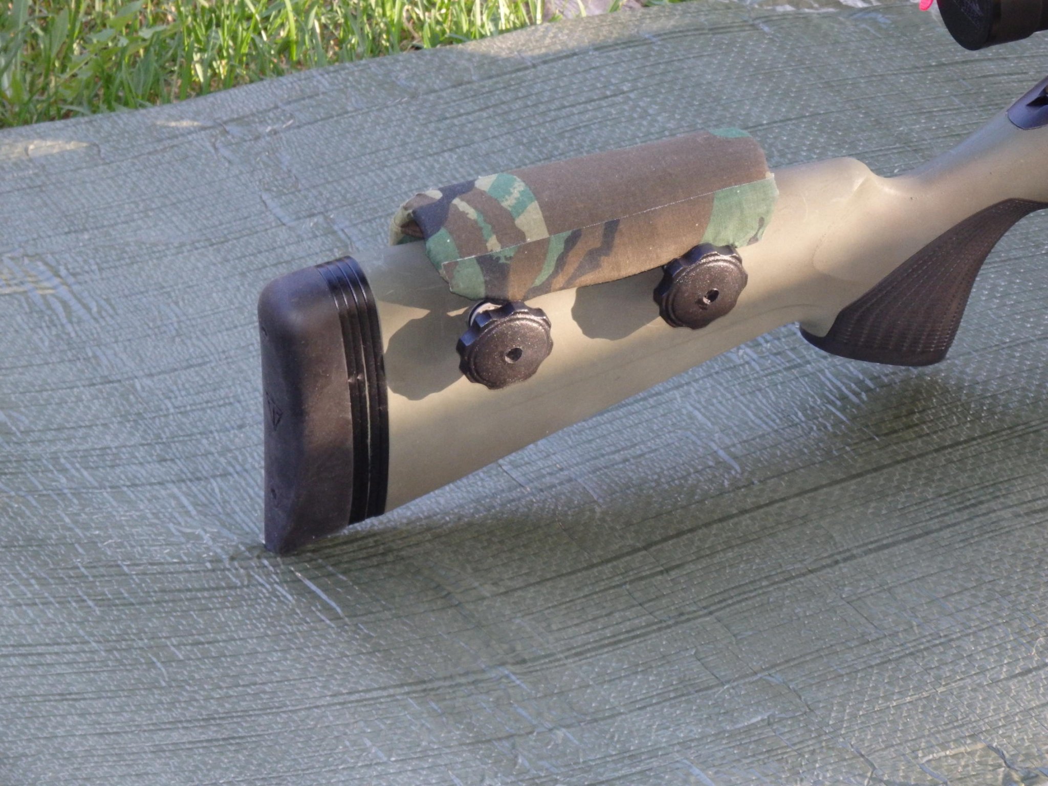

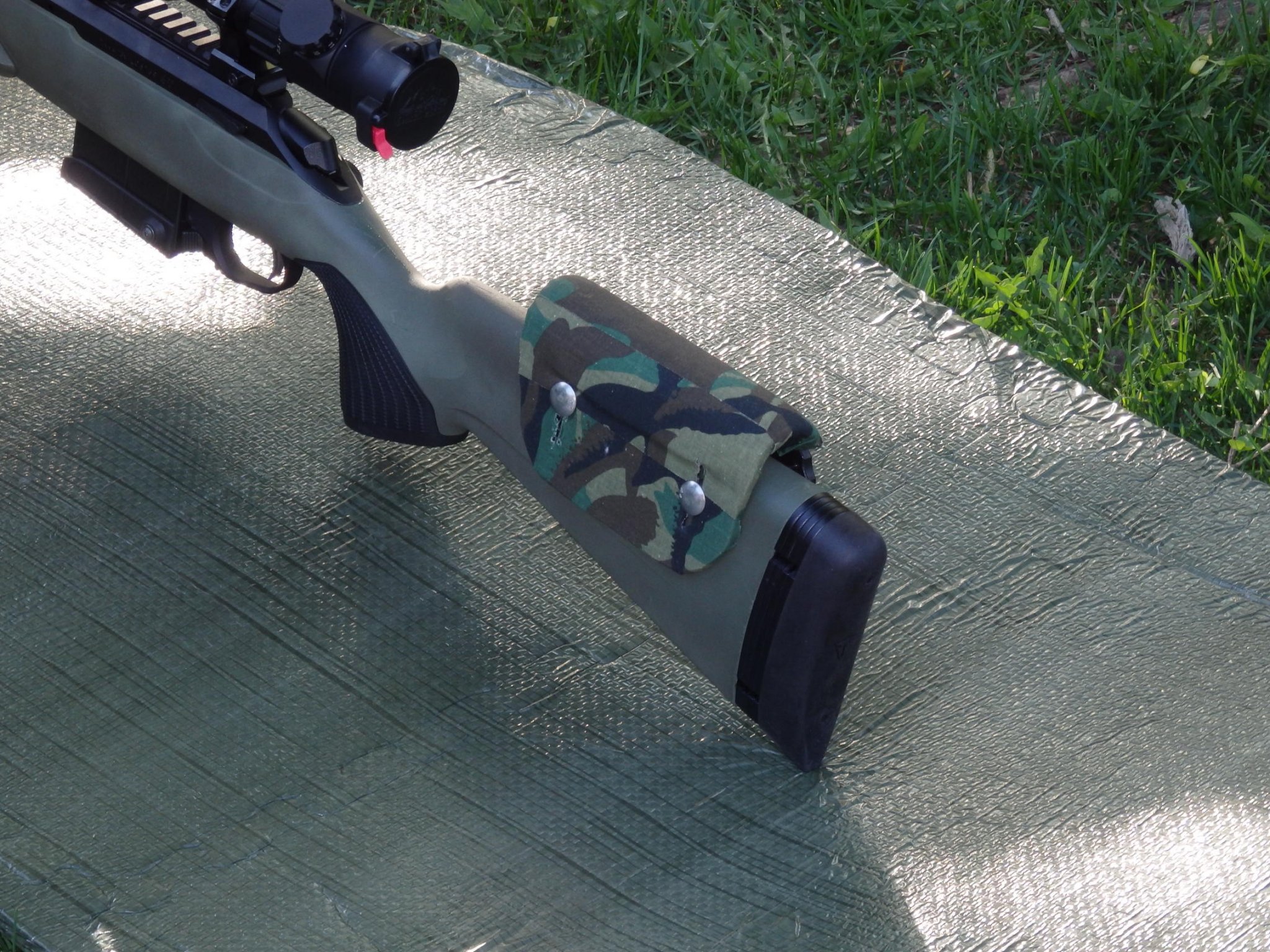

Has anyone attempted to add an adjustable cheek rest to the T3X CTR stock, or are you just using strap on pads?
I was originally going to swap out for a bravo or a-5 stock, but ended up with a different action/setup for prs and plan on using the ctr as a lighter weight hunting rifle, so I'm looking to utilize the factory stock to allow for more budget on other things.
Made a big difference on mine.Do the rail covers help with the aluminum in colder weather?

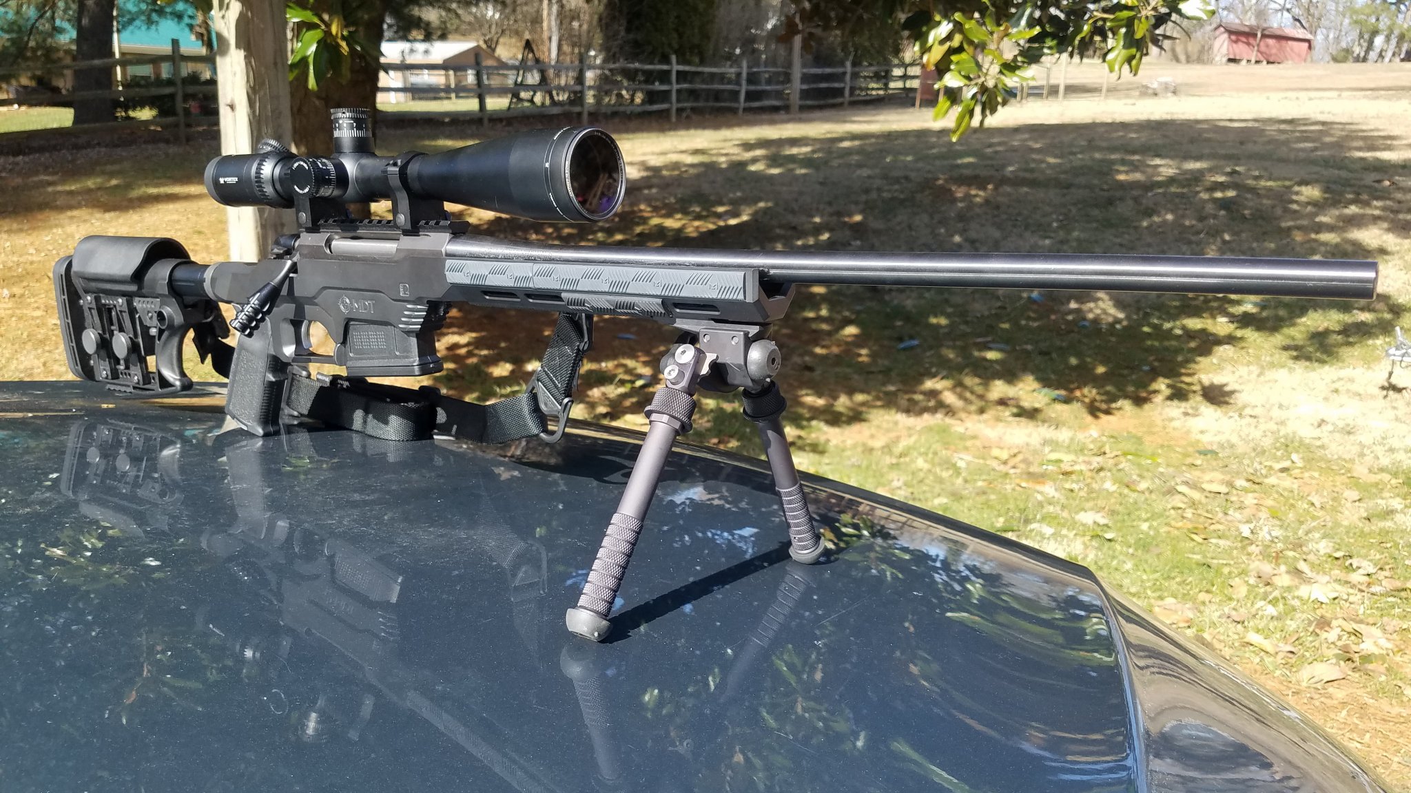

Just placed my order for the J Allen chassis, should hope to have it the beginning to the middle of June. Will post pictures when I receive it and get it all mounted up.

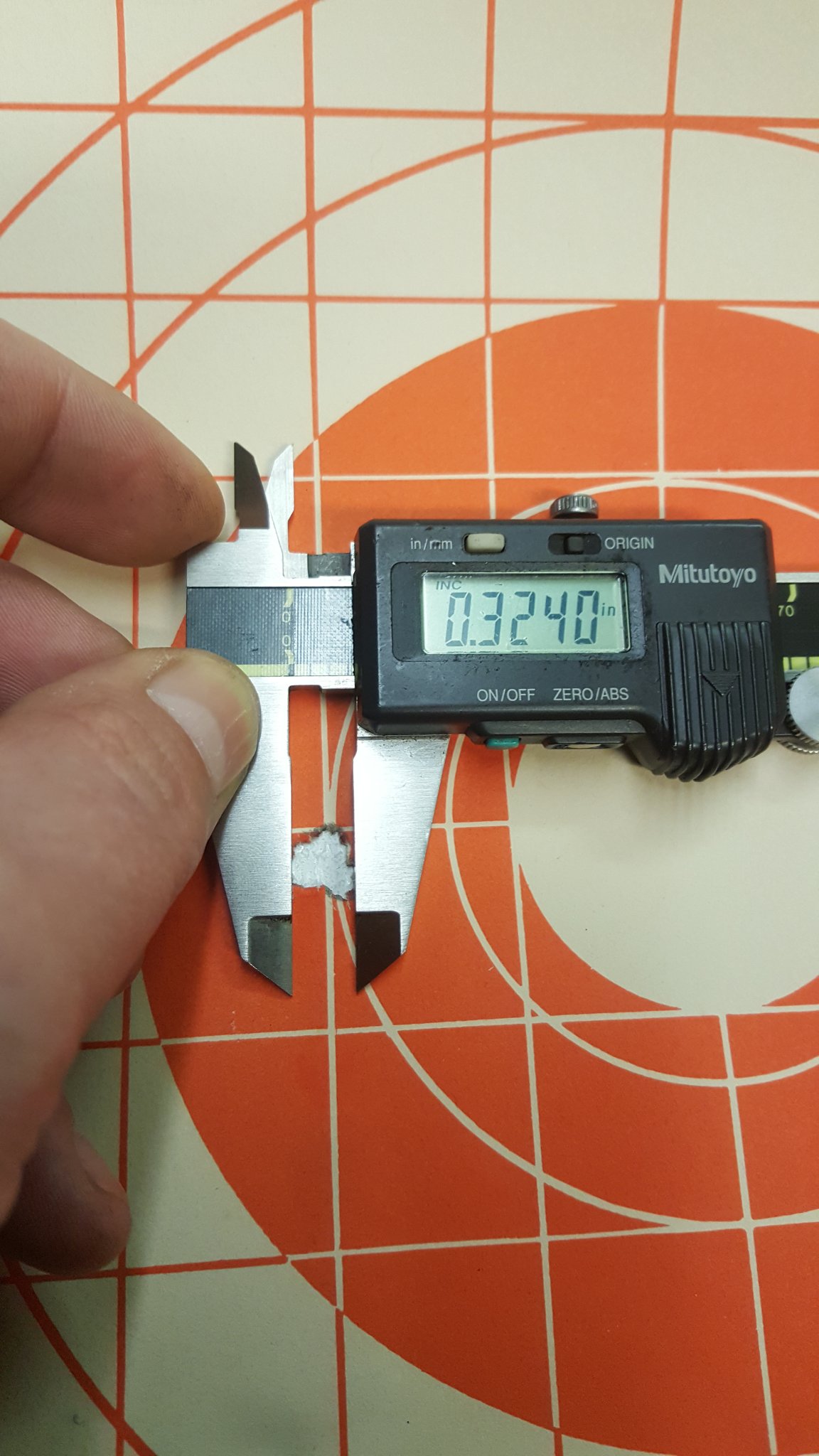

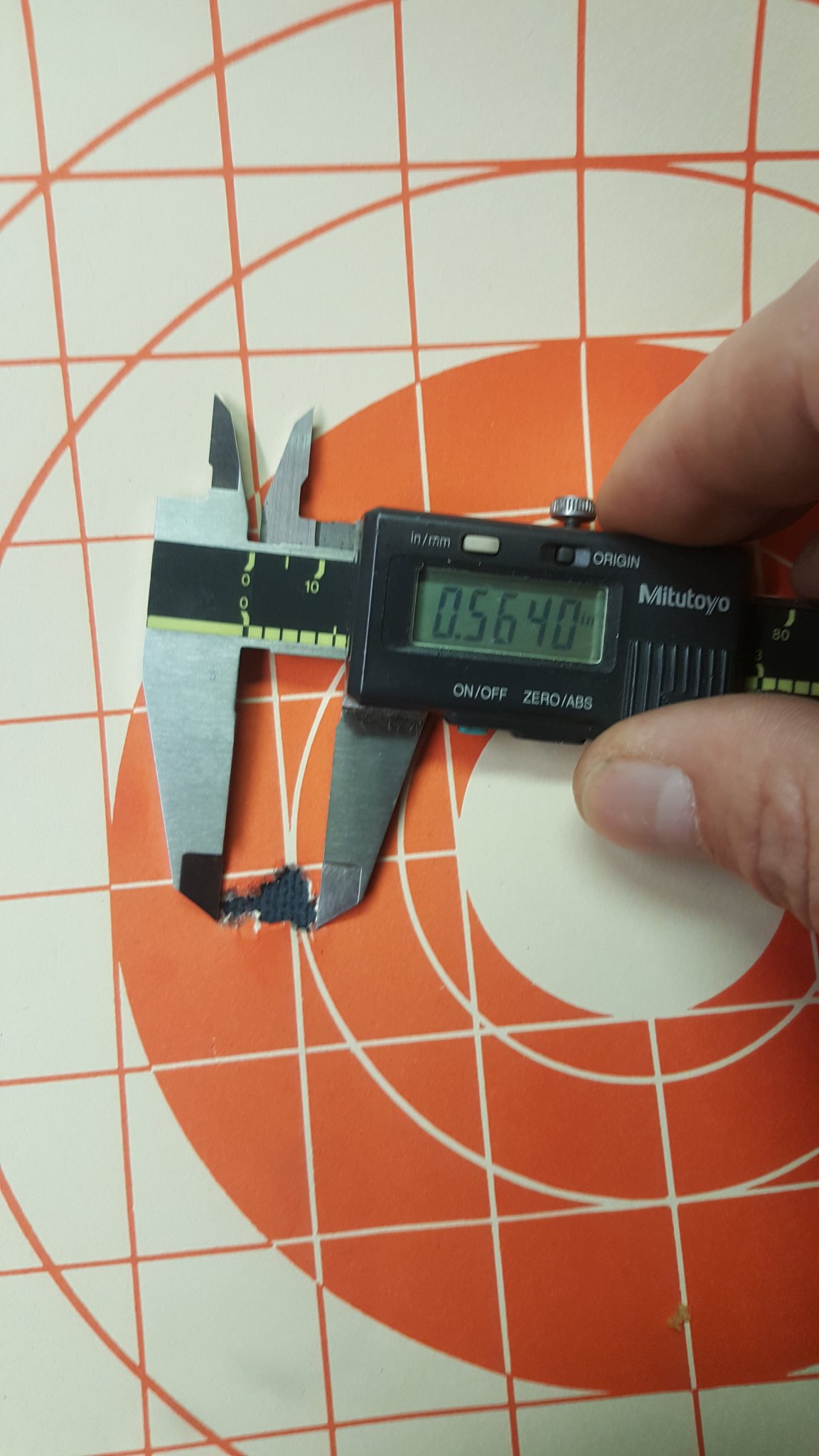

Impressive groups from that ammo! Let us know the velocity if you get a chance.Factory AE 140gr OTM. 5/100m today with the Tac A1 in 6.5cm. Top round was CBS.

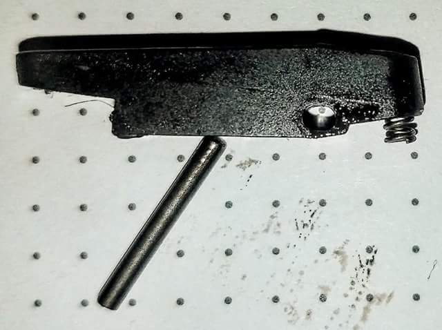

Going over my rifle today I noticed alot of back and forth play in the bolt stop/release. Upon inspection the hole has elongated almost double it's original size (kind of hard to see in the picture). This is from 750 rounds and just as many if not more dry firings. Looks like I will be making a order with Jason McHann at Mountain Tactical for a new one and extras to have on hand.View attachment 6890387
This is correctThe holes come like that from the factory with the newer rifles, my CTR looks the exact same. I think its done that way so the stop itself has some play and will contact the receiver rather than the pin taking the force when th bolt is cycled.
