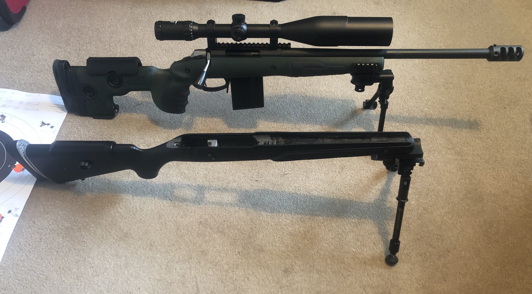

I’m new hear but I’ve been shooting a Tikka T3 Tactical 308 for a long time. I reinforced the standard stock & inlet it for an AICS mag bottom metal. It’s been that way for a few years now & shoots really well with the right ammo.
I have considered a chassis kit for sometime, but they are quite expensive here in the UK & I chose the 20” so I could use it in the field as well as the range. So I liked the look of the GRS stocks & finally got to try one in the flesh a couple of weeks back when another shooter brought a Berserk to the range.
Whilst doing some research on these I came across the new Bifrost which seemed a better stock from the info available, so after acquiring one & inletting it for my AICS mag bottom metal, here is the result.
Feels great, hope to see how it shoots tomorrow, but the weather is looking bad ☹️

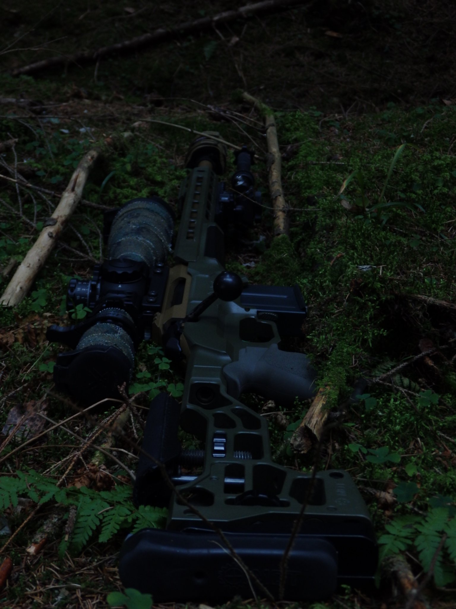

I AM 99,9% sure, that i am going to get Bravo chassis for the 223CTR, this mix KRG is just so good for the 260rem.
308win is now in MDT chassis, since it has more recoil than soft 260rem, my son like to shoot it more now.

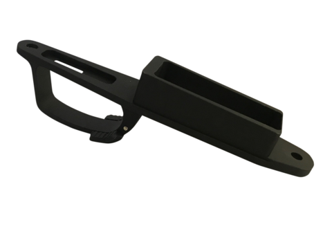

Are you talking about this?
https://www.atlasworxs.com/collecti...ucts/atlasworxs-bottom-metal-dbm-tikka-t3-ctr
Now that I look at it yes I believe it will work. At first I was wondering why you wanted the CTR inlet if you're not going with ctr mags but then I didn't see that mag release design in the other AICS dbm. Nice find.
Pic of the linked dbm for reference.

That’s exactly what I’m talking about, yes. Sorry for the confusion. I want to run AICS magazines not CTR mags. I’ve read from more than one source where the CTR receivers have an extra cut on the bottom of the receiver to give clearance to the CTR mags that would otherwise not seat on T3/T3X receivers. Ive had McMillan tell me this too, but I haven’t seen a picture of the underneath of both receivers side by side to confirm. I’m asking if this relief is still needed while running the pictured DBM above that uses AICS mags and the CTR inlet.
The simple answer is “just use the AICS metals that aren’t for the CTR inlet” but I like the design of the one above best.
That’s exactly what I’m talking about, yes. Sorry for the confusion. I want to run AICS magazines not CTR mags. I’ve read from more than one source where the CTR receivers have an extra cut on the bottom of the receiver to give clearance to the CTR mags. I’m asking if this relief is needed while running the pictured DBM above that uses AICS mags.
From the deluxe kitted version page. https://www.atlasworxs.com/collections/tikka-t3-t3x/products/atlasworxs-deluxe-kit-tikka-t3-t3x-ctr
"This particular kit is for the Tikka T3/T3x CTR for those wishing to use AICS pattern magazines. (This kit will also fit the Tikka T3 / T3x Short Action models)"

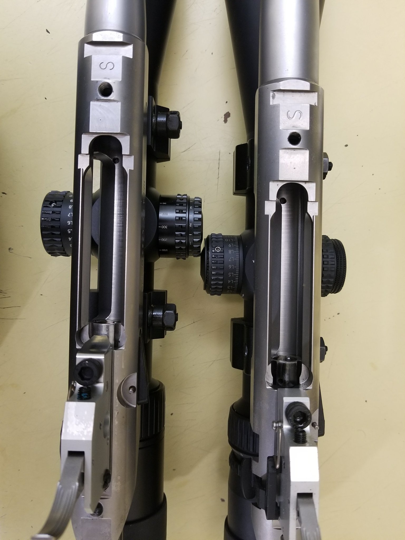

CTR and T3X receivers are exactly the same. There is no such cut on the CTR receiver. T3X left, CTR right.
I'm not sure if all T3X receivers have the transverse notch near the front of the bolt path cutout as shown above, but only the CTR in the regular T3 does. I have three T3 receivers and only the CTR one has said notch for the CTR magazine.
Reactions: WVHick
I think it is something they commonized in the T3X.
That being said, I run AICS mags in a T3 without issue in an MPA Chassis.
