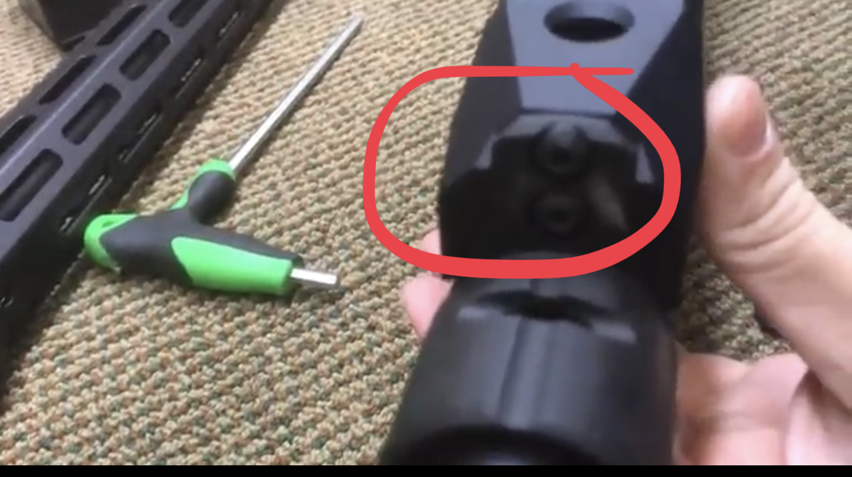

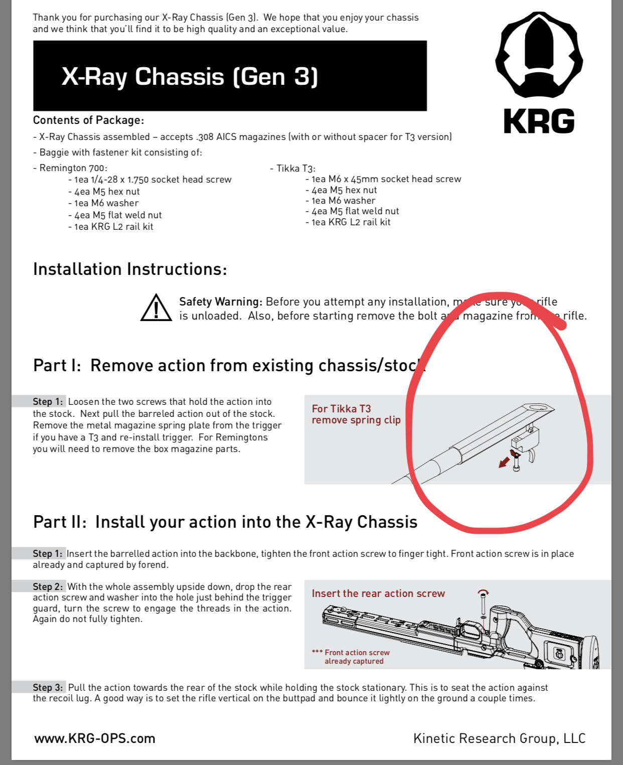

Question for those KRG owners...why do you have to permanently remove the spring clip (see picture) when installing your action to a the KRG chassis?
I mean, it's not permanently removed, it's held on by a screw... But yes it needs to be removed. It is what holds tension on the factory magazines that release from the front, AICS mags release from the back.
Got it..so just remove clip, reinstall screw. What about the barrel nut housing screws? Is there a place to reinstall those on the KRG xray?

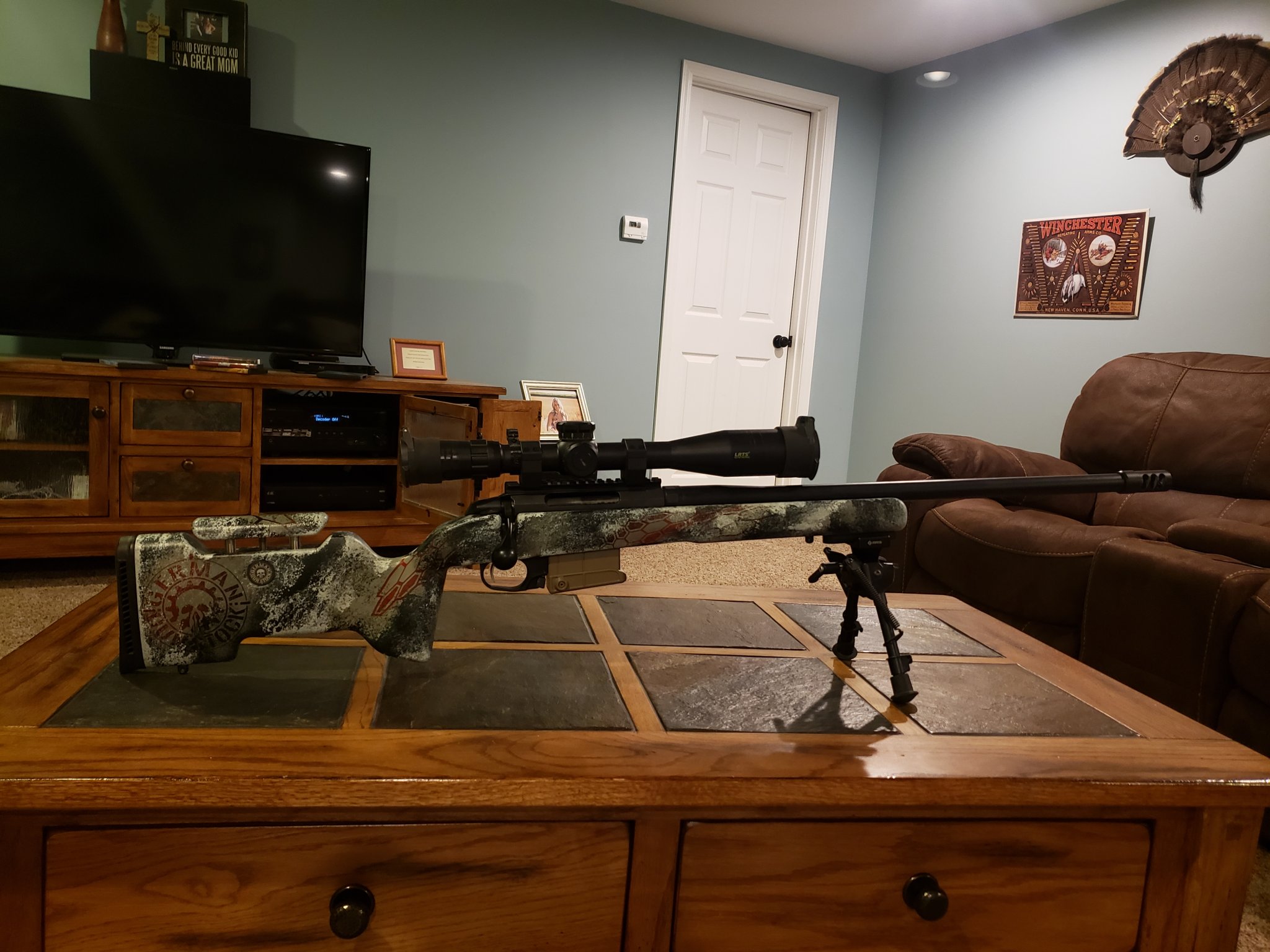

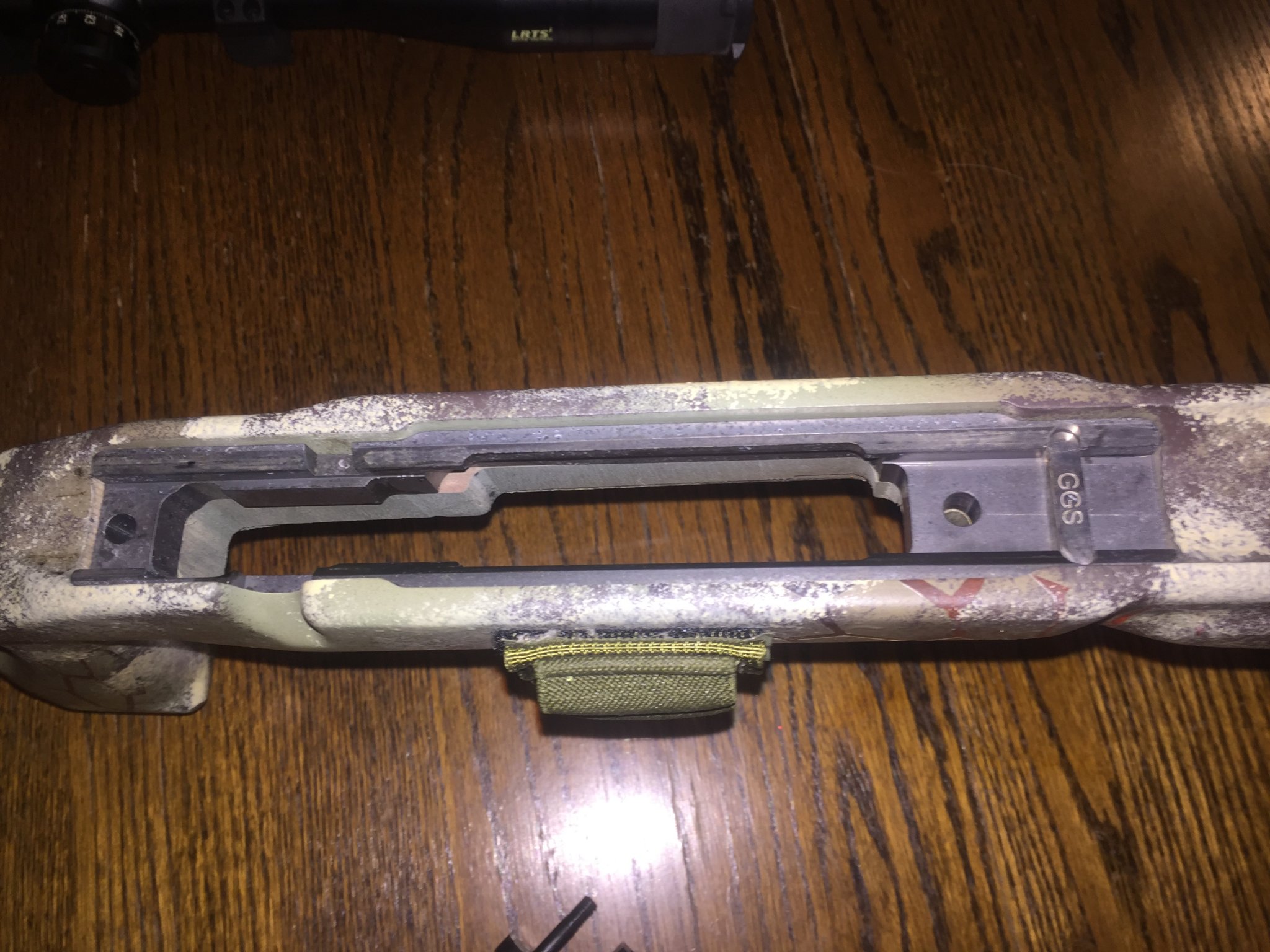

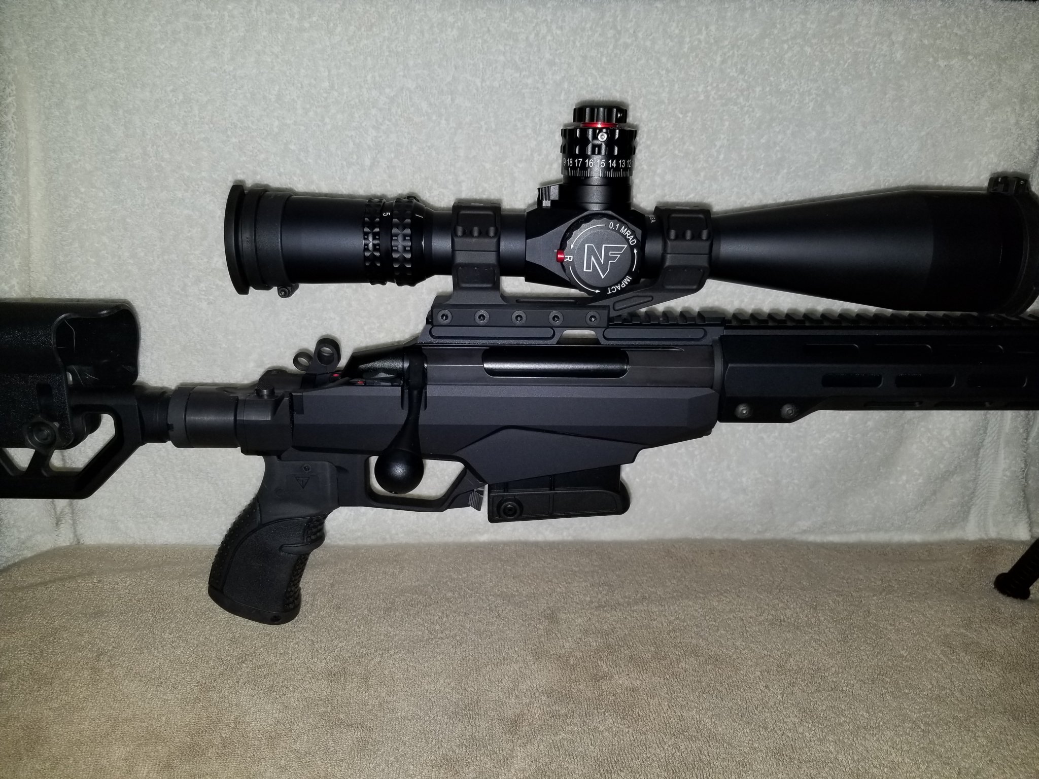

What chassis systems are direct drop in for the Tikka T3X Tac A1? I’m looking at swapping out to a fixed stock over the folding oem T3X.
German Gun Stock makes drop in stocks for the Tikka. They have 3 models, all with aluminum inserts that do not need bedded, but you will need bottom metal for them. Your TAC A1 has it built in. I have a CTR in their Predator and a Varmint in the Ranger. My son has a Raptor that will be here today. I have the factory CTR bottom metal on my Predator and Mountain Tactical CTR inlet for AICS mags on my Varmint.

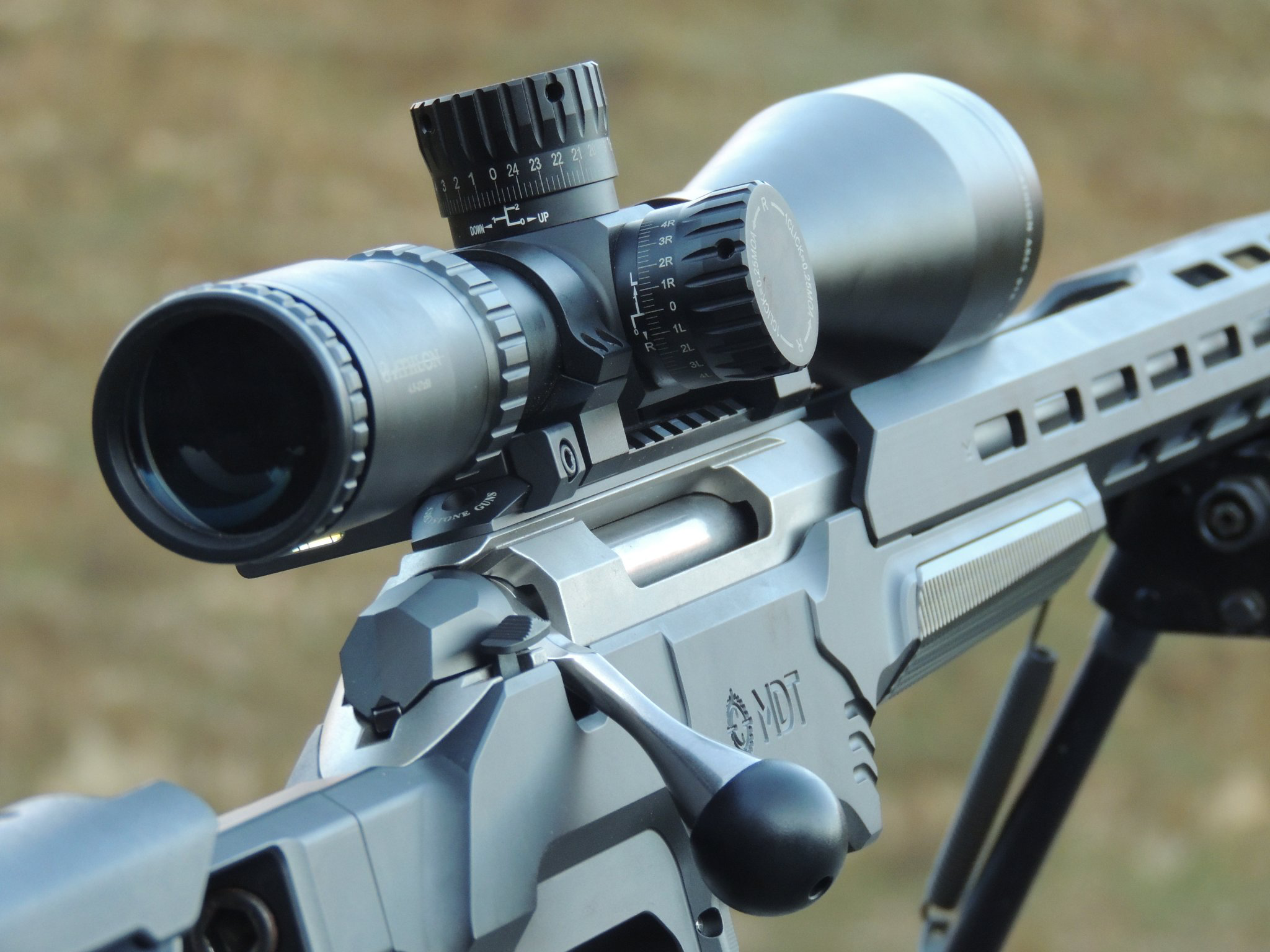

Tikka experts - Any advice would be appreciated:
What height vortex PMR rings should I use with my Tikka CTR and Vortex razor gen 2 3-15x50. Im using the base stock that came with the gun
I used low rings with a Burris XTRII and had to use a stock pack. I did have a 20 moa rail on it though.

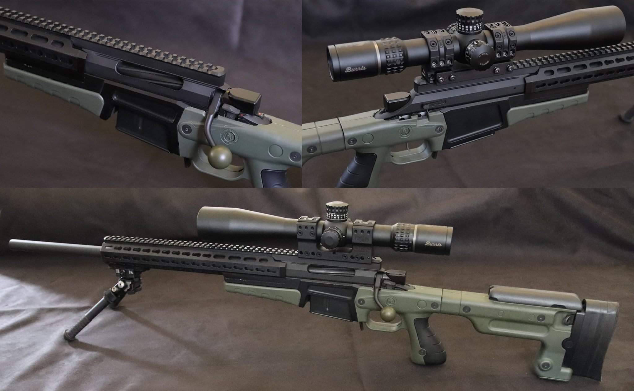

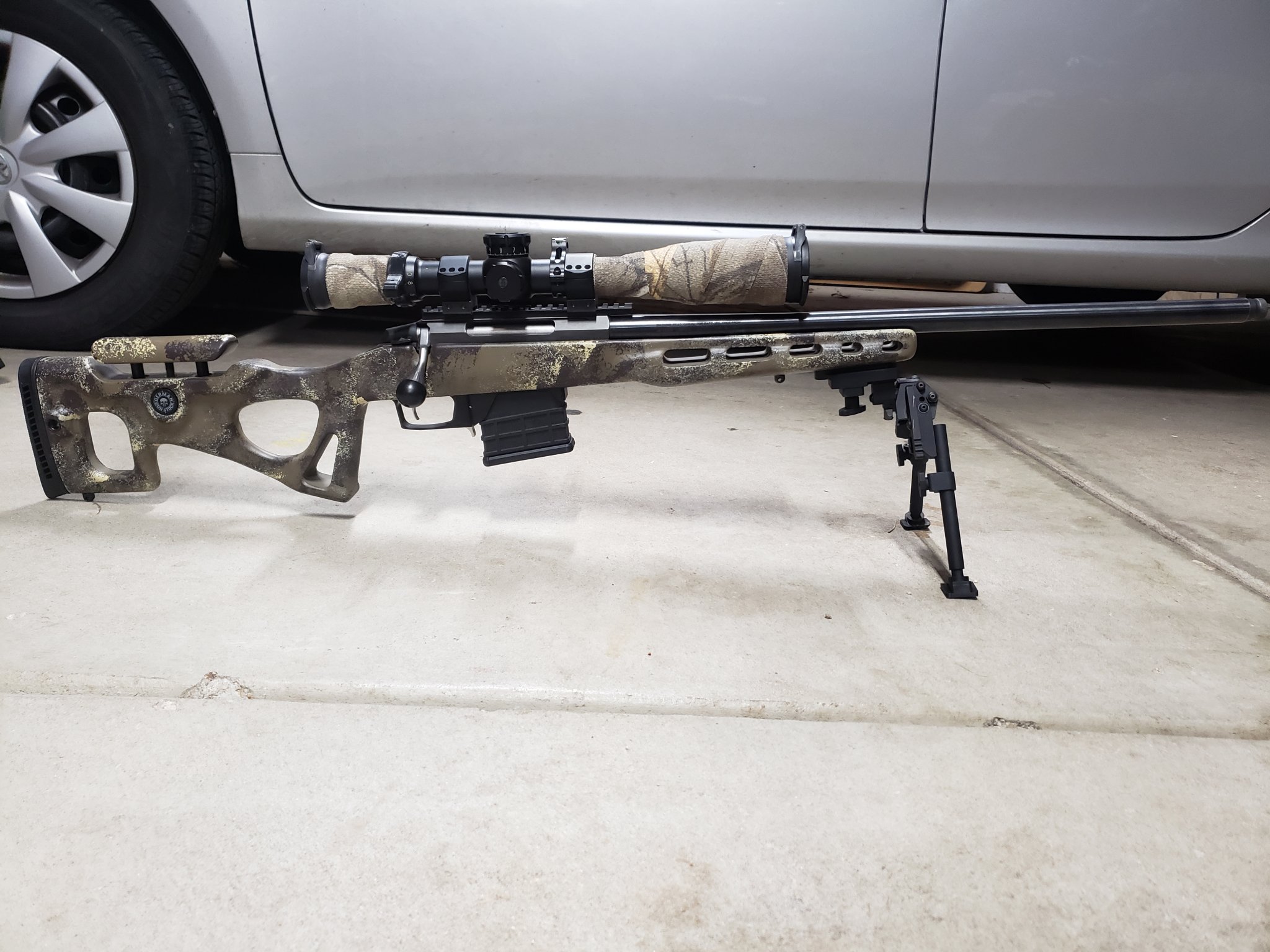

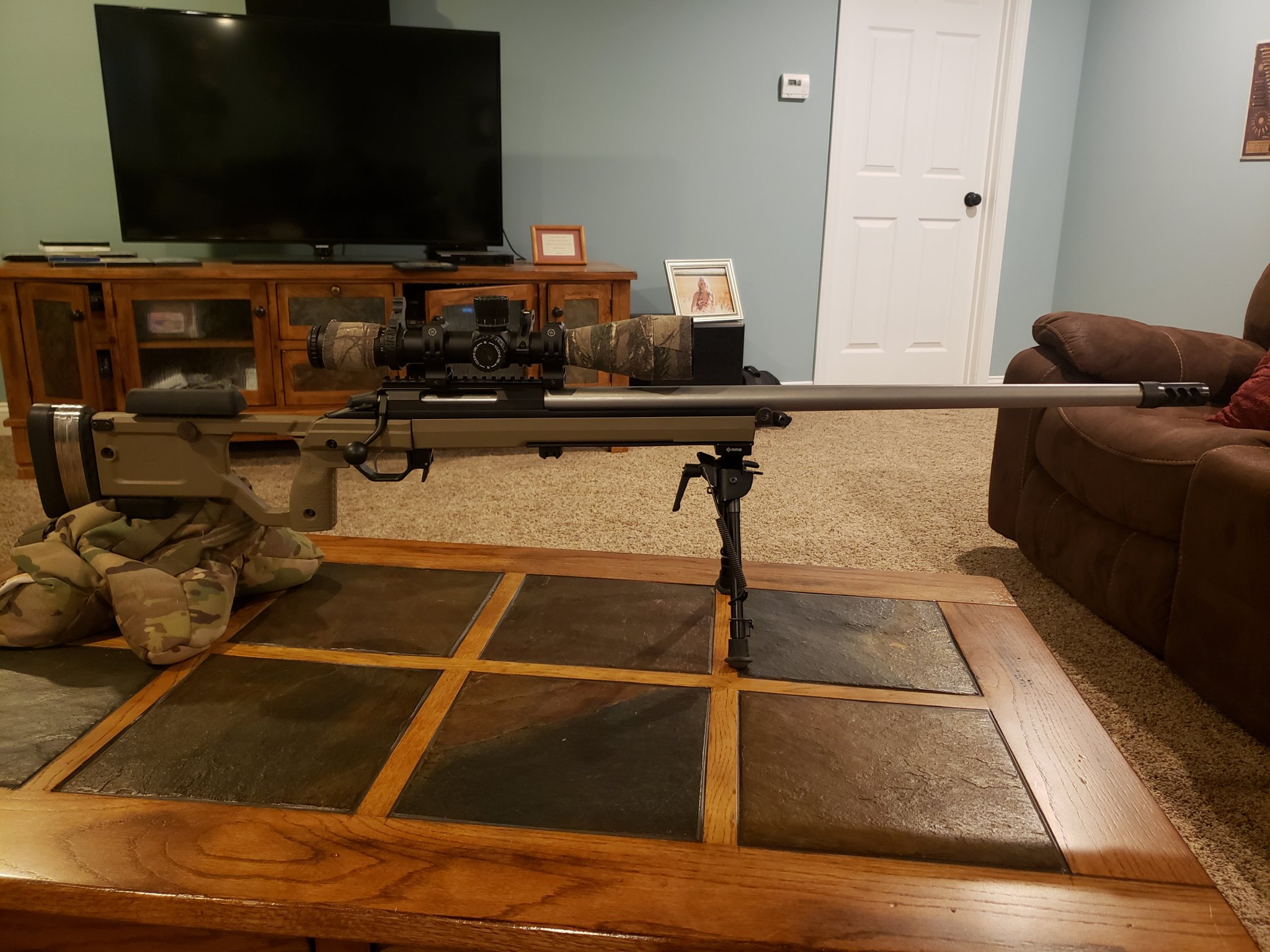

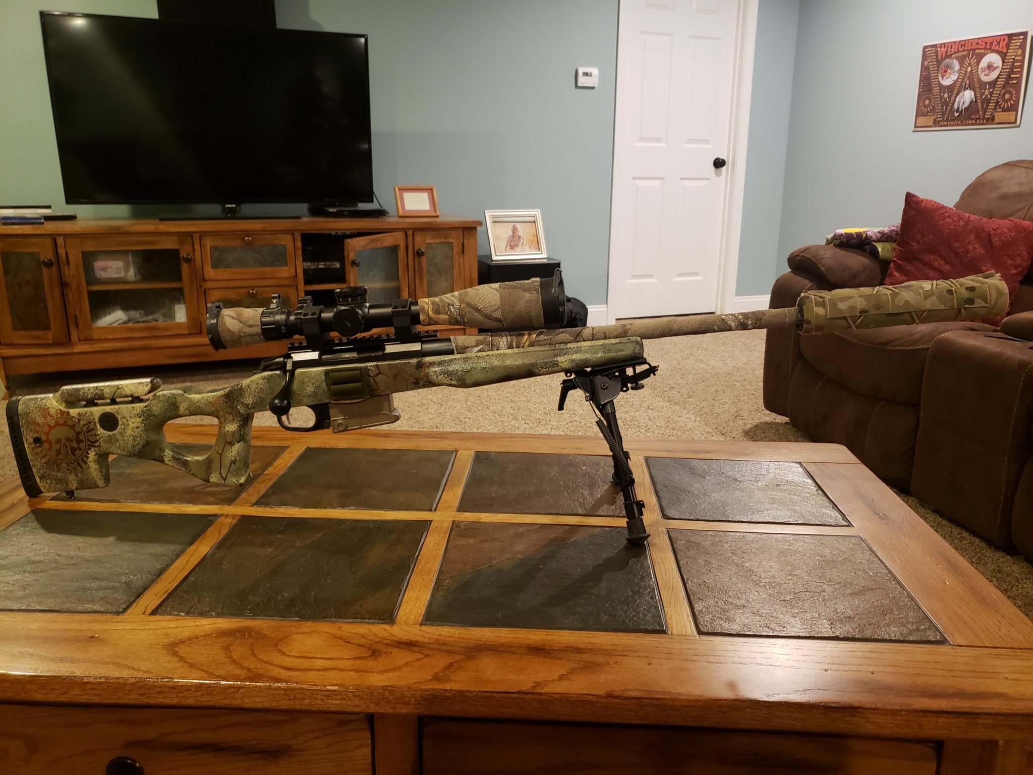

I picked up an X-Ray on here used. Was going to get the Bravo, but this was a better deal. I have added a spigot to it since these pictures were taken.
Nice! What Tikka barreled action did you use in the Xray? I’m still a little confused on how the Tac A1 action will work in the xray, because it looks different than the normal T3X? Other than the front two barrel nut bolts that I posted a picture of above, is the Tac A1 a direct drop in for the Xray chasis? What about how the scope rail lines up on top?
I used a T3 action with a 26" light varmint Bartlein. It is a match rifle I built for PRS matches. It started as a 270 T3 Lite. I used the action and the trigger. All Tikka T3 and T3x actions are the same footprint. The TAC A1 is the same as a CTR.

From KRG (regarding Tac A1 fitment into Xray)
It will fit just fine, but you will have to remove the current chassis components, including the barrel ring that holds the forend. Our chassis come with the proper action screws (x2) and that is all you will need, to attach the receiver. The existing rail will work but it is really tall, you might want to look at getting one that is more of a standard height.

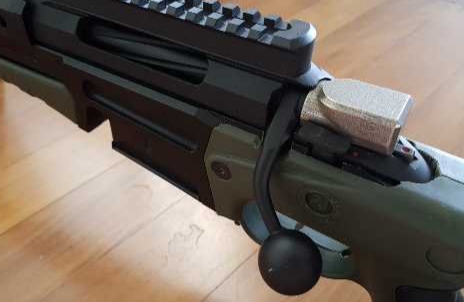

Yea I saw that but that’s not what I’m talking about. I’ll keep looking. I seem to remember someone made it custom and said they might sell them.
Roedale has one too with the three position safety. Although I think it's the same one someone else posted above.
Ive got a few people interested but they have to be 3d printed (can't be machined), so theres a fair bit of hand finishing. Got a heap of other products to make at the moment but might do some more metal 3d printing and see what people think.
Why can’t it be machined? I run a machine shop, I might be able to figure that one out... PM me if you’re interested, maybe I can help.
Reactions: cannoncrossfire
I work at a machine shop too and it's maybe possible with 5 axis and a tiny ballnose haha. The issue is the round front changing to a square back - but the transition is on an angle due to the shape of the back of the tikka action. It might look simple but to make it is another story.

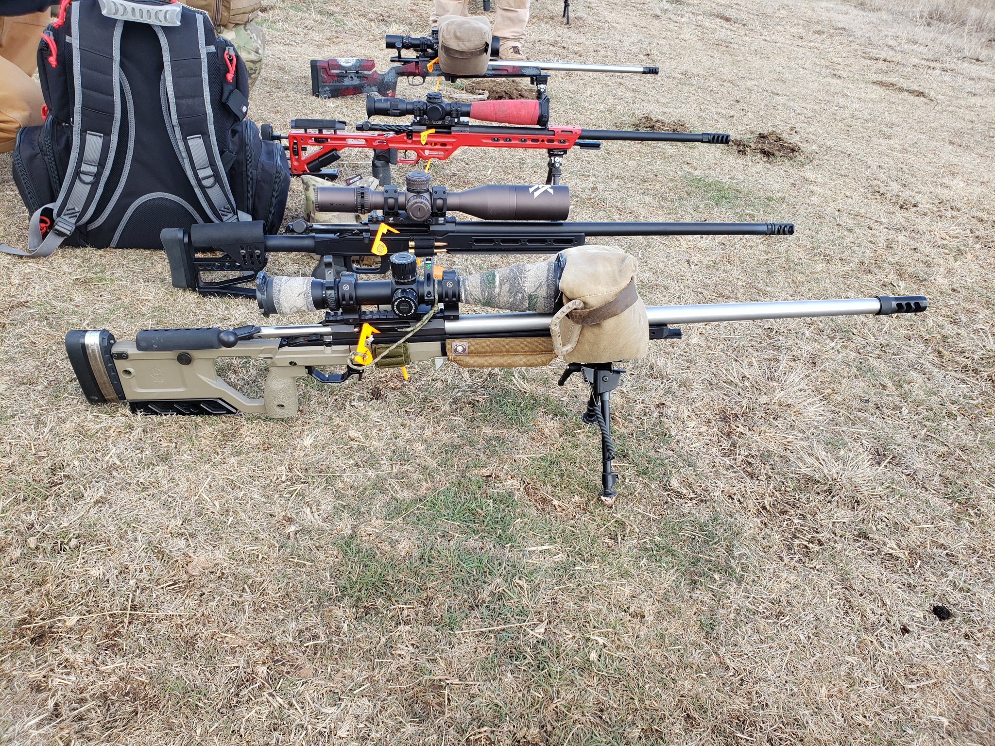

For those of you with the Bravo how is it? I've had an X-ray before and like it for what it was but it never felt as steady to me as a McMillan or Manners, even with the Spigot. Just got the 223 in will be doing load development this weekend. Grayboe keeps hinting that Tikka T3 inlets are coming but idk how far away that will be. A $350 renegade would honestly be what i want as of now. If i'd had the money i'd grab another PRS to mimic my Tempest. Still waiting on the next sterk shipment as well, other than that everything is in place. Just need something besides the factory stock and DBM.
I’d put the XRay and Bravo next to each other. Reasonably well-balanced and stable, especially with the spigot mounts, but they don’t compare to a PRS1.
