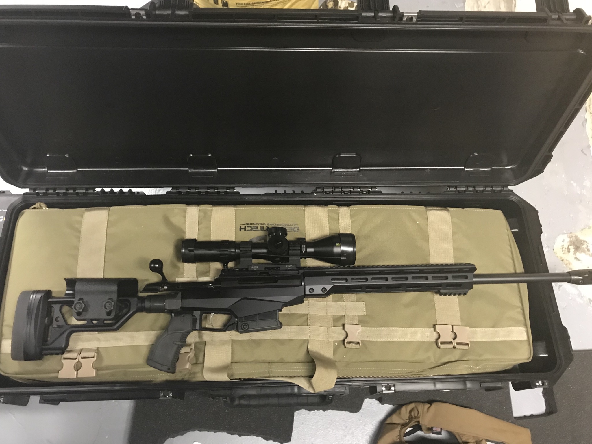

I have 2 of the ARC M10 QD-L, one of which on my Tikka Tac A1. I really like these mounts.
On my Tac A1, I am running the “High” model (1.57” I think) with a 34mm tube Athlon Ares ETR and 20 MOA incline. With defender flip caps, it just fits to clear the handguard/rail.

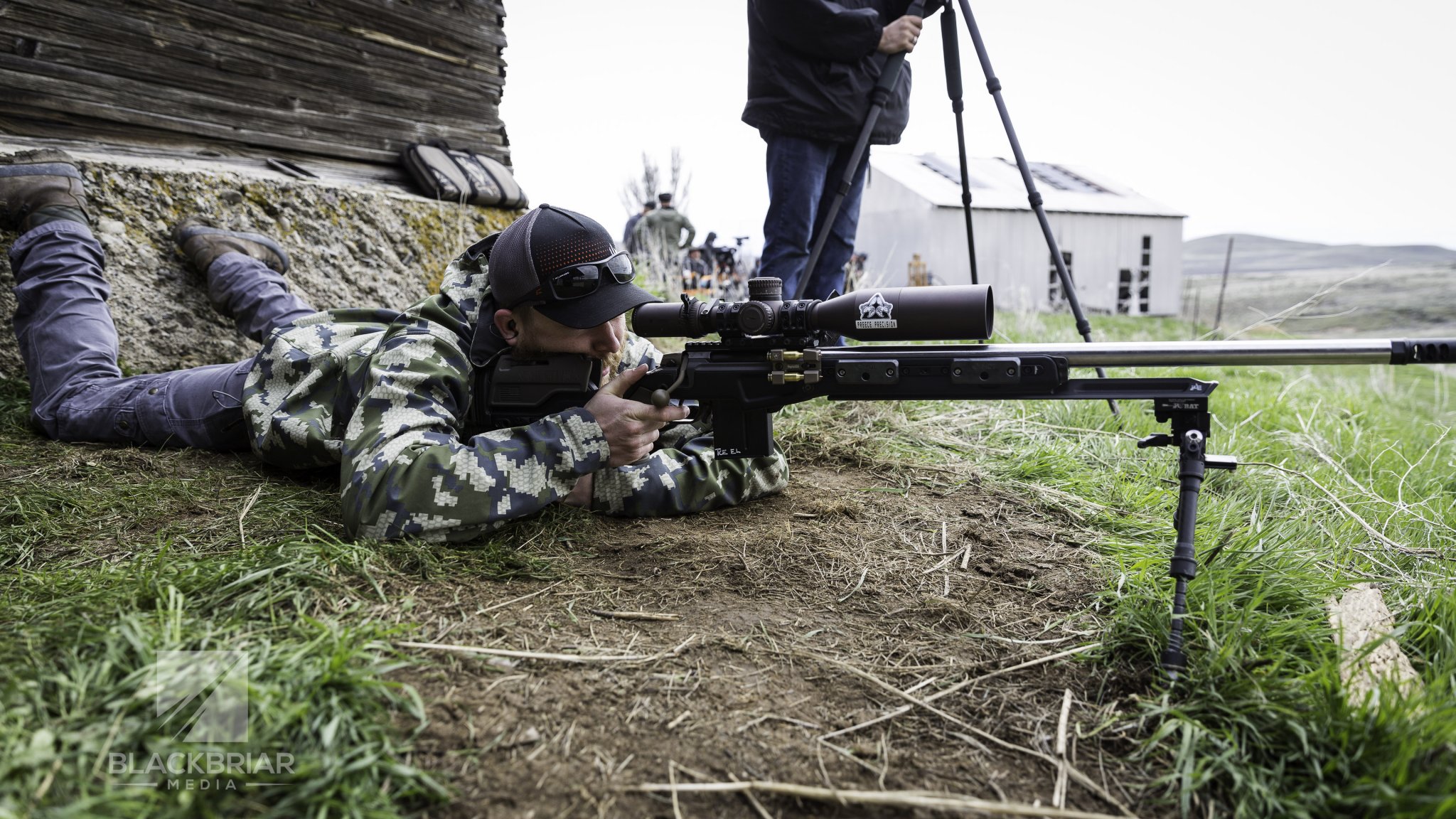

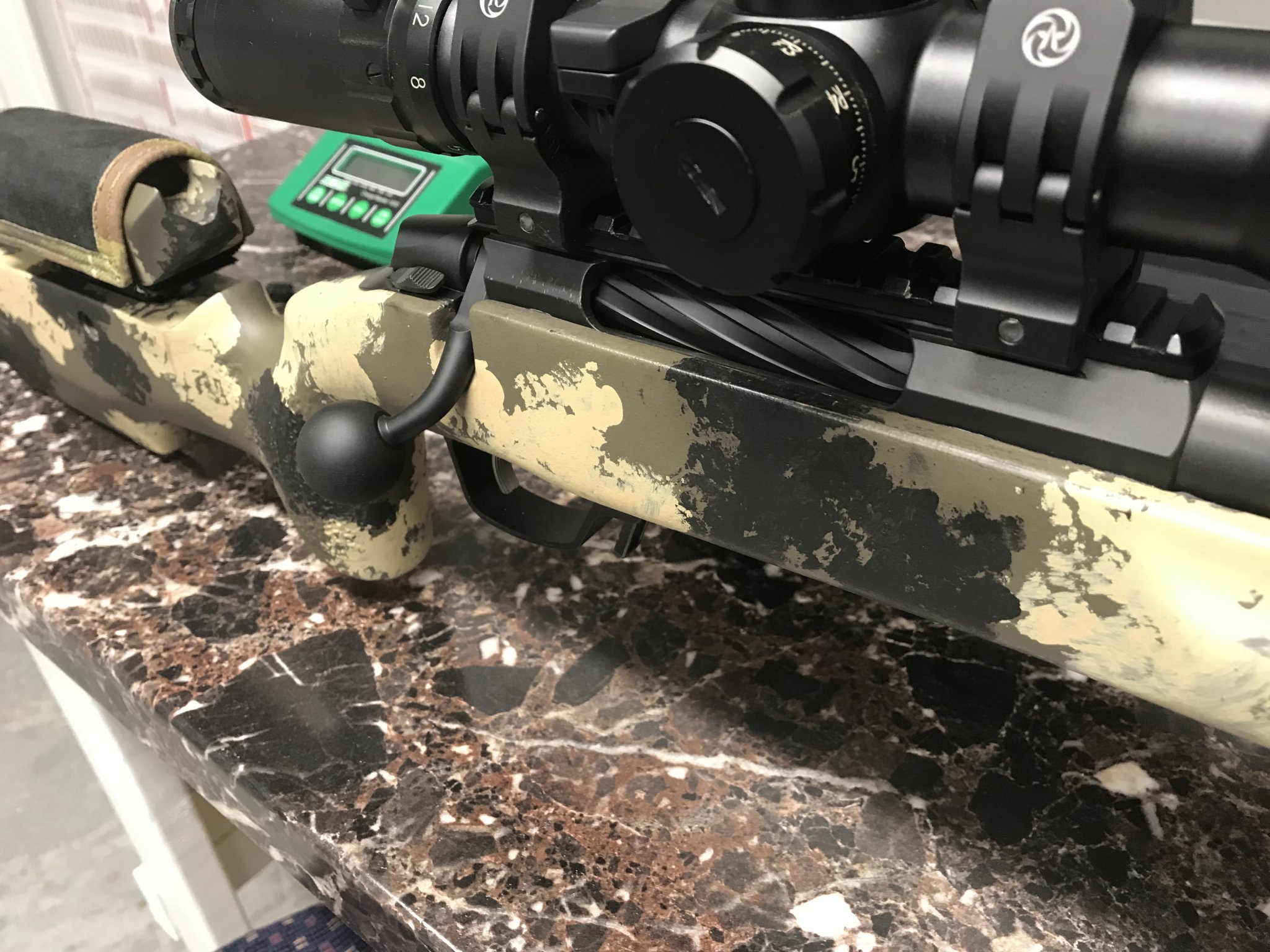

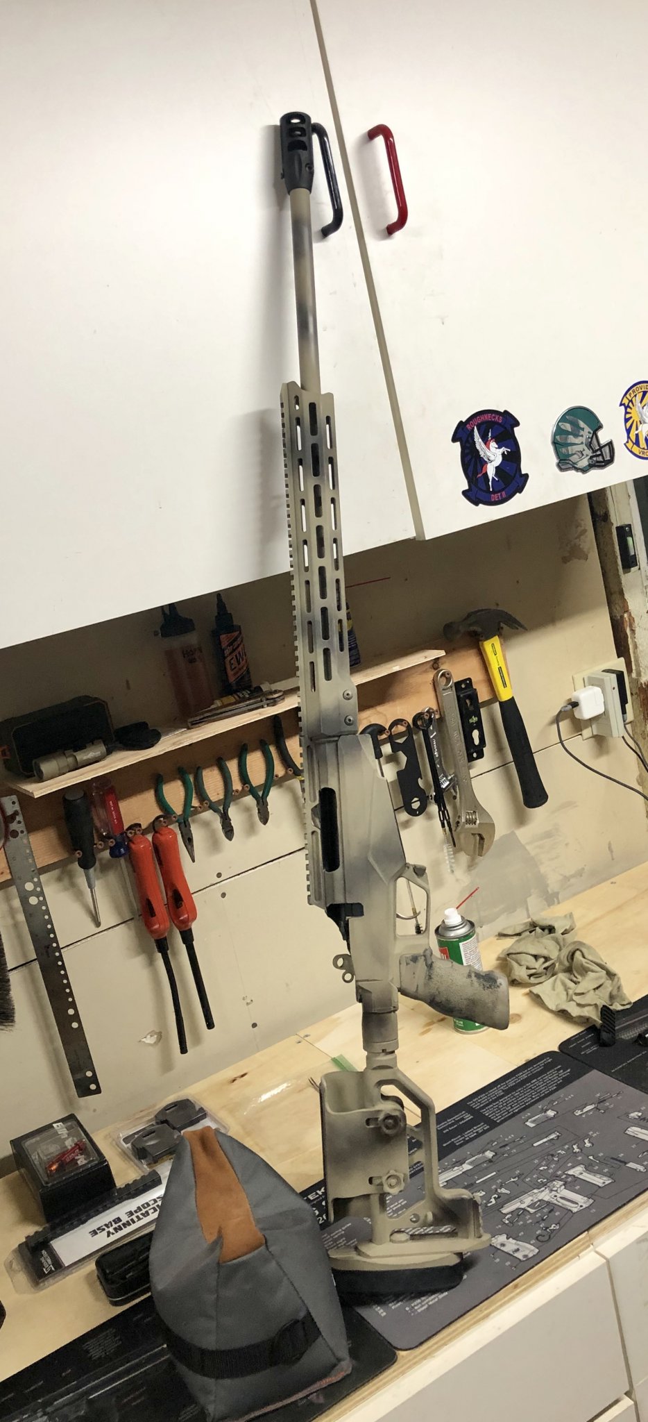

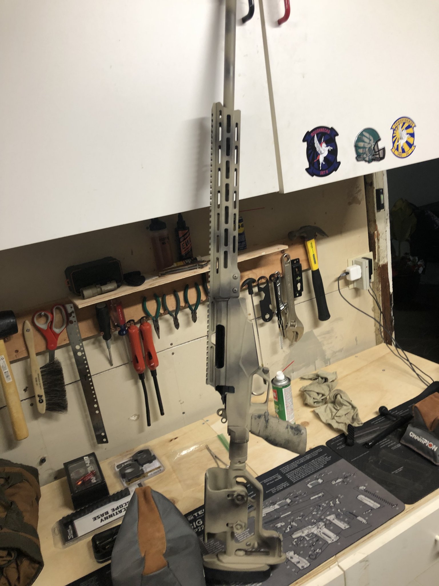

Tikka Action
Proof Competition Contour chambered for 6Creedmoor
J Allen Chassis
Timney 2 Stage
Vortex Razor Gen2
Sphur Mount
Sterk Swept Handle and Gen2 Shroud
Barnes 112Gr Match Burner w/ Barnes Brass
Evo Bipod
Sawtooth Rifle rails with MDT weights
Little Bastard Muzzle Break
Rocky Mountain Mayhem Sponsored by Vortex Optics National Match put on here in Utah. Alot of great shooters and a blast to shoot.

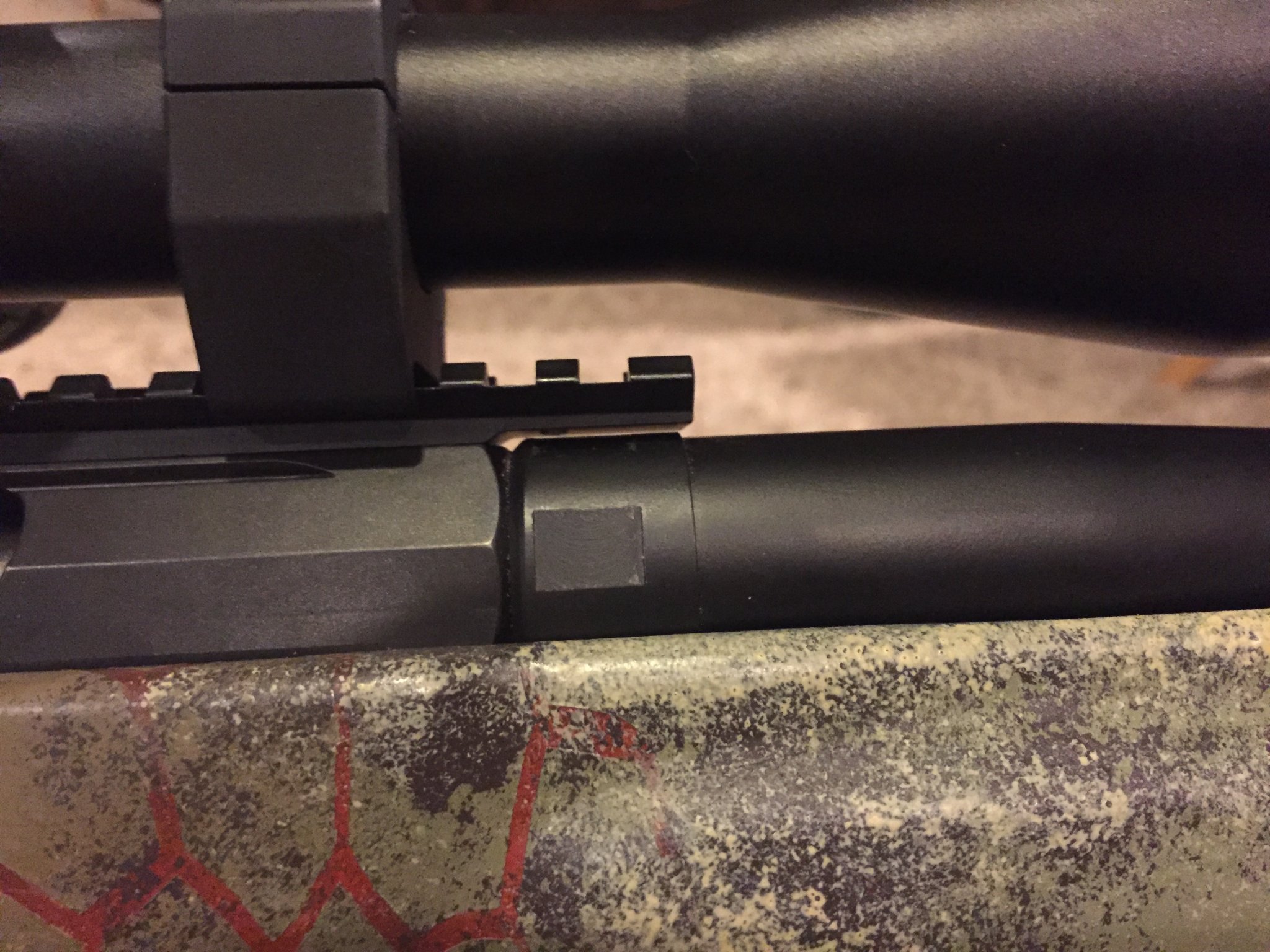

Anyone had the chamfer taken off their receiver face and/or machined off the receiver side of a Bugholes magnum nut to match, that knows how much one would take off either/both or the resulting OD? (Yeah, I know it's not exactly an OD being it's a hexagon.)
I need to take out >0.150" up to 0.250" from my receiver-barrel nut-barrel shoulder interfaces to fix a minor oops. I'm planning to get the receiver Cerakoted anyway to cover up some marks I put on it trying to wrench my barrel off, so I'm kinda inclined to get the chamfer taken off the receiver and shave the nut down to work.
Only catch is my MT rail is contoured to the curved part that would be chopped, so before i ring the bell that can't be unrung, I'd like to know what's coming off of where and hopefully convince myself I wouldn't need to have the front of the rail machined too to clear the barrel nut, and then have it coated too. ?

Are you going magnum caliber with the Bugnut? I have his original size on a 6.5 Creed and it works pretty good on a medium palma. His new Tikka nut is smaller and blends better. You have to use a small shank savage barrel for it though.
Nope, 6.5CM, basically same as yours- it's a medium Palma with the chamber area taken down to 1.20" to fit under the magnum Bugnut.
Simplest solution would just be to have the "shoulder" pushed forward enough to headspace, which doesn't even need to be super true since nothing's riding on it and the Bugnut "shroud" will hide it. But since I'm wanting to get the receiver coated anyway, and I need to shorten somewhere in there anyway, why not get the receiver milled to a flat face, and take some of the receiver side of the Bugnut off to increase the OD? That also avoids the theoretical downside to Option 1, which is that I'd be adding another ~0.15" of no threads where the nut will be riding, on top of the small amount present already between the end of the shank threads and the "shoulder".

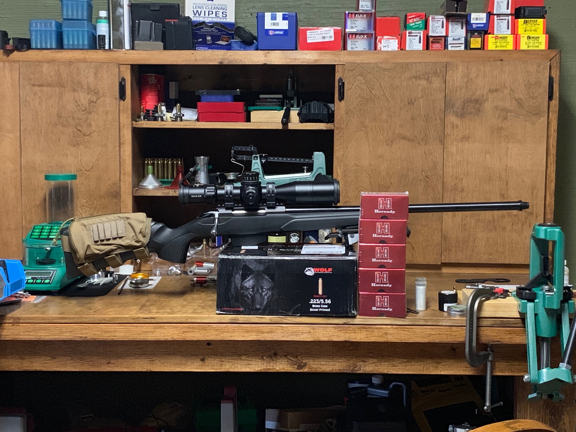

Been meaning to get the wolf brass for some time haha i couldn't help myself with the ELD-Ms hoping they shoot, which i'm assuming they will and i'll be able to find a load for them. If i had the money there is a PRS1TK flat top at Manners it would be here in a month, though i'd probably ask them if i could make it a PRS2. Also just sold my EH1 to fund a PRS2 for my Impact 737R so that puts more hindrance on the stock selection for the Tikka. Though Grayboe keeps telling us it's coming so i'm really leaning toward a Renegade, despite not wanting the butthook, for $350 i'll put up with it. Ready to get the Sterk Bolt knob and shroud in too. Tikka bolt lift with that little handle is a tad stiff.
I feel like they shouldn't have issue though right? I mean a Flat top stock is a flat top, other than the butt hook and comb difference is there really any difference in laying the tikka Mini-chassis in a PRS2?
