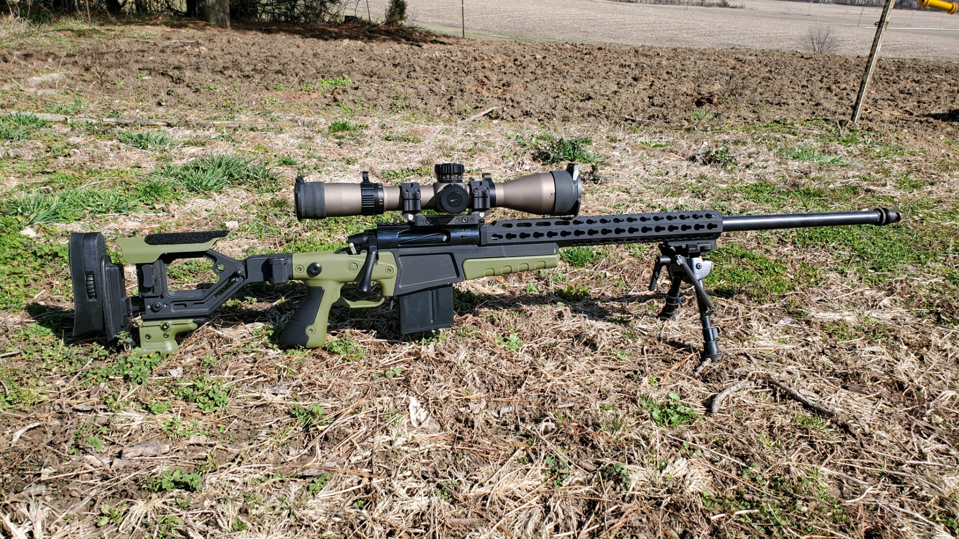

I say origin all the way, I did one last year and couldn’t be happier with how it turned out. It’s currently my do all rig in 6creed, and smokes pretty much everything it connects with.
