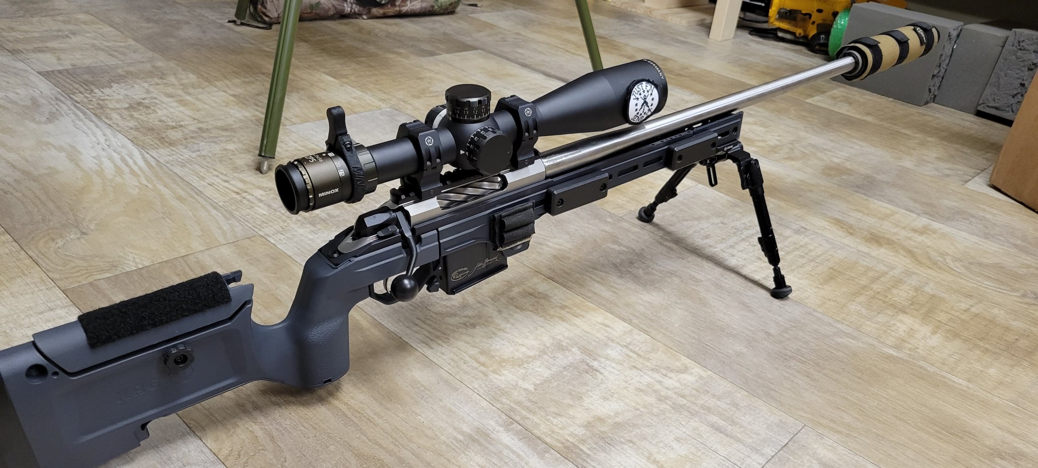

Just wanted to follow up. I ended up with a used archimedes and just got the barreled action back from my smith.
Initial impression was just ok, action only had a few rounds through it before I got it and it felt kind of rough when cycling the bolt. I’m also not crazy about how much slop is in the bolt to action fit. Mine wanted to bind at the very back of travel. After cycling it a ton it has smoothed out nicely and I’m getting used to how it likes to be cycled, more of a neutral push pull vs my bighorn I have to keep downward pressure to get it to run well. I love the bolt knob, such a great design!
I got to test the pivoting handle extractor. My new barrel is a tighter chamber than my old barrel so the brass was not fitting into the chamber. I forced a few and the extraction definitely works and boy does it launch brass!
Took it out for pressure testing loads yesterday and it feeds the 6br like greased lightning, very smooth and no issues vs my bighorn. In use I didn’t really notice the pivoting bolt handle, while sitting on the couch it’s pretty obvious. The mechanical ejector is really nice, where I shot there was tall grass and the ability to just dribble the brass out was nice. The CRF seems to be working and I believe is what contributes to the better feeding.
Here are the very first 3 rounds out of the barrel. Shout out to Fisher T&C off here that did the work. Super fast turn around and so far, seems she is going to be a shooter!
