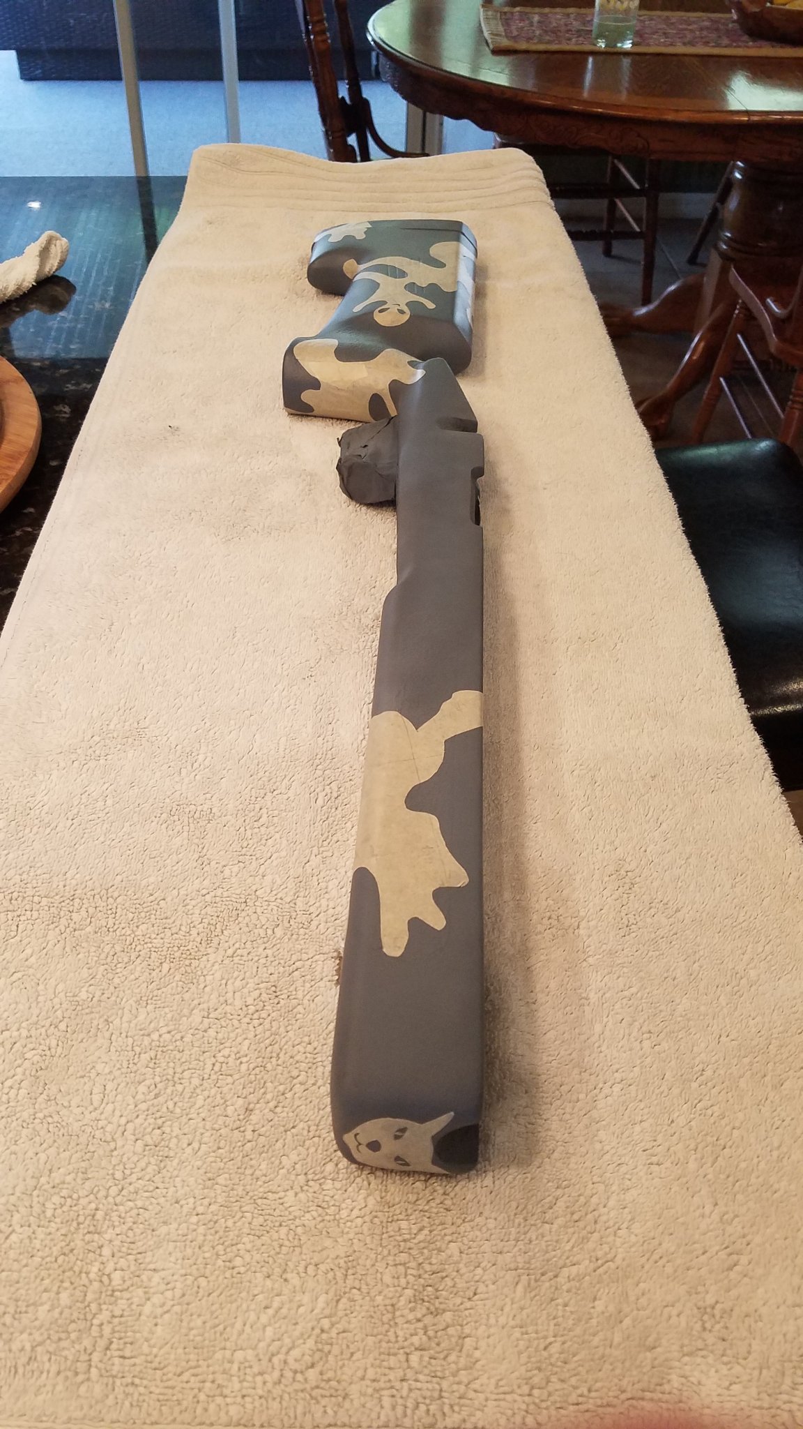

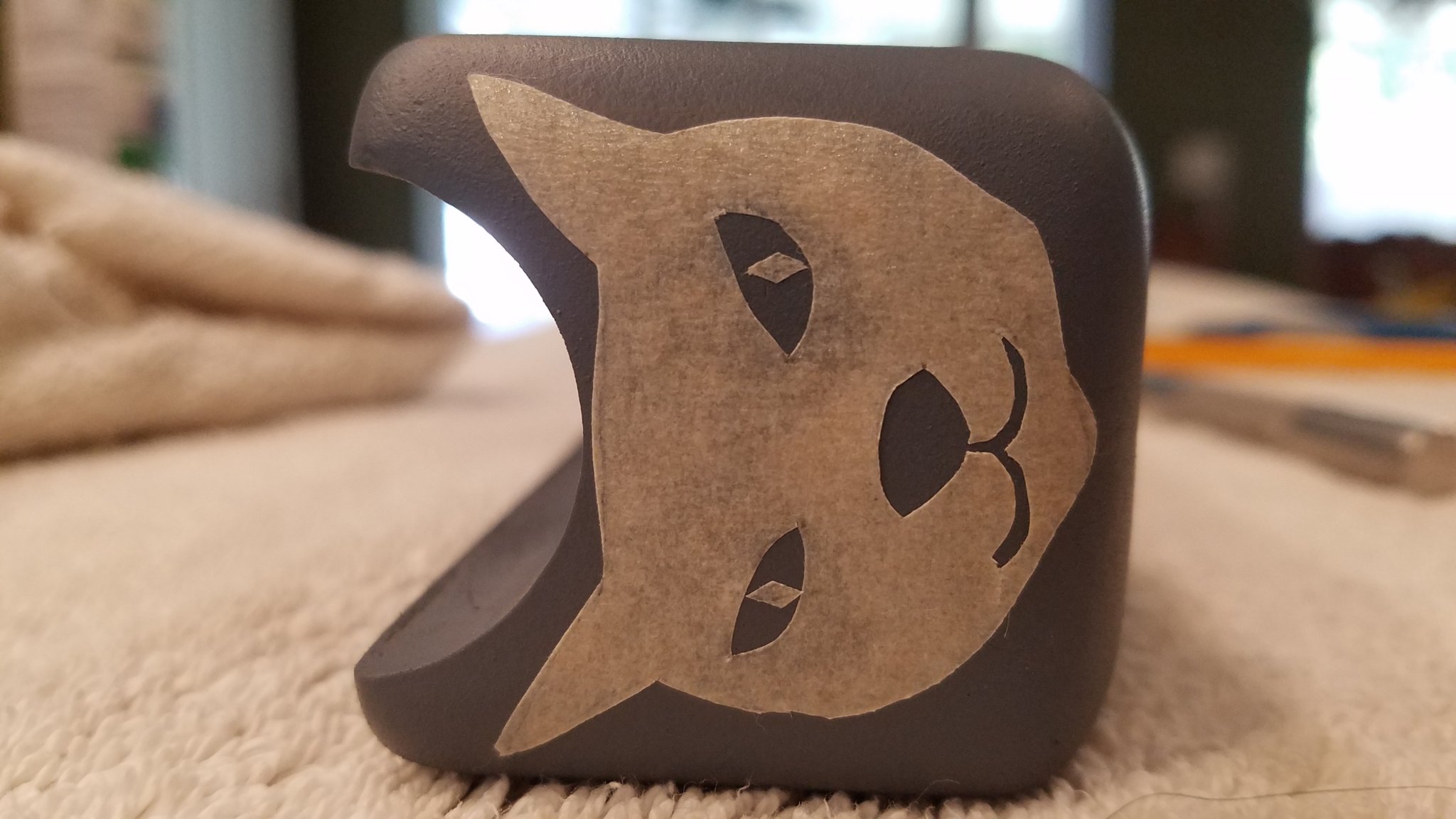

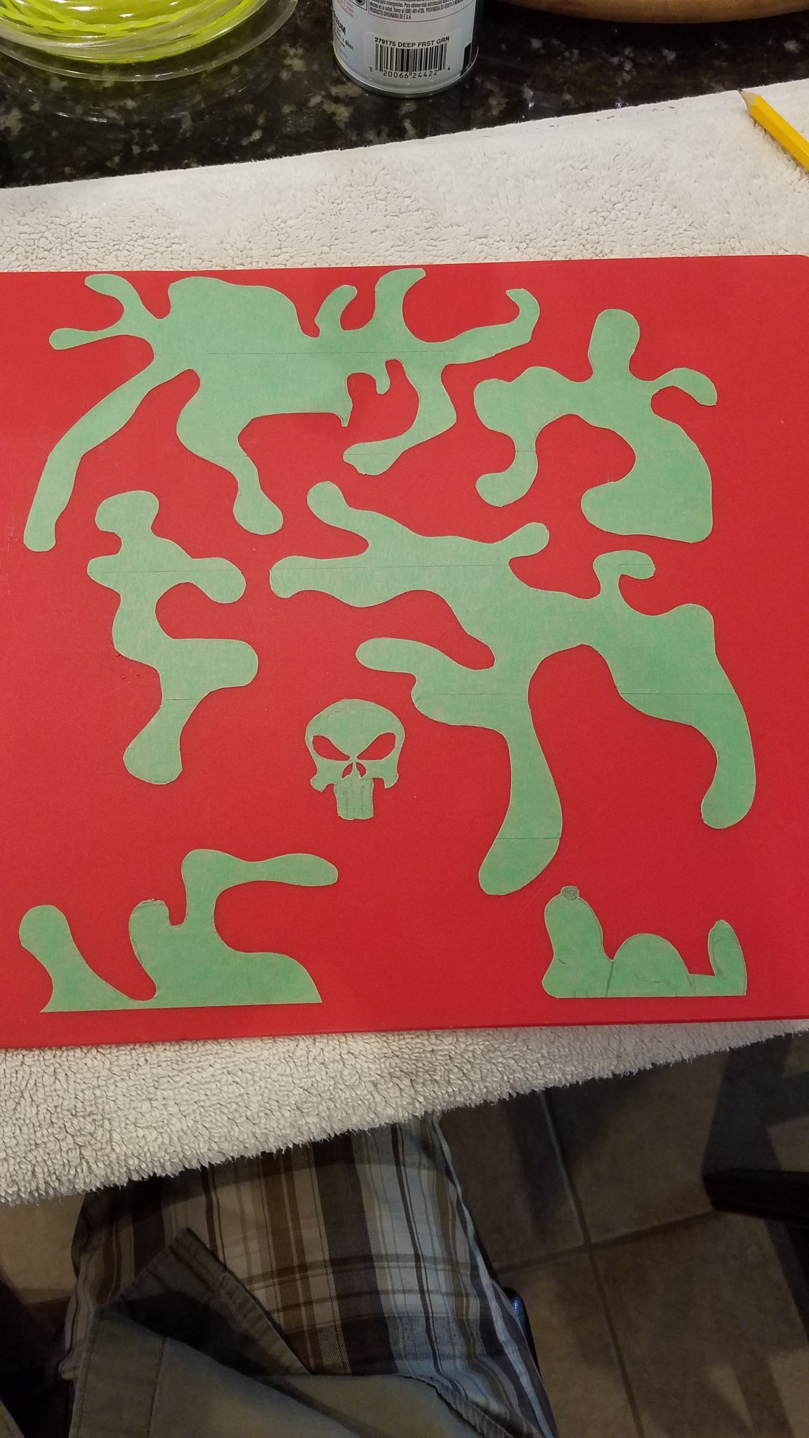

One of the stencils I made for my first complete failure of a camo paint job.
I present, Bancat.
I just ran rows of tape on to a thin cutting board and drew out the patterns I wanted.
Transferred them to the stock as needed.
The patterns were easy to make, but my color choices didn't blend well.
So, I repainted it two days later using the sponge technique.

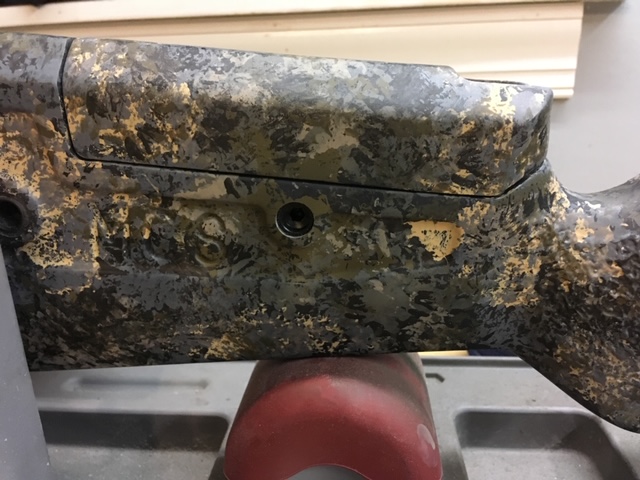

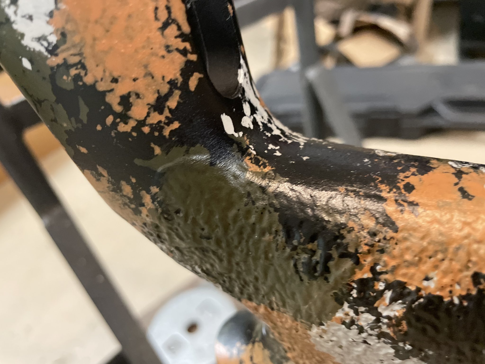

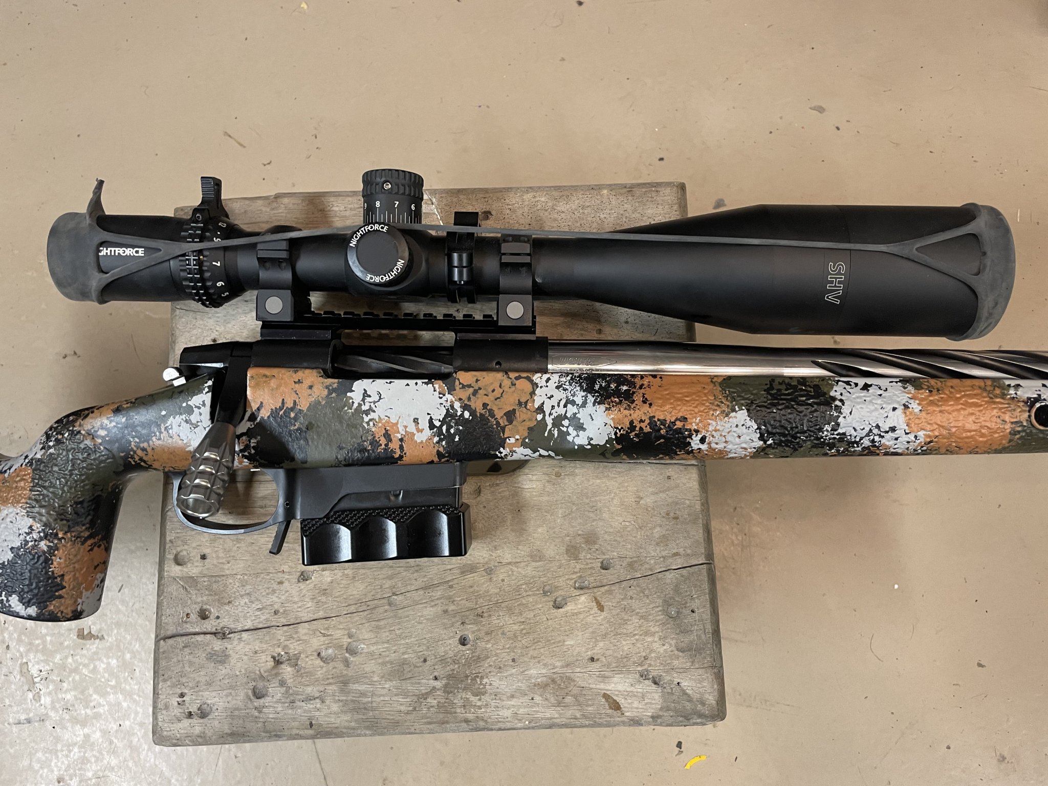

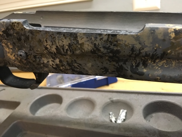

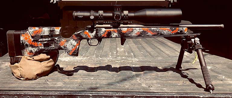

I've done quite a few, just using spray paint. Actually pretty durable and easy to touch up or redo of you want. I usually hit it with matte clear at the end. I've used stencils both made and purchased, most of the time I just use sponges anymore. The bergara here I originally did B&W with some gray. Since it's mostly a range rifle .22 I thought I'd add some color. Couldn't find a sponge at the time so I used a piece of red scotchbrite for the orange.
You can some cool stuff with just a sponge
(Manners cover-up)

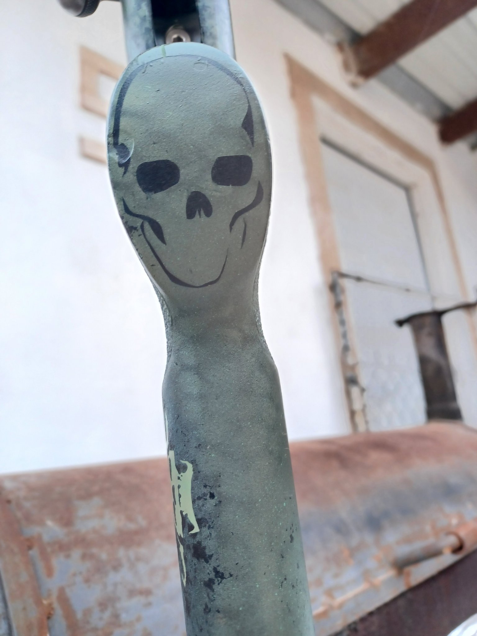

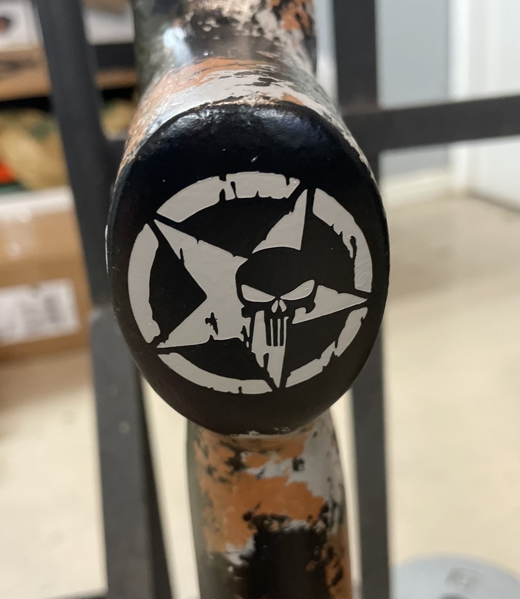

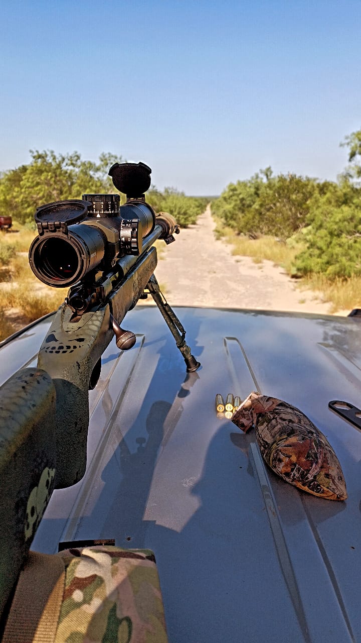

I did something similar to my SPR. I know it looks like the skulls are all along the sides of the stock. However, there's a few hidden around. I put some at the very front just like you did with the bancat.
I did forget to paint some black around these though, so they could stand out more.
And then there's these other hidden ones as well!

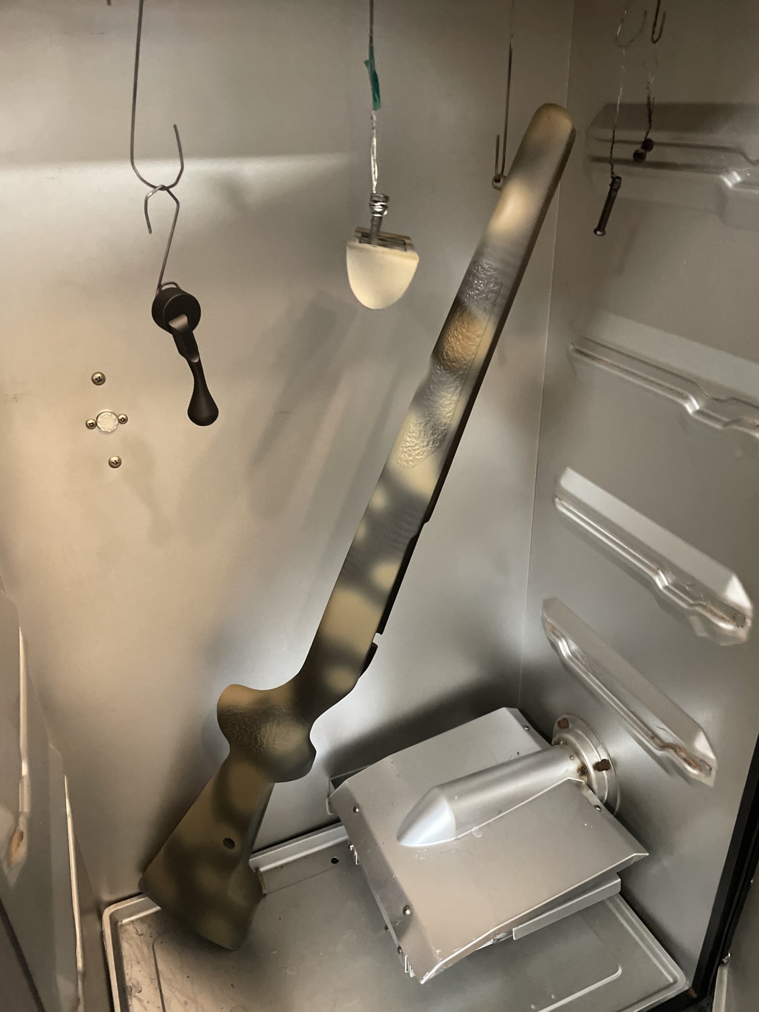

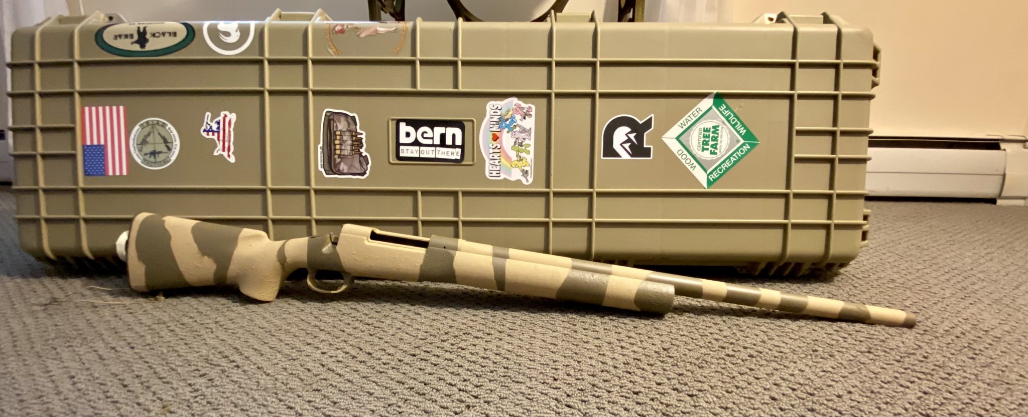

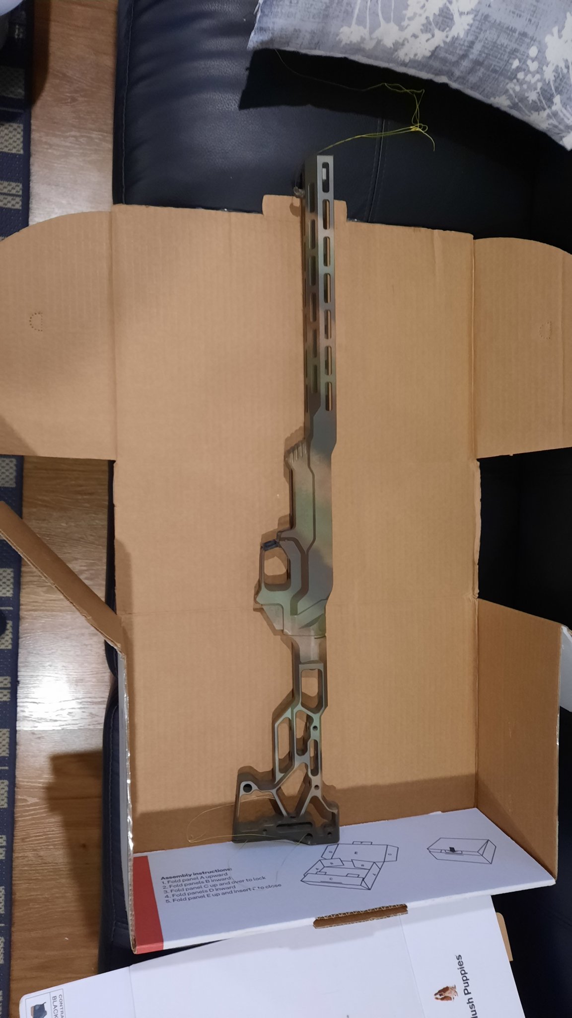

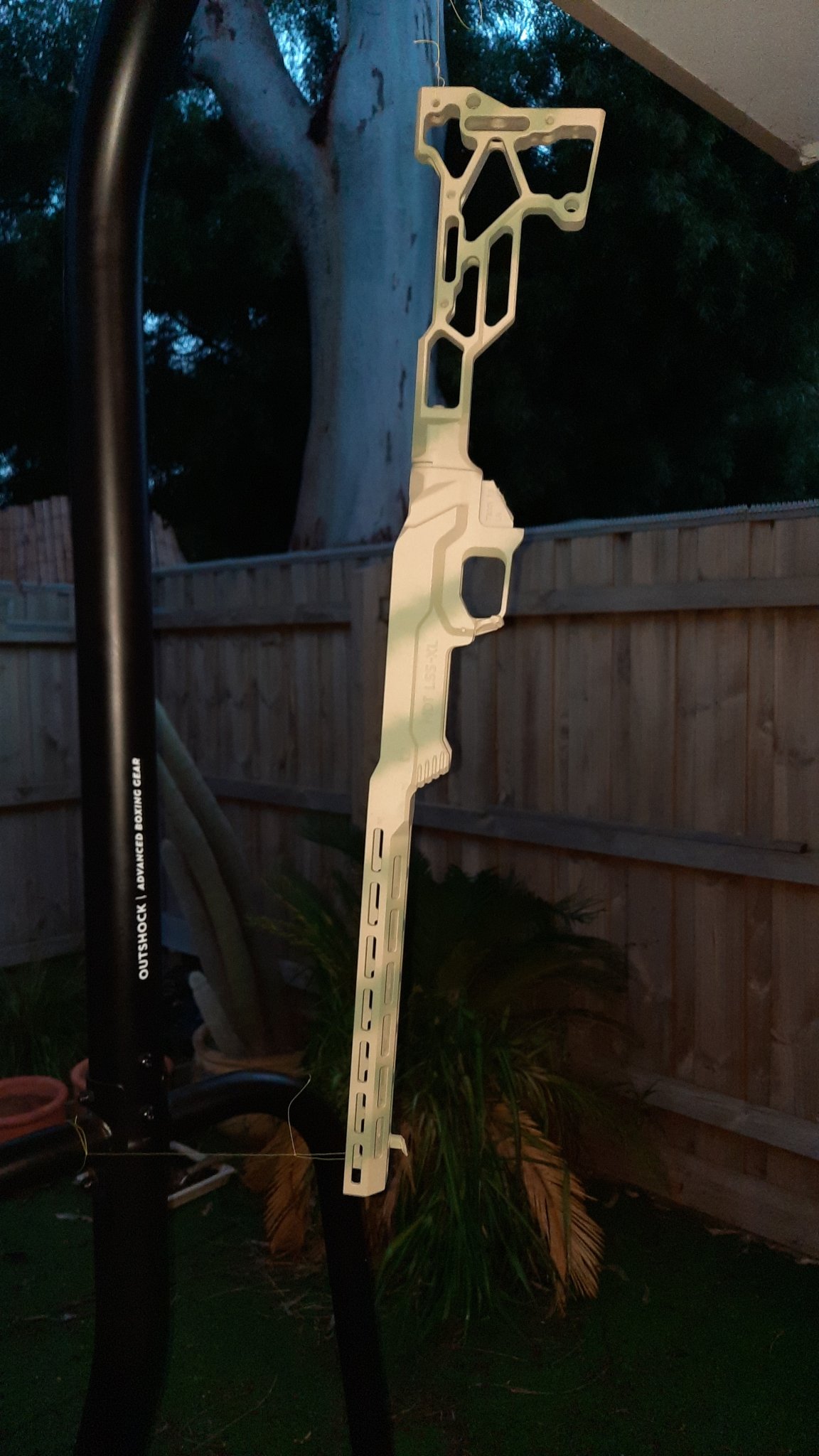

Do it! There are heaps of videos and pics for inspiration. I've probably painted 20 firearms over the years and the first 5 of those were paid for by Her Majesty The Queen, rest her soul. I can see why there would be some nerves before your first paint job, especially after spending hard earned cash on a rifle/chassis.

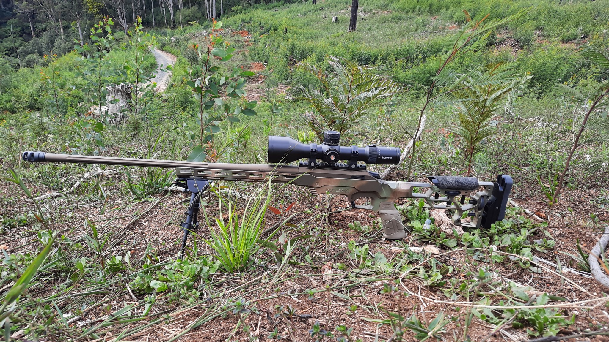

I used rustoleum camouflage paint and stuffed it up first time. The joy of it is you can strip it with thinners and start again! I'm really pleased with the finish of my latest spray job. Practice on card or something to experiment with patterns before commiting.
The good thing with distorted patterns is the more random the better, so no need to worry about accuracy with the rattle can. And I find less is more.
Get 4 colours, start with the lightest and do a base then build layers getting darker each time. That's my method.
Enjoy!
Enjoy!

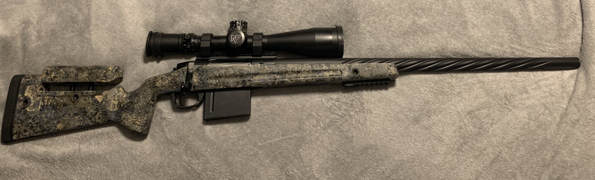

all those layers...howd you miss the scope ...lol
