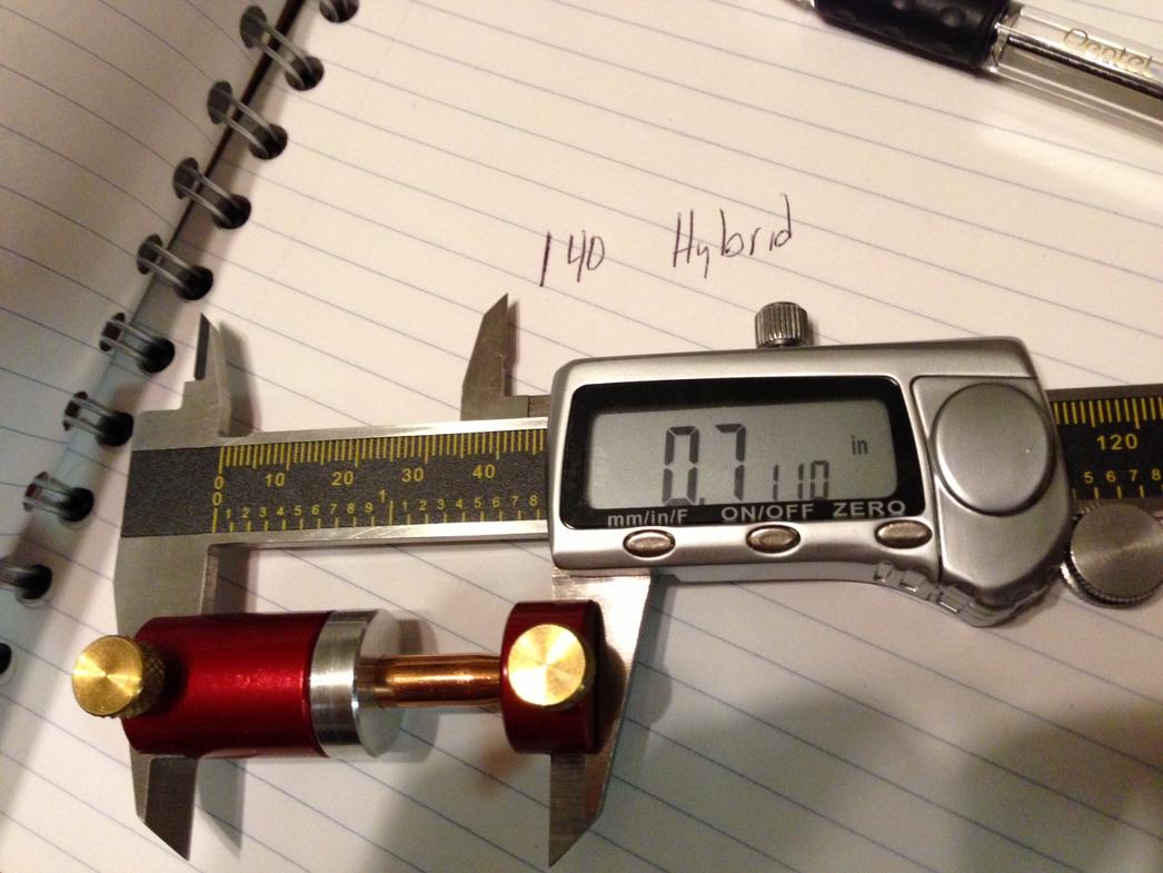

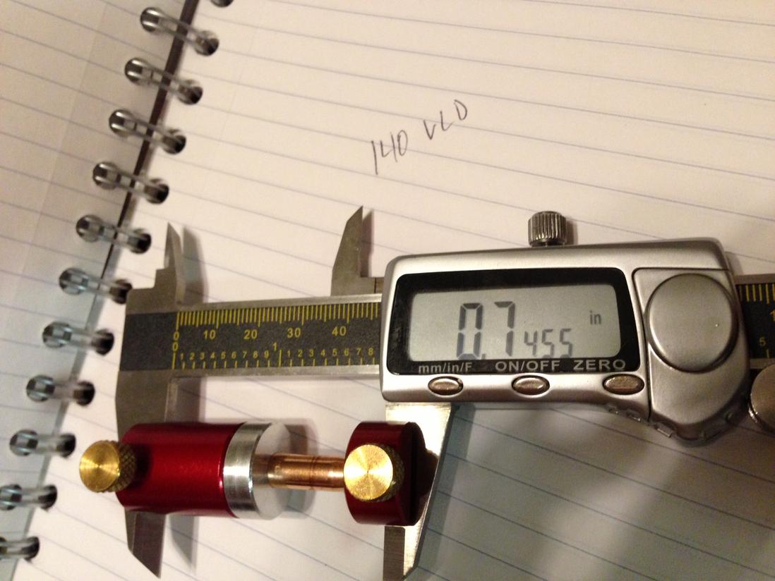

The VLD is 0.032" longer from base to ogive than the Hybrid from my measurement. Either way, the freebore is still too long to touch the lands without having less than 1 full diameter of bullet grip.

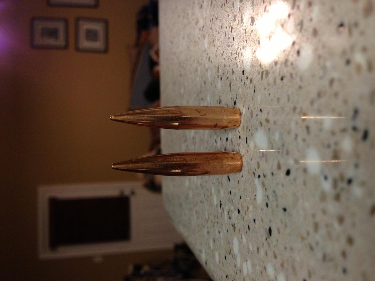

I just measured again, I still get 0.034" difference to ogive. 140 Hybrid left and 140 VLD right.jpg140 vld.jpg140 hybrid.jpg

What is the ID of the tool you are using? I think that is a tool designed to compare the length of same style bullets. You aren't measuring base to Ogive. You are measuring base to a point on the nose. According to Berger, the VLD measurement should be .700" and the Hybrid should be .610".
That is the Hornady bullet comparator, and you are correct, it is only measuring to a specific diameter on the nose. Maybe 0.250" or something like it.
That being said, do you think the difference in ogive angles is big enough to explain the difference between the book 0.090" and 0.034"? Part of the difference could also be the length of the boat tail. Just by eyeing it, the angles look a bit different, so measuring from the base would add additional error when stating bearing surface length...
The Hybrid has a longer BT, .212" vs .200". The VLD has a longer bearing surface, .500" vs .398". The angle will make a difference. A vld will typically make contact at the end of the bearing surface. The Hybrid will contact before the end of bearing surface.
