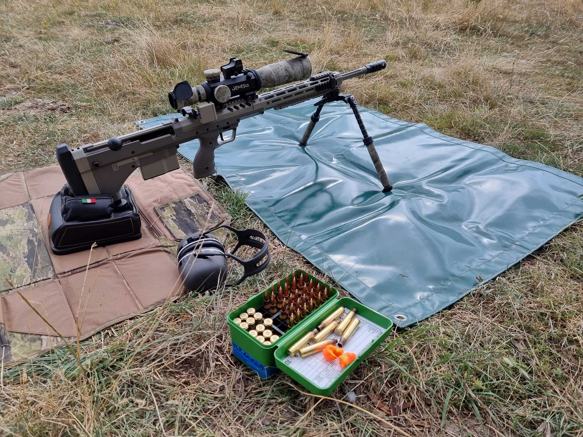

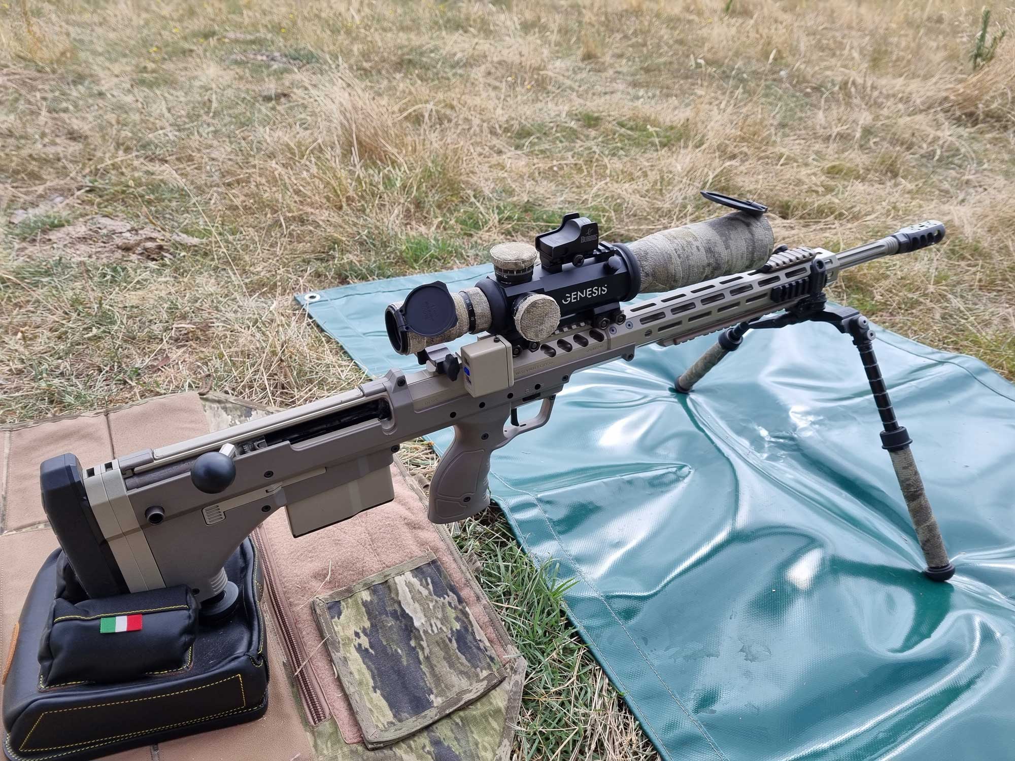

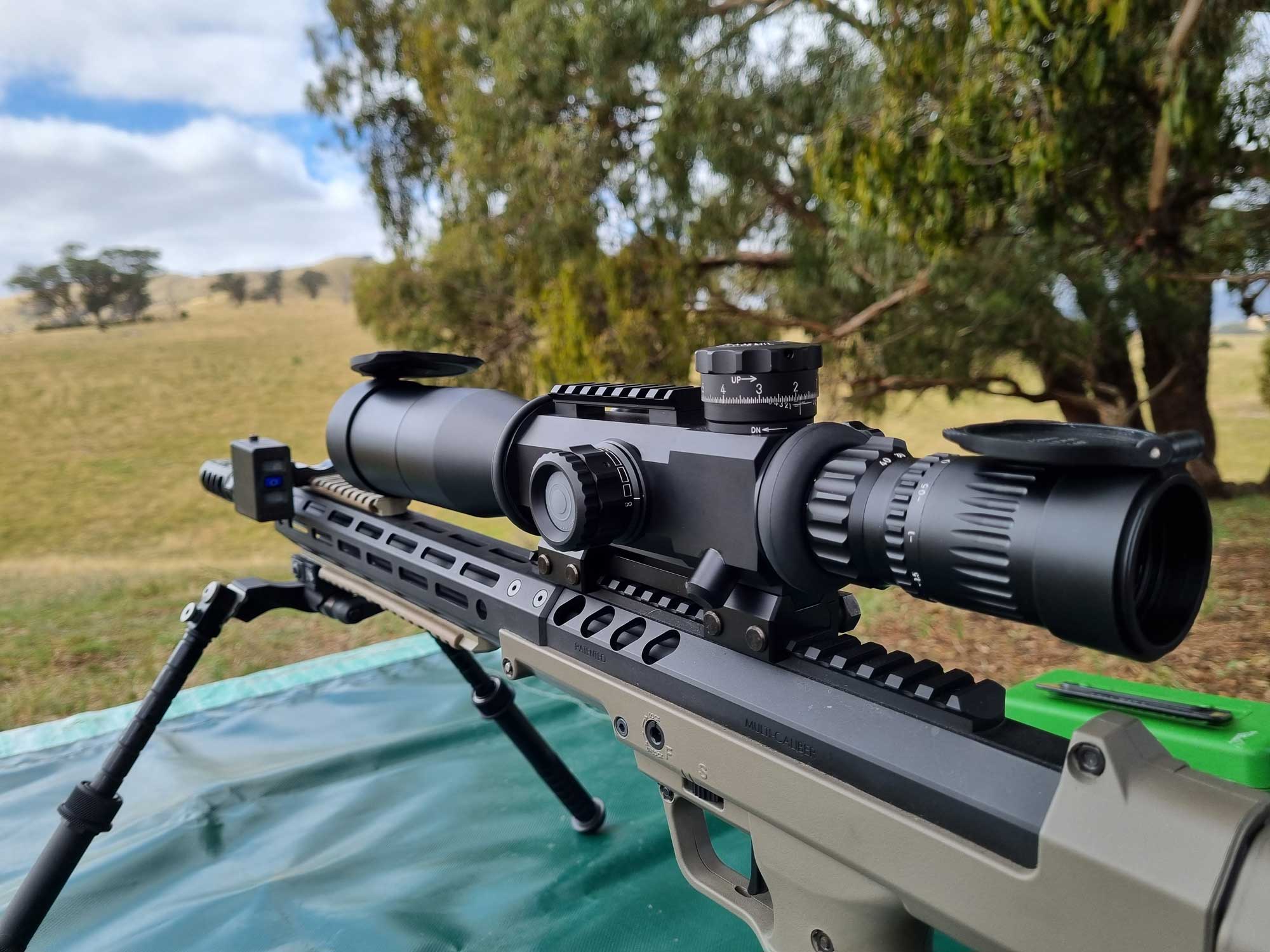

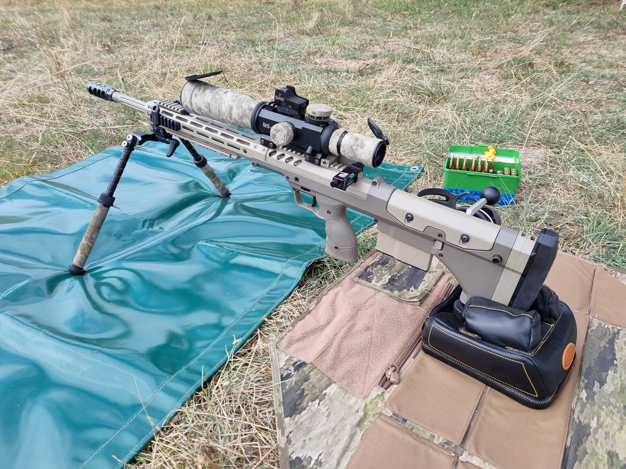

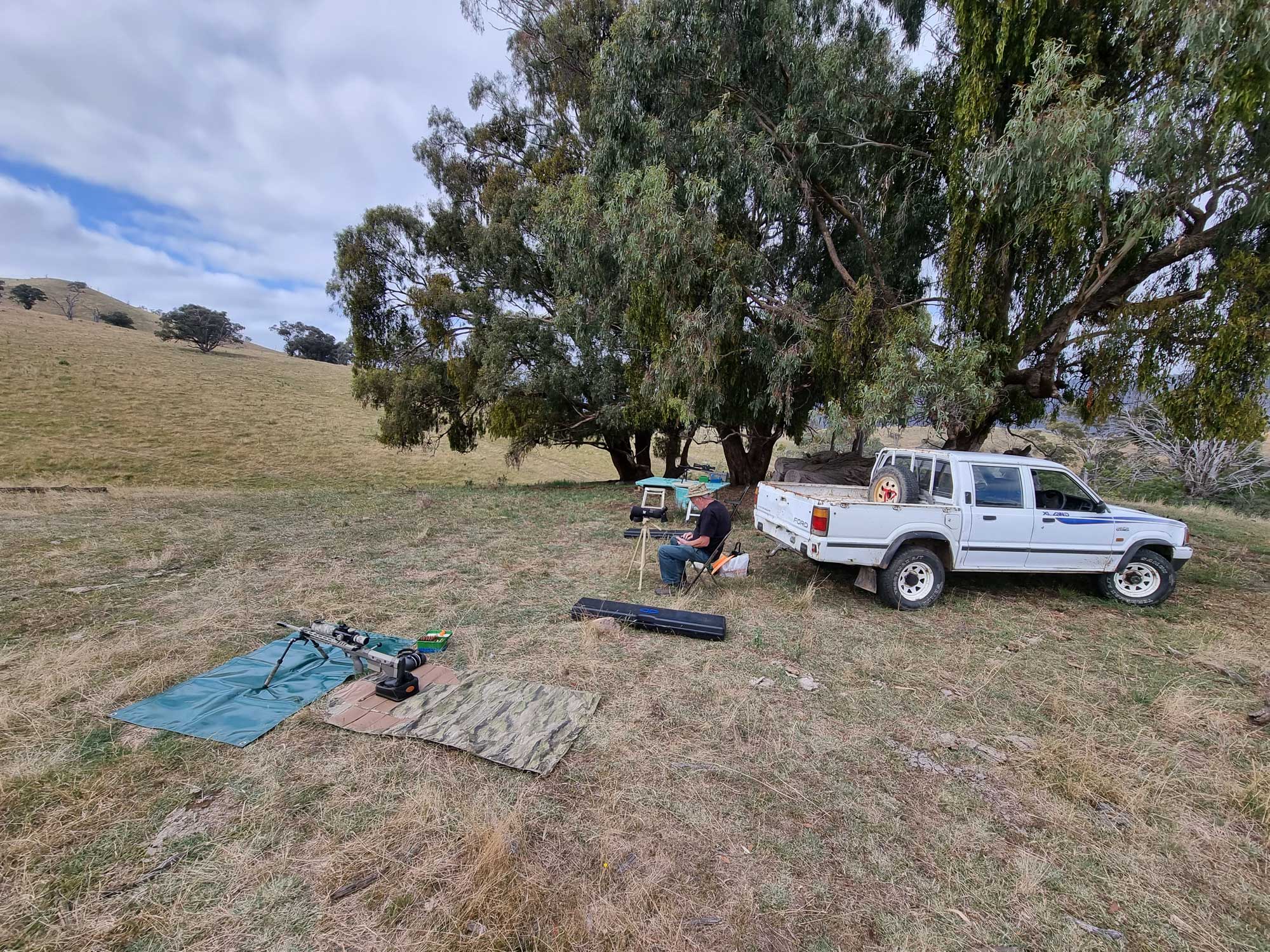

Desert Tech 338Lap with 300gr Atips last weekend... :) Plate is 24" x 24"

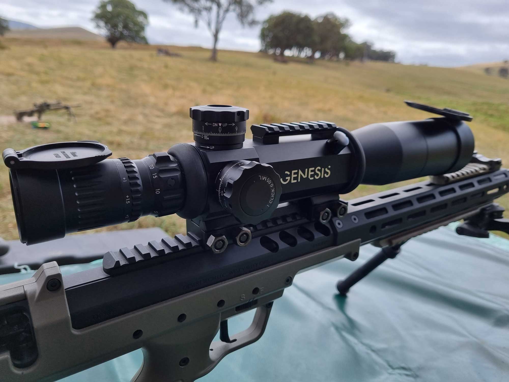

I'd suggest starting with figuring out how much more you can get out of the scope you have.
From your zero, how much elevation is available before it tops out? What is the advertised elevation for that scope? Subtract one from the other and that's roughly how much more base you can use. The more accurate way to do it is to just move the zero stop out of the way and see how far down you can go. You'll need to leave a couple few mils above completely bottomed. Buy another base that recovers a chunk of that available elevation. Or buy a 1 piece setup with some cant in it to put on top of the base you have. Burris also makes rings with inserts that allow adjusting cant.
A shorter version would be exactly which scope do you have and how many moa are in the base. How many mils or moa from your zero until the scope tops out?
The general approach on optics is to buy a scope that gives 30 mils or more of available travel, add cant in the base to use most of it, and then add a Nightforce Wedge or Charlie Tarac if you need more elevation after that.
The 416 won't help much without solid fundamentals. It'd just be a more expensive way to learn them.

What is your firing solution at 1000 yards? I ran a generic 338 Lapua load using a 300 grain Berger at 2750 fps and came up with about 25 moa? With a little help from a density altitude above sea level you should almost be able to do that with either the MOAR-T or MOAR-20MOA and nothing in the turret?
Your scope has an advertised 62 moa of travel. It comes centered and will normally zero around there with a flat base. That'll give you 30ish moa of travel up. If the zero stop is set, there won't be any down. If you add a 20 moa base or mount, the zero stop will have to be lowered that amount to regain your 200 yard zero but now the scope will give 50ish moa of that advertised 62 moa.
I'm not sure why a rifle like that Desert Tech ever came with a flat base. There will be varying amounts of optical degradation as the scope is adjusted closer to its limits. You'll need to decide if you want maximum clarity when you're jerking off at 100 yards or when you're actually shooting. And 200 yard zeros are for hunters. When you start taking the reticle off the fur, most go to 100 yard zeros. It's less walking and harder to fuck up. That SFP silliness is also for hunters who don't estimate range.
Start warming up to that 100 moa scope idea, but don't buy it yet. It'll save a few steps if you wait until you've worked through these base/available travel concepts, you've accepted that the idea that 125+ moa is the way to go, and FFP is for UKD long range.
