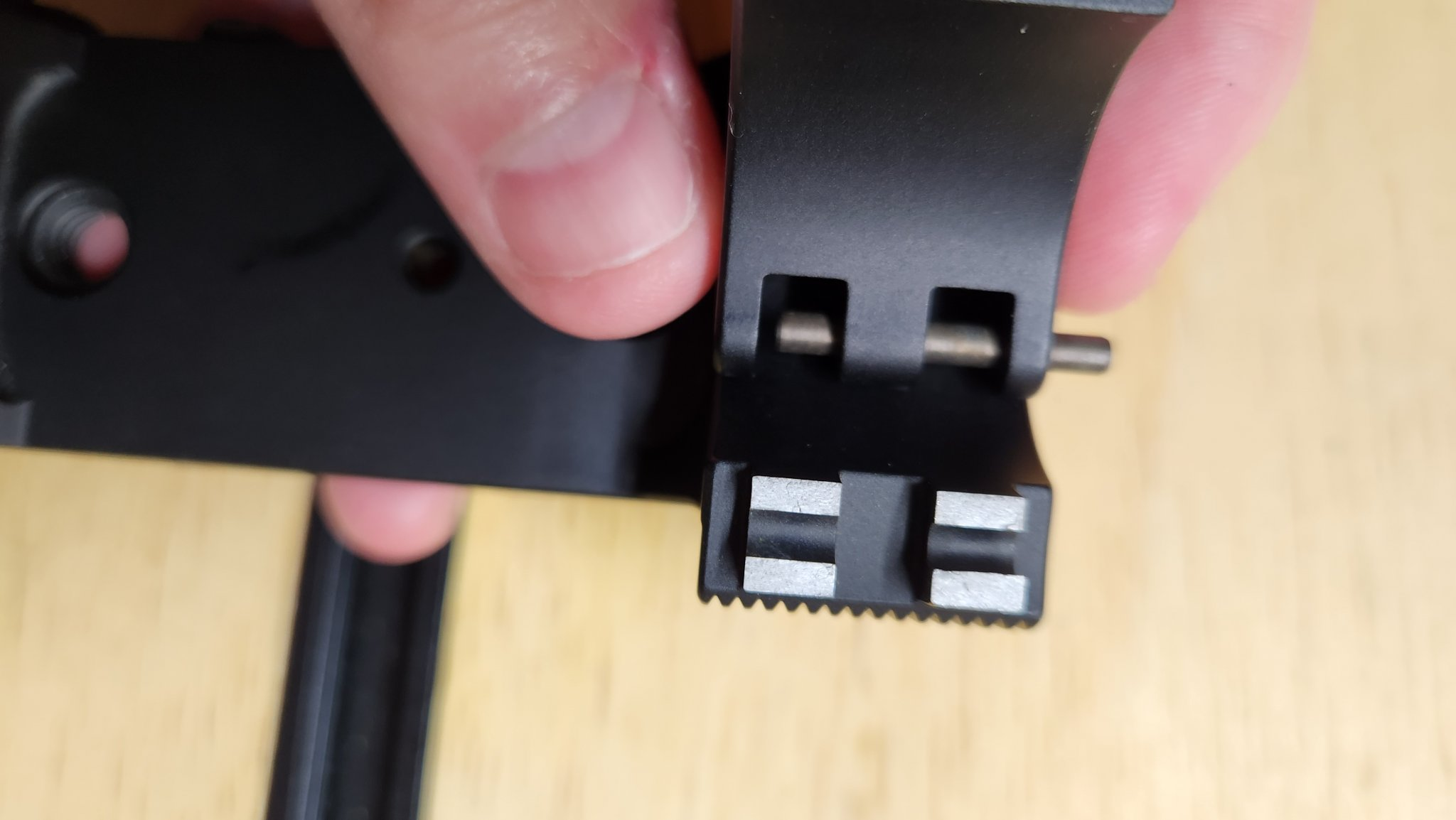

ARC has been pretty weak in my experience. Mine and a buddy's MBrace mounts cracked and broke right at the hinge with no major impacts. My going theory is cold temps caused it. The LRF bridge is tough as hell but the rings, not so much.

I've heard a couple reports of this, but haven't seen any pictures-- and I'd love to see some if you have them. It's fairly obvious the expected failure point of the ARC design would occur in hinge pins themselves or in the "fingers" for the hinge pins in the base or rings caps. I have yet to have any failures in my sample size (10 mounts and 1 set of rings.) Not saying the ARC design can't fail, but they appear to be failing at a far lower rate than say scalarworks where you can easily find lots of pictures of broken ring hinges. If I had one of my ARCs fail I'd switch brands again, just like I did with Spuhr, only this time I'm not waiting until I have a 45% failure rate to change brands, lol
How cold was it when you had the failures? Several of my M-brace mounts have seen lots of use and bouncing around on quads and side by sides with heavy razor gen 3s and S&B 5-25s down in the 15-30f range for a couple years now with no issues, but that's not as cold as is it gets elsewhere...
Post #64
I've only seen 2 break like this personally, but I've read plenty of reports of this happening to others. Really a shame. Cool company and a good price point for an otherwise good product. Temps were in the 0°F to -10°F range. Mine went first, then a couple weeks later my buddy's did the same shit.

Post #64
Thanks for that, exactly as I expected a failure to look and where to occur. Wonder if they got some bad material combined with a design that leaves minimal margin in that area especially if there's some material or process variability.
I may have to turn one of my ARC mounts into a test piece, come up with a test fixture, and subject it to some impacts between say 70 to -50F...
I'll continue to run mine up until I have a failure; at this point they have proved far more reliable than Spuhr for me.
