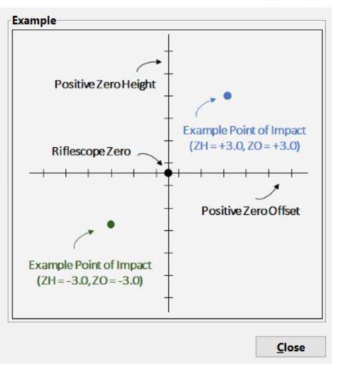

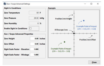

Here's the information from the two platform manuals.
Screen Shot 2017-09-20 at 9.48.56 PM.pngScreen Shot 2017-09-20 at 9.49.07 PM.png

Sight Scale Factor - This is to correct for the true travel of your turrets vs what is indicated on the dial.
Zero Height and Zero Offset - This can serve different roles. One of them, like you are asking about, is to account for the zero shift when your remove the suppressor. The key here is to make absolutely certain this is repeatable. The other use of this, is when you cannot zero your scope (If one click on the scope sends you past zero) you can adjust for this. Say the scope has 1/2 moa clicks instead of 1/8th.

Thanks! I found the zero height and zero offset. I think I got it to work right.
My suppressor shoots 1" low and 1" left. ZH=-1 and ZO=1.

So does this look right?
