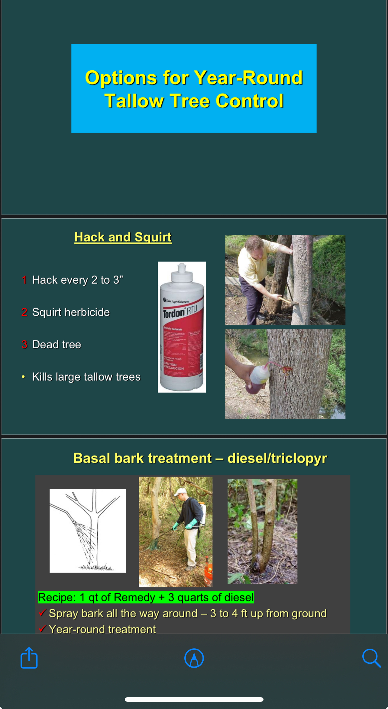

A buddy and I are discussing what is the best tree killer.
He said crews in Texas have a product where you make a cut in the bark or drill a few inch deep hole at a downward angle and inject a tree killer.
In weeks, the tree and roots die off.
Anyone know what product they use?
Tordon RTU Specialty Herbicide​
We girdled all of ours, (for fire wood) but some used a herbicide as well. If the roots are cross grafted, using a chem can kill both trees.
Sent you a PM. Think about a Hack and Squirt, if its a large area/lots of trees your back will hate you if you girdle. We do a lot a site work pre/post harvest on undesirables. Hack and Squirt is fast/easy. A crew can knock out 20/30 acres a day depending on what's being treated.
I’m a forester do this professionally. Active ingredient should be something with either glyphosate or tryclopyr. Cheap generic herbicide from TSC with this as an active ingredient works better. Roundup works on small acreages.
If more than an acre or 2 get the cheap shit from tsc. Just read the label, should state something like timber stand improves, woody species etc.
Doesn’t have to be anything special for hack and squirt… just use one of the 2
Tryclopyr is slower to kill but stays in the tree longer than glyphosate
Need to either hack and squirt when leaf out or just before fall, that way the herbicide is transported throughout the stem. Fall everything is moved to the roots, spring/summer travels around the stem.
Sink a hatchet a few times into the tree, (I like one cut per 2 inches in diameter) larger diameter more hacks.
Use a squirt bottle into the open wounds. You’ll need to get a recipe, like reloading what works for me may not be legal/work for you.
If you plan to girdle, make 2 rings/cut about about a an inch 2 inches apart, Cut through the bark into the cambium. You’ll don’t have to remove the bark/cambium between cuts, as that section between cuts does it acts like a tourniquet but blocking float/sieve cells stopping water/sugar movement in the tree. Works better on hardwoods.
YMMV
