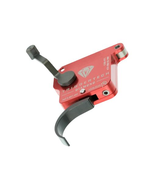

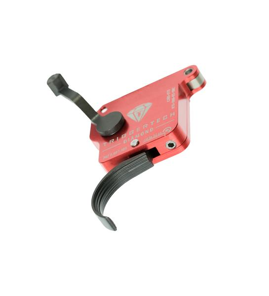

    To expand with some images
    Traditional curved has the stepped down pyramid shape with the middle thicker/higher than the edges, this is whats on my normal TT and I really like it.
    Pro Curve is smooth like on a jewell with even thickness all the way across
    Reactions: lennyo3034
