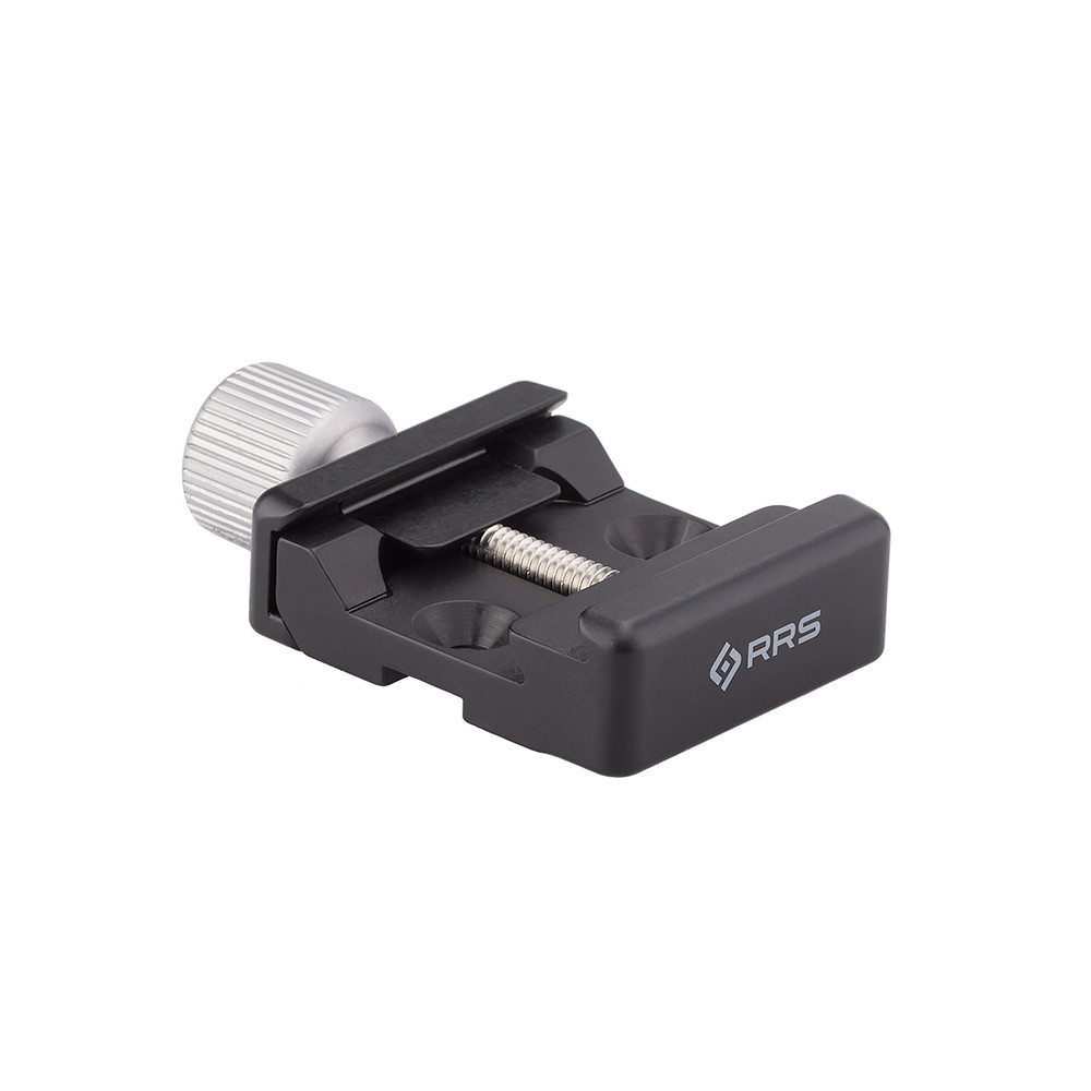

The new RRS Mounts, the Anvil 30 and the Pro Clamp work with A Pic Rail
7038670
On the top is the Dovetail Clamp, inside where the screw is the pic rail mount.
One clamp does both. As noted being that far forward will not be very stable, but it will work. You are better off with a full rail and mounting the tripod under the balance point.
