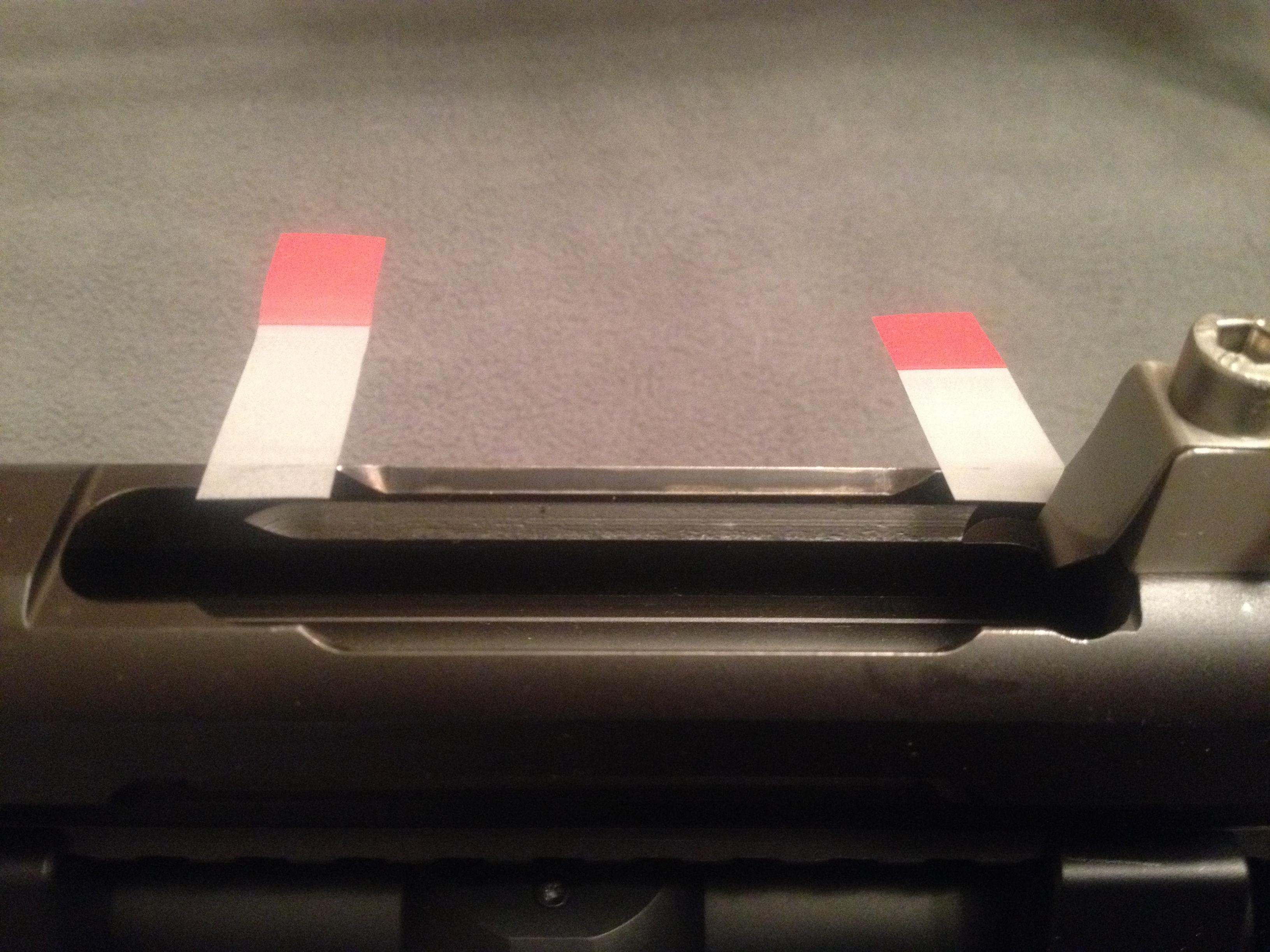

T3 receiver AI mag clearance
I used a 45 degree carbide cutter to remove a little material from the bottom of my T3 receiver to provide clearance for the AI poly magazines. The material was removed between to two post-it flags and then I just used a little Van's cold blue to protect the surface.
I am using CDI bottom metal inletted into a factory T3 Varmint stock.
