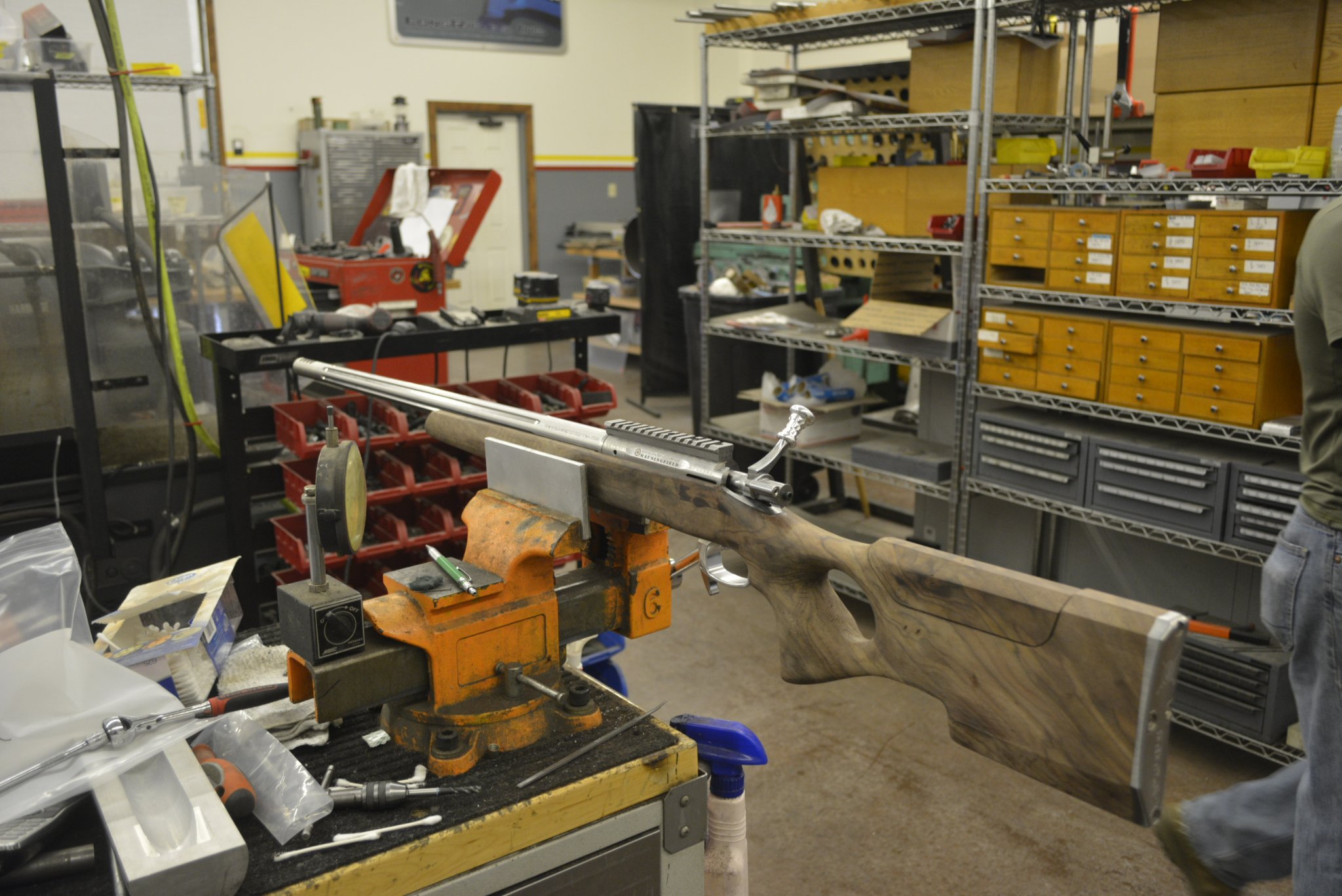

Stock work? I've been machining my own inlets since 2003. If curious, do your own research on what an LRI bedding job looks like. You judge for yourself. In 11 years of business I've yet to have one come back. We don't touch em with anything "hand worked". They come off the machine like that.

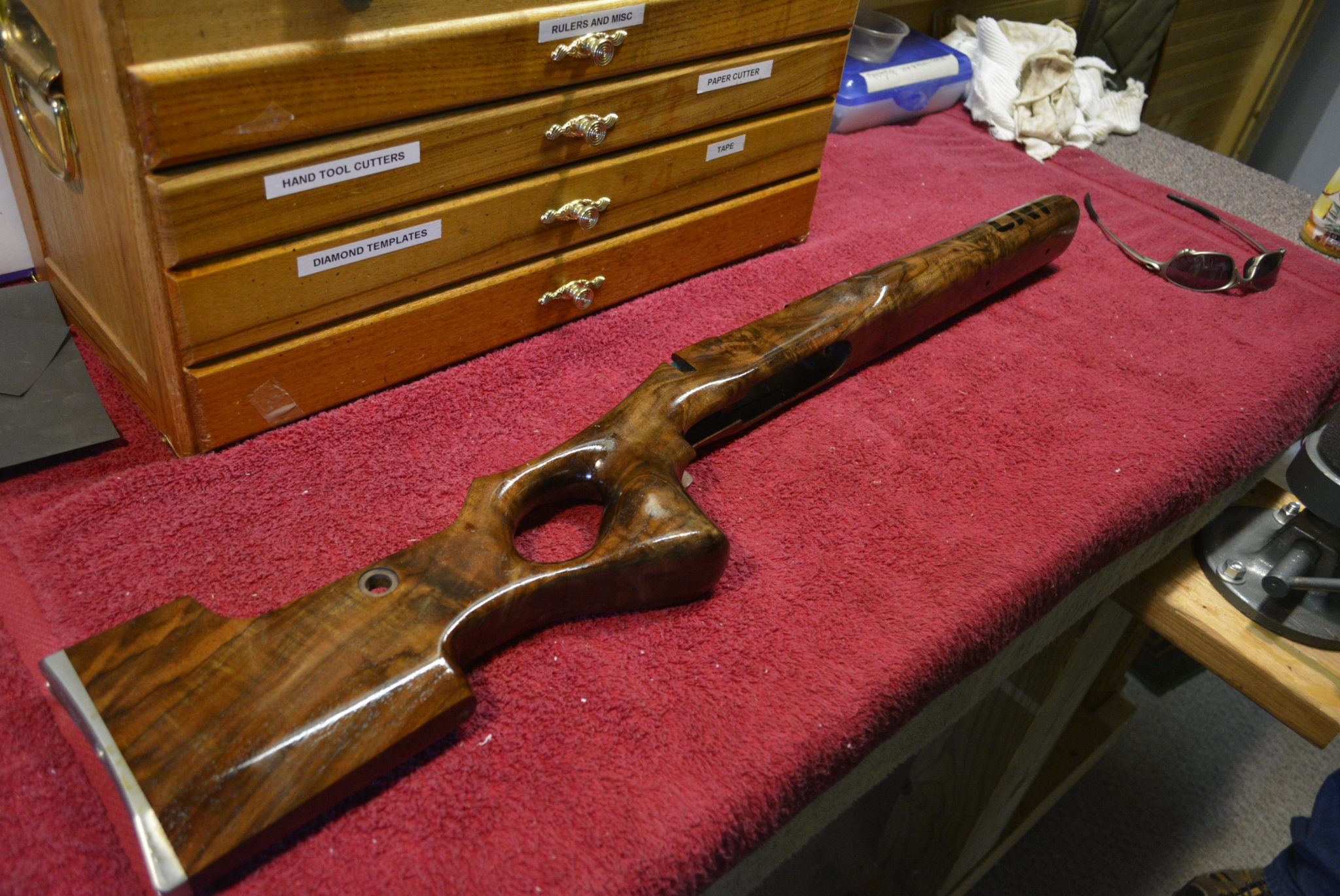

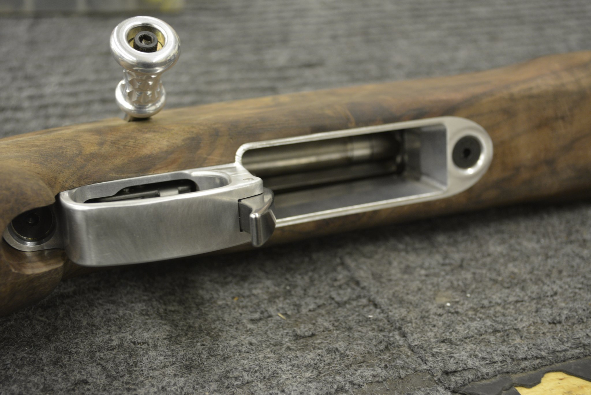

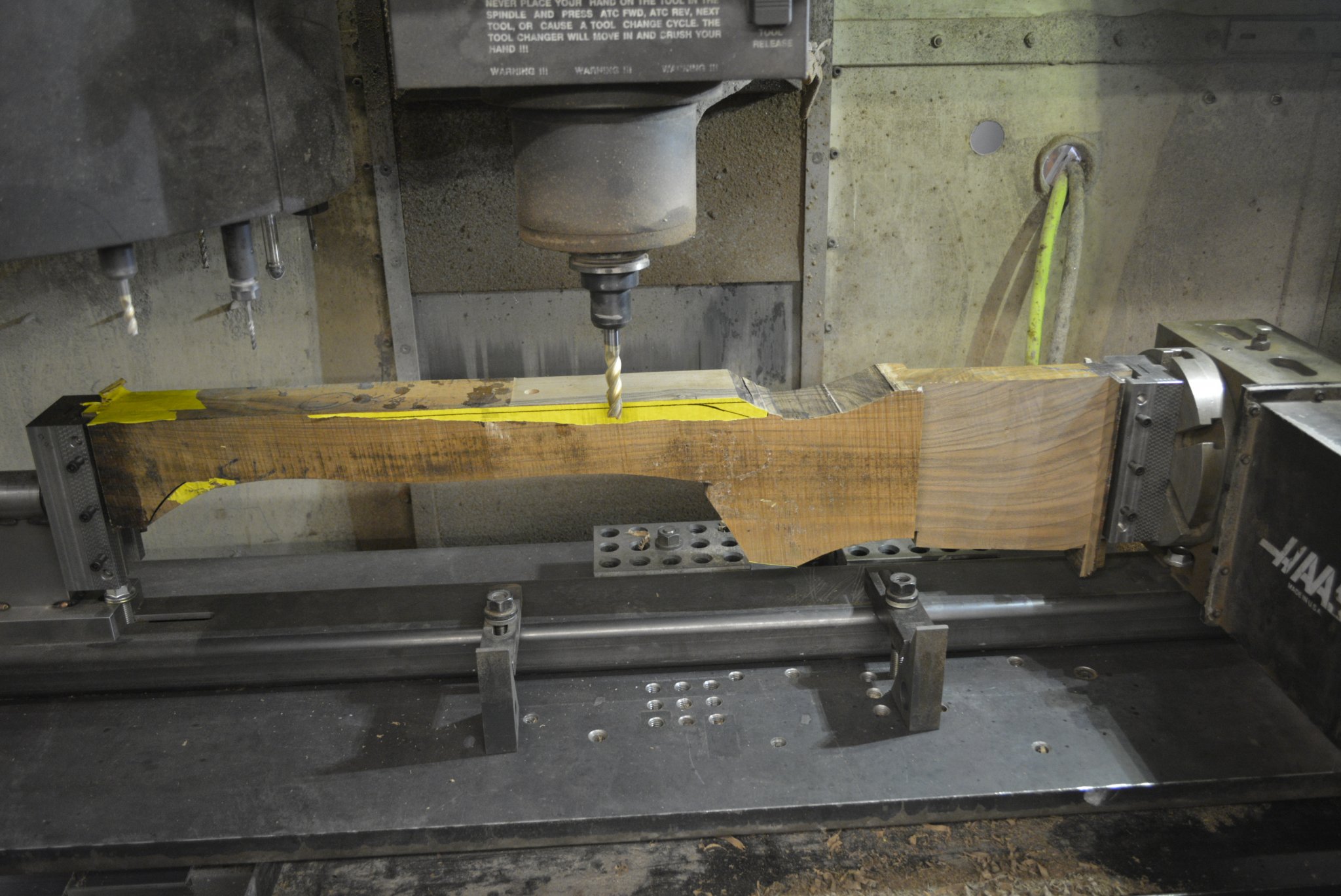

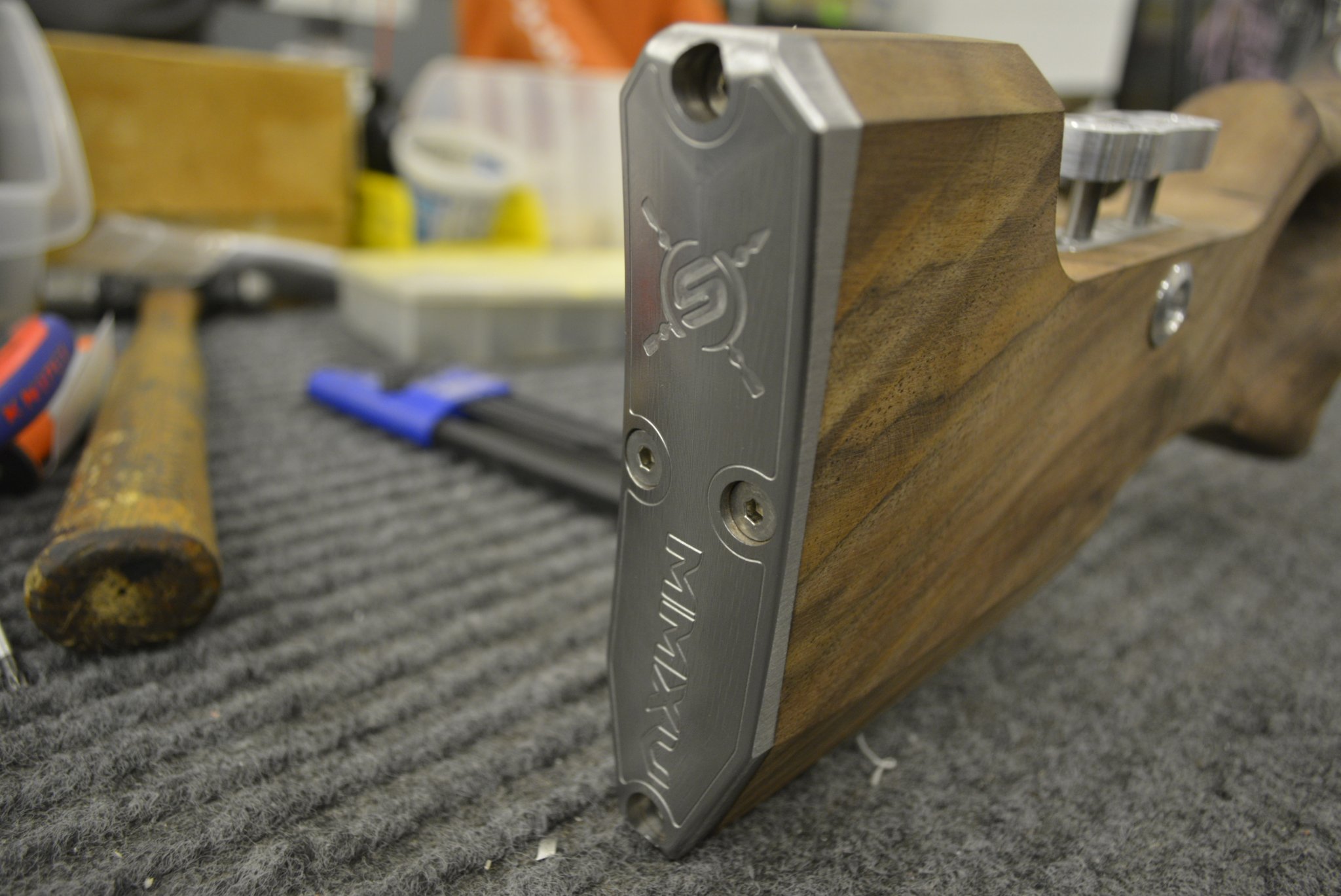

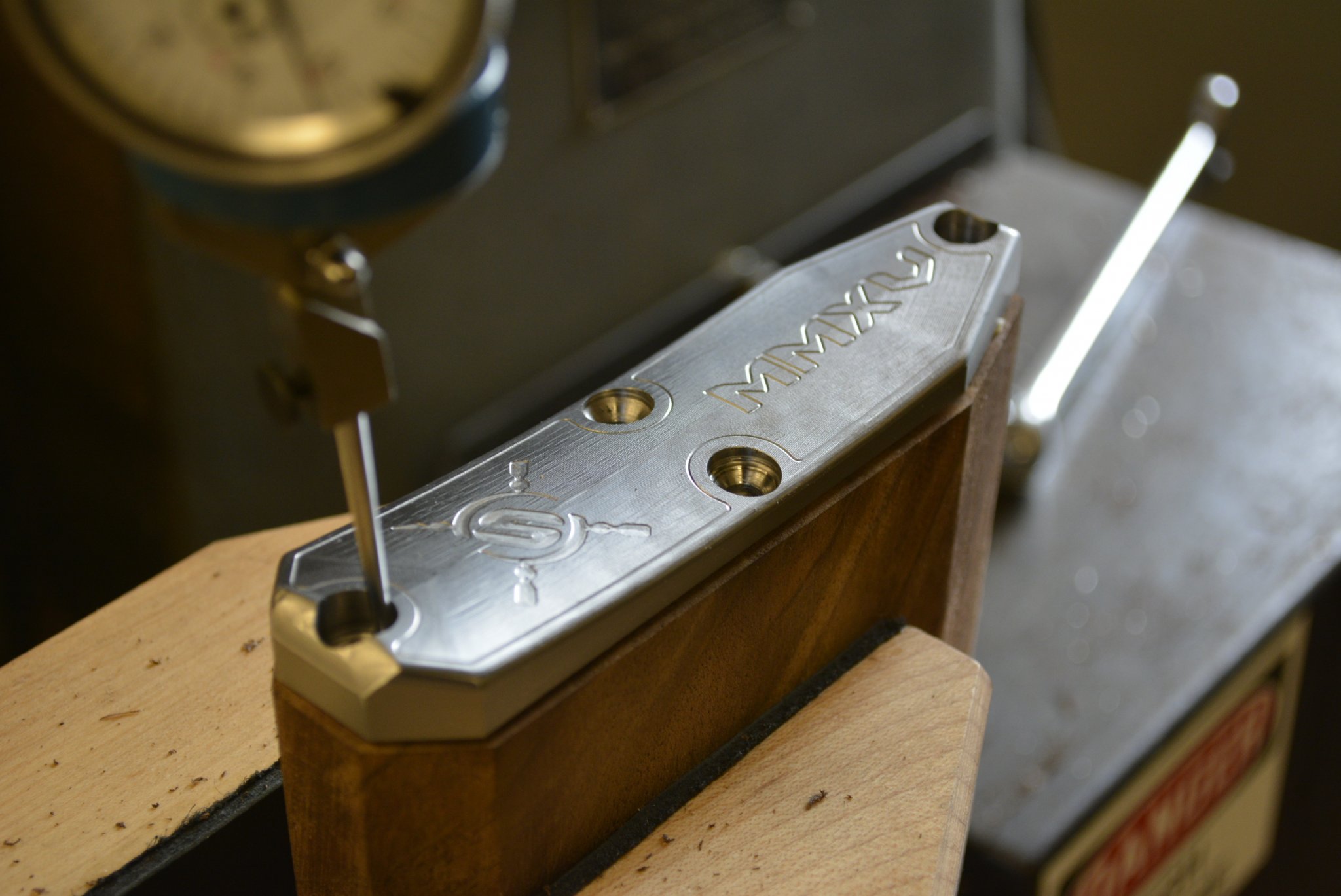

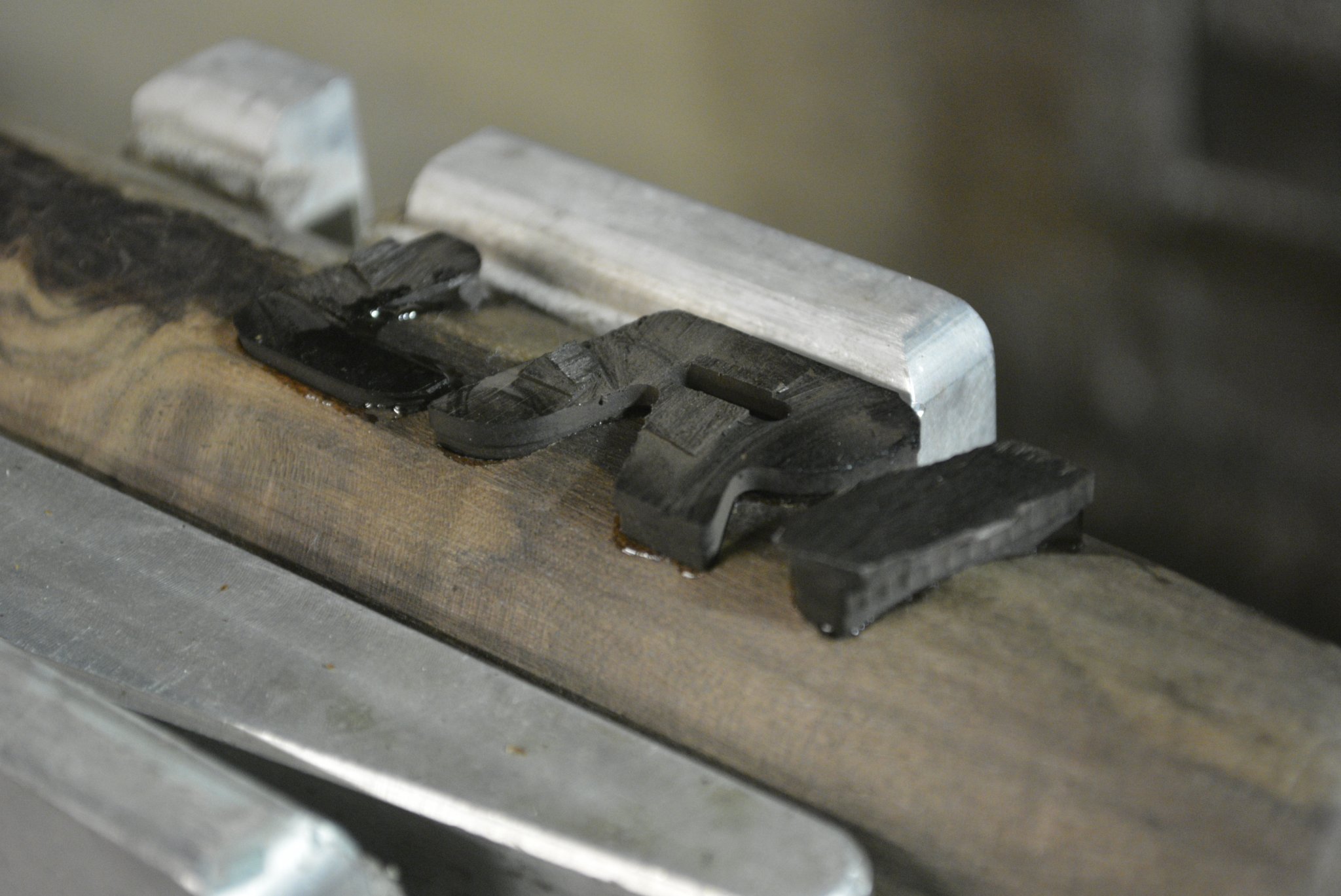

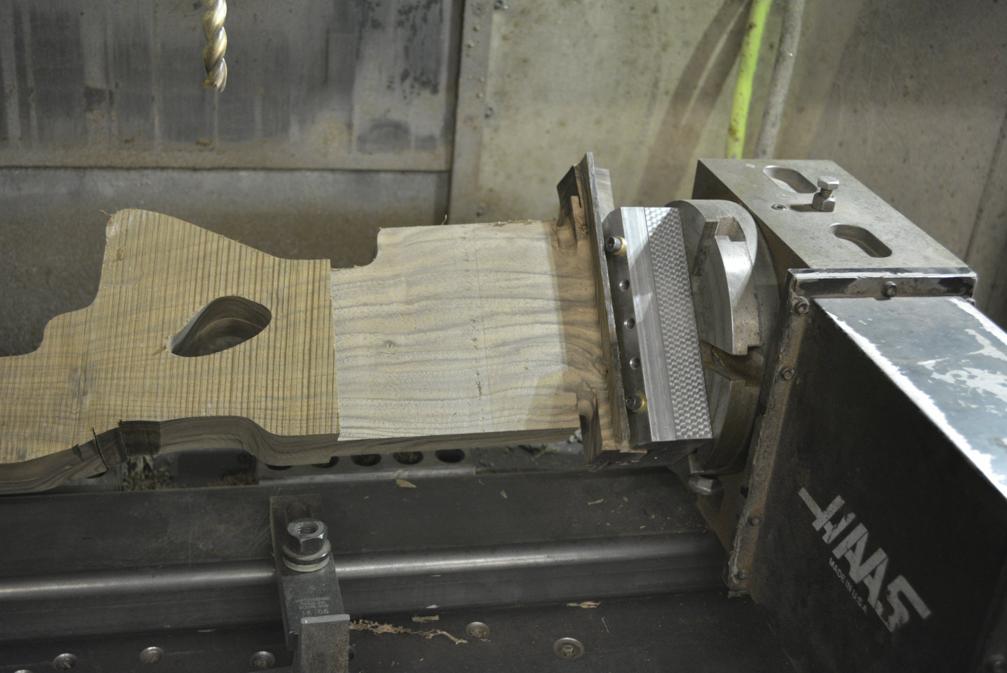

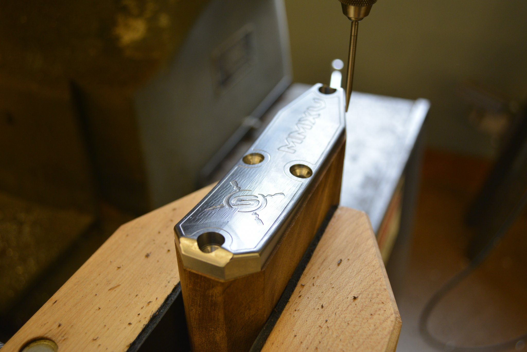

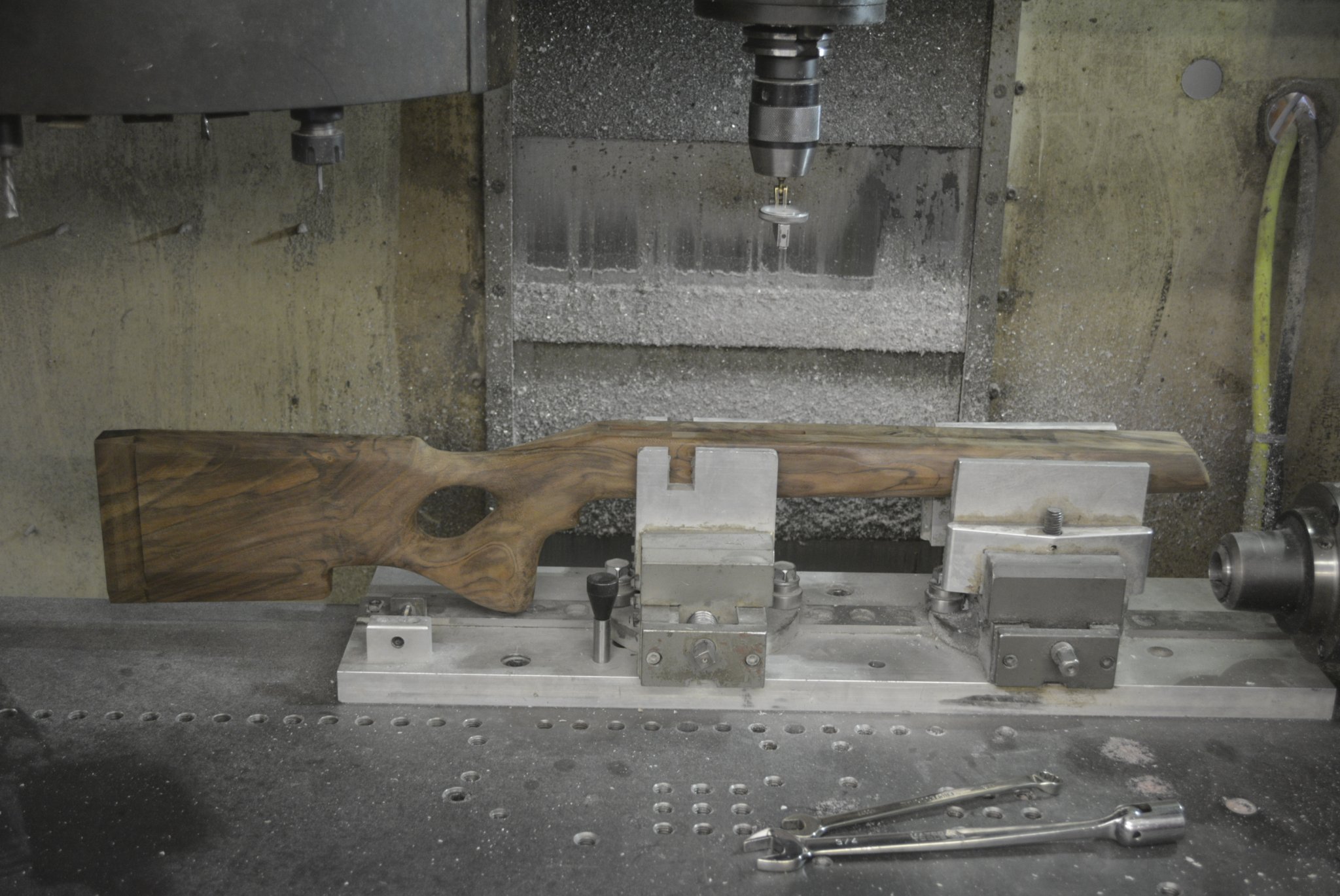

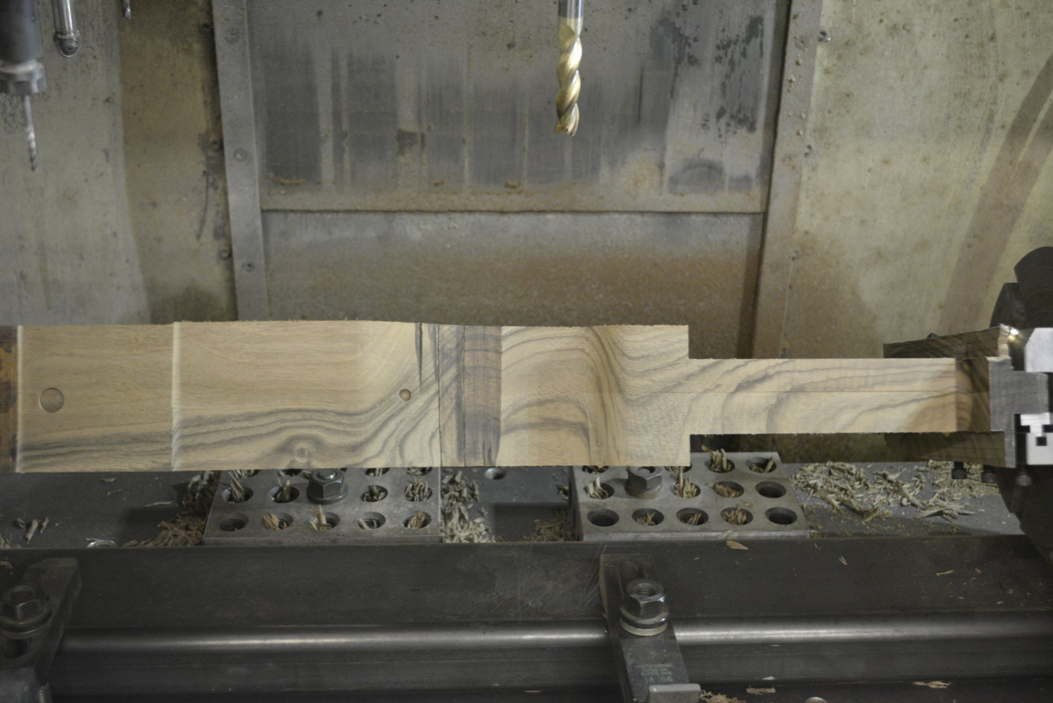

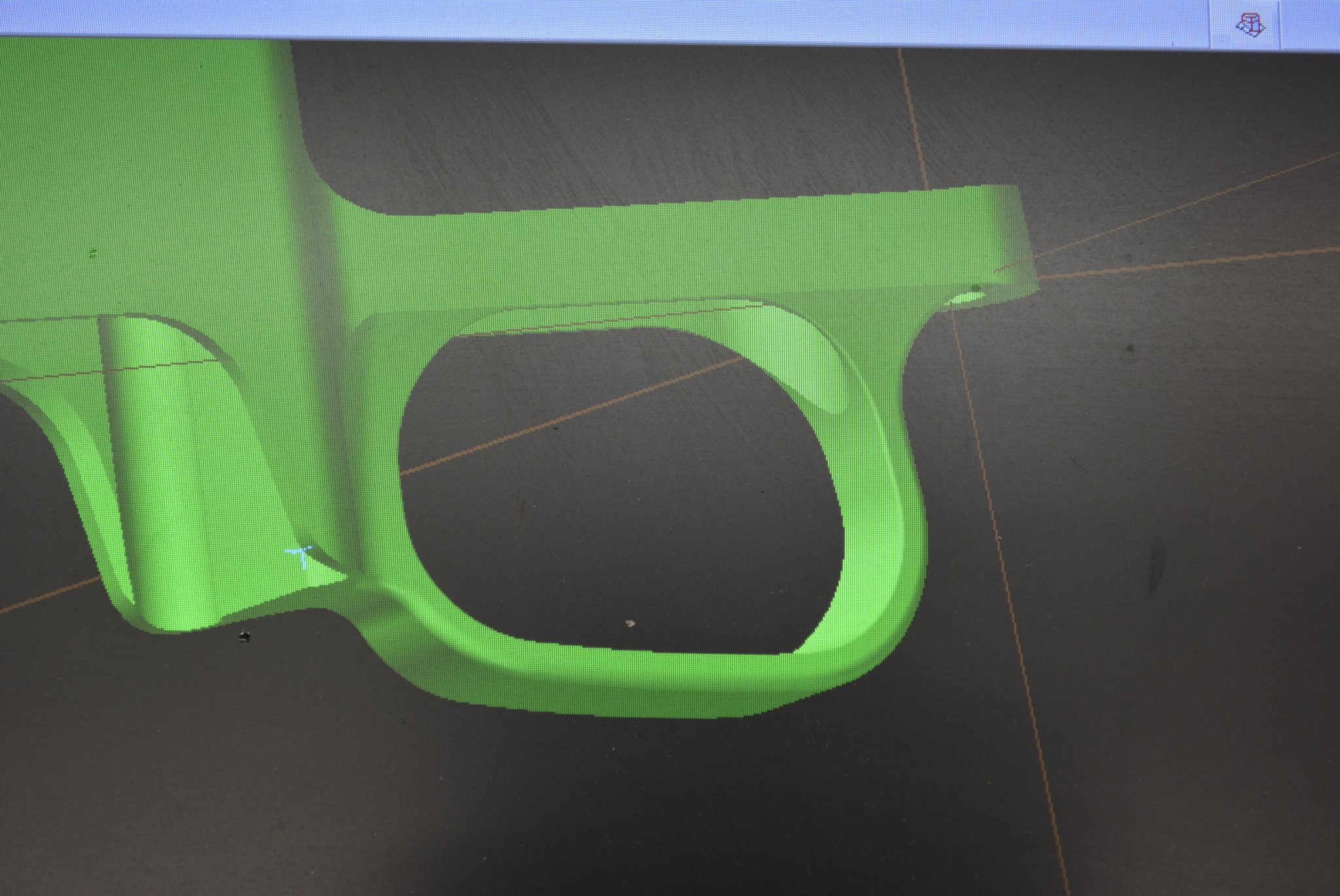

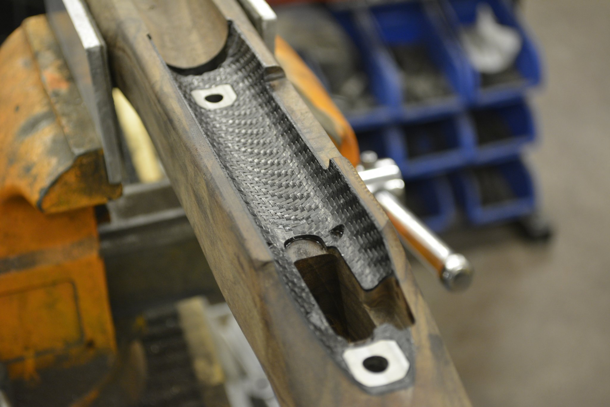

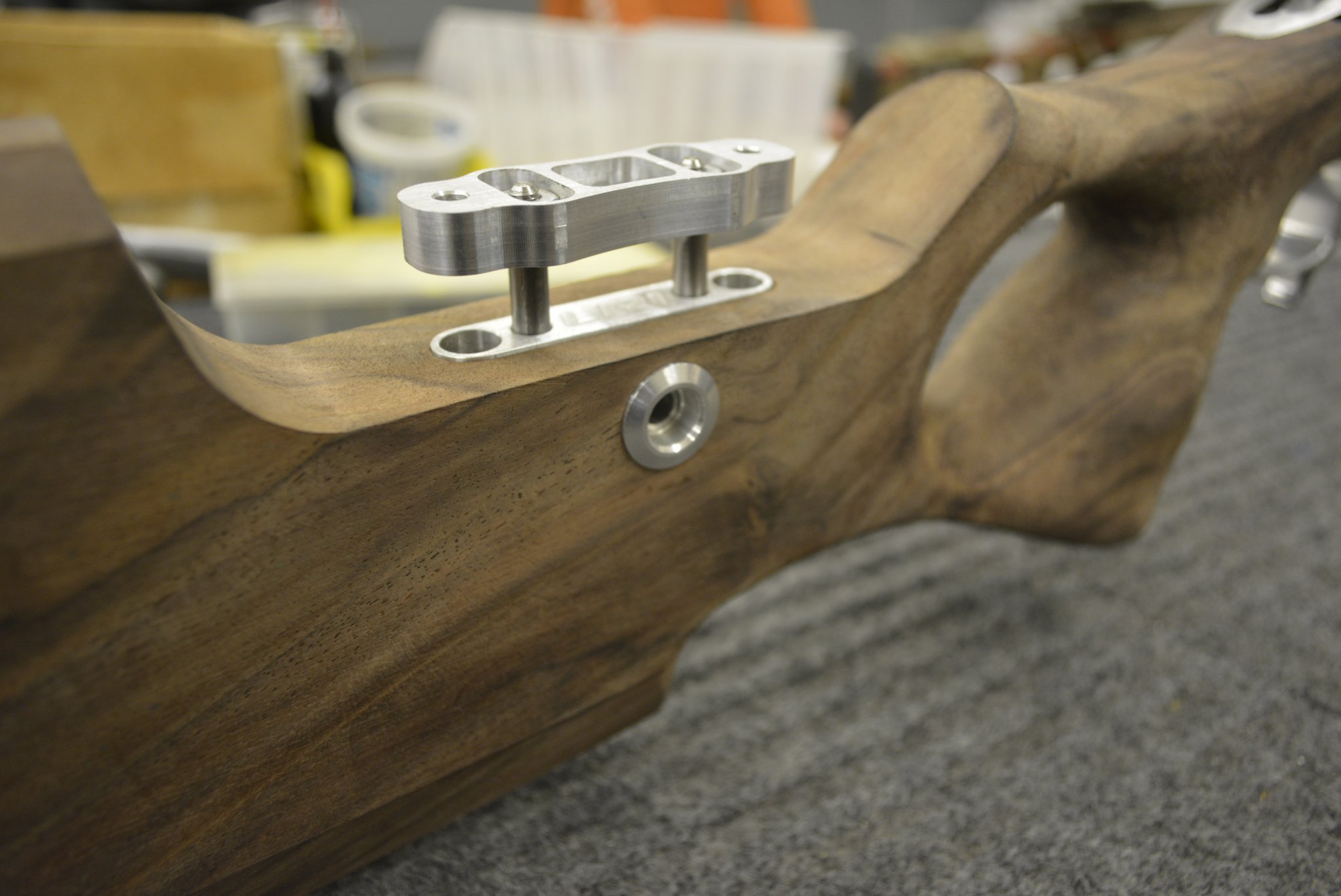

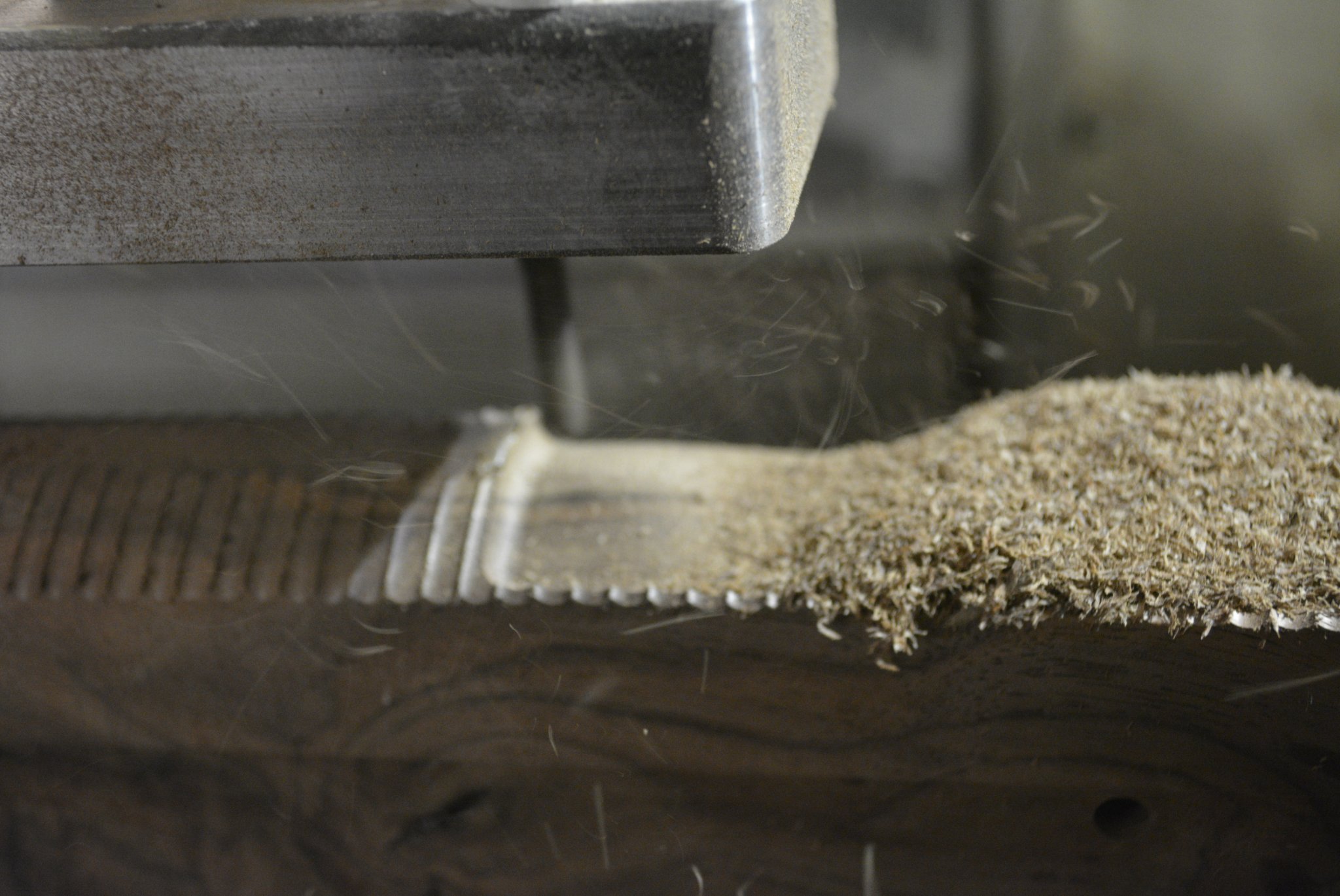

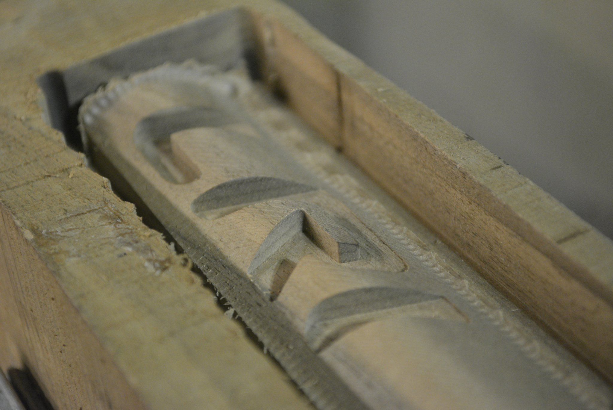

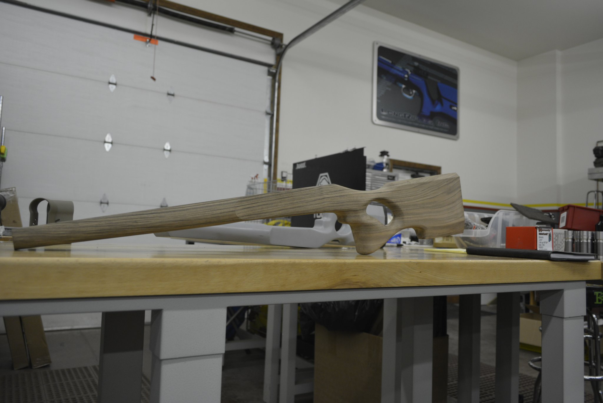

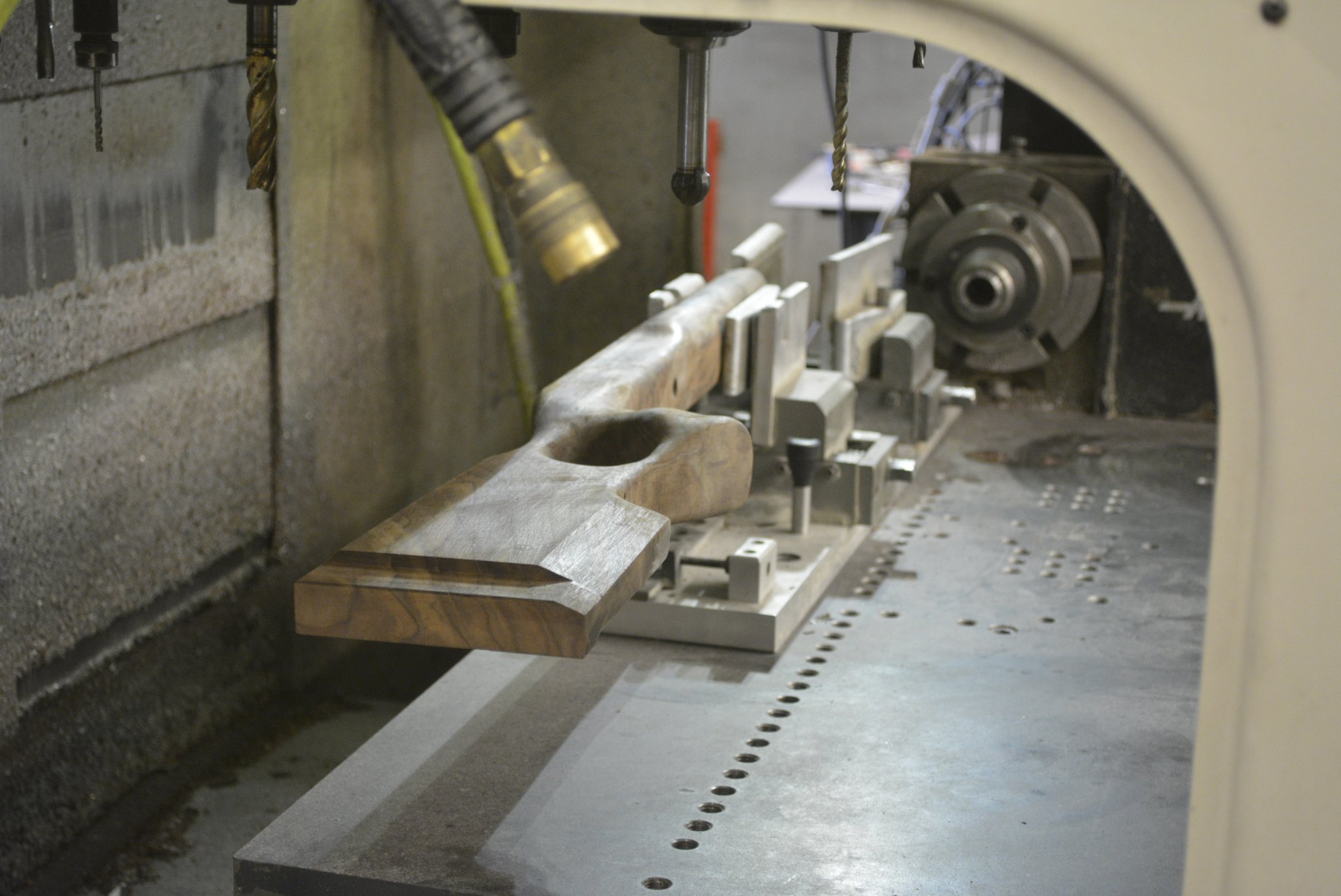

I agree whole heartedly. In 2015 I took this to the highest ceiling I could achieve. I scanned, modeled, programmed, and machined a T5-A stock from scratch. Tom Manners blank as the master used to acquire data from, but it was not a digitized point cloud mass of shit that has been the industry norm for decades. That gun cost me over $50,000 to build. (2013 Sniper's Hide Cup Trophy Rifle, awarded to Jake Vibbert)
When it came off the machine it was ready for 320 grit sand paper. 13 hours of machine time in the mill. The sanding, as you mentioned, was still done by hand. However, the Ebony inlay in the forend was all automation. So was the prepreg carbon fiber bedding job. Engraving and other feel good wigits were also done via computer/machine.
I was once a department head at Dakota Arms and Nesika Bay Precision. I know exactly what level of effort goes into those rifles. It was the seed for me deciding to do the SHC gun in 2015.
Comparing those types of guns to what we see here though is truly apples and onions. As with anything, when price goes up for a given product, the number of clients willing to spend it goes down by about a factor of 3x. Few enjoy that level of disposable income.
There's more. . .

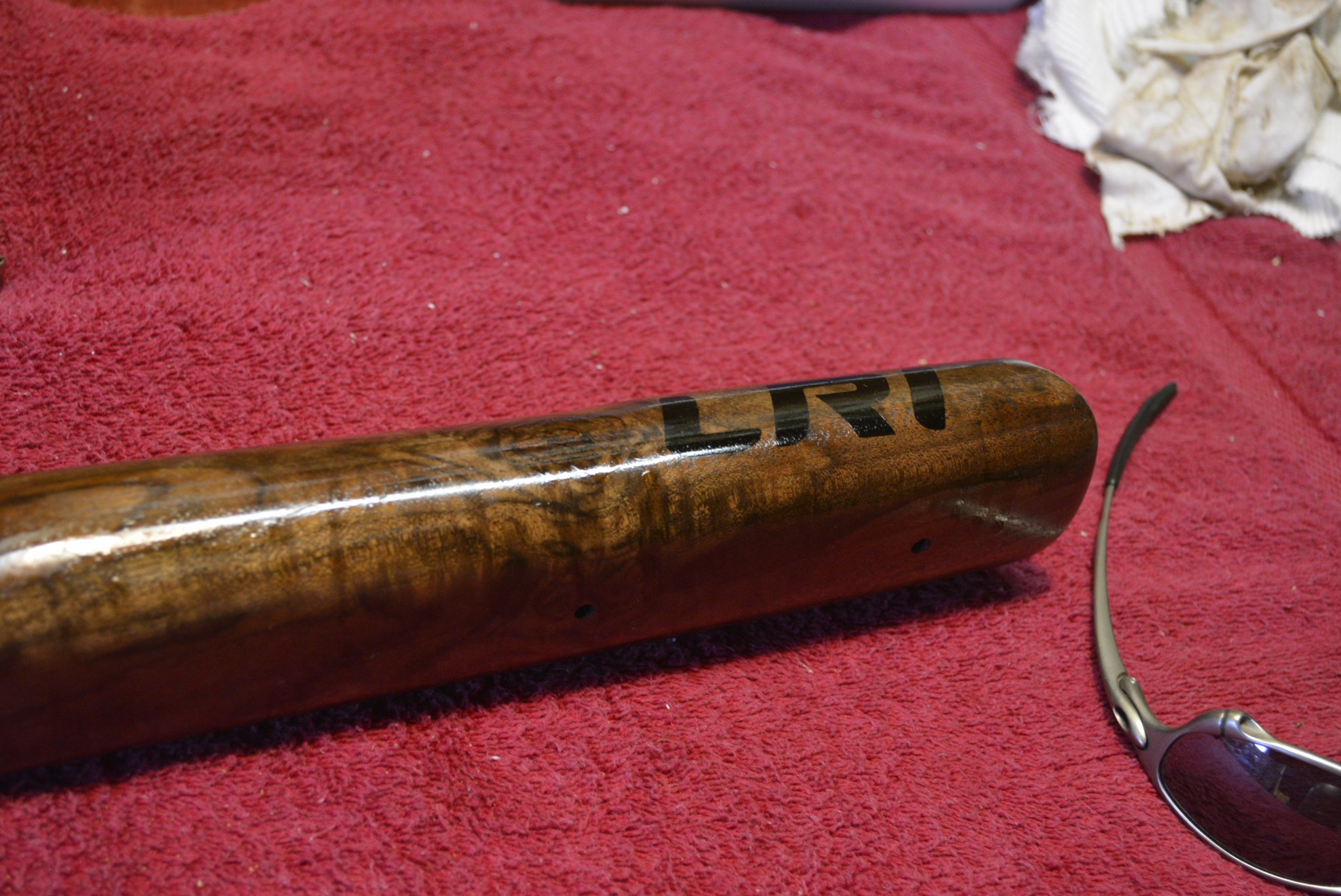

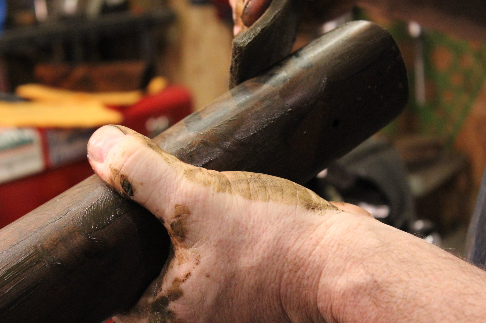

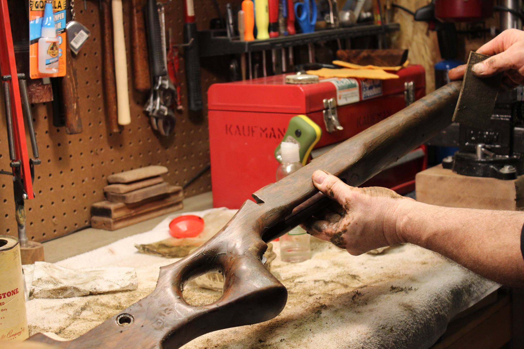

Finally, moving onto finishing. Rotten stone, oil, and a whole lotta elbow work.
