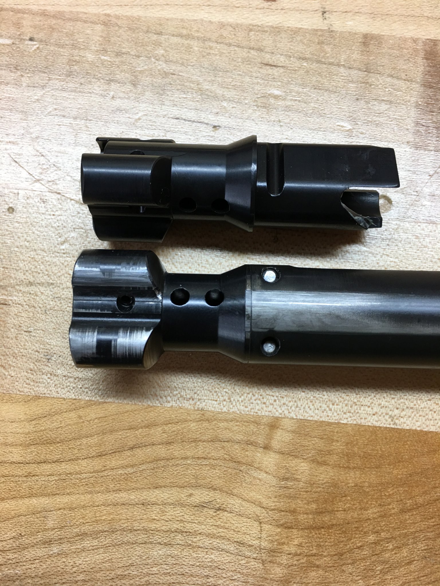

What's a barrel change and bolt head change involve? I cant find a video, if you made one it'd probably get about a million hits.
I might try that. We will see. My video equipment consists of an iPhone or a small digital camera. W

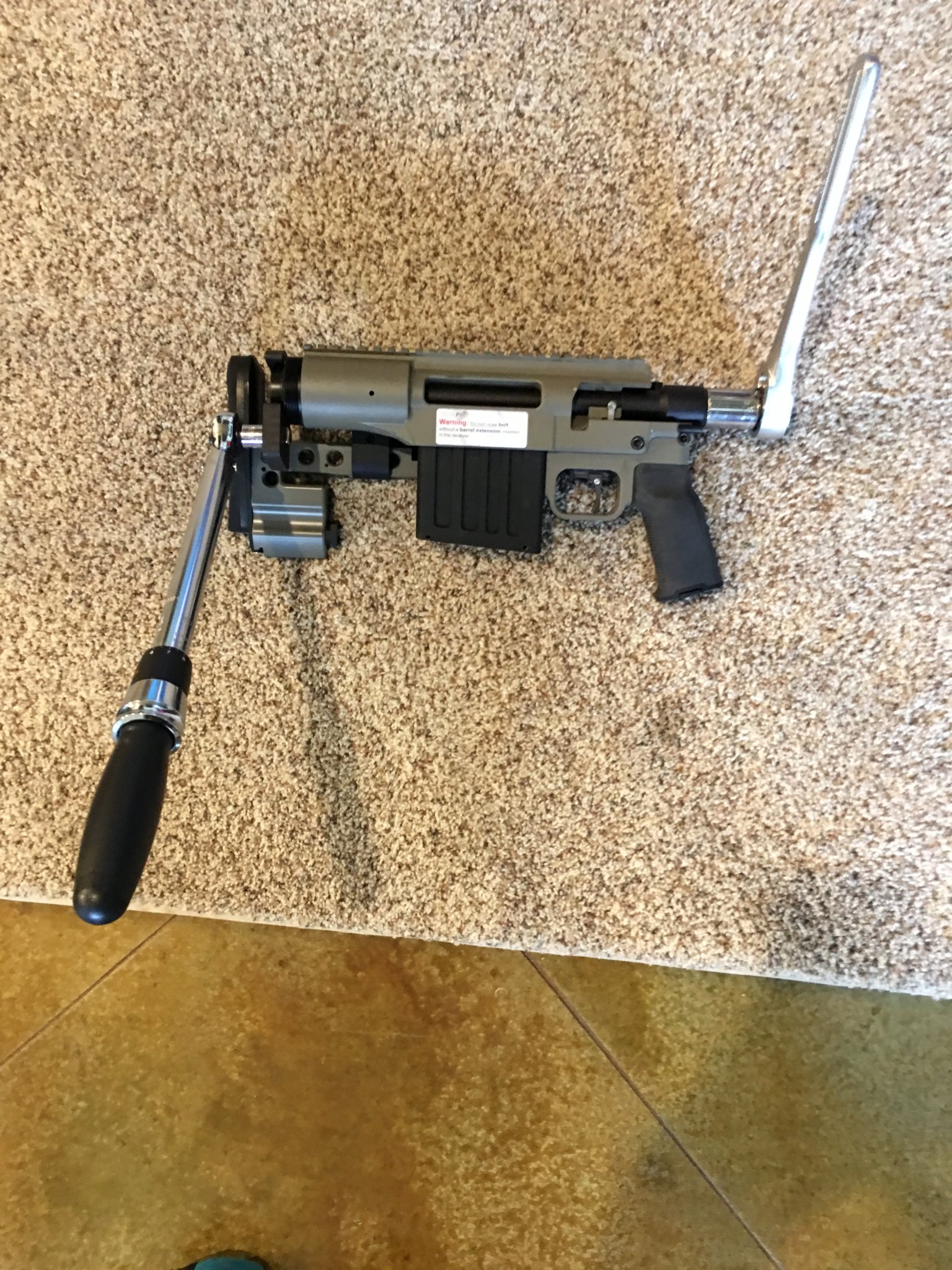

With barrel extension torqued onto barrel, it is basically an AR15 barrel swap. Rifle uses a similar nut and armorers wrench to torque down. Hand guard uses same system as old T2K: indexing pin and threaded collar, very simple to remove. Rifle comes with an action wrench to hold back up with and I have experimented with having the rifle on the floor and torquing the nut to 50 ft lbs using torque wrench and back up held in rear of action. I wanted to simulate doing a barrel change without a vise and 50 ft lbs is easy to get. Because of this goal the above Shooting was done with 50 ft lbs on the nut. Can’t complain.
Punch out 2 pins and you can swap bolt heads. Not hard, but maybe not as loose as say a Bighorn. A couple taps with a 1/8 punch is all it takes. I can take a picture of the bolt head a little bit later.

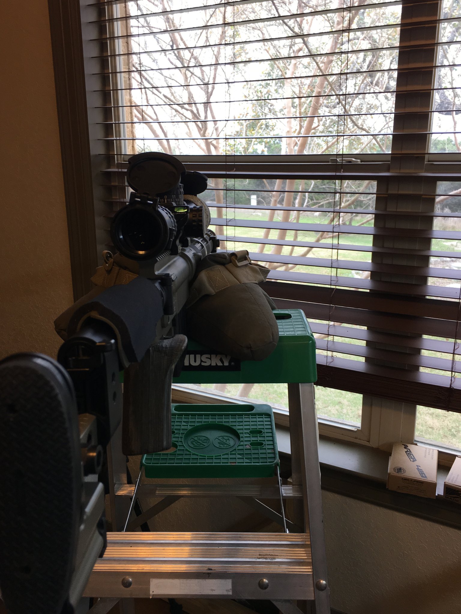

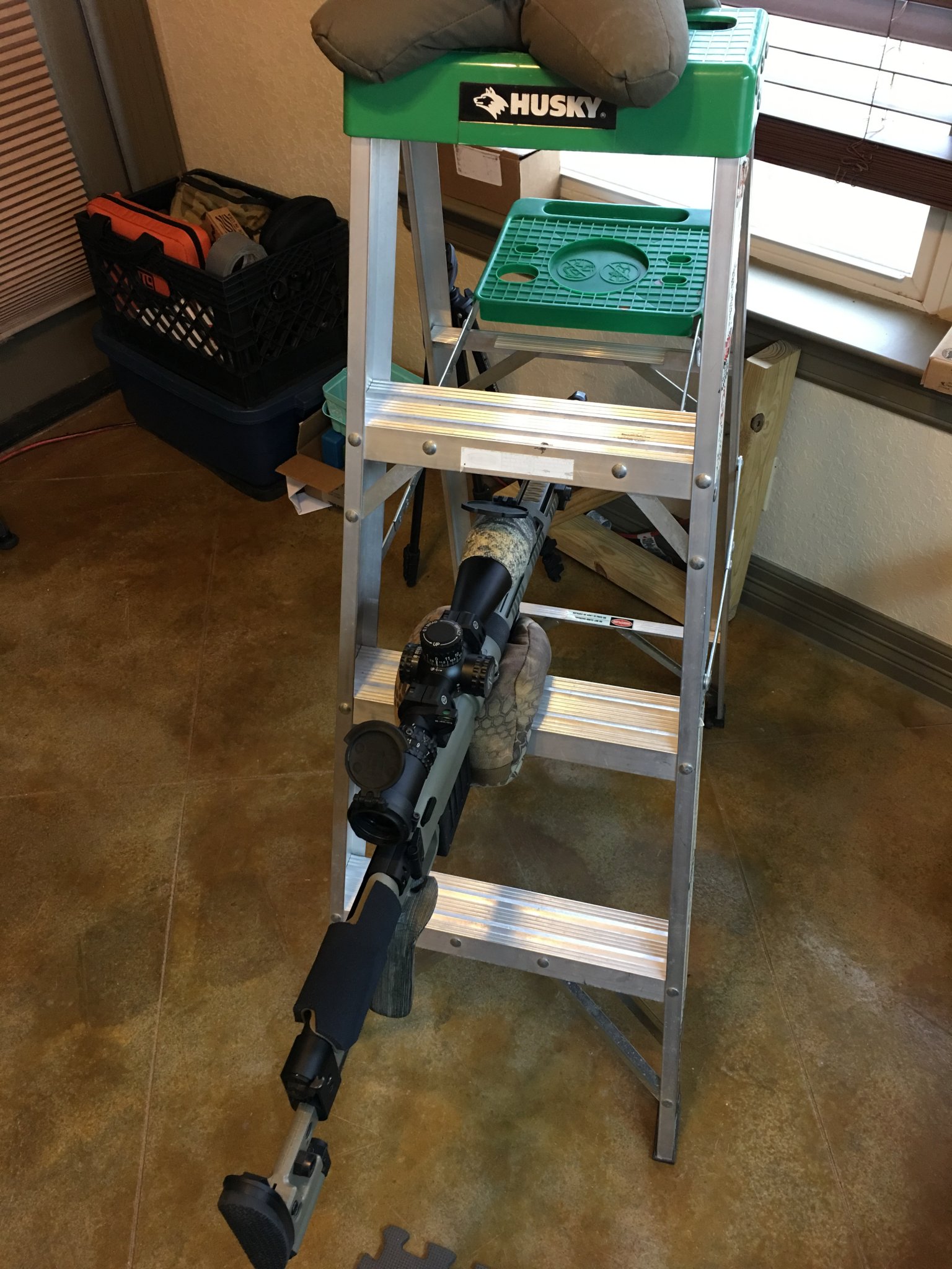

Conrad, great stuff! Any idea what max LOP would be? I'm quite tall at 6'9".
Any other pictures or findings on ergonomics would be appreciated.
I measured about 14.75" and that is leaving the butt stock about half way in the clamping block which I think would still provide adequate clamping force. Would have to play around with that. 2 things though. 1) I'm running a slightly shorter LOP than normal (~1/2" shorter) such that my cheek weld is good on the cheek piece, and I just place the scope a little more forward. This isn't an issue and the rifle is very comfortable in all positions. 2) The Pachmayr recoil pad is very thin, so I would think you could easily gain some additional LOP with a different pad, or a Delrin spacer. That would be an easy fix.
I am running a piece of foam I got off Amazon on the cheek piece. I have a fairly skinny face and while the adjustable cheek piece wasn't maxed out I wanted to make sure I had plenty of elevation if I had a scope mounted higher in the future. The rail is very low profile so you can get scopes low. Additionally, the foam is a little more comfortable primarily because it gives the piece a larger radius, much like my old T2K had, which I liked the feel of better. This will simply be personal preference as everyone is shaped differently, but I found an easy fix for me.
Rifle is adjustable for Cant and cast, and you can also rotate the cheek piece left/right if you desire.

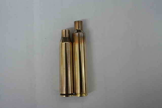

I just picked up some 33xc brass on their site :D and sent in an email on availability of the platform in Right hand.
Going to go with the .590 bf so i can do 33xc ,338L and 300nm ,get a 2nd bolt head in .532 for a 300win.
