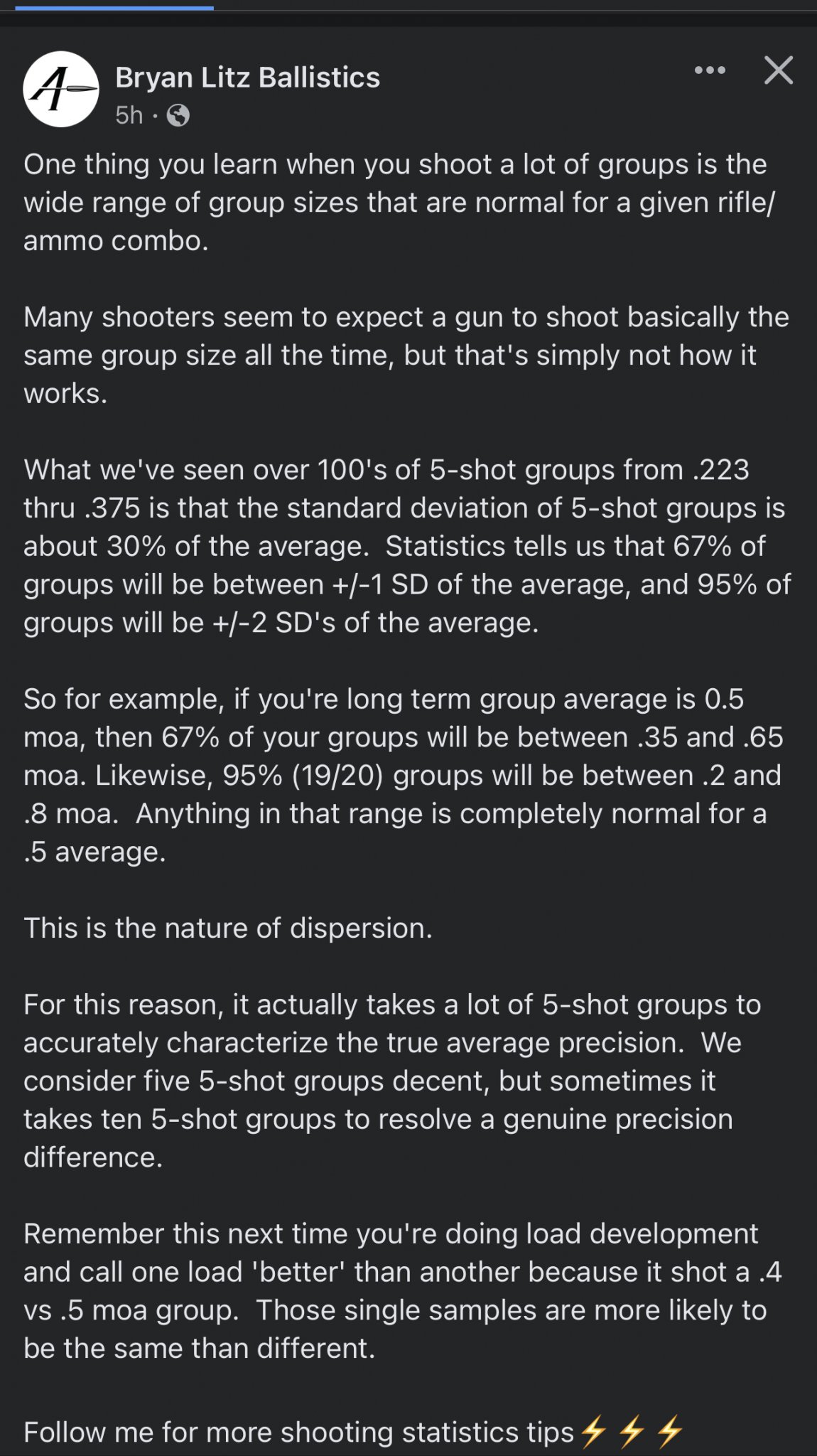

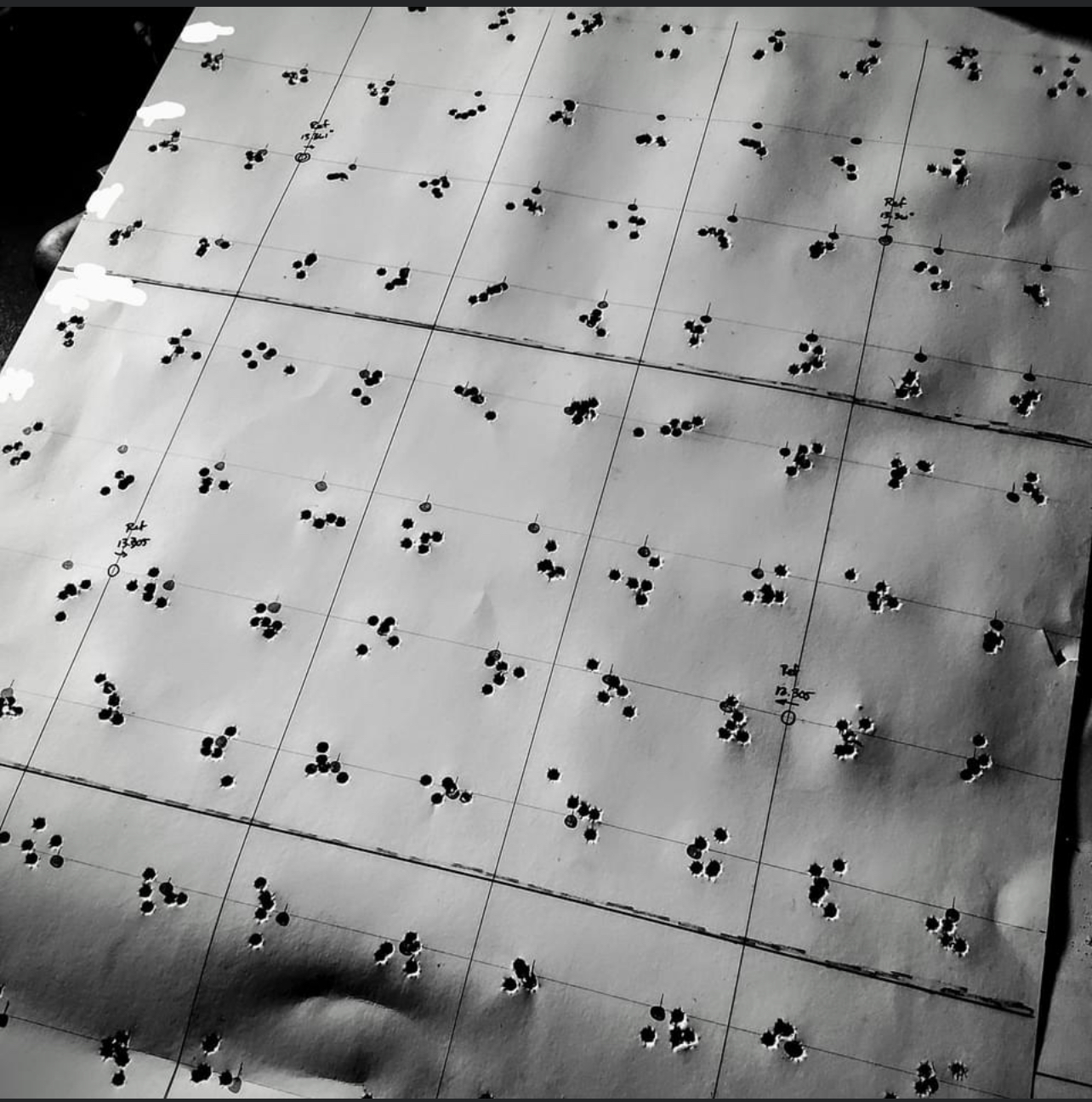

For anyone interested in actual dispersion, here’s a great example and explanation.
Interpret how you will. Long term data suggests an SD of 30%.

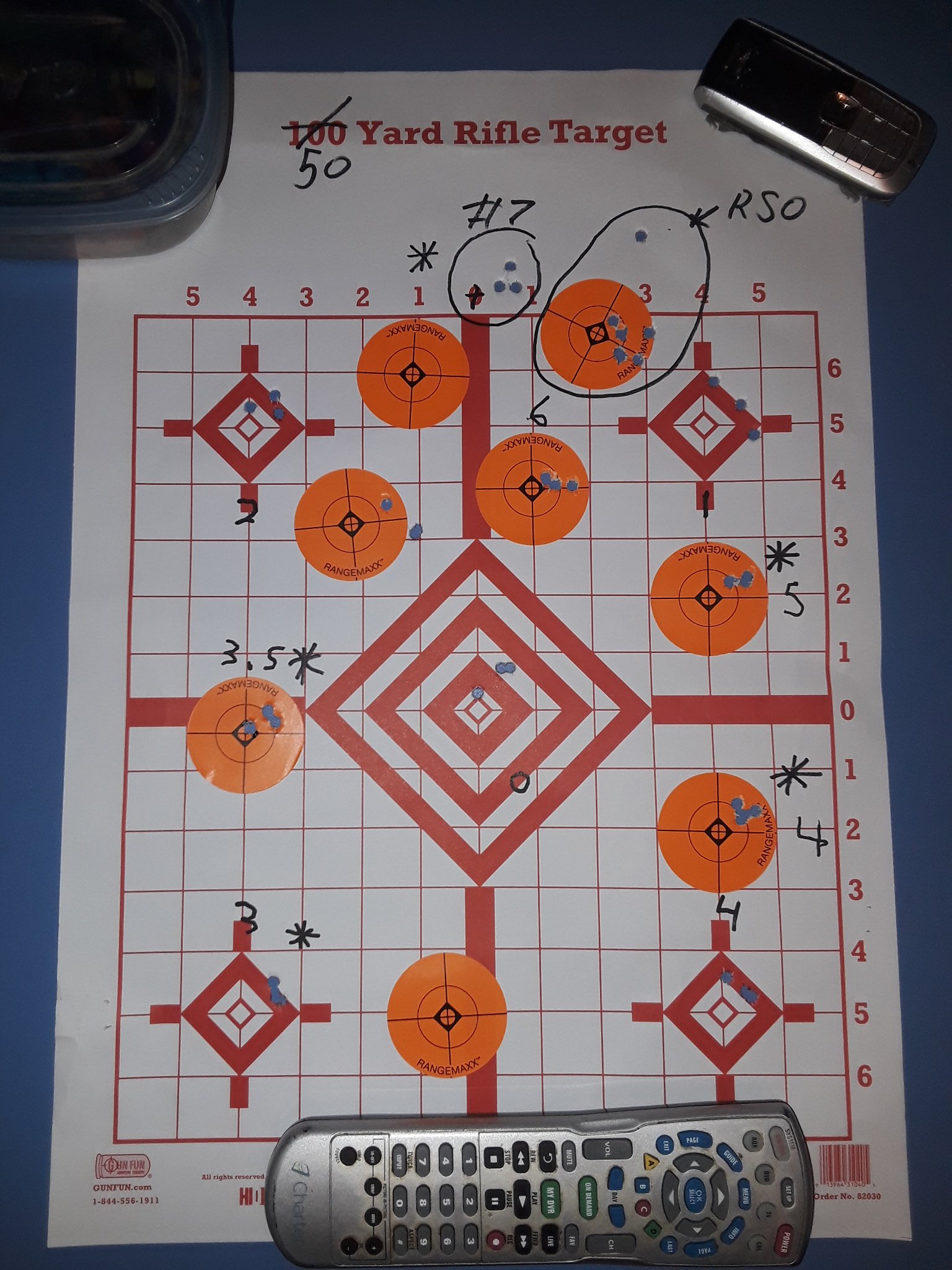

Here is an example of a load that got messed up when going from single stage development to the dillon.
Within the first 9 shots I knew something was wrong.
The load had been worked up with the EC tuner brake set at 1 .
I had got a few tight tests with 25.3g of H335 and decided it was time to get the dillon rocking and test the tuner setting.
It was an oh shit moment when setting # 1 was crap. The tuner got the rounds back under controll and usable but no nice round tests.
They were stringing togeather and I don't like that.
When I got home I checked the dillon and it was throwing 25.2g which I suspect is the very bottom beginning of where it gets good.
My equipment only reads to 0.1gr
It will be redone, and those remaining rounds still are not horrible but I really wanted some nice groups to show off. Lol
Anyway not scared to show some mistakes along the way.
Ar, 50 yards heavy bags and my 12 cent bullets.
Edit: That's a reason I use 3 shots instead of just the two, to help check for stringing.

Shoot another 8 or 10, 3 shot groups on one setting only to see if that looks much different to adjusting the tuner every 3 shots.

Would you be willing to shoot a 30 round group each using your best and "worst" settings from above with that ammo? Sounds like you loaded a bunch of it on a dillon. I'll paypal you for the cost of primers, bullets and powder if you'd like.
^^ odd request.
The remaining rounds from that run have been tossed into the pumpkin blaster pile.
Today I only had time to load some 45 hardball. I should have time the next couple of days to tweek the powder drop on the dillon.
I doubt I do any 30 round groups because it will compleatly take out the center if it shoots like it did on the single stage / chargemaster loads.
It would be possible to overlay groups and get the same data I suppose.
Maybe I might play with seating depth just for fun but it is so easy to just dial it in.
The pile of Frontier range brass I worked up was also probably not the best choice but I had hundreds of them.
It was just an experiment in plinkers that I OCD'ed on. Lol
As soon as I get another 100 loaded with the better charge weight I'll post them. If they produce (round) groups I'll shoot a few more if I can.
