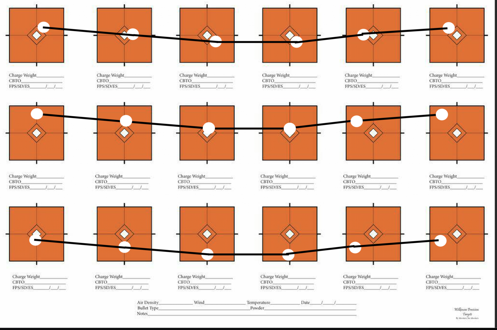

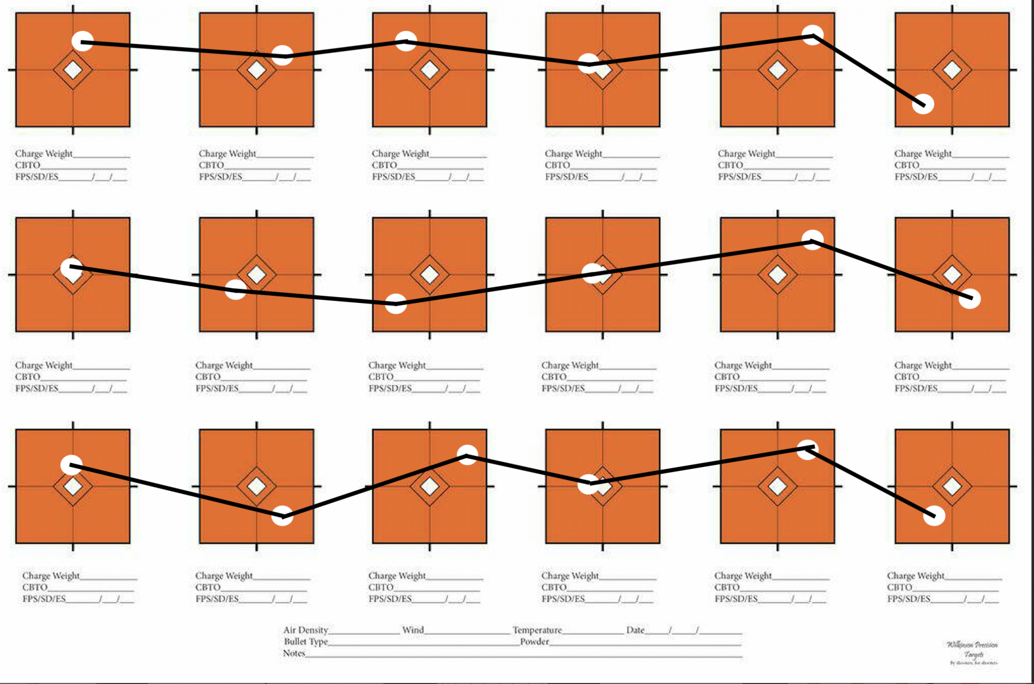

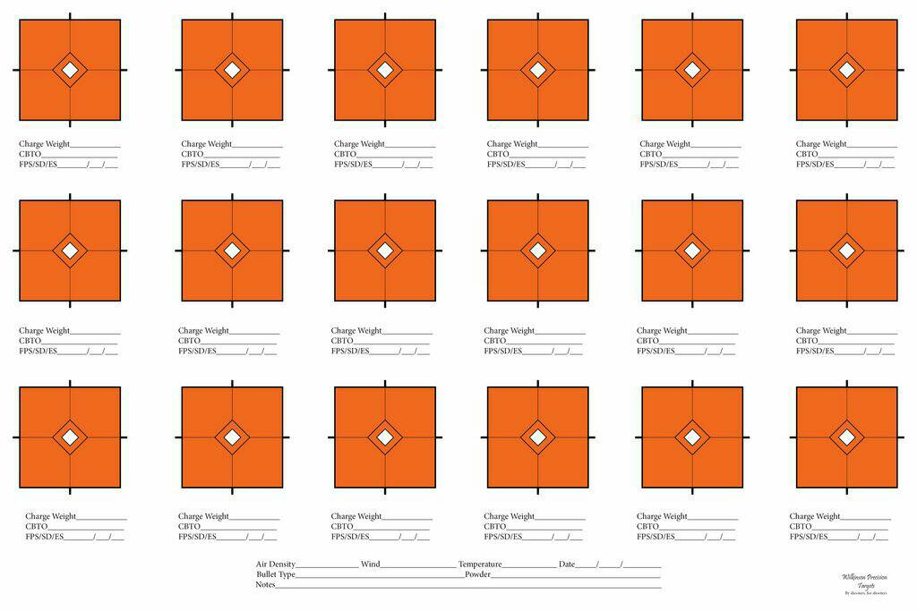

So, if you were to take a rifle, with a properly worked up load.
And you were to take your tuner, adjust it whatever amount you want. Let's say to mark number 1. You shoot a single shot at a bullseye. Then you shoot another shot at a bullseye under than....then another bullseye under that. Single shot each time at tuner setting 1.
You move to tuner setting 2. You do the same thing to a vertical line of 3 bullseyes directly to the right of number 1 setting.
You keep doing this.
So, you will have 3 horizontal rows of shots and 3 vertical rows. Each vertical row would be 3 shots at a given tuner setting.
If you were to draw a from each bullet hole on each horizontal row, you would have 3 lines that show the POI moving as you cycled through your tuner settings.
In your understanding of barrel movement and tuners would those POI lines be:
A) very similar
B) if yes, why, if no why
Thanks
Here is an example of a target like that:
If your tuner is set ideally you won't have any vertical at all.
If you then move the tuner to another setting you will introduce vertical into your shots.
Just for clarity tuners like the Stiller have numbers on them but they don't click and can be more precisely adjusted.
Tuners like the Harrels/Hoehn have clicks so your stuck with an increment that might not be ideal.
Not what I asked.
Which of those targets would you expect to see as you rotate your tuner?
