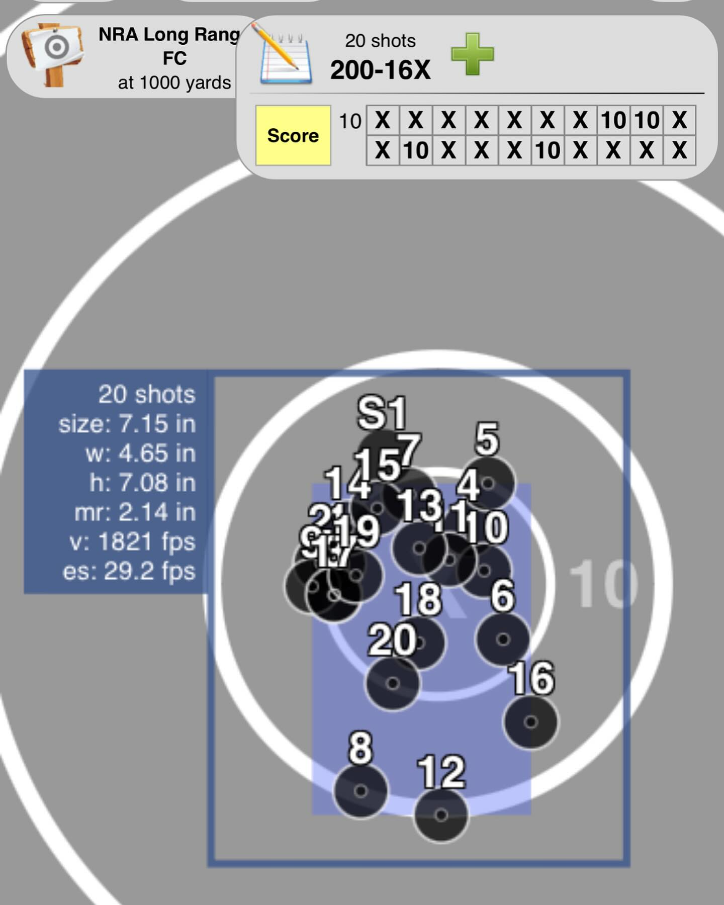

Eric can, thats why he is a champion. I believe he could potentially win without one, but having one, is like 10th of a second improvement on a F1 or MOTOGP bike. They dont NEED that 10th of a sec improvement, but its a nice buffer to have in your back pocket when you need it.
i'm not going to tell any one they dont know what they are doing when they can keep well with in a 10'' from 1000 yd
its being done at every F class event . because it can be done
Why will no one prove it? I saw Cortina once bring two 1000 yard target that he was claiming was due to tuner change but even his data showed the ES alone would have caused the greater dispersion. Just because they think it works doesn’t mean it does.
