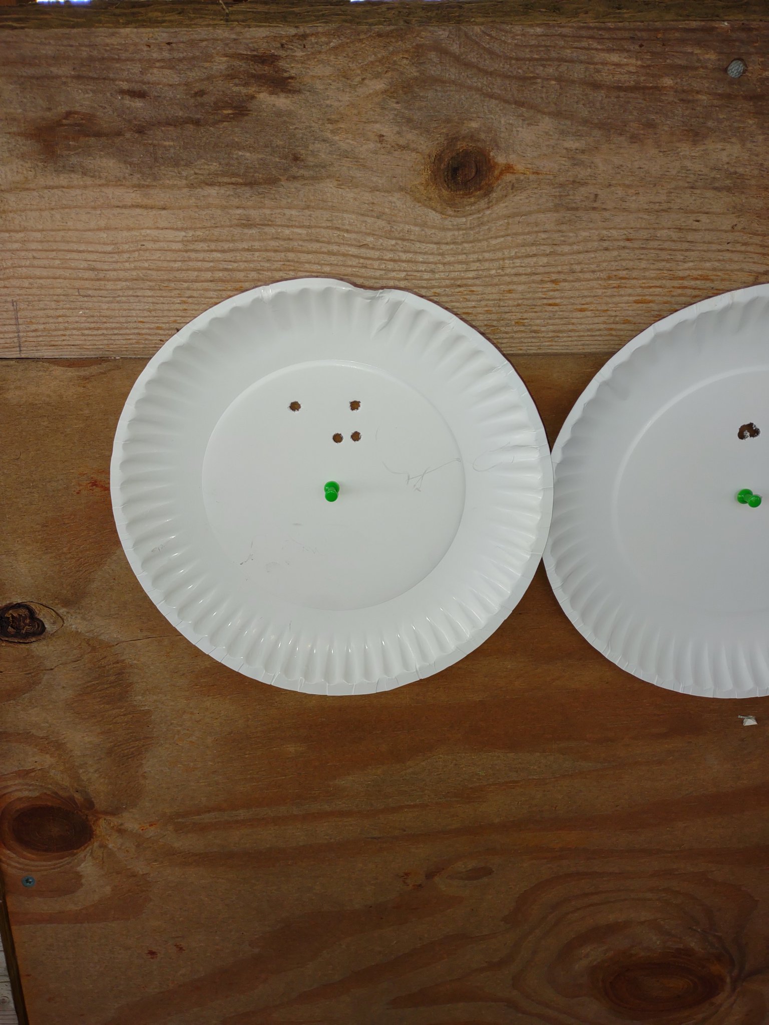

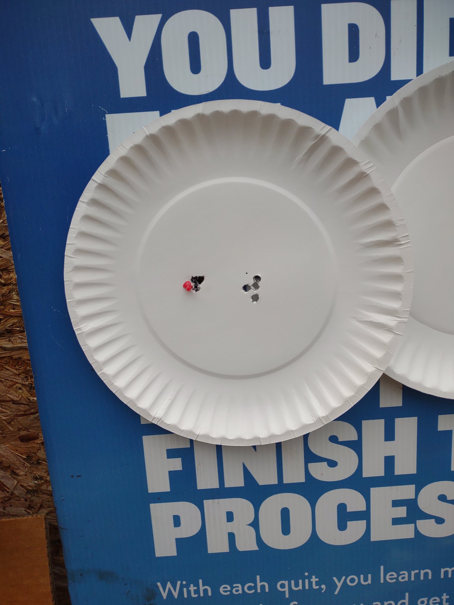

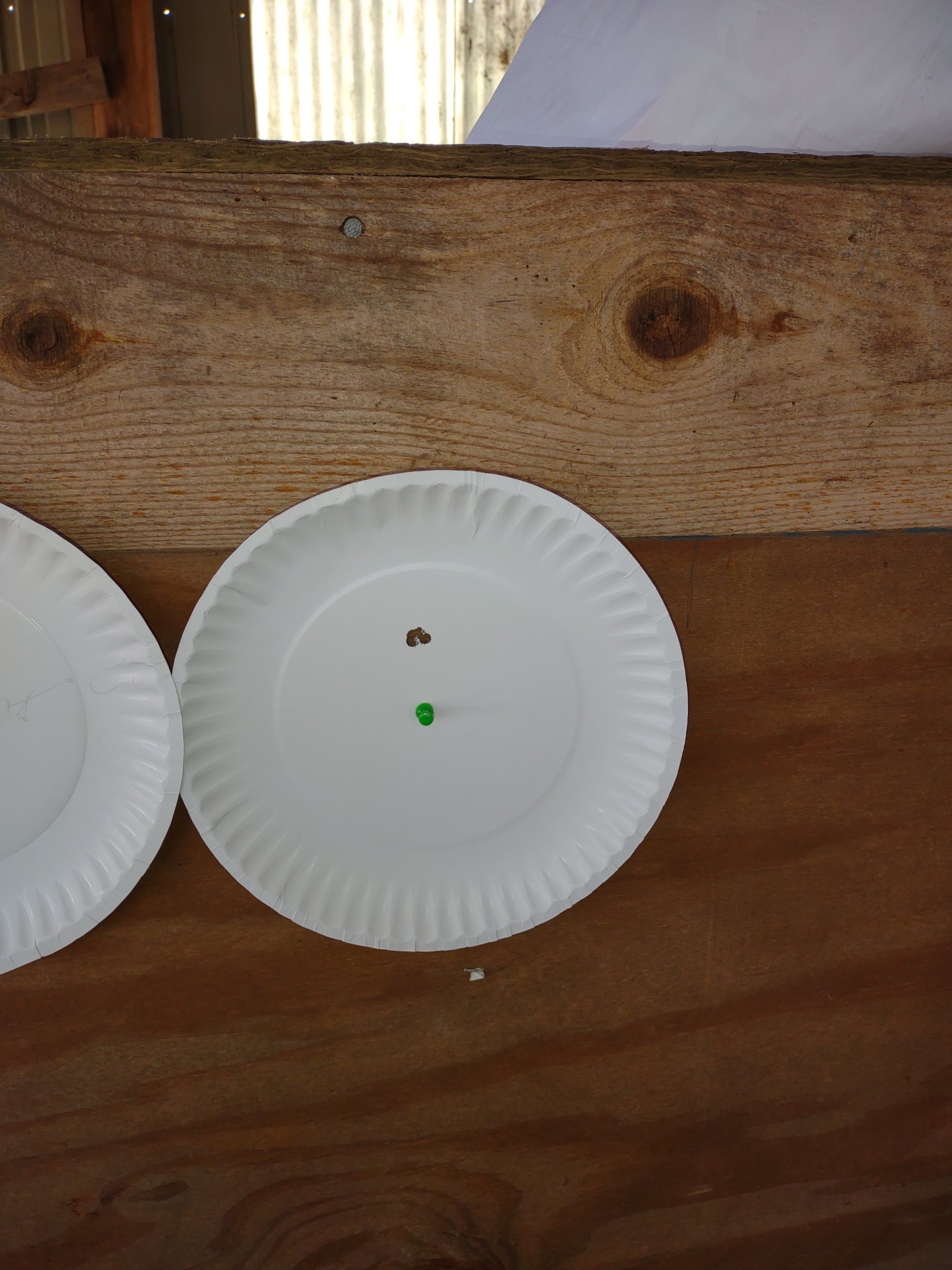

tuners work
LOL. Disregarding whether tuners work or not, you're showing literally nothing here. For example, here's the same rifle, same ammo, no tuner. Shot group, moved zero, shot another group.
It's fine to believe or don't believe they work, but at least put some effort into your attempts to illustrate it either way. Pictures of two groups ain't gonna show anything.

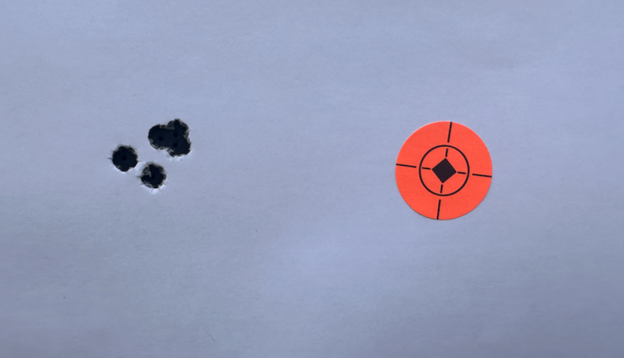

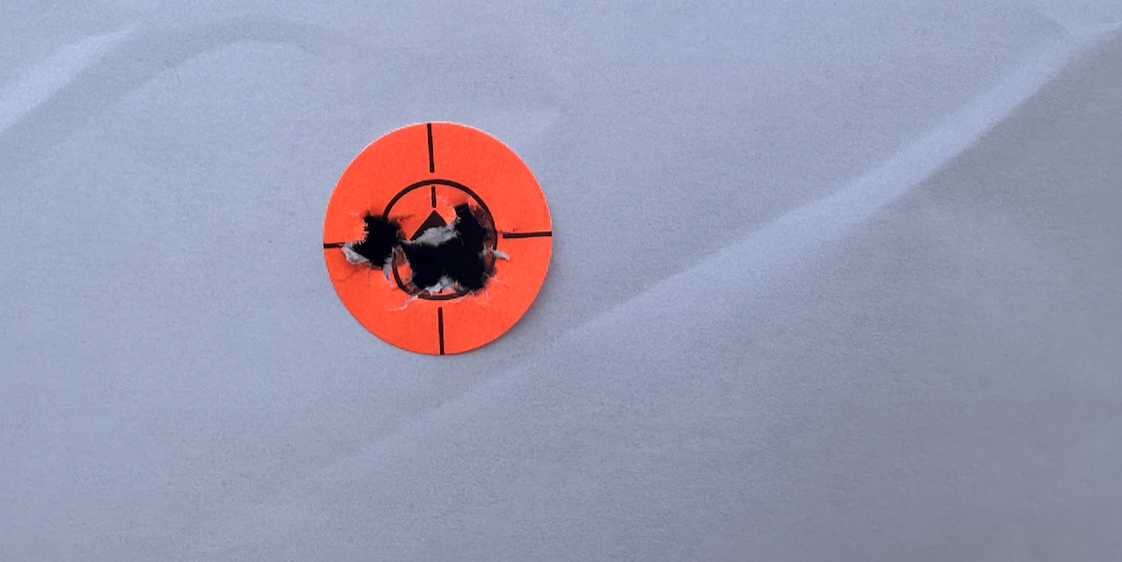

same rifle same ammo minutes apart. from bad to great by making a small adjustment to the tuner. are you that guy on youtube
''Whining in the wind''? he doesn't like tuners
I think the point being made is that its not uncommon at all for shooters to go from shooting a really bad group to a really good group. A lot of times its the shooter, not the equipment that causes that discrepancy. Posting two groups is not really proof of anything.
Reactions: Tx_Aggie

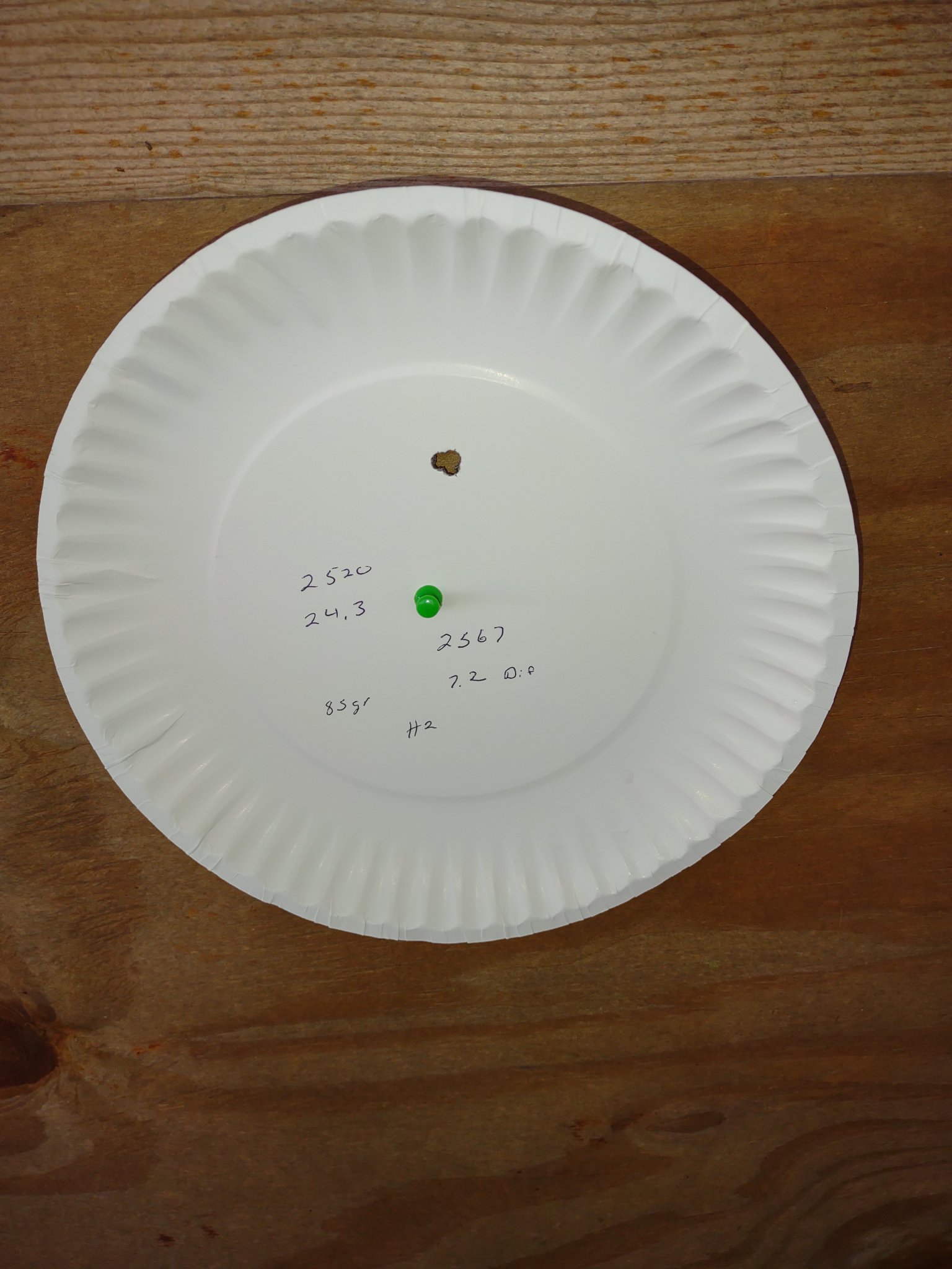

Minutes after,same gun 2/10 more powder 3 bullets. I had loaded 10 for the test saved the 3 to measure and take apart to check charges
Maybe the rifle liked a little more weight on the end. Maybe there was shooter error in the first group that contributed to most of the discrepancy. Maybe you're a victim of statistics. Etc.
Honestly, there are many factors that weren't isolated that could've contributed to your change in group sizes.
But if you think a tuner works for you, then by all means keep using it.
Reactions: Taylorbok
Have you not been paying attention? one or 2 groups proves nothing. Those groups are well within what would be expected of regular dispersion with no adjustment.
