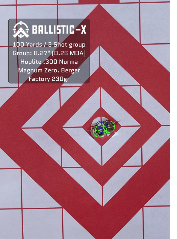

Been running 1-8 for a year now and strictly sending 250’s out. Shoots hole for hole at 100, girlfriend just shot at Spearpoint for the first match Saturday and took 4th with it.
I had a load that was 2990fps too heavy a bolt lift ... the rifle was not Able to handle it
I recently switched my Legacy AWSM to a dedicated 300NM and it can handle the pressures much better

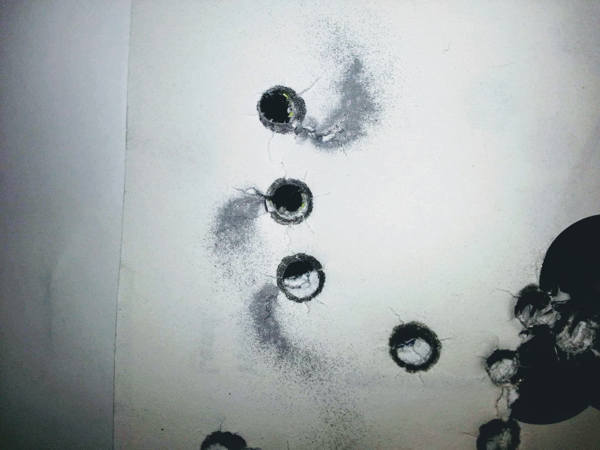

I did a lot of work with a .221 Fireball using a 7 twist. Velocity is not that high but pressure levels get critical REAL QUICK. Between not enough pressure to stabilize the case in the chamber and over pressure signs with sticky extraction and heavily flattened/cratered primers was caused by a 0.3 grain difference pushing a 80 grain Berger. Hit the sweet spot and that little round can do big things momentum wise. However, that tiny round, trying to push heavy bullets down a fast twist barrel is real hard on the gun, hence the critical powder charge weights. It actually was able to send a 90 grain Sierra. In testing, a slight wobble was seen on paper at 50 meters but the group at 200 meters was still within limits to reliably take down rams. Still, why push the firearm any harder when the 80 grains will do the job.
I suppose the point here is, there is no free lunch. Faster and faster twists can stabilize very long bullets but pressure rise and bullet fraiilability both come into play. What is marginal may not actually be marginal at all. The 9 twist in a .223 is not supposed to be able to stabilize a 77 grain Sierra but in a Savage Striker, pushing the bullet quite hard, proved very successful.

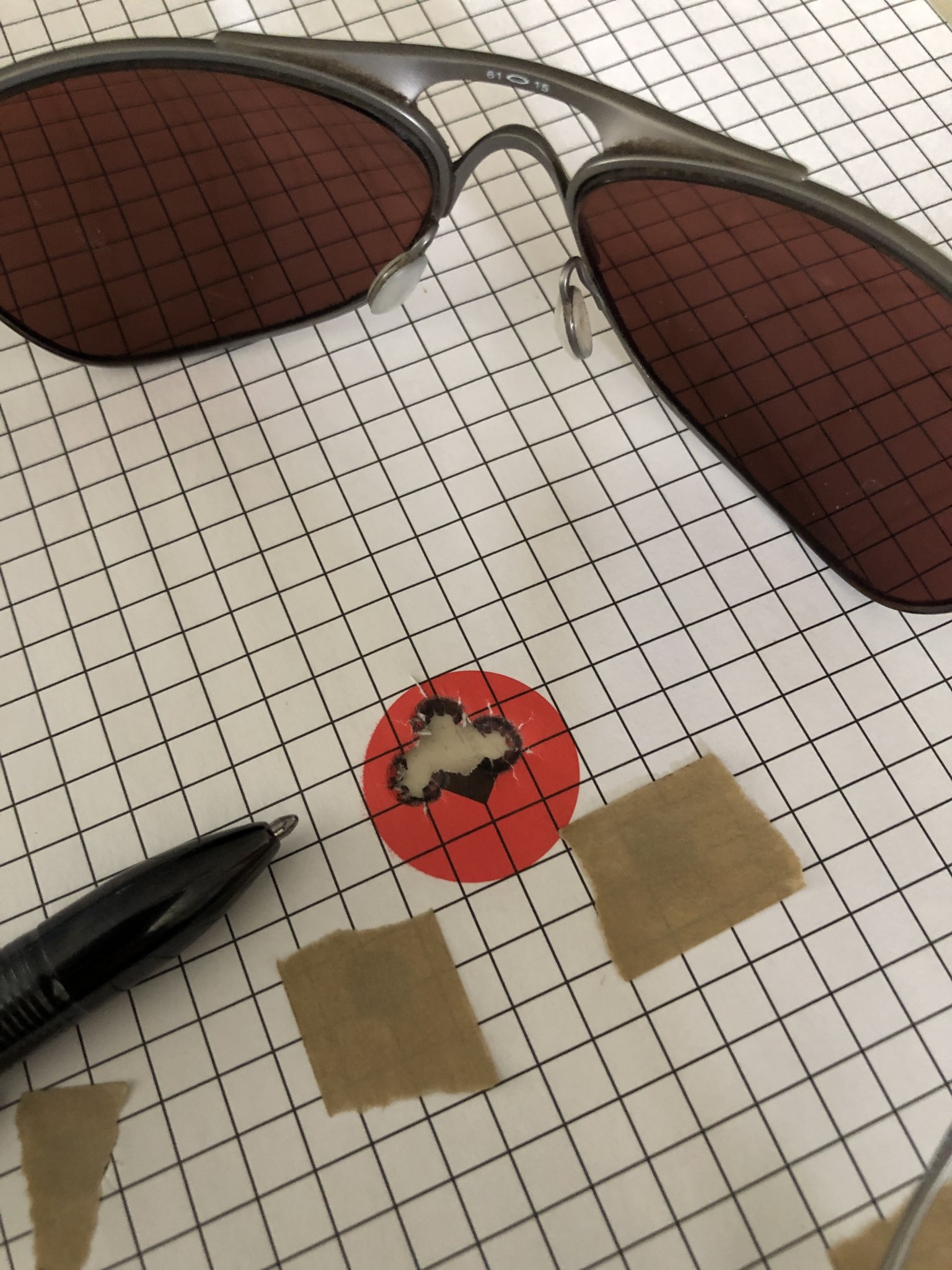

While we have been led to believe the 77SMK required a minimum of 8 twist for stabilization, I was told not that long ago by a Sierra tech that the 77SMK was actually designed with nine twist in mind. That bullet worked extremely well in my 9 twist 22-250 barrel.

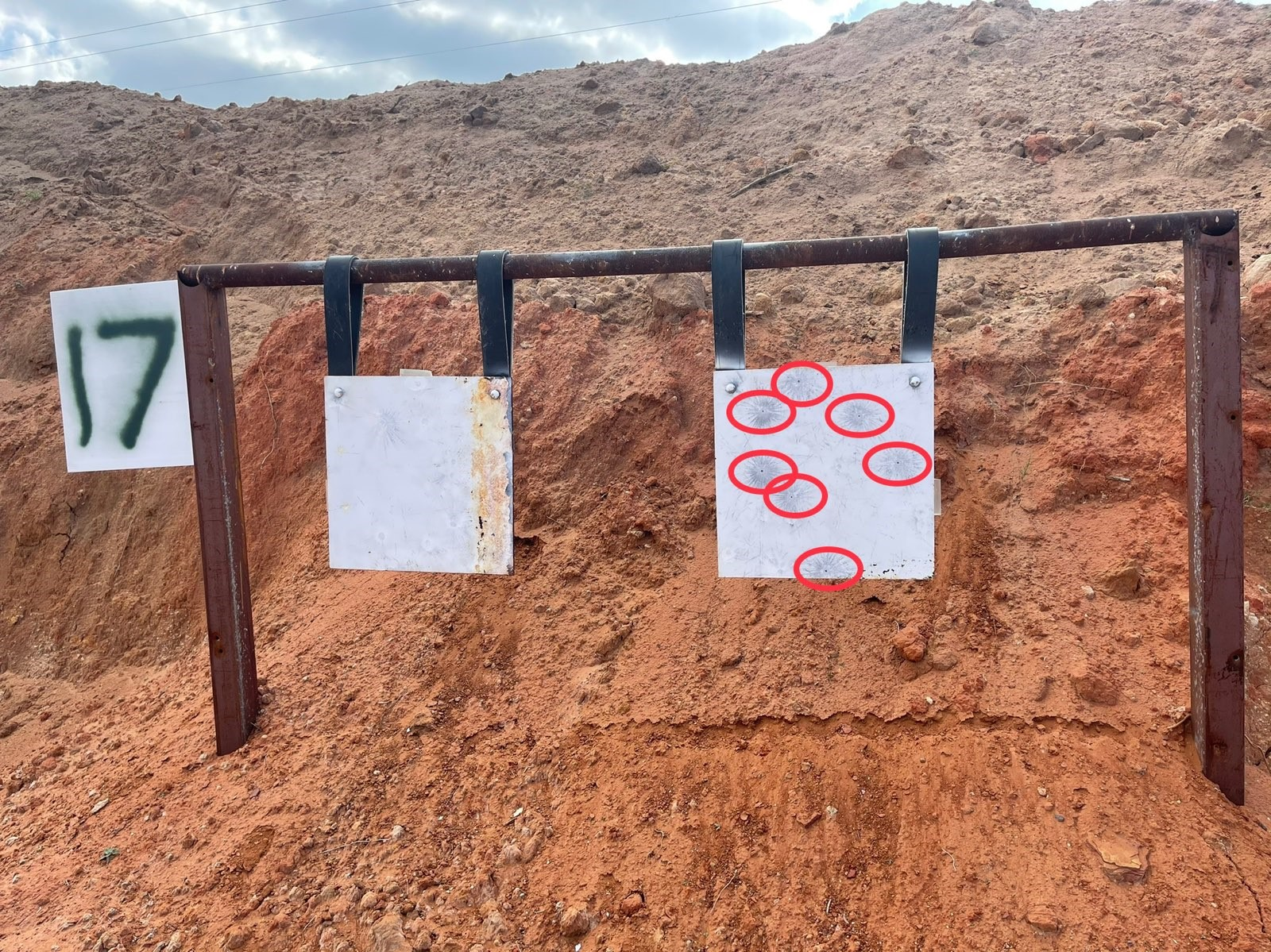

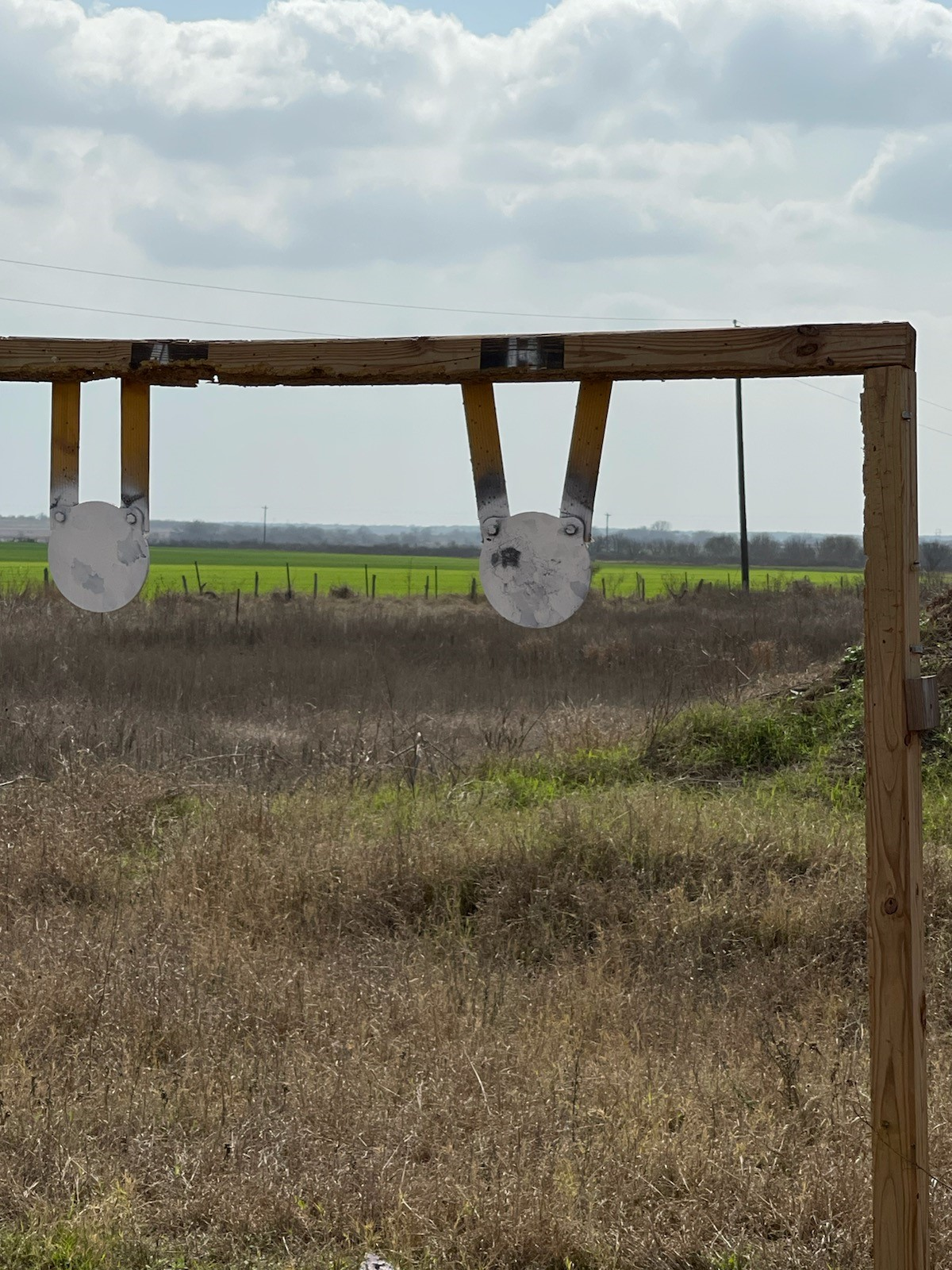

Hi,
ModBB Left hand gain twist exiting at a 7.....
At time of pictures the T&E rifle had less than 40 rounds through it.
Then first round impact on 1 MOA target at 1k after stepping to 600 and 800 IIRC.
7 out of 10 at 1 Mile...24x24 target.
Sincerely,
Theis
