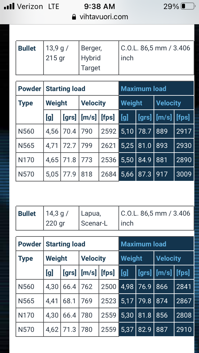

That would be great. I know for the 215 they list 88gr as max. I'm going to run 85-88 tomorrow and see if there's any sign of pressure.
This is what I got from Berger/Capstone over the phone. My COAL is 0.057" shorter than theirs but I'm also almost 8gr below their max.
.300 Norma Mag, Berger 220 LRHT, 3.680" COAL
N570
Starting load: 83.5gr approx MV (26" barrel) 2692fps
max load: 98.1gr Approx MV: 2986. 97% case fill
Reactions: goosendmax
N570
Around 98 gr is what QuickLOAD is saying should be the max for a 200 gr Bullet. You might ask if Berger has shot that load are are they just giving you the QuickLOAD data.
I started at 90, saw no signs of pressure, but 10% higher velocity than expected. When I adjust the burn rate of my lot of powder for actual velocity, QuickLOAD is now saying 90 gr is seriously over pressure. I’m seeing 3,000 + FPS with 87 gr.
Be careful out there.
Reactions: dgheriani
I found actual data for a few loads. I think 98gr is cooking. They're coal is super short, I'm at 3.620" with 215's
This came up in the 300NM thread in the reloading section. Viht's COAL is 3.406" vs Berger using 3.680". A 1/4"is a huge difference and gives you way more case capacity (at lower pressure). I too think 98gr would be absolutely cooking. I hit very slight pressure signs at 92.5. My COAL with 220s is 3.623" (2.820" BTO) and 90.4gr gives me 3200fps with no pressure. I had it out to 1608 yards yesterday. I guess we'll see as temps warm up. How temp stable is N570?
