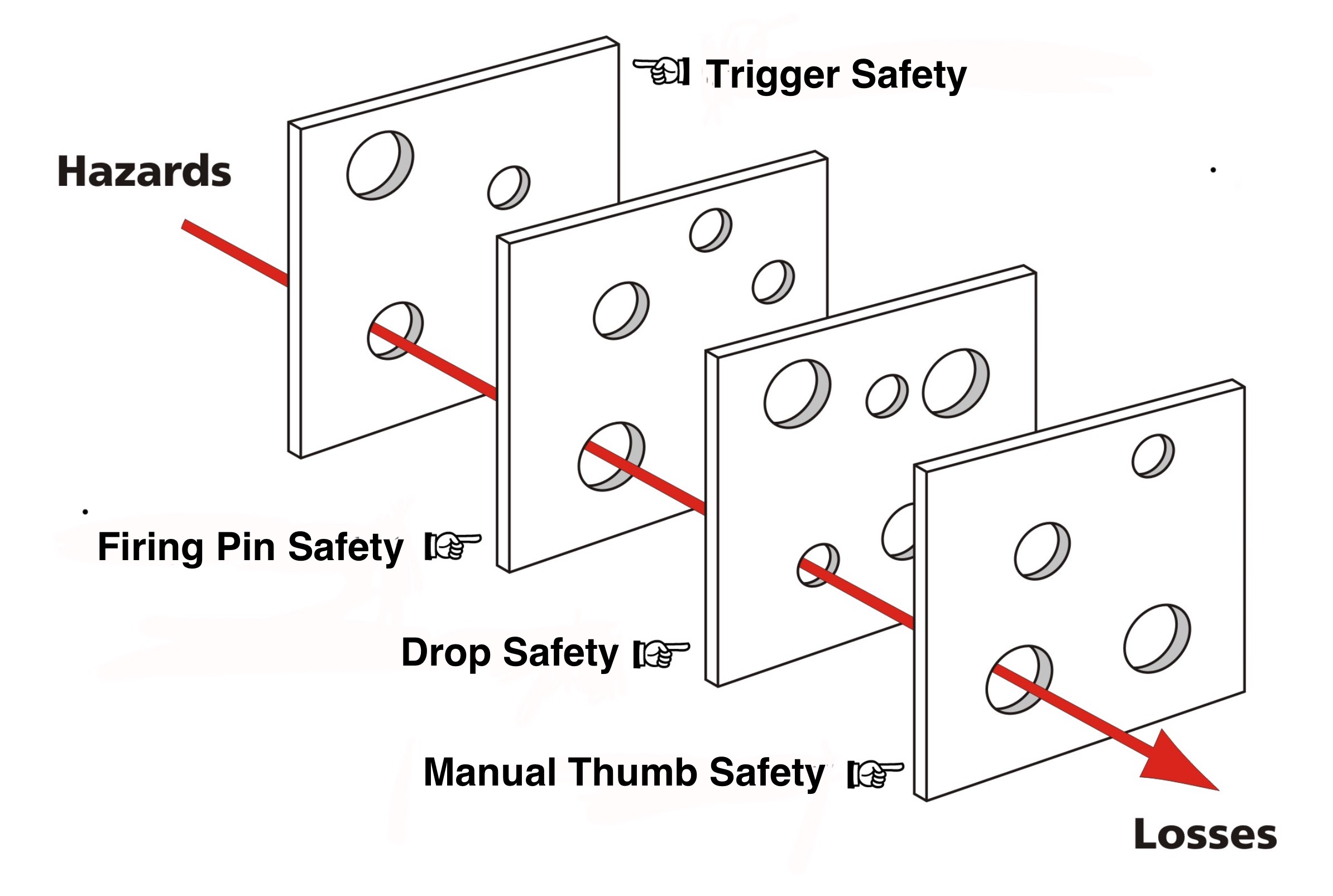

The trigger safety lever incorporated into the trigger of other brands could also be an additional barrier
Above is the Swiss cheese model (James REASON), a conceptual framework for the description of accidents based on the notion that accidents will happen only if multiple barriers fail, thus creating a path from an initiating cause to the ultimate, unwanted consequences, such as harm to people
For example, GLOCK choose to not use a Manual Thumb Safety, as they considerer other barriers are sufficient.
But if for some reasons, losses occur, something has to be done to put additional barriers.
Reactions: W54/XM-388
