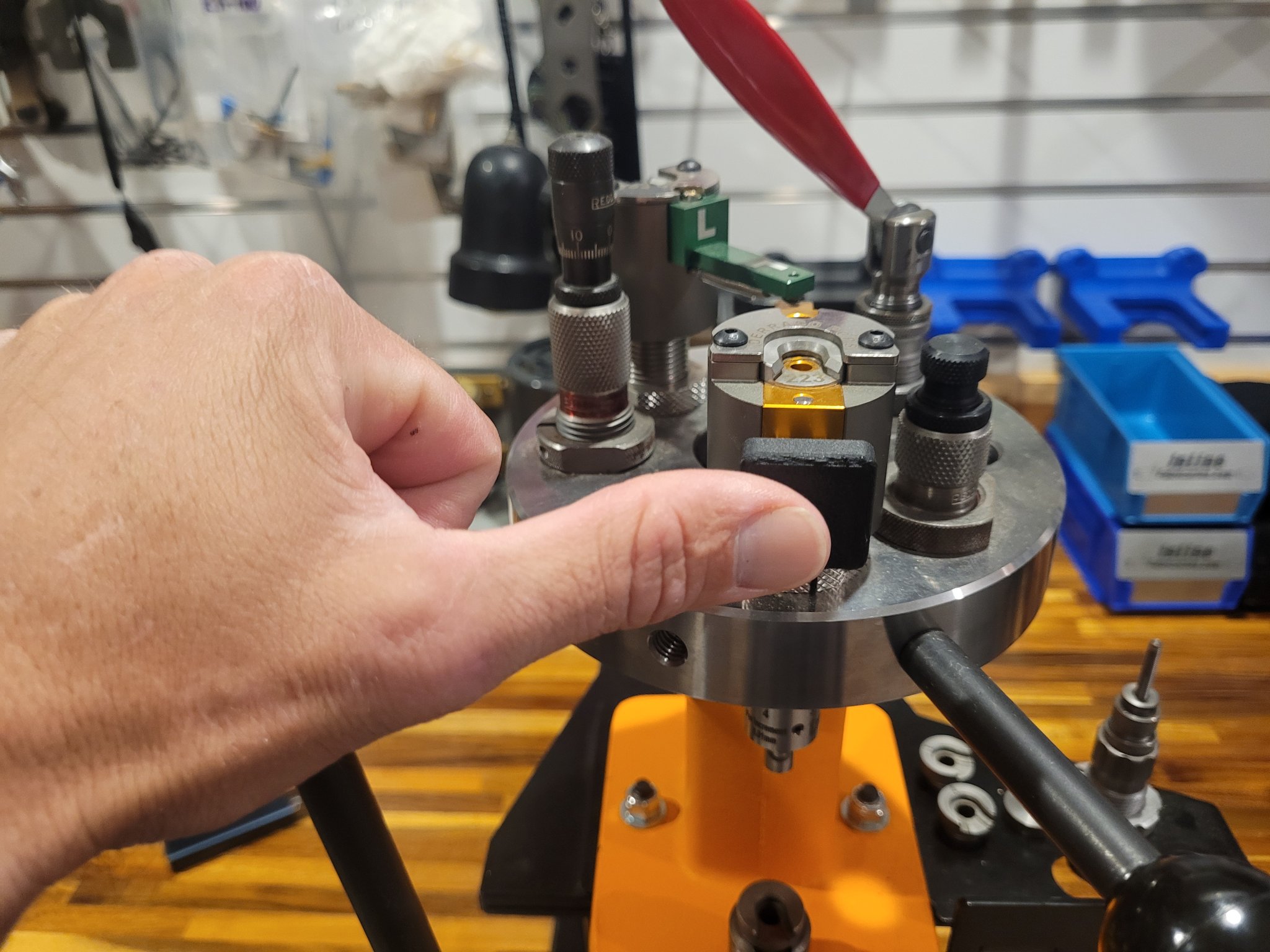

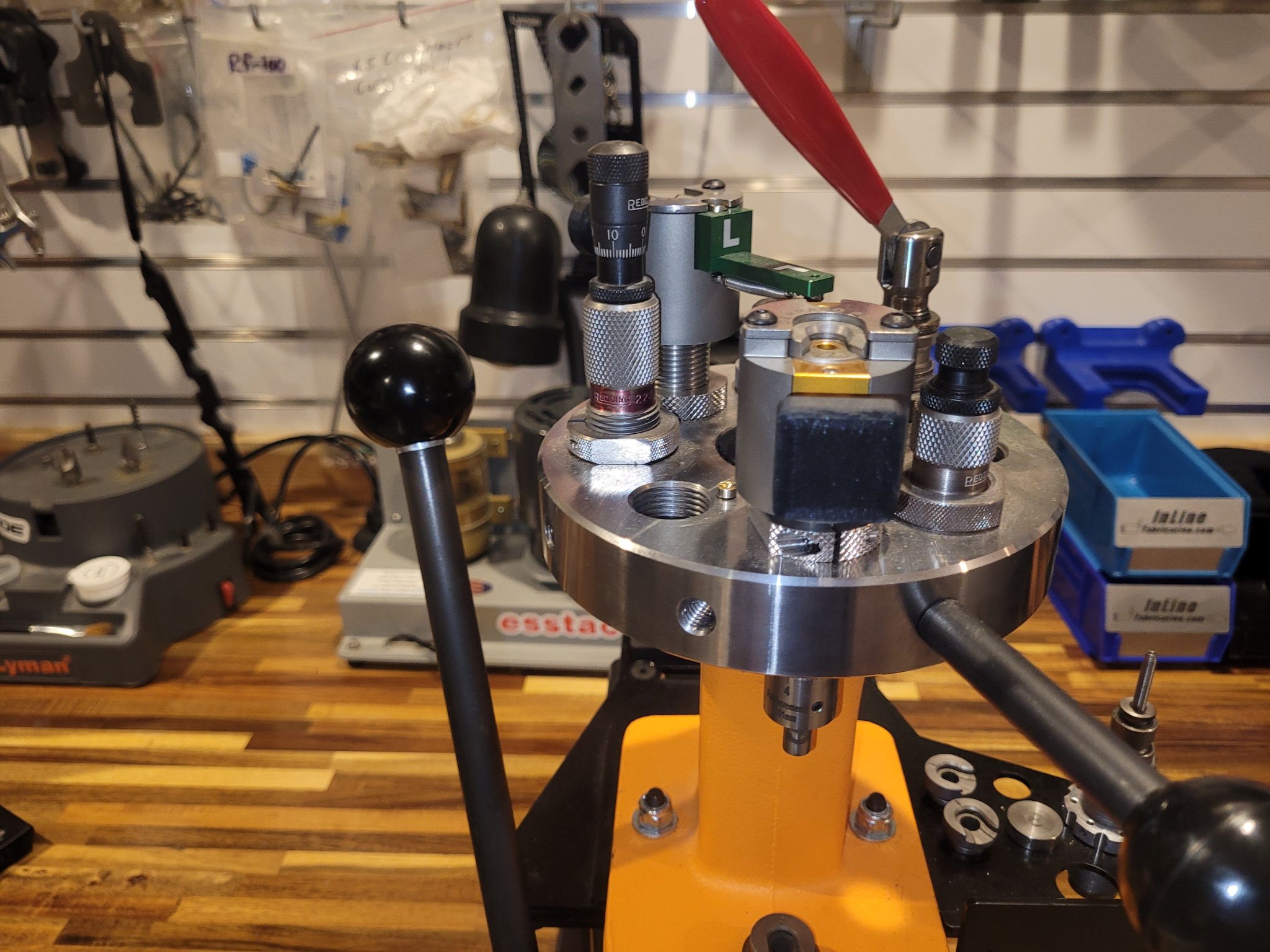

I got a guy to 3d print me some buttons to glue on the end of the push rod so I don't have to move my hand off the handle when I come up with it on the press. I can easily just push it with my thumb and load another primer really quickly. It works great and is very fast for precision loading. I'd rather them just make the end of the push rod with a bigger spot made into it to hit but these buttons have worked very well.
Very happy with mine, but I would prefer folks buy from Ugly Reloading vs Amazon so it goes to an American vs overseas distributor.
I have 2 so I can just keep one for small and one for large on my turret all the time. The rim thickness on my brass is pretty consistent and definitely consistent enough for me.

I'm not sure I'm following you on your button addition.
I like mine as well. But I am actually selling it to try out a lee app.
