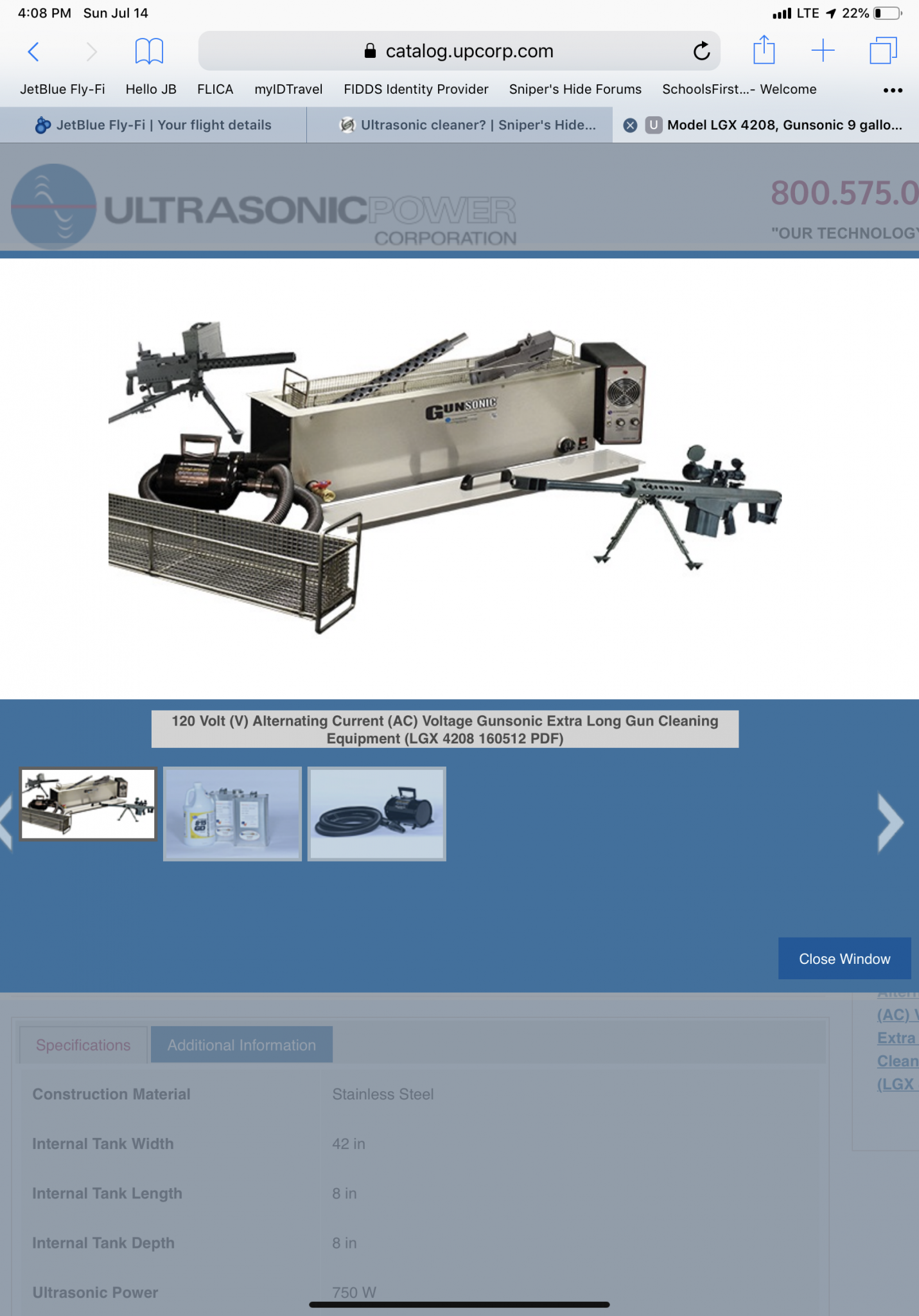

Something like this
7111922
Yikes, those are $4000-8000. I was thinking a little crest model at $700 was a stretch. The little Hornady lock'n load for $110 gets bad reviews, but it's only for some jewelry and a bolt carrier groups. I don't think I'll even mess with brass in it. The tumblers I have are fine.
Haha. I was showing an example of a commercial cleaner. I’m not dropping that kind of coin either but that’s the style I want. The Hornady ones are made in China so as usual, u get what you pay for. There are some decent value ones out there.
