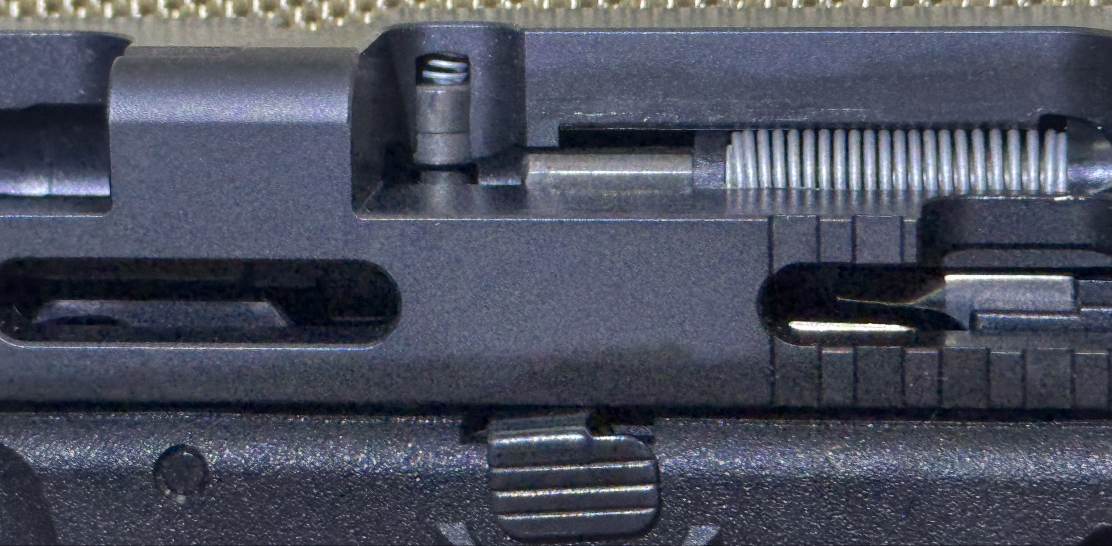

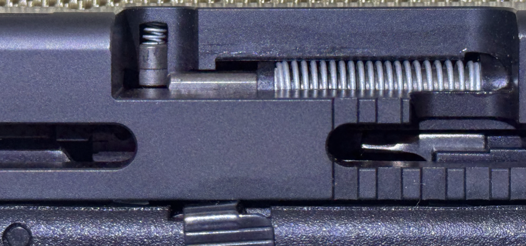

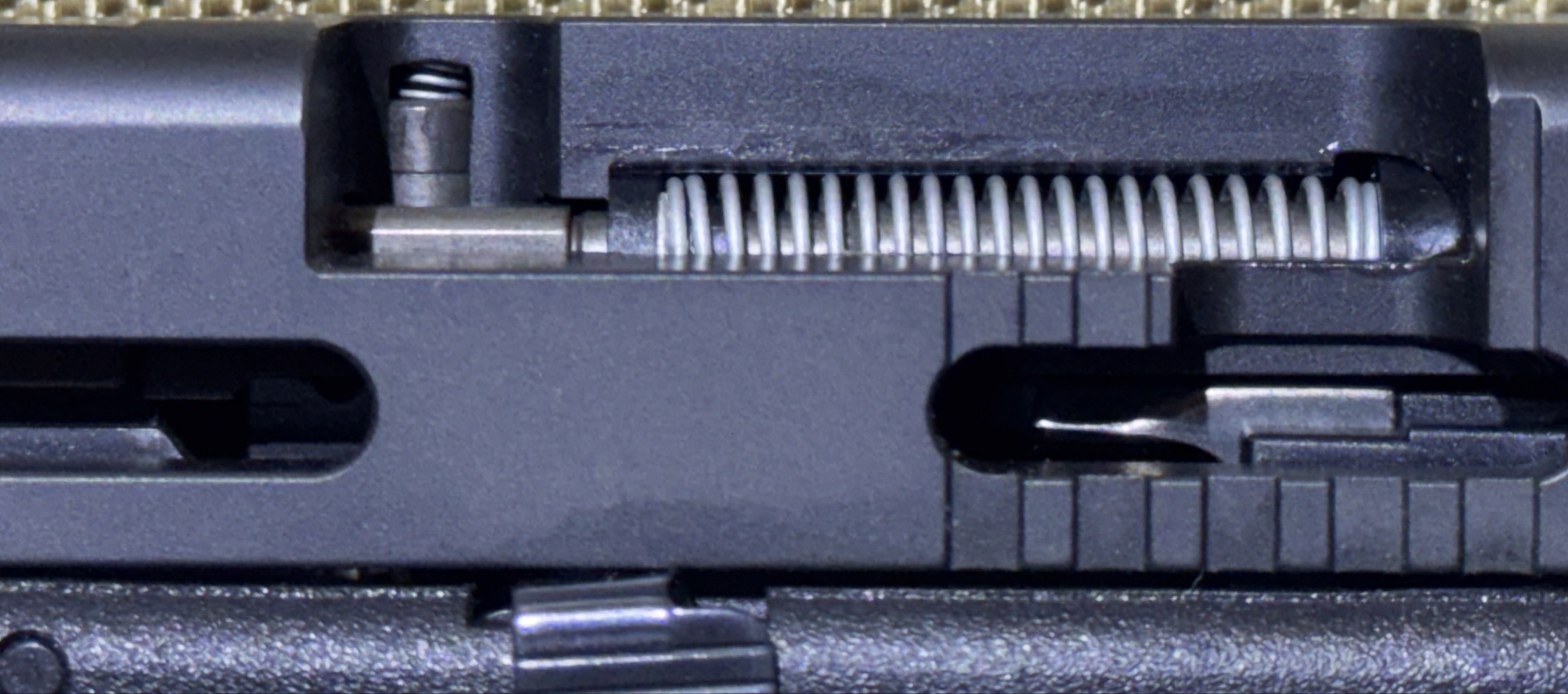

I took out my special cutaway Glock 19 just to gaze upon its inner workings again, and to make myself feel superior to all others
Fired, striker released.
Cocked, maybe 50% tension?
“Riding the reset,” maybe 50% + 40% tension, additional 10% to overcome that final hump before actually firing?
Very light pressure on trigger, sear displaced slightly posteriorly and inferiorly. Maybe 3/4 to as much as the entire sear’s thickness engaging the striker in the absence of any pressure on the trigger.
More pressure on trigger. More movement posteriorly and inferiorly, less of the sear’s total thickness engaging the striker.
Right before firing. Hanging not so much by the skin of its teeth (see first post), as there’s still that final “10% hump” to overcome prior to actually releasing the striker.

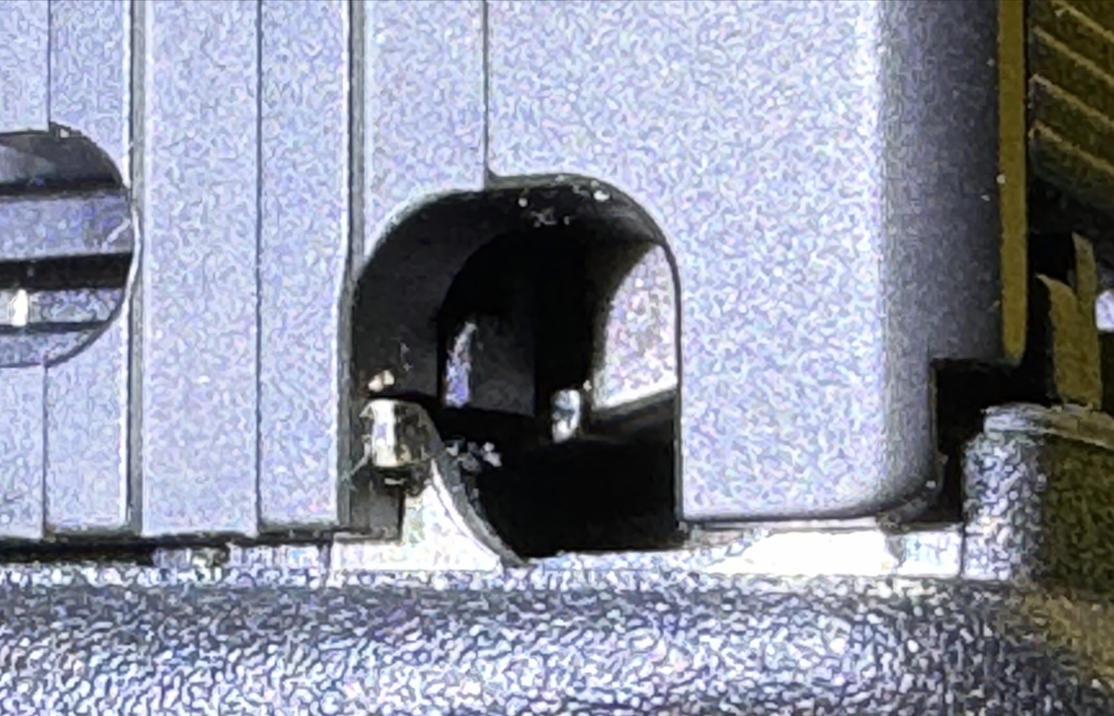

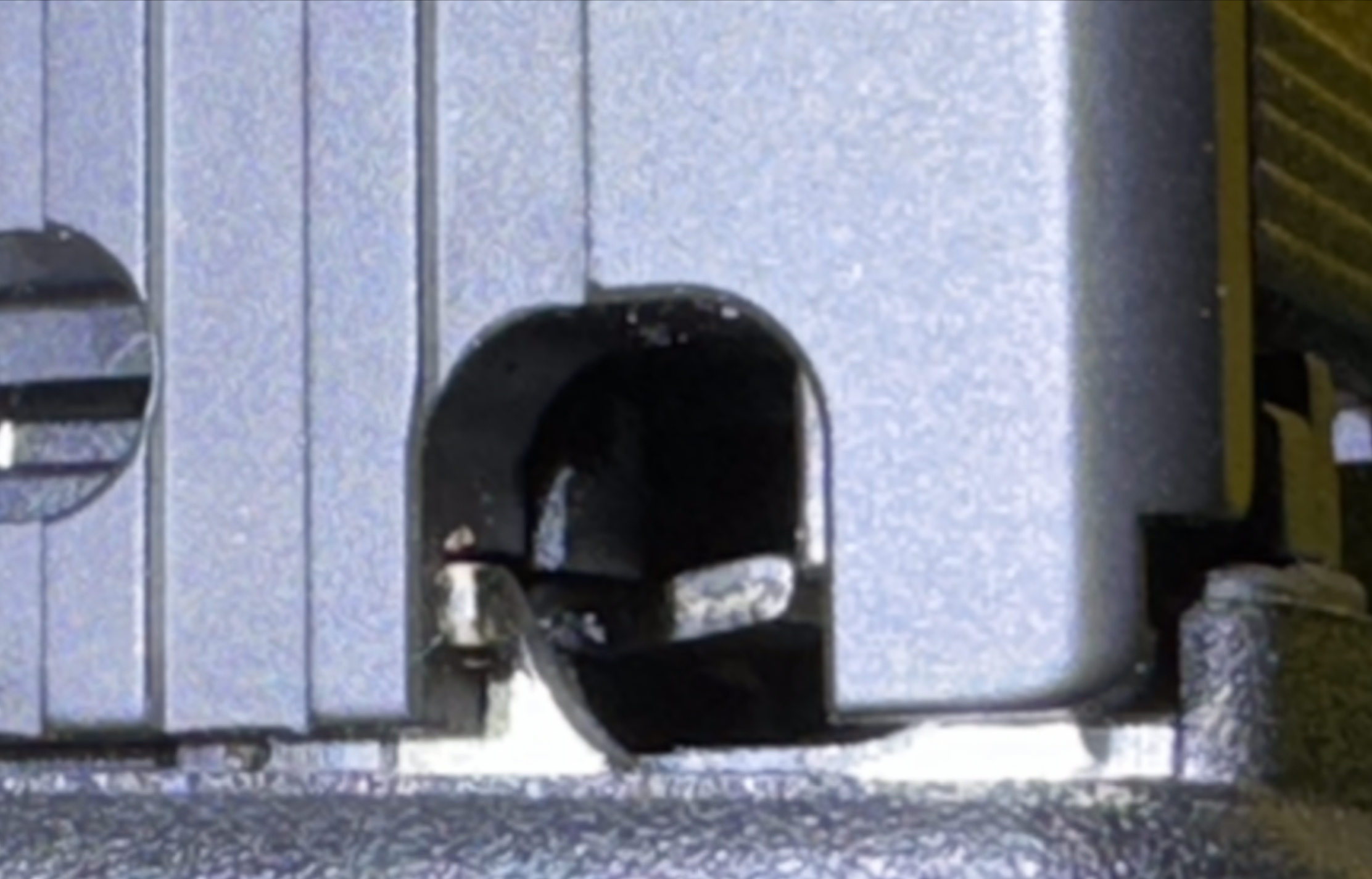

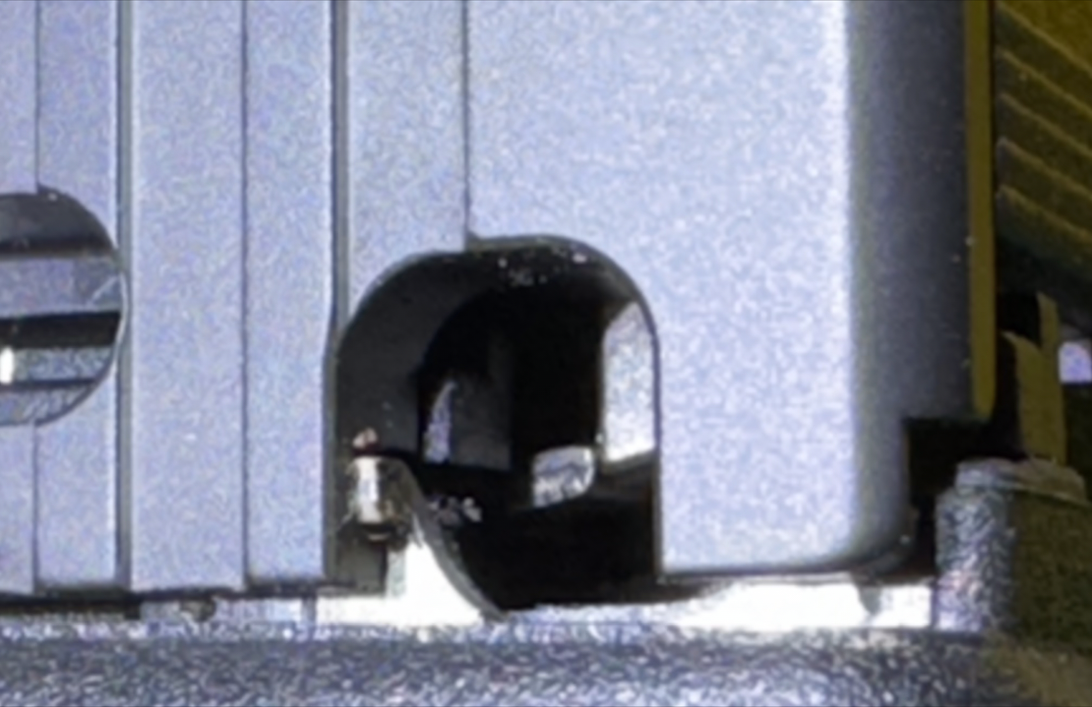

An actual video!
Trigger to the wall, maybe 50% + 40% tension, additional 10% to overcome that final hump before actually firing?
Right before firing. Hanging by the skin of its teeth, but there’s still that final “10% hump” to overcome prior to actually releasing the striker.
An actual video!

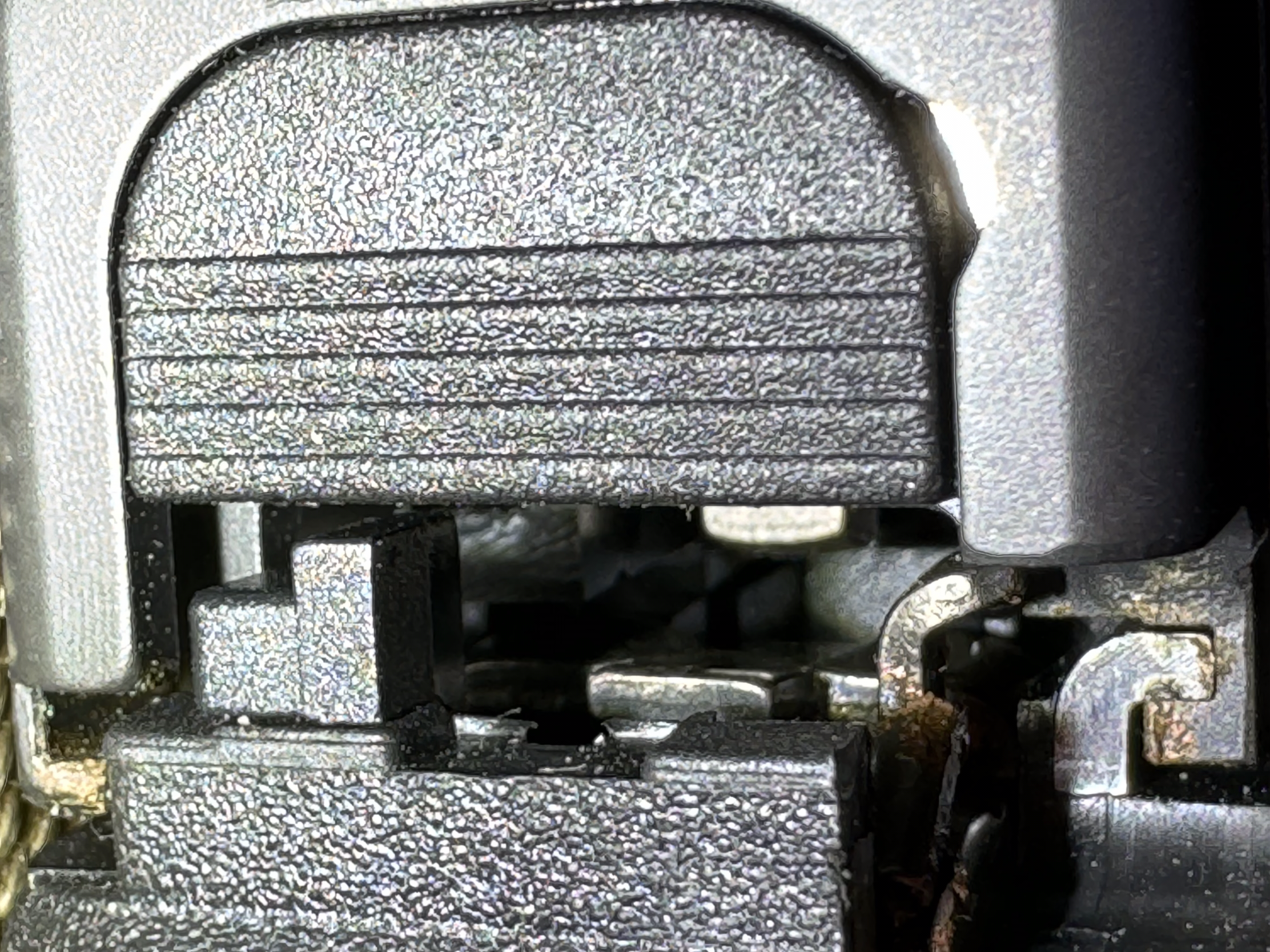

That’s really cool. Does it have the ability to see the channel that the part of the sear rides in to keep it from disengaging the striker until far enough back?
You can see part of the cruciform section at work from the rear, but it’s kind of tight…
Difficult getting the area illuminated with a flashlight and capturing and image with the phone simultaneously :ROFLMAO:
