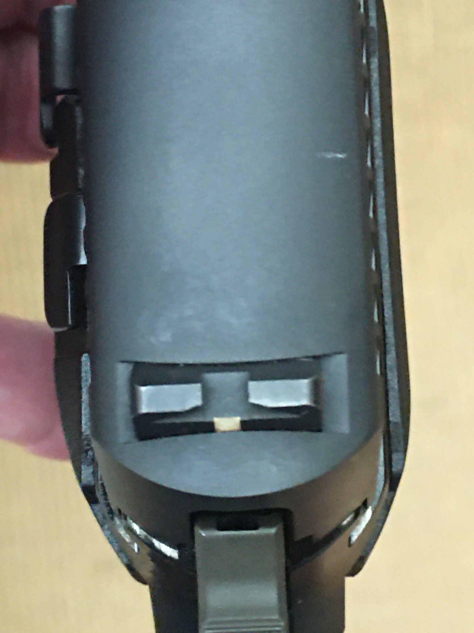

    Man I'm getting dizzy looking at the options.....crazy! I've got a P226 I want to make a tweak on the rear sight.....anyone have a universal they have used with success? Have S&W's I'd like to be able to work on as well. Thanks Hiders

    Ahhh very good thanks! I like it not afraid of DYI. Never had this happen before you ever had a sight migrate? I've got probably 10k rounds through this thing it's just noticeably in the last year I'm compensating more and more. Funny looked down the other day and was thinking what the heck?! It's spent a ton of time on my hip in the woods banging around I guess at some point maybe nudged it a bit much? No ding marks and in a holster.....who knows. So you just pad the slide in a vice and gently nudge it with dowel/hammer?

    I'm thinking it never sat in there tight enough.....can't fathom how it moved that much.
