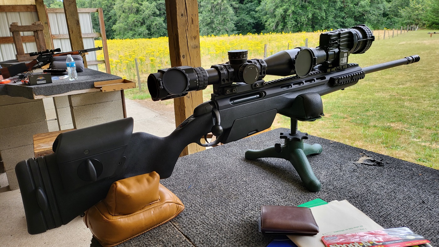

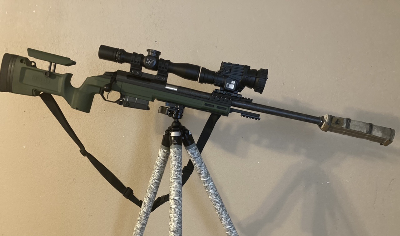

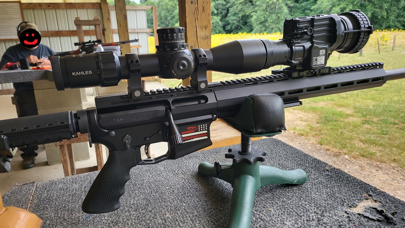

I will echo Evolution 9's sentiments. I have purchased several high dollar items from SOK and the ClipIR-LR is tops. Much better than the TigIR and I would dare to say very close if not equal to my older HISS. (and a hell of a lot lighter!). The CLipIR-LR is smaller and much lighter than I thought it would be. If you pick one up be sure to have 1.5"ish (standard) mounts and parallax adjustment on your day scope helps a ton. I'll be testing this more with a USO Foundation 1.8-10 and Zeiss V8 1.8-14 when they get here, both with side parallax. Scopes 13" and shorter are a big plus as well.
I have tried this on three rifles, all had REPEATABLE and CONSISTENT POI shift of 0.5 mils left at 100 yards. A 300WM, a 6mm Arc and a 17 Rem. Five clicks on each scope tested and back to zero. I can live with that. Mount the clip on, five clicks right and dead on.
Pics for your enjoyment...
Jeff

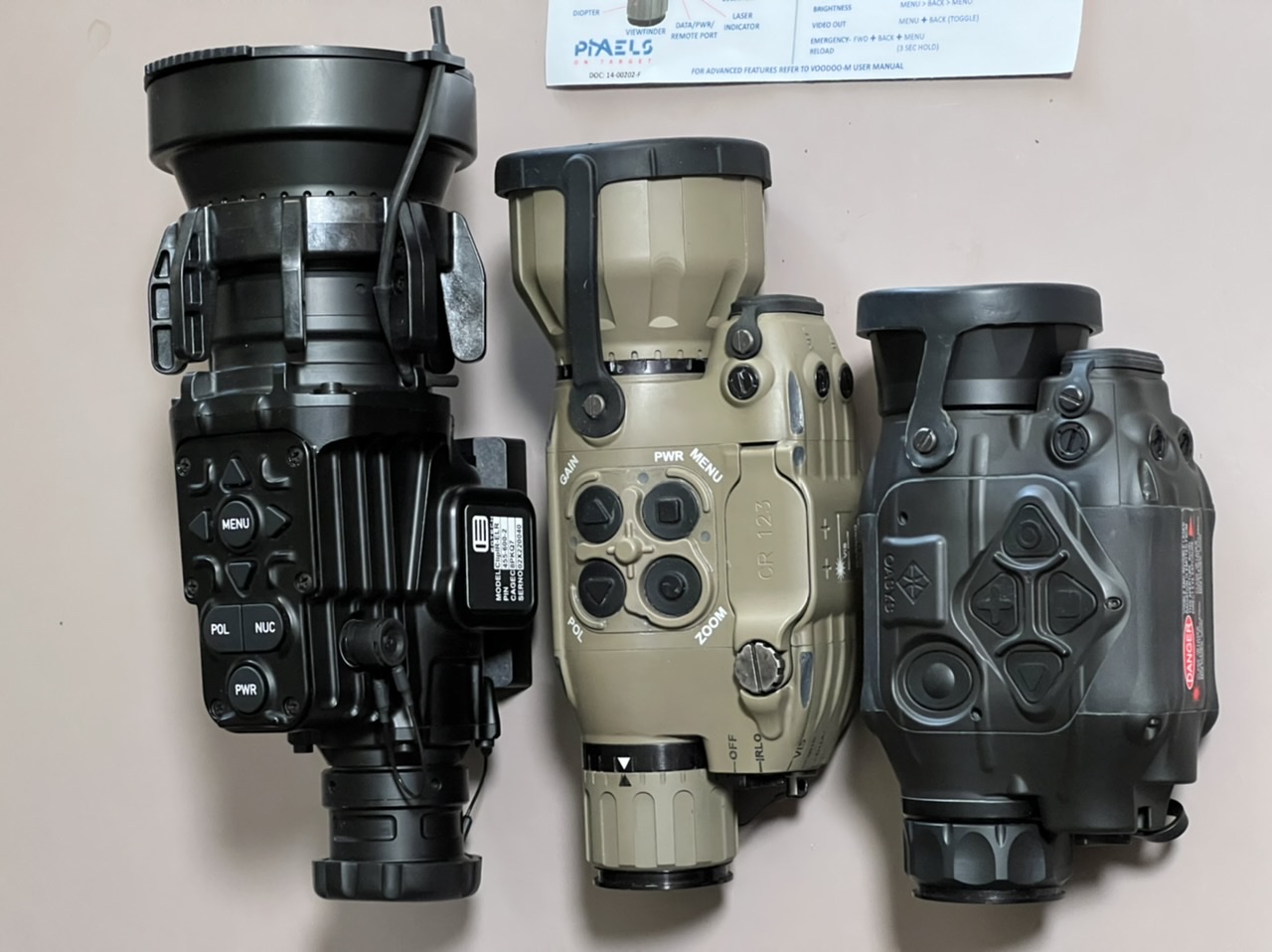

Effective day scope magnification range (sweet spot-max usable IMHO) / FOV at 100yds - as measured in the field by us:
ELR - 12x-20x / 8.5 yds low end of effective mag range ( 3x )
LR - 8x/12x / 14 yds (2x)
MR - 6x-10x / 21 yds (1.7x)
so, MR is good for lpvo on stoner type rifle for walking and stalking type hunting at short to medium distances where you might be facing multiple critters or face snap shots at short distances.
ELR is good for yotes in large, flat cut fields where typical shot will be over 300yds and some shots will be over 500yds
LR is a good compromise between the two if you move around a lot and are in highly varied terrain.
