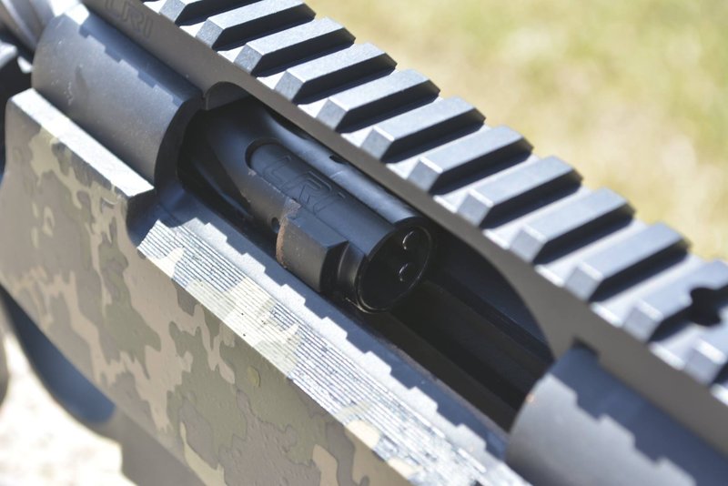

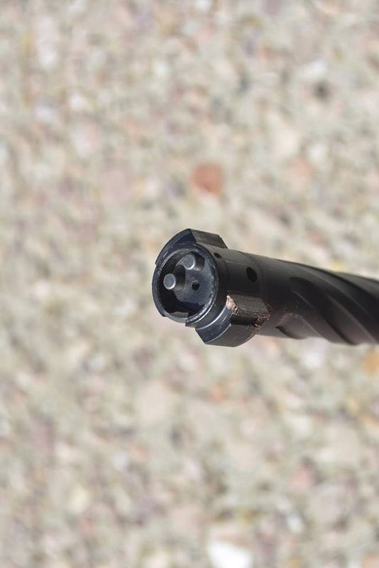

Dual ejectors alters the angle and increases the "snort" of kicking the shell from the port. The consequence to this is a slight increase in the effort required to roll the bolt into battery. You can mitigate some of this by trimming a few coils off the ejector springs. Some will argue that dual ejectors have the added risk of indicating pressure sooner due to less effective surface area being present at the bolt face. I too shared this concern until actual testing didn't reveal it to be all that relevant. These photos are of a 300WM loaded to the MK248 Mod 1 performance level. If it was going to be an issue, we'd of seen it with this setup.

M16 extractors do a reasonably good job. One issue with them is the ejection angle gets changed, often resulting in a case the flops right back into the loading port.
Dual ejectors alters the angle and increases the "snort" of kicking the shell from the port. The consequence to this is a slight increase in the effort required to roll the bolt into battery. You can mitigate some of this by trimming a few coils off the ejector springs. Some will argue that dual ejectors have the added risk of indicating pressure sooner due to less effective surface area being present at the bolt face. I too shared this concern until actual testing showed its of no concern. These photos are of a 300WM loaded to the MK248 Mod 1 performance level. If it was going to be an issue, we'd of seen it with this setup.

Thank you Chad. Great info and insights as usual. I didn't even know dual ejectors were an option. I'll reach out mid-week to talk through and explore options. Thanks again.
