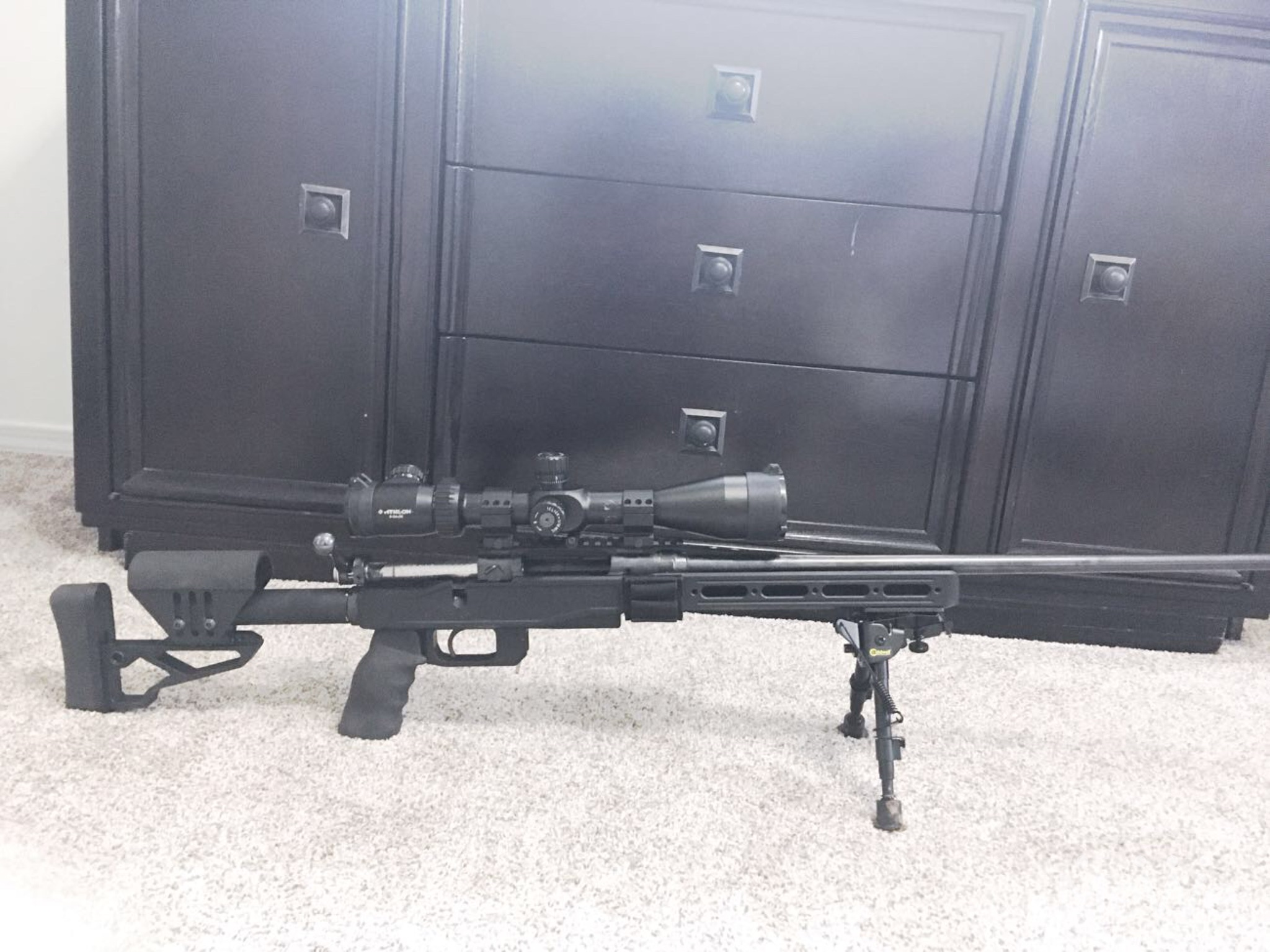

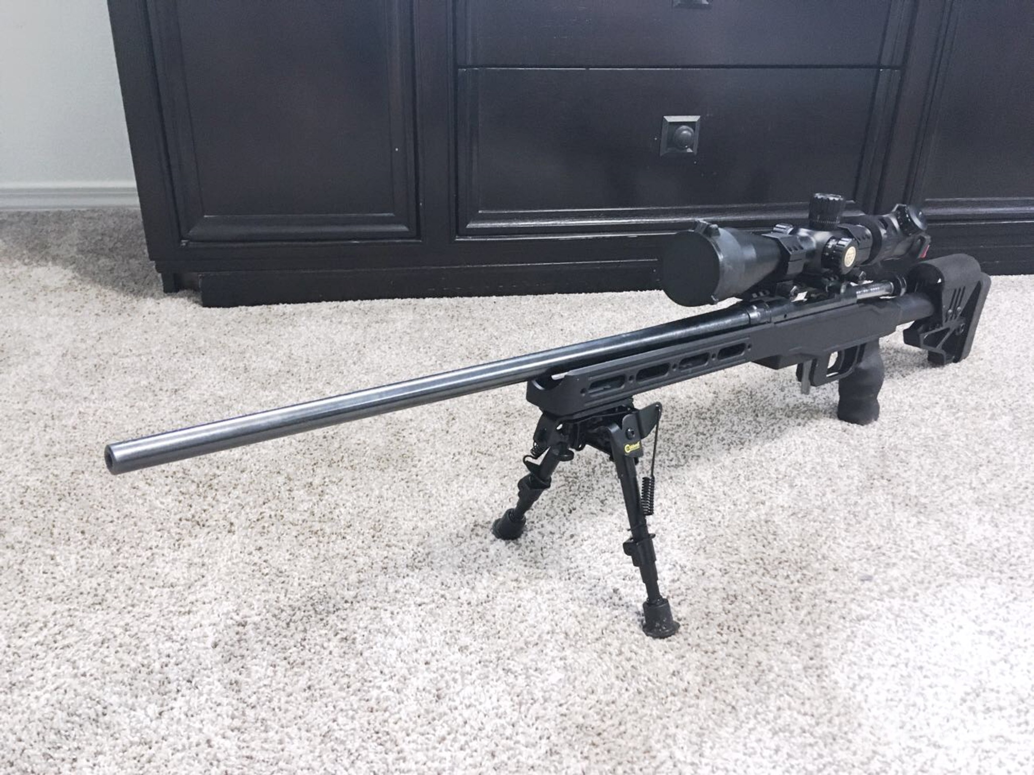

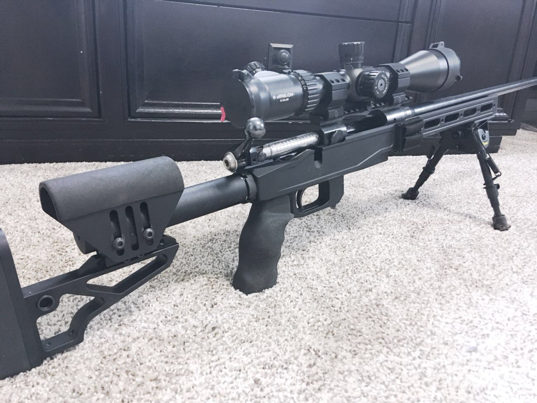

    Below is my old Savage that I took a bit of a bath on....
    This was the info I was looking for. So after you dumped the money into it what kind of results did you get out of it?
    I upgraded the extractor, bolt lift kit, trigger job, chassis.... Essentially everything accept the barrel...
    It shot fairly well, but after longer shot strings it would walk all over the place...
    I realized I dumped money into that platform trying to overcome its inherent draw backs....
