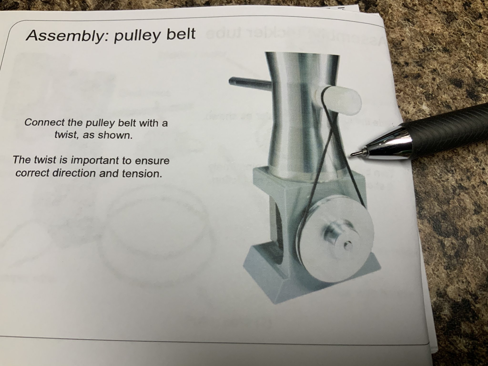

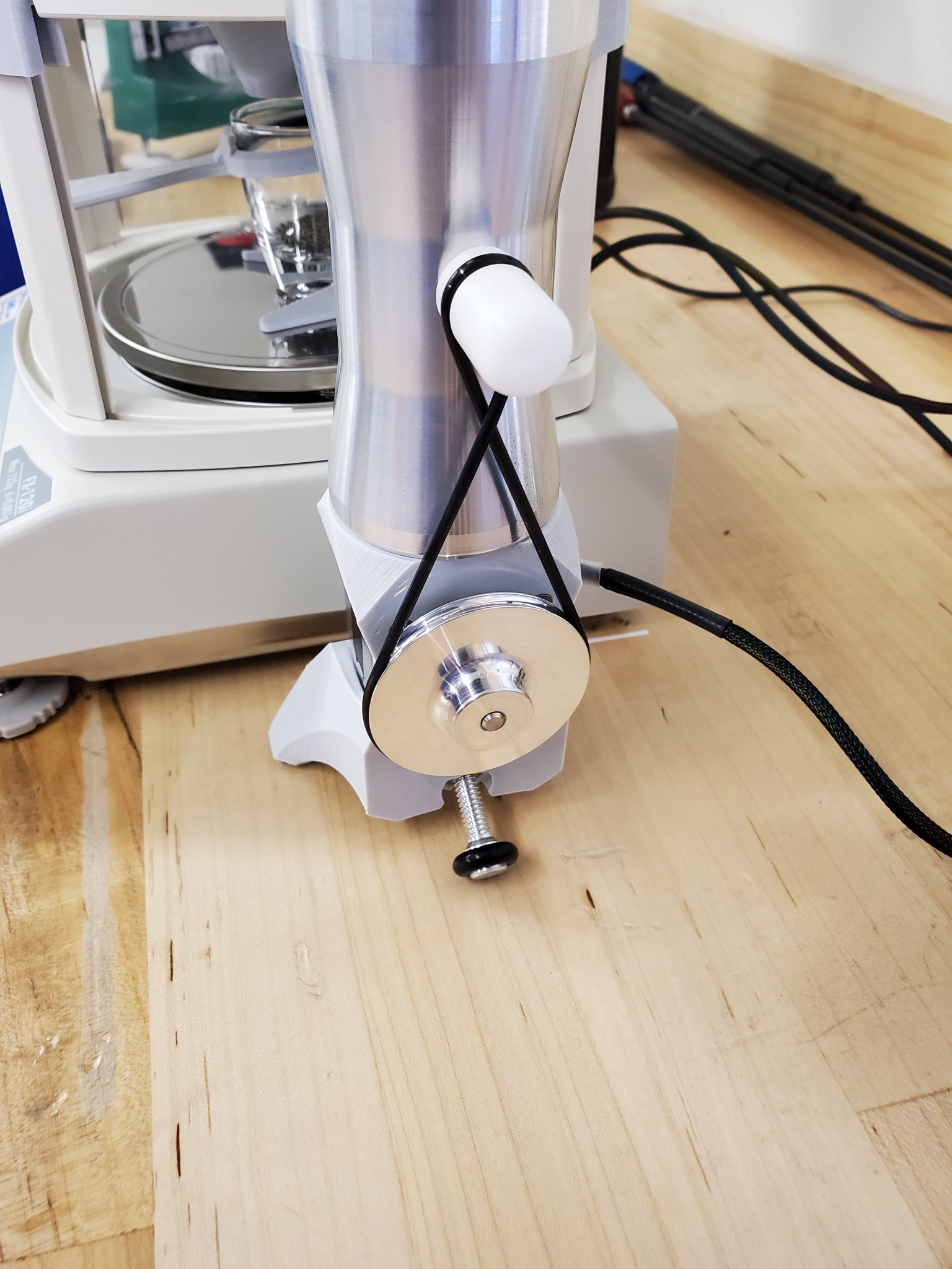

I don't believe it is.
According to the manual, you have it reversed. I always wondered if it made a difference.
Pointing at the loop that faces away from the unit. It’s outside the loop, yours is inside.
V3 does not matter which way the pulley is placed. Page 1 of the V3 manual. This was a change from V2.
