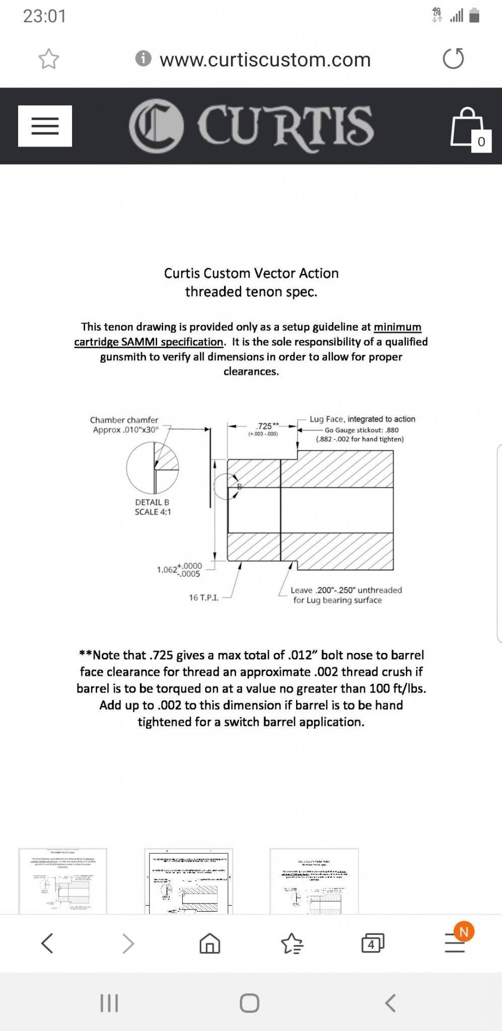

1. Can someone take calipers to a vector prefit hand tight barrel and tell me what your reading is from the chamber end of the barrel to the shoulder.

It should be .725

Axiom.would be .680 and vector is .725 from face to shoulder.

With all due respect to others, 3 revs (+/-) is .0625" x 3 = .1875", which would be the gap between the front of the action and the shoulder of the barrel trunion. I seriously doubt your brass is that far out of spec. I would agree that you should get a set of headspace gauges. However, I think they're just going to confirm that the prefit barrel prep is wrong for your action.

If you are roughly 3 full turns before bolt will lock on a round, that is roughly 0.150 - 0.187" of difference. That is a butt load and way out of bounds for differences in brass/headspace. Either the caliber is incorrect or the barrel is for a different action.

Youve been given the tenon measurements. You havent said how yours compares.

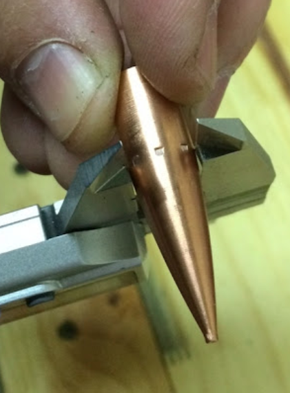

I had a prefit spun up for the 108 hornady's, and was getting the same thing you were, with the bolt not closing. I ended up shooting the factory federal 6mm ammo, and everything was fine.

I have literally had dozens of rifles chambered with this reamer and never had an issue. Apparently the ogive of the hornady 105 and 108s is dramatically different and needs a different reamer.

I had a barrel chambered with that reamer too, I found it to be unreasonably short. If I were the OP I'd either send it back or have another smith pilot ream the throat. For whatever it is worth, factory loaded Hornady 108ELDM is about .090" too long.
Federal Gold Medal 105 Hybrids. I had pretty stout lands marks on the Hornady 108's, and the bolt would have closed if I forced it ( I did not), but the Federal ammo chambered and shot fine. YMMV.
