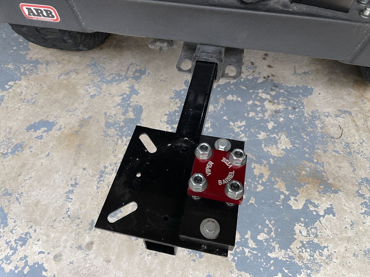

Anybody try mounting their vice (viper in my case) to 2" tube steel? I'm moving things around and the place I have my vice isn't the best. I was hoping to use the hitch on my truck.
Did the exact same. Worked out fine installing a prefit.

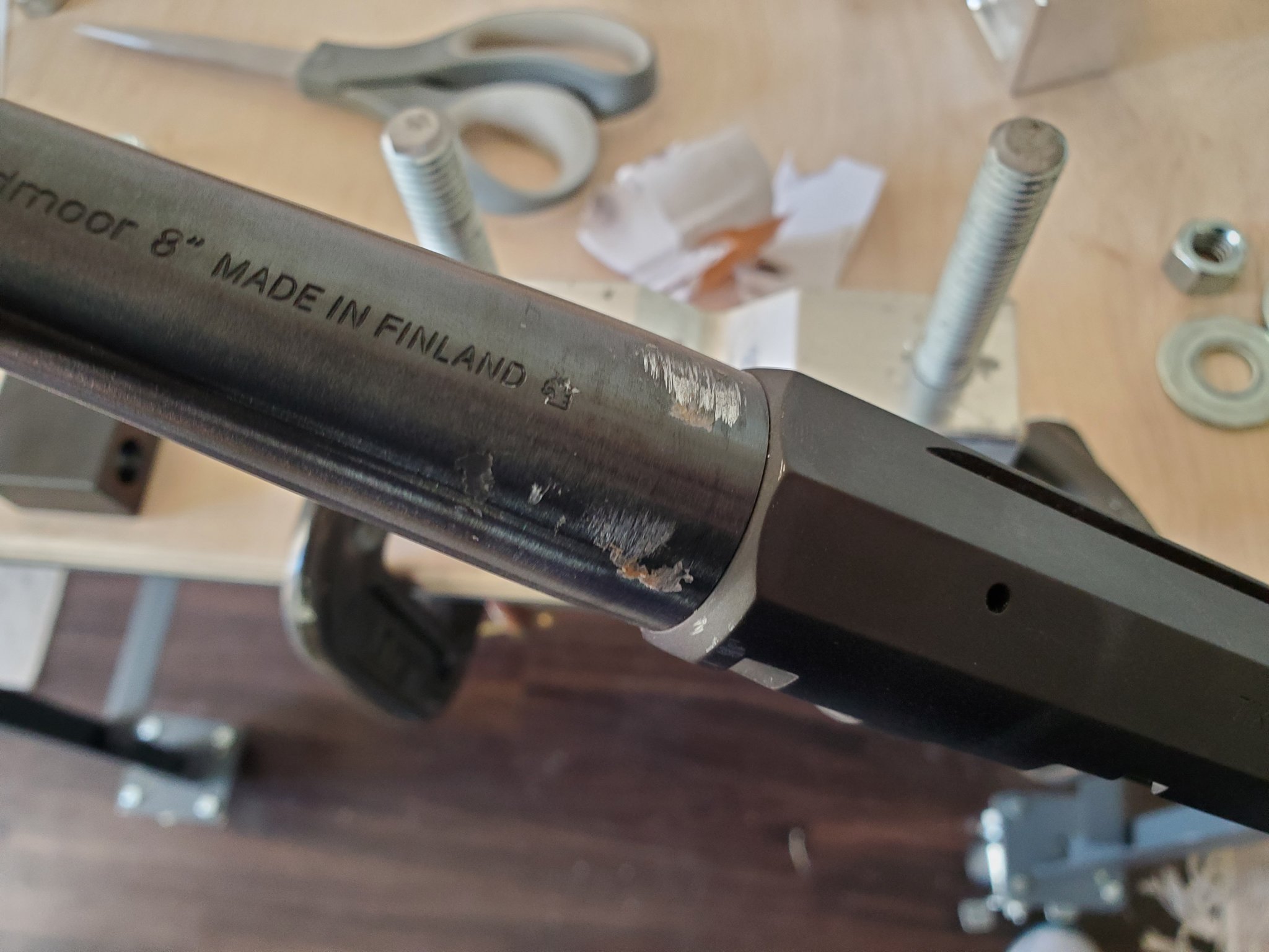

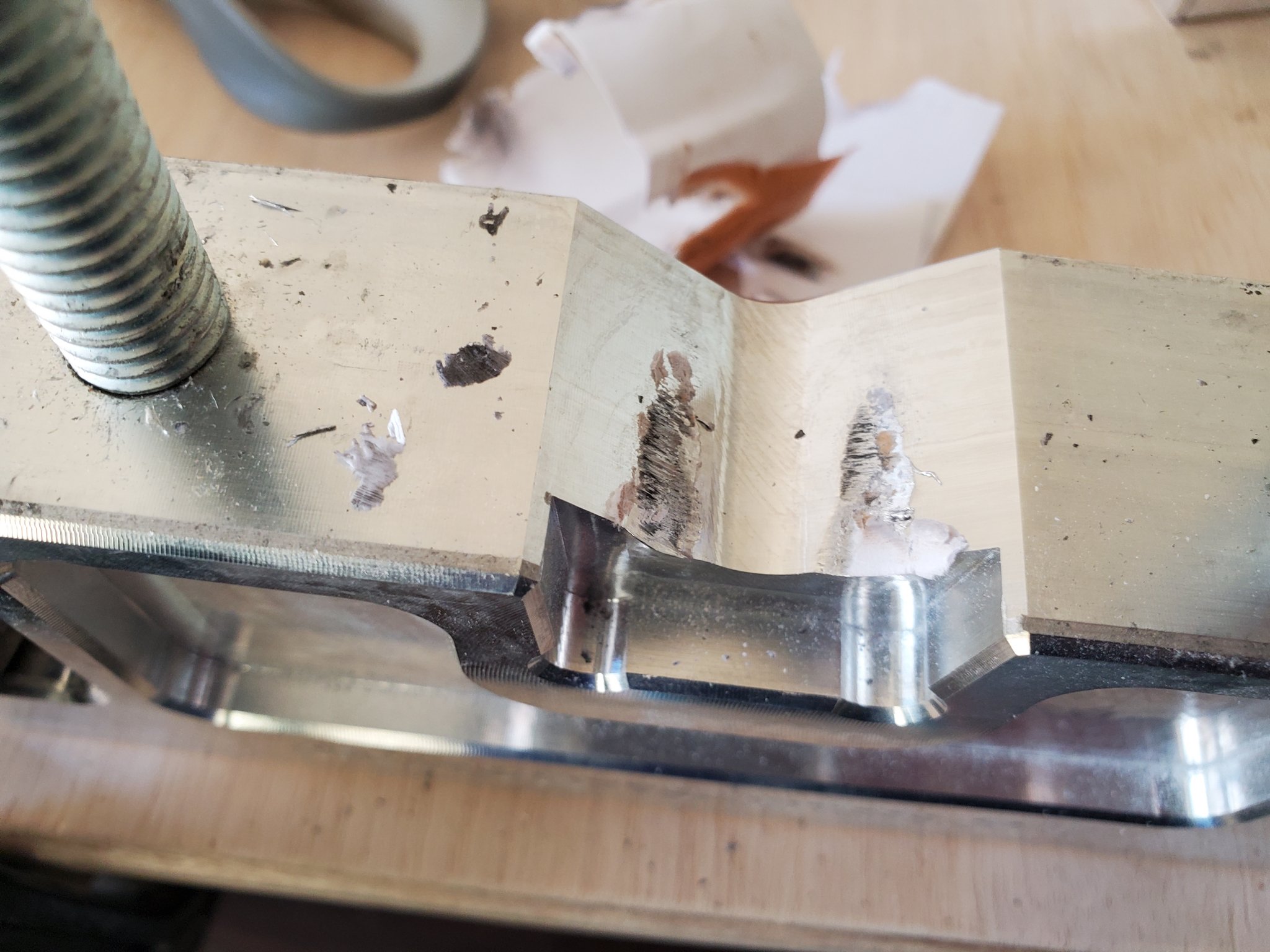

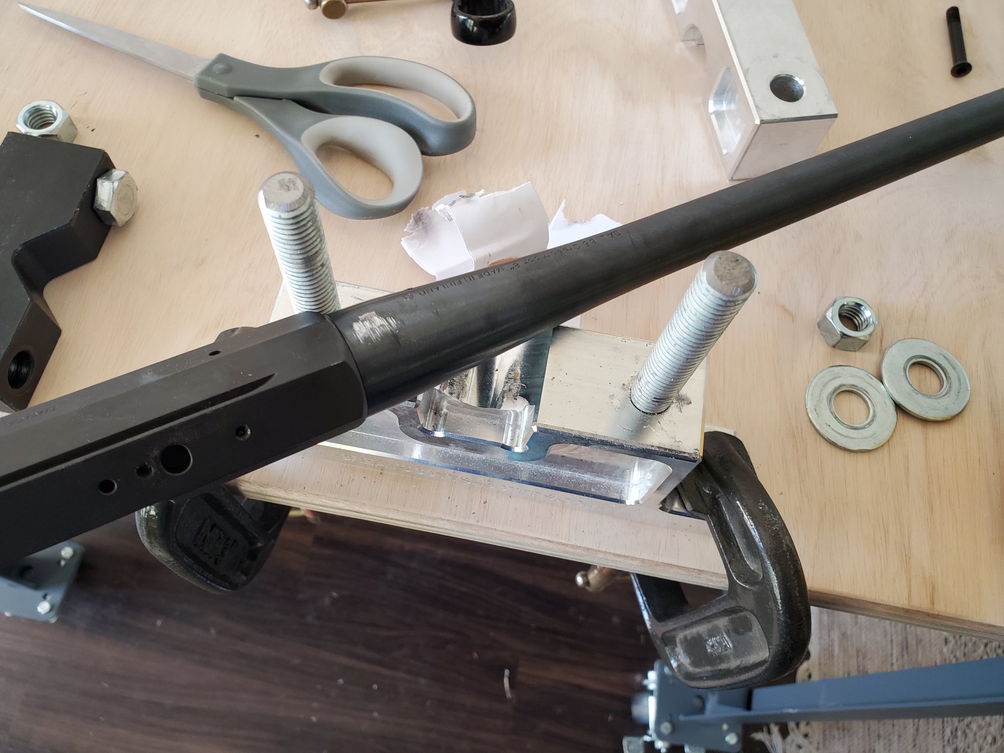

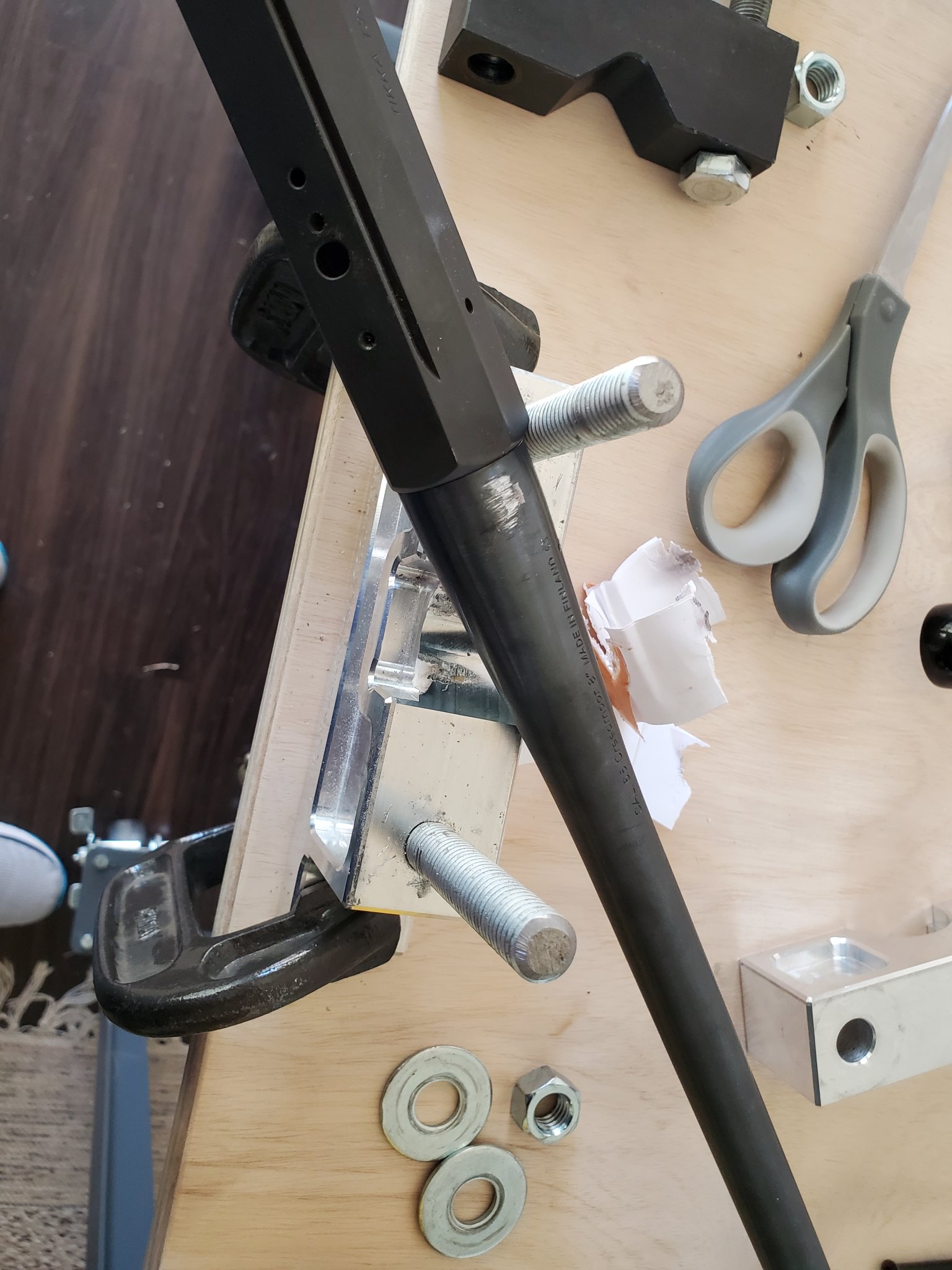

Don't use the Great Scott vise for your Tikka, made a mess of mine today.
