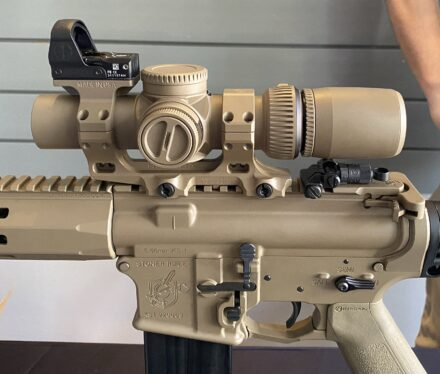

    How come Vortex can provide real FDE to .mil, but to civvy's they provide :poop: color???
    Not sure why all the comments about AMG being so expensive, I always thought the AMG (6-24) was actually a bargain compared to other scopes with similar quality. It was cheaper than the Kahles K624i it replaced when I bought mine 🤷‍♂️
    It cost less than a Schmidt at the time, it was a bargain. That whole gun looks a little spray-coated though, Bill.

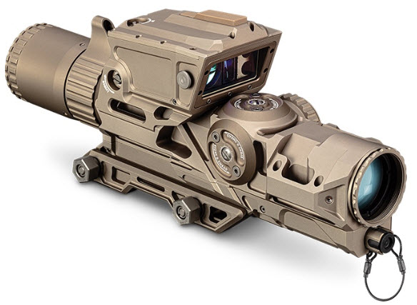

    The 1-8x that's the basis of the XM157 scope.
    ILya
    He's referring to this bad boy
    Interesting that Vortex went with a 1-8 for the NGSW-FC, my guess is they determined that 1-8 would provide "enough" for the purpose of this platform and 1-8 has slightly less compromises than 1-10, especially in a shorter body... 🤷‍♂️

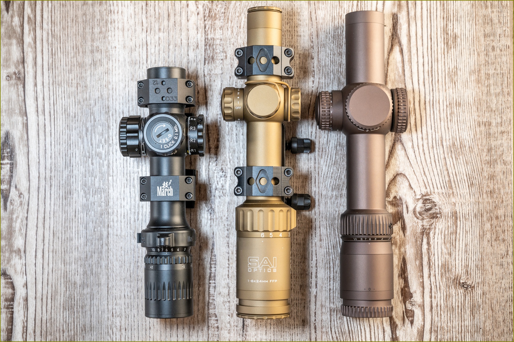

    The ATACR is fairly flat but the FOV is lacking.
    I'd like to look through an ATACR 1-8. The other ATACR's I've looked through - I wasn't super impressed with, given their price and reputation. The Vortex Razor 1-6x24 is about as good as it gets optically, at the price of weight. Kahles K16i is great too. In the higher-mag scopes, I've found the Steiner M-series to be fantastic, especially for their prices in the used market.
    Well that is the tradeoff, if you want wide FOV then you'll probably sacrifice some of that flat field or sharp edge to edge clarity, I have seen this in many scopes. The best I've seen at handling the "best of both worlds" is the TT, but those are long range scopes and not LPVO's. I was very impressed with the ATI SAI6 1-6x24 and they are coming out with a 1-8 model next year and am very anxious to get my hands on one of those. The 1-6 has very good FOV and I don't recall much distortion at 1x, if they can keep similar with a 1-8, that might be the ticket... it also has an anodizing that is much more ideal than Vortex!
    Very cool, thanks for the info! I was wondering about those SAI's.

    It’s all compromises. Even their NX8 product has 10% more FOV.
    Everyone I know with one likes it a lot.

    Jake just bought one (ATACR 1-8), he's obsessed with them (but more for the reticle I think). Me, I'm content to wait for the SAI8 that will hopefully be what I hope it is...
    If I got them at dealer cost I might have them, but I get them at peasant prices so there’s better out there per dollar for me. Schmidt dual cc blows it out of the water IMO, so that’s what I ended up with.

    That would make it even more interesting. Unfortunately I think ATI is pretty committed to the BDC world for SAI, but maybe they are listening and the SAI8 will come with both BDC and mil options (y)
    I'll be honest, I had really high hopes for the SAI 6 and then when I got one in hand I was a bit disappointed but unfortunately I really can't put into words why. I think the reticle presented a bit small, absent was that "no glass inside" view like say a Razor Gen II or a K16i Kahles. I came away, meh. A 1-8 could change that. I much preferred the same reticle and view of the K18i Kahles vs the K16i just because of how the scope presented on 1x and the resulting reticle scaling.
