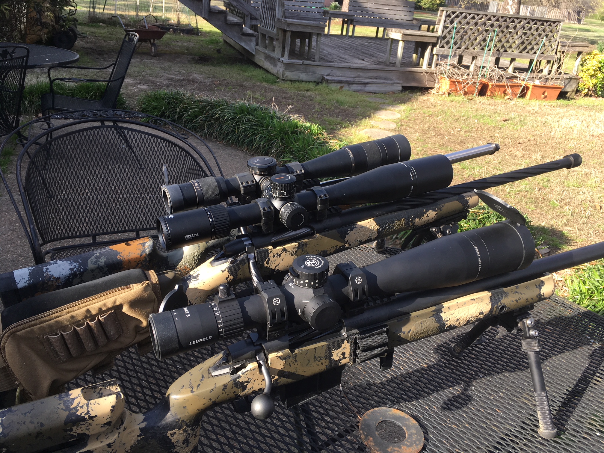

In my quest to find the perfect optic for Michigan deer hunting. This last season I used a 1-8x Trijicon. While that is a great scope, I found myself using 2-3x mostly while in my blind and when at the range zeroing and just playing around I'd find myself wishing it had a little more power at the top end.
With that in mind I picked this bad boy up recently.
http://www.vortexoptics.com/product...-10x32-ffp-riflescope-with-ebr-4-mrad-reticle

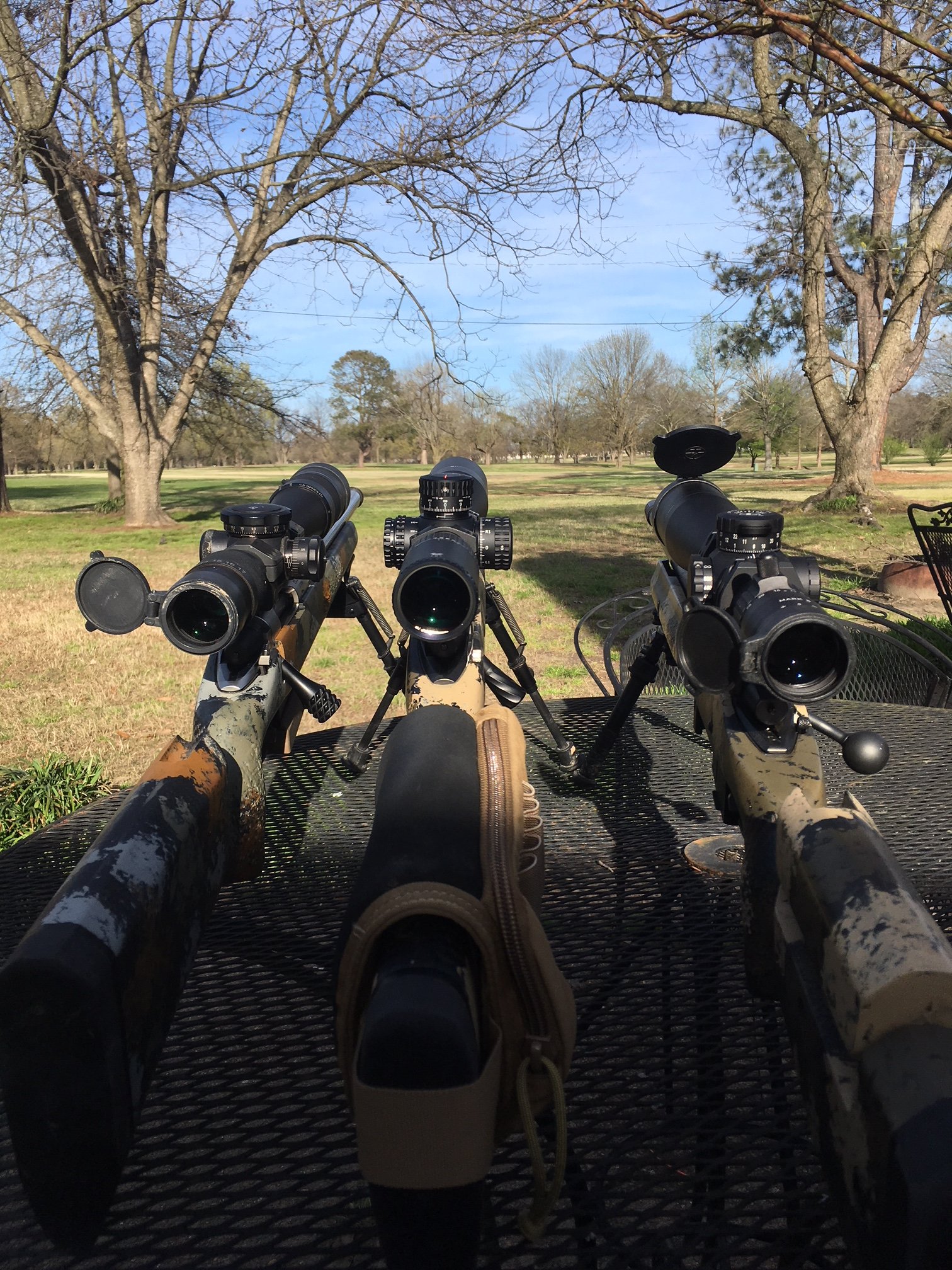

We are in the middle of a snow storm today... Conditions suck for a comparison. But I can tell the Nightforce is slightly better than the PST... but its is definitely better than my swfa 5-20 at 10x and my Bushnell 3.5-21x DMR. In person I couldn't see an chromatic aberration with the PST but if you look closely in the blown up Pic's the camera does show the NF as the clear winner, not that I was expecting the PST to beat it. ;)
PST @10x
The fence is about 50 and the recycling bin is about 100 yards
ATACR 4-16x42 @10x
Using my Leupold boresight which has a grid in inches I compared all three scopes over 10 mils and the PST tracked true.
The illumination doesn't go quite as low as my Trijicon 1-8x but it isn't bad at its lowest setting.
Now here's something interesting, with the PST at 2 power it has a wider field of view than both the swfa 1-4x and Trijicon 1-8x with both set at 2 power.
Next I'll have to see how it handles lowlight that I will encounter in the woods while deer hunting. But I'll need to wait for the Snow to melt to do that.
So far I am happily impressed with this scope.

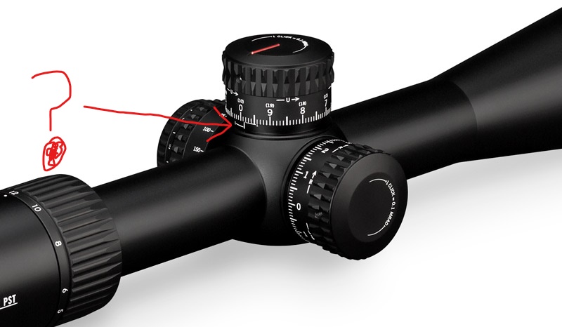

Are you talking about this line?
Got mine out to the range. Not sure if the dial matches the reticle, but that is for another day of testing. I set the zero stop and it works, but the dial isn't at the bottom and line up with the lowest 0 line? Are there washers or something to remove in the cover knob to get it to sit lower?
Those lines are just for reference. Different mounts, cant, rifles, zero will index at diff lines. Use it as a reference. That's what the zero stop is for. Make sure to give yourself 0.5 minimum down adjment
