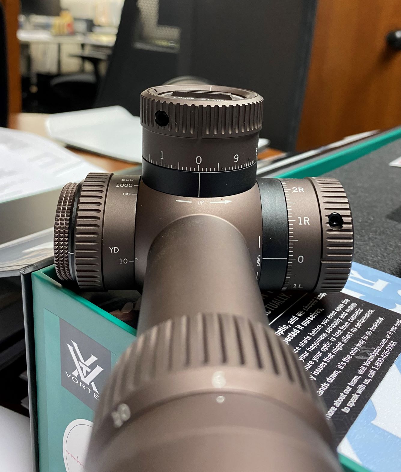

My HDIII arrived yesterday afternoon and the first thing I did was twist the turrets....no issue for me. They felt very similar to my XRSIII. The locking portion is 'stiff', but I'm sure with some use it'll ease up some.
How is the sound and feel? Are they clunky and loud?
Some guys must be gay for turrets - they are fine, softer than some, but not mushy like old school Bushnell. Controls are great quality and good feel IMHO - stiffer than ZCO and lighter than XTR3, but, like the glass, closer to ZCO than XTR3.
Reactions: Sjc141
Nah they just have expectations which is understandable given the price point and noted inconsistency in users experience. Turret was a large selling point of this optic. Obviously the glass and mag range are as well. Mine are meh for money. Which is why I’m letting them take a look. It’s the worst turret i currently own maybe besides the LHT.
It would appear just from this thread alone there is a range of sample variance with regard to the turrets, mine have settled down some and have a nice click value now - not as inconsistent from when I first got it (makes me think it is a grease issue?), also don't feel as heavy (hard to turn) as when originally out of the box; however, my parallax is still very hard to turn and almost can't with just two fingers. I am considering sending it in to see if they can free up the parallax and just have them "check" the turrets.

Guys, it's all definitions and what each of us 'feel'. Clicks do not feel like my 22+ yr old PMII, but very similar to/slightly stiffer then my XRS III. Parallax/zoom knobs very smooth. I don't count clicks when I'm raising elev, I just spin it to my number, so feeling/hearing/etc each individual click isn't an issue. Will be mounting it on my custom M700/Bartlein/A5 this weekend.
Just took delivery of mine, and yup... slightly more than yours... not quite halfway in-between but definitely off by more than yours. Is there an adjustment for this or "just the way it is..." ? (gonna shift my OCD into overdrive... ;) )
That's too funny, my ADD and OCD often conflict with one another 🤪
For what it’s worth, the parallax adjustment ring on both my Razor Gen 3s are as stiff as the magnification adjustment ring on all my Razor Gen 2s.
And the magnification adjustment ring on both my Razor Gen 3s feel like the parallax adjustment ring on all my Razor Gen 2s.
Confusing, huh?
I’m not sweating it, although a buddy who tried the parallax adjustment asked if they’re making a throw lever for it.
